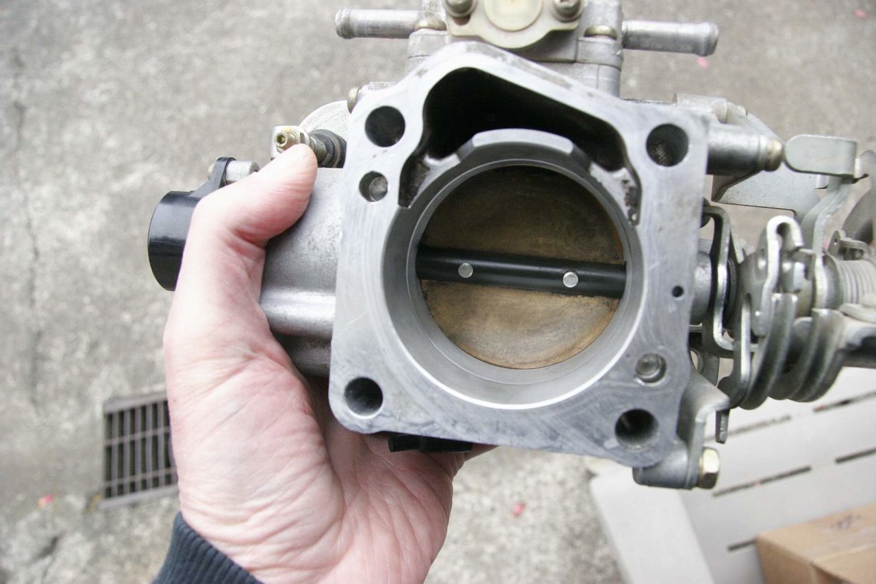

    With mileage, the throttle plate wears a groove into the main bore of the TB. The throttle plate is supposed to close completely and not allow air to pass by it at idle. The Max Bore service machines the opening round again and replaces the plate.
    http://maxbore.com/

    When the throttle plate is functioning correctly (not allowing air to pass) the engine and its electronics manage the air and idle through the IAC. Intake Air Control.
    Mine was pretty grungy too. My mistake was cleaning it because the grunge was helping it to seal the throttle plate. I compounded the problem by not removing the TB from the plenum.
    When you clean yours, make sure the IAC is removed so the grunge cannot get into it and gum it up.

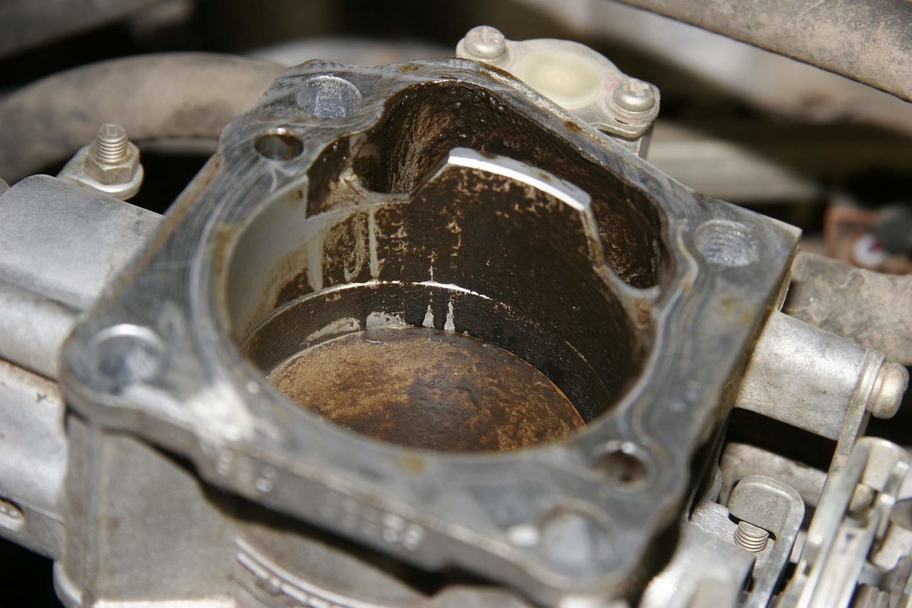

    If you don't want to remove the IAC before cleaning, at least flip the TB upside down so there is no chance of anything dropping into the IAC. I ruined mine and it is an expensive piece to replace. Best price I can find on it is $225 for the OEM parts.
    IAC Valve Gasket 22215-62180 $4.01
    Throttle Body Gasket 22271-62040 $4.49
    IAC Valve (idle speed control) 22270-62050 $211.85
    Here's what mine looked like before I cleaned it. :puke:

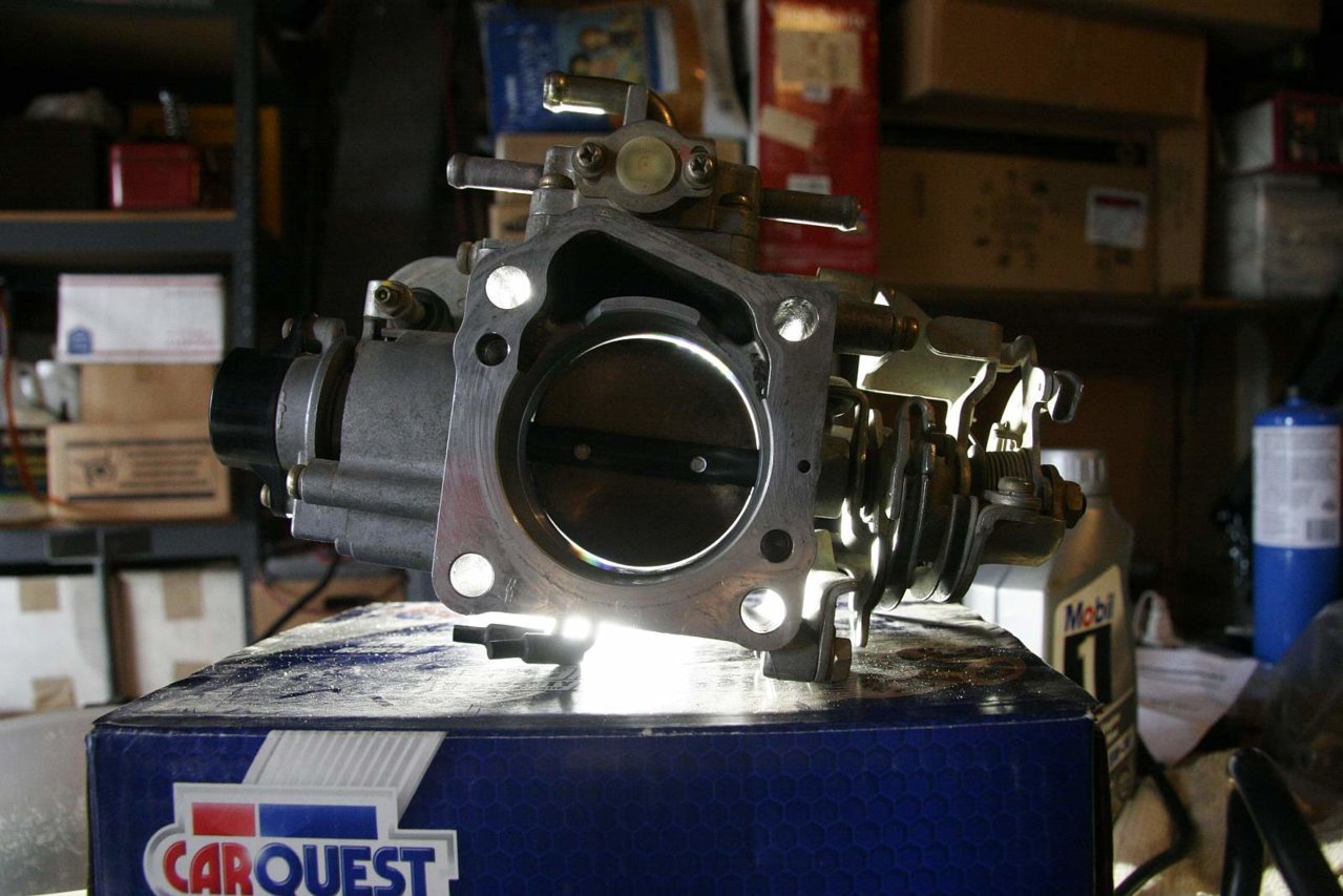

    After cleaning...
    After the Max Bore work, no light shines through.
    I suspect most of my idle issues were the IAC, but there is no way for me to be certain how things would have been after cleaning if I hadn't fucked up my IAC.
