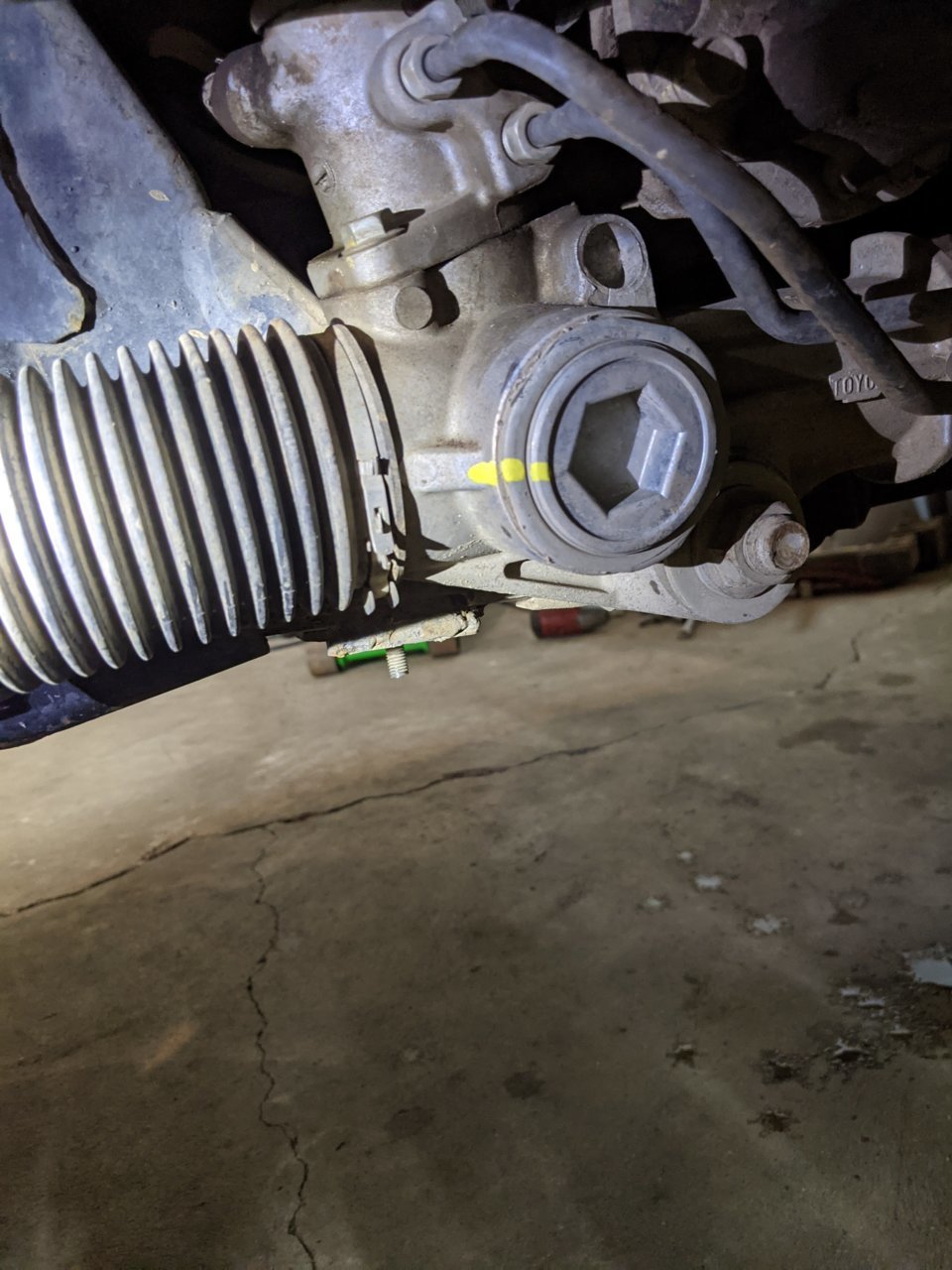

    If anyone has an inconsistent vibration almost like a tire out of balance but it isn't constant give your steering rack bushing a check. I was able to get about an 1/8" turn. It seems to have solved my intermittent shaking steering wheel.

    Do you mean the bushing that mounts the steering rack, or the big hex one that you have paint marked?

    The big hex. If it's a nut it has a roller instead of a bushing.

    That's the rack guide, I tightened mine just a smidge once and it really stiffened up my steering... Like in a bad way lol. Tires wouldn't return to center after turning. Had to loosen it again. It's crazy sensitive

    It gets sensitive quick. Mine might be just a skosh tight but I figure it'll wear in or I just won't notice it after a week of driving it. This is the 2nd time I've had to adjust it in 3 years or so. After the first year of the new OEM rack the locking ring was loose. I should probably put an inline filter in one of the lines if I wearing it that quickly.
