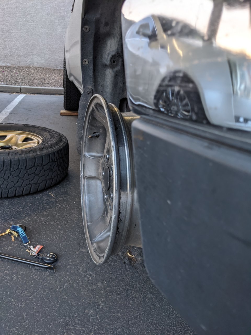

    Stock again- rip slug

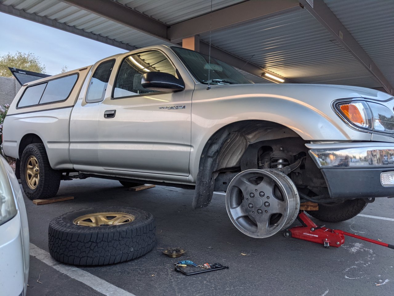

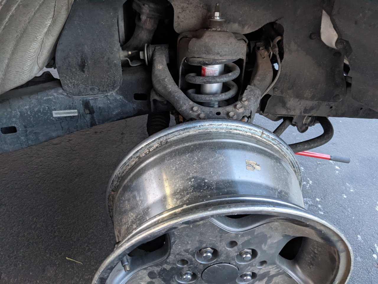

    Last spam.
    Fitment

    looks really good. almost like fj80 wheels but 5 lug =)

    Thank you!
    Hoping it comes together nicely in the end. I didn't anticipate changing the wheels and my wildpeaks out at 32k miles but they're already at 4/32 :oops:

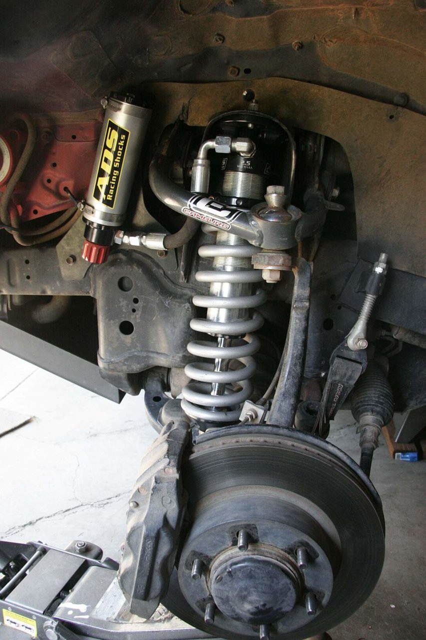

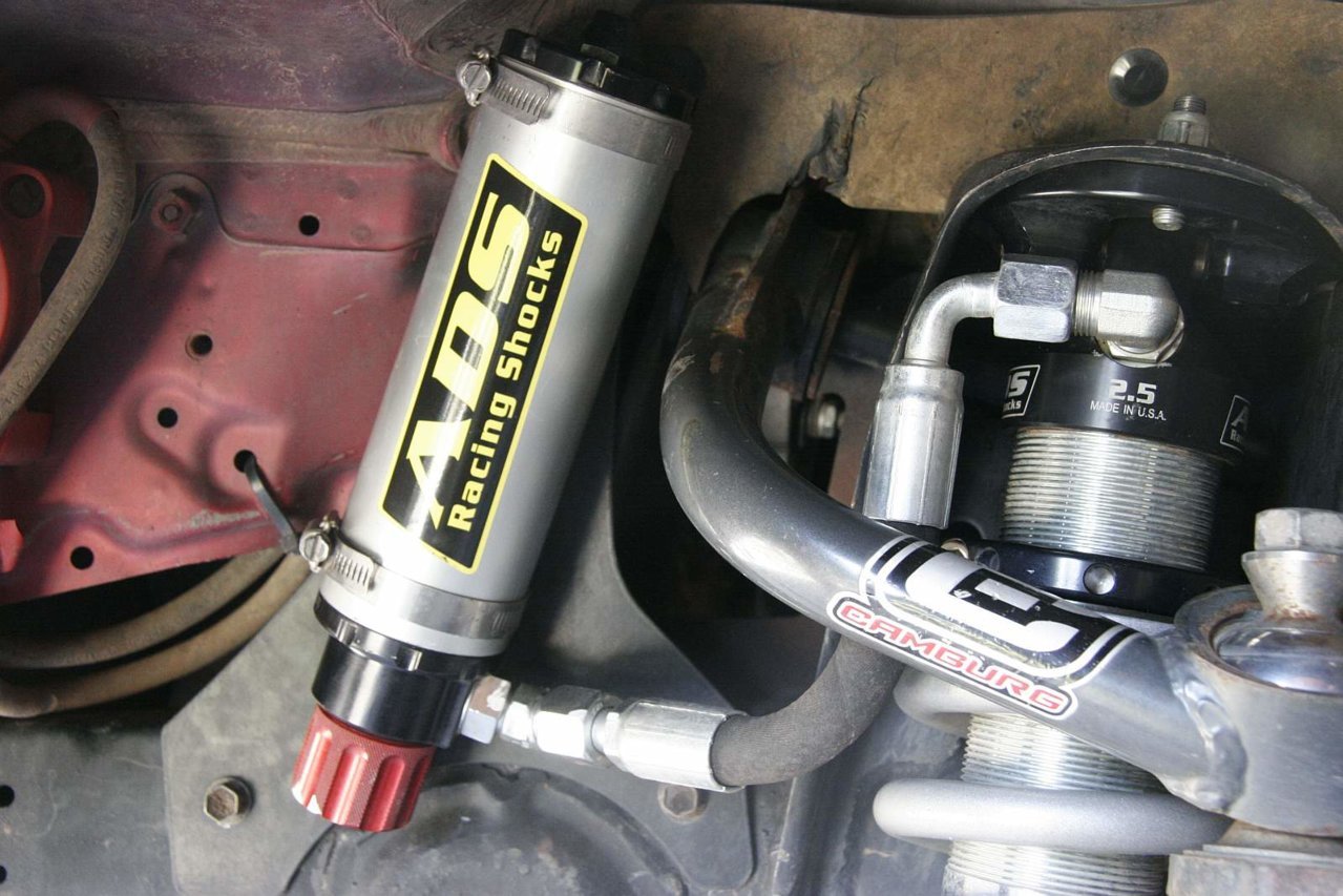

    About 9 months ago I purchased a set of ADS CO with resis and compression clickers. These shocks are amazing and by far the best shock I have ever run. Unfortunately, the resi hose configuration they came with exposed that hose to rubbing from the 285/75-16 tire in tight turns and trail conditions.
    Before:

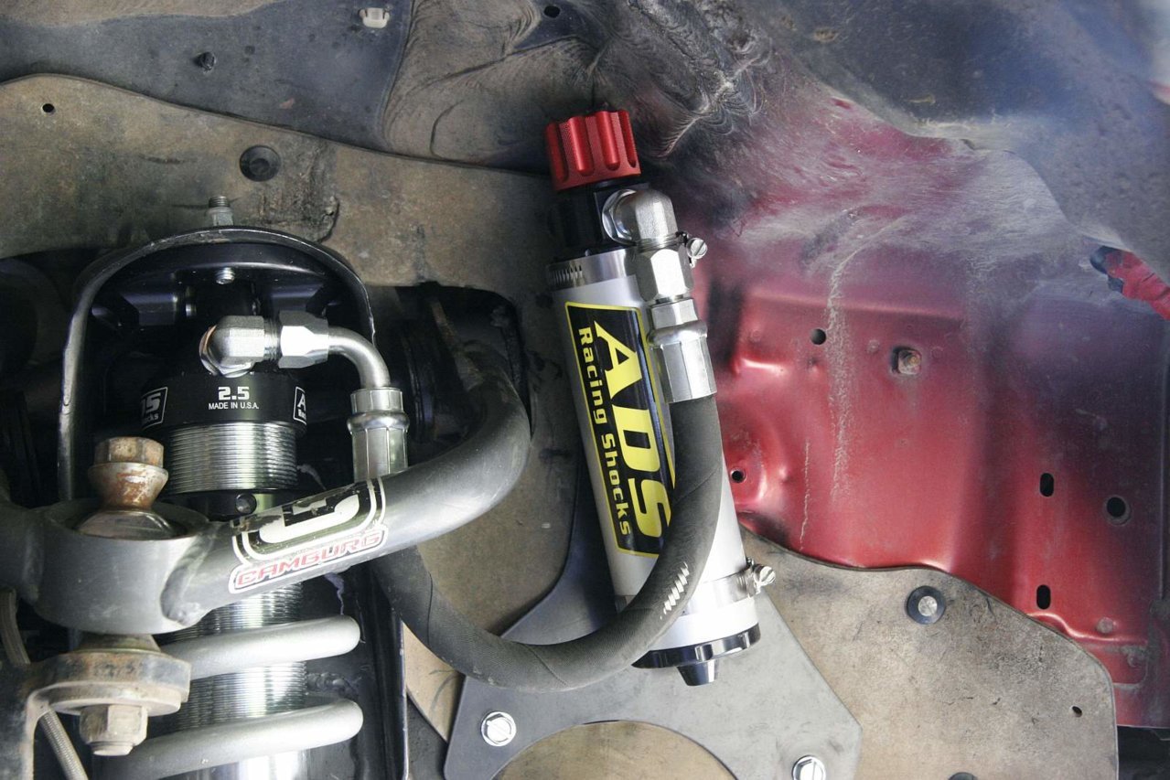

    Fast forward to a couple of weeks ago. I took the truck to Matt at MCM Fab in Las Vegas where I had made the original purchase. Matt completely disassembled the shocks and fitted brand new hoses, with the correct configuration. And did not charge me a dime for his 3 hours of efforts.
    After:
    We both agreed that this is how they should have come originally from ADS and he assures me that his findings will be passed along to ADS so all CO w/clickers intended for 1st gens will be configured this way going forward.
    I want to give a big shout out of thanks to Matt. He took care of me and made it right.

    All that work on the front end and no spindle gussets?

    Ha! You are right of course. With this setup I can now go fast enough to easily break something.
    FWIW, I have another set of spindles and a set of TC gussets to put on them. It is on the to-do list.

    I’d love if mine were in that orientation

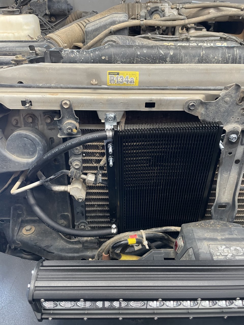

    Got my trans cooler hooked up. Looking forward to see how it does. 5D05322D-AEF2-4DA1-B1FF-2D41C36AE256.jpg

    I'm sure you can get yours setup this way. I can't recall who you purchased from.
