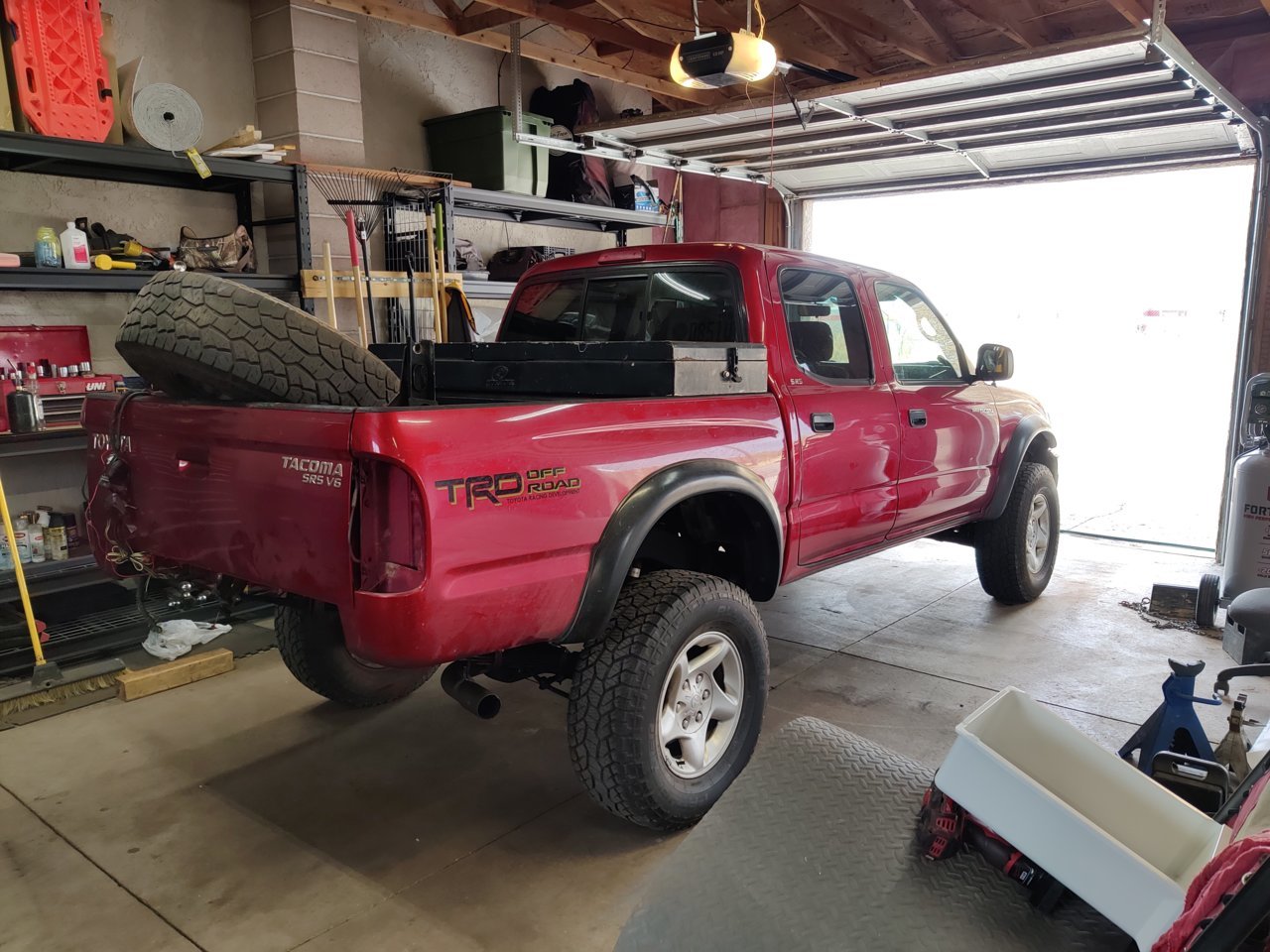

    Mostly backIMG_20210416_165124.jpg in one piece.
    I'm a bit disappointed with Low Range Off-road right now but that's a story for another day

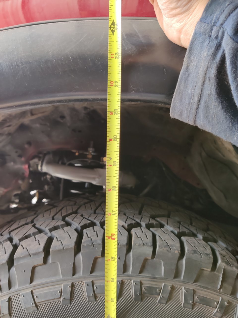

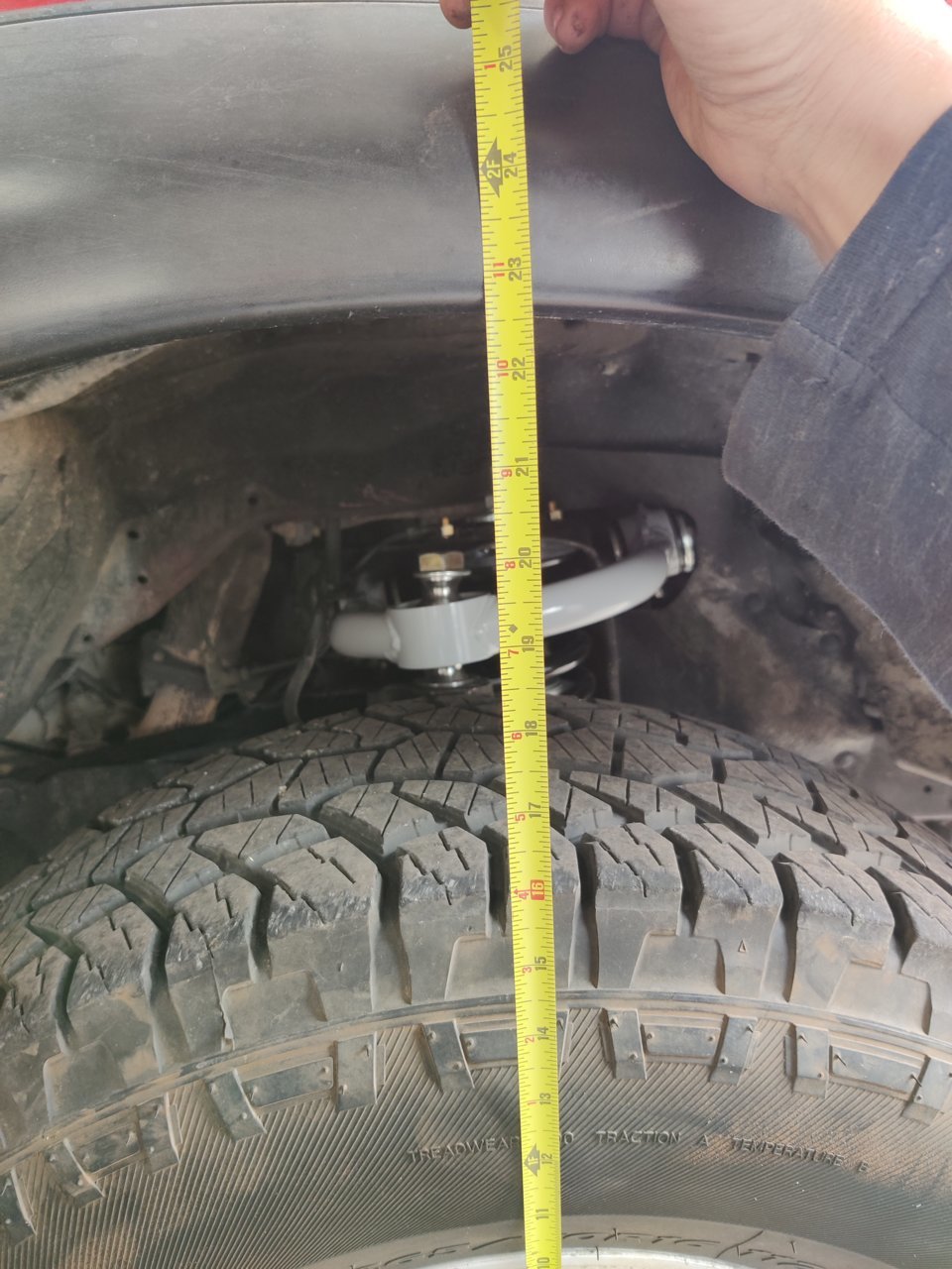

    Here's where my 6112's are currently sitting. (drivers side)
    (passenger side)
    :annoyed:

  12. Apr 16, 2021 at 4:35 PM
    eon_blue
    Mar 4, 2016
    #180213
    70,110
    Azusa, CA
    Not that uncommon really, with the gas tank and all on that drivers side. You sure you're on level ground when measuring?
    1" is pretty noticeable though. I remember I had that problem with my Expo springs and was even contemplating putting a small block on that side, but just ended up biting the bullet on new Alcans and that solved that problem.

  13. Apr 16, 2021 at 5:22 PM
    unstpible
    unstpible Well-Known Member
    Aug 16, 2012
    #84909
    3,938
    Derek
    Cedar City, Utah
    03 4x4 boosted V6 Auto 341k miles
    CX Racing Turbo kit. TransGo shift kit. All Pro Apex bumper and skids. Smittybilt XRC 9.5 winch. All Pro Upper control arm's. Bilstein 6112's with 600lb coils. Eimkeith's lower control arm reinforcement plates. Perry Parts bump stops. All Pro spindle gussets and alignment cam tabs. All Pro standard 3" leaf springs. Bilstein 5125's rear. Extended rear brake lines. Rear diff breather relocation. MagnaFlow catback with resonator. Bluetooth stereo. Memphis 6x9 door speakers. Diode Dynamics SS3 Pro Amber fog lights. Single piece headlights. aftermarket grille. Anzo taillights. LED 3rd brake light. 4runner sunglass holder and dome lights. Master Tailgaters rear view mirror with 3 directional cameras, G shock sensors, and anti theft system. Honda windshield washer nozzles. Stubby antenna. Scan Guage II. 2nd Gen Snowflake wheels powder coated black. Cooper Discoverer ST Maxx 235-75/16 Denso 210-0461 105 amp alternator. Speedytech7's big wire harness upgrade. Aeromotive 340 fuel pump. Haltech Elite 2500. Tacomaworld sticker. Tundra brakes with Adventure Taco's hardline kit
    The instructions just tells you to install the drivers side one notch higher than the passenger side to compensate for the taco lean. So I'll do that when I brake it down I just didn't want to hassle with it and that's why I payed Low Range to assemble them for me but that was obviously a mistake and waste of money
  14. Apr 16, 2021 at 5:29 PM
    eon_blue
    Mar 4, 2016
    #180213
    70,110
    Azusa, CA
    Haha wow I totally missed the UCAs in there and thought we were talking about the rear. I'm blind.
    Yeah if it's the front then you can adjust the coilover for more height. Or just put a small 1/2" spacer in there. Pretty common for some kits to include a small spacer for the taco lean
