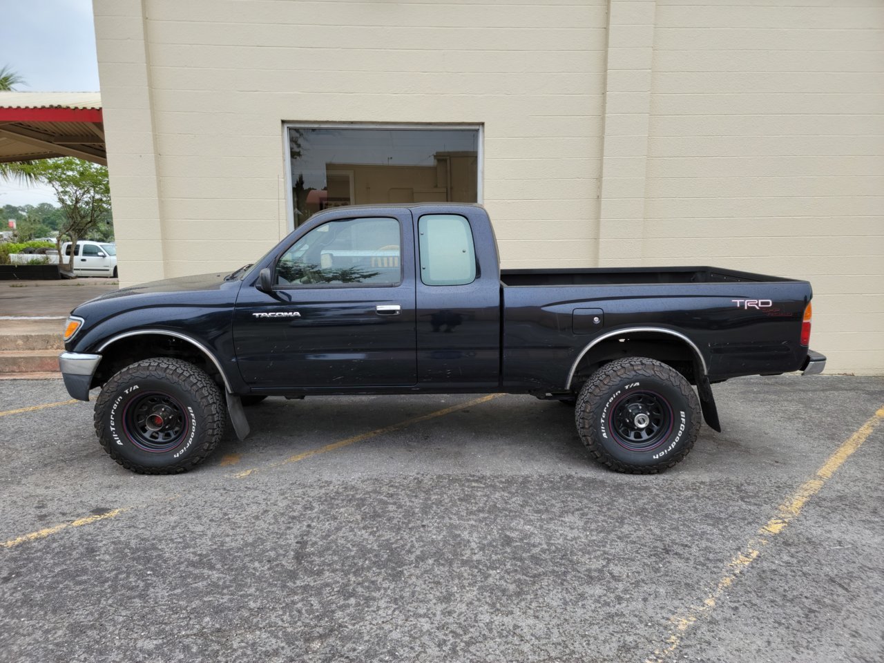

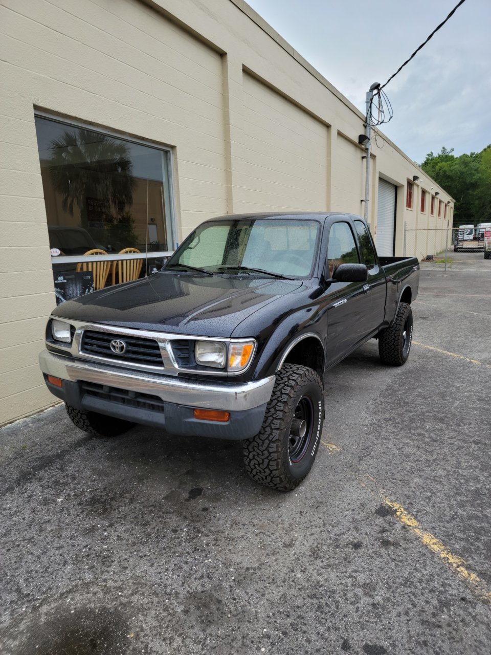

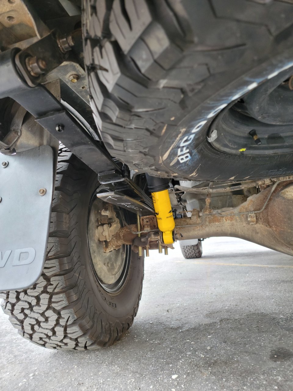

    Technically this was yesterday, you'll have to forgive me, but I put my truck up on OME 881s and progressive AALs

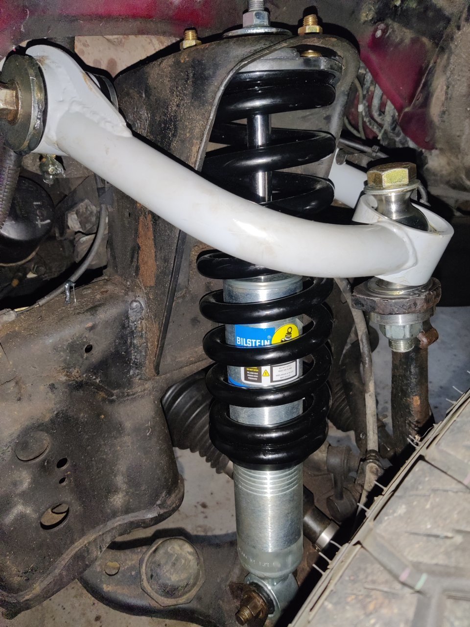

    There was a tag attached to the drivers side to make sure they went in the right order

    Well check them either way. They could have labeled them wrong. Should be able to tell what the lower collar is set to. Those 6112s have a lot more positions and could have been easy to miss take what side was what.

    The driver side is set one ring higher than the passenger side.
    Here's a thought and please correct me if I am wrong but would it be better for the range of travel to put some small spacers on top instead and leave the spring perch in the middle? I imagine for every spring perch higher it goes the less down travel it will have

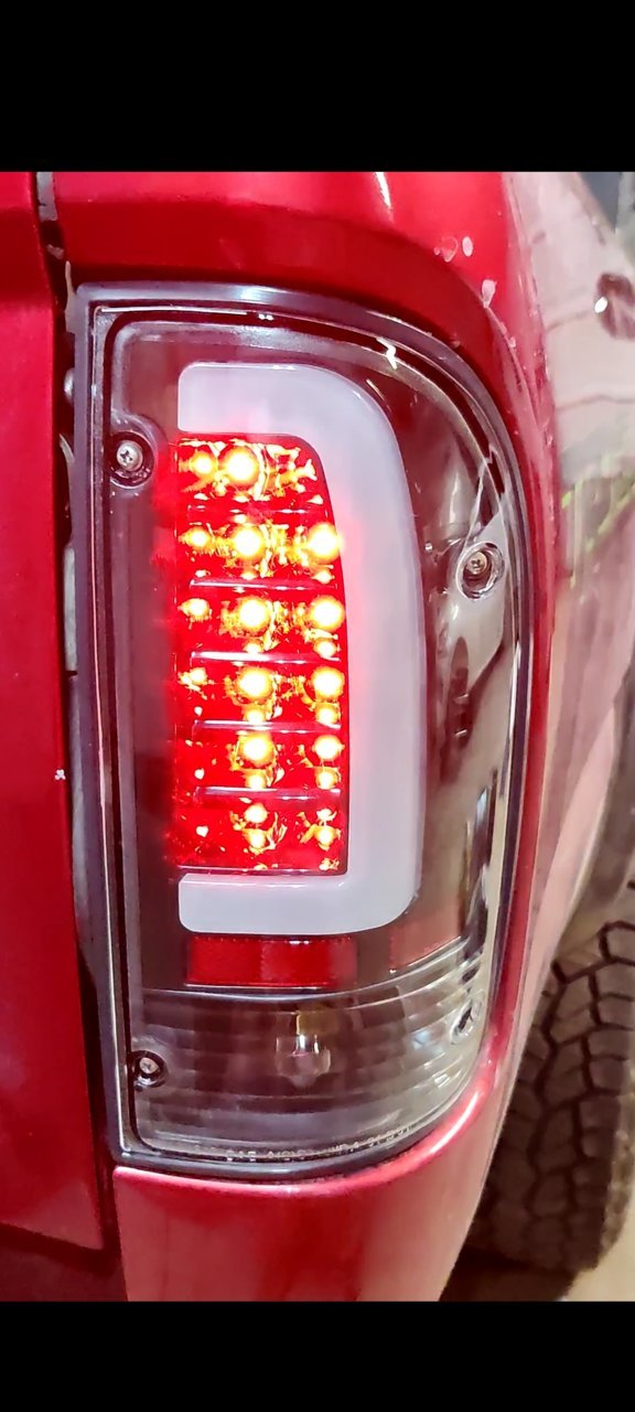

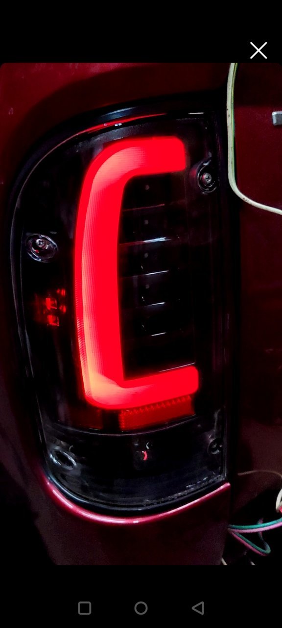

    On a side note I installed some ANZO taillights and discovered that the drivers side and passenger side were wired differently. they plugged in just fine but the bulbs are all sorts of scrambled
    I did some deep breathing and emailed customer support after reinstalling the OEM lights. We shall see what happens.

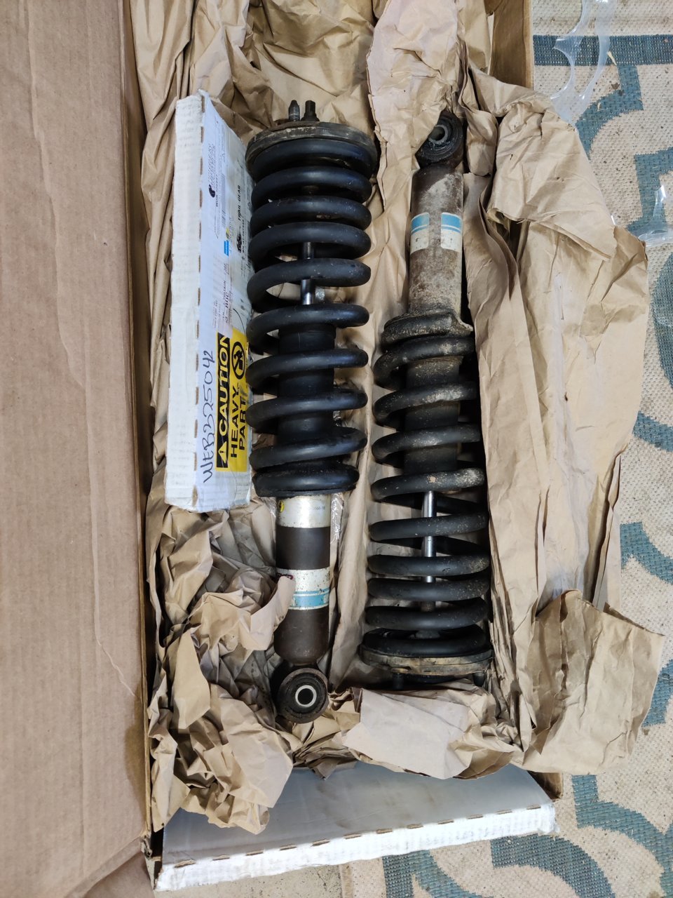

    I don't really like Spacers anyway. I'll probably slide a 1/2 on the drivers side anyway to correct the taco lean and adjust the 6112's to where they should be.

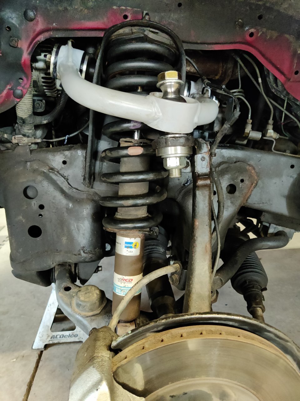

    IMG_20210417_135916.jpg I got the old 5100's back in the drivers side and gained an inch of height back.

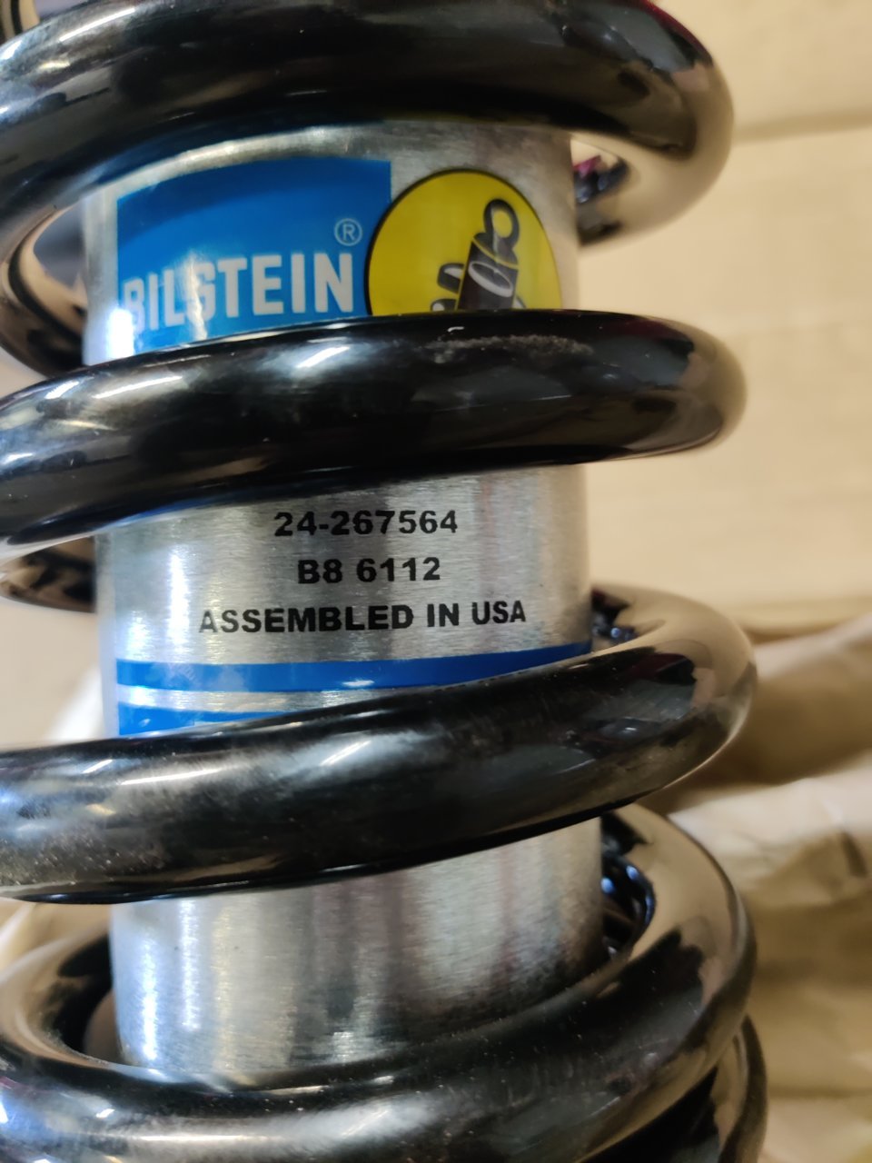

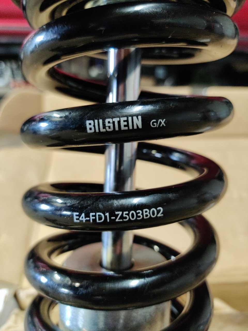

    Hm something just still seems off. Are there part numbers on the coils? Maybe they got mixed up?
    And I wouldn't use a spacers it'll lower the overall geometry of the shock and it won't match the geometry of the control arms. It's better to use the shock.
    I'd honestly consider lowering the passenger side first not raising the truck higher.

    Part numbers on the shock body and springs are the same for both sets

    Swap them and see if it's the same.
    It's not hard to take them apart. Can rent a coil compressor kit from a parts store.

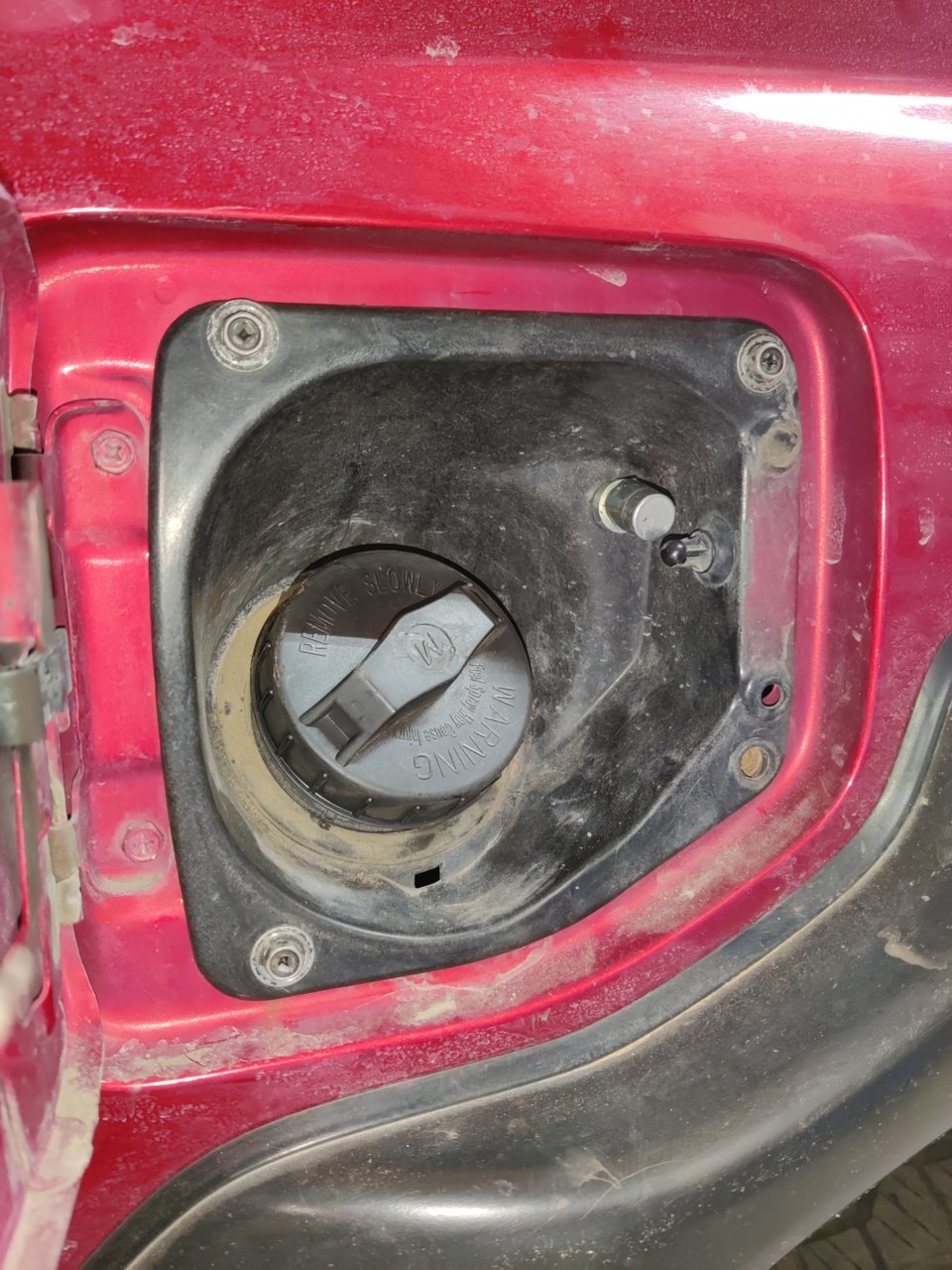

    I tucked my axle breather behind the gas flap today. That went smoothly. I don't think it'll be sucking water any time soon
