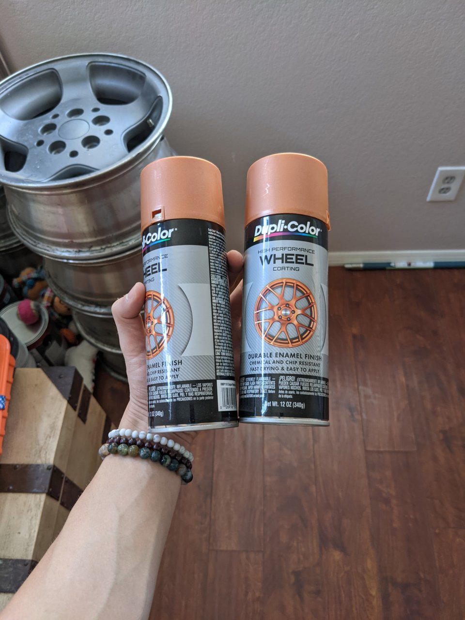

    Oil change #2 on the slugs new top end, and picked up the paint for the new wheels.

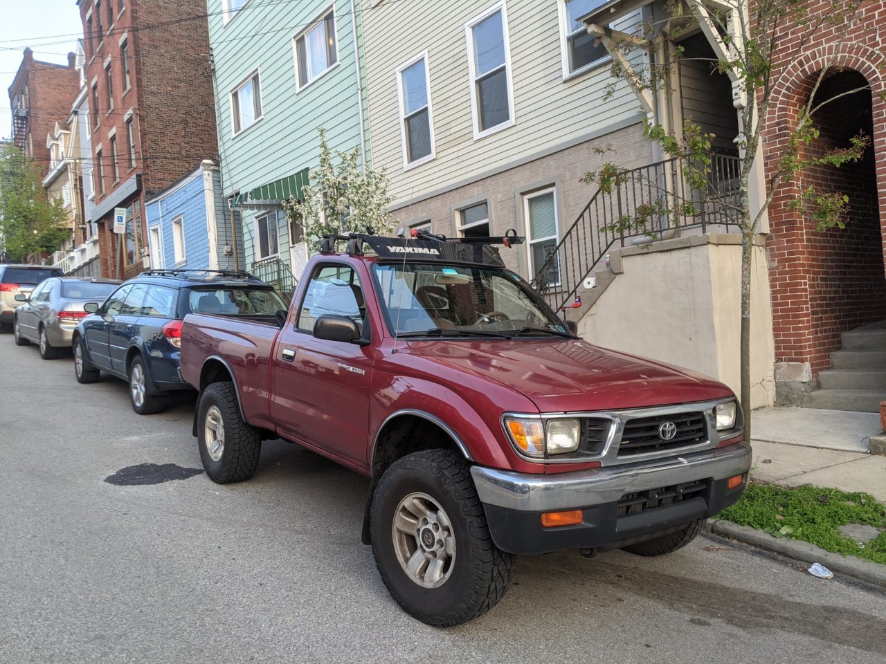

    world's tiniest roof rack on a reg cab...
    looks hilarious but surprisingly strong and its funny look is growing on me!

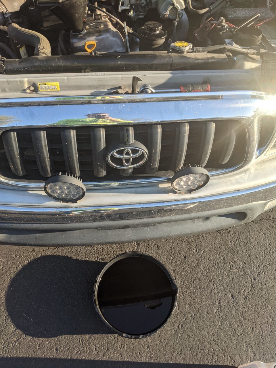

    Drain and filled the tranny. The fluid was a little dark and had a bit of a smell. In combination of the tranny cooler and the new fluid, I can’t get it above 200 and it cools off much faster now. I’m very happy with the results. I plan to do another drain and fill at my next oil change as well, might be over kill but figured it can’t hurt.
