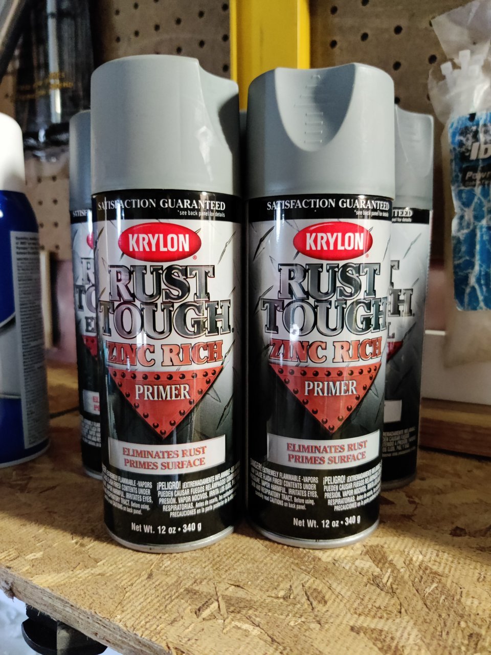

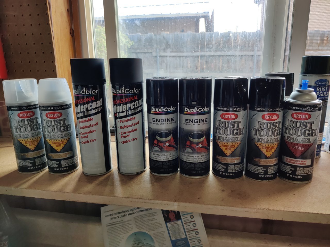

    As for paint I knocked all the rust scale off using everything I could from a flat head screw driver to a grinding wheel and some EvapoRust to soak bolts and smaller pieces in.
    I got everything I needed from my local O'Reillys. I used Krylon Rust Tough primer and then Krylon Rust Tough paint. I also added a coat of dupli-color pro grade undercoating. (the pro grade goes on and dries black non pro grade seems to remain a brown color)
    Eastwood makes a decent spray (not pictured) that has a tube for getting into the hard to reach areas, might be worth looking at.
    If you're going to take the bed off I'd recommend removing the frame cross member that holds the spare tire. It's a lot easier to clean and paint off the vehicle.
