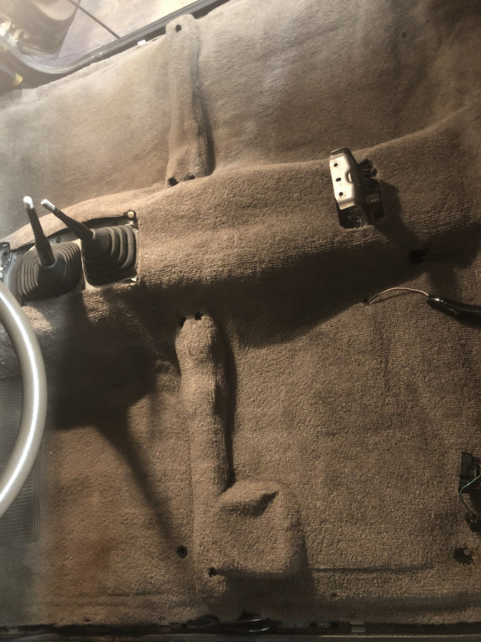

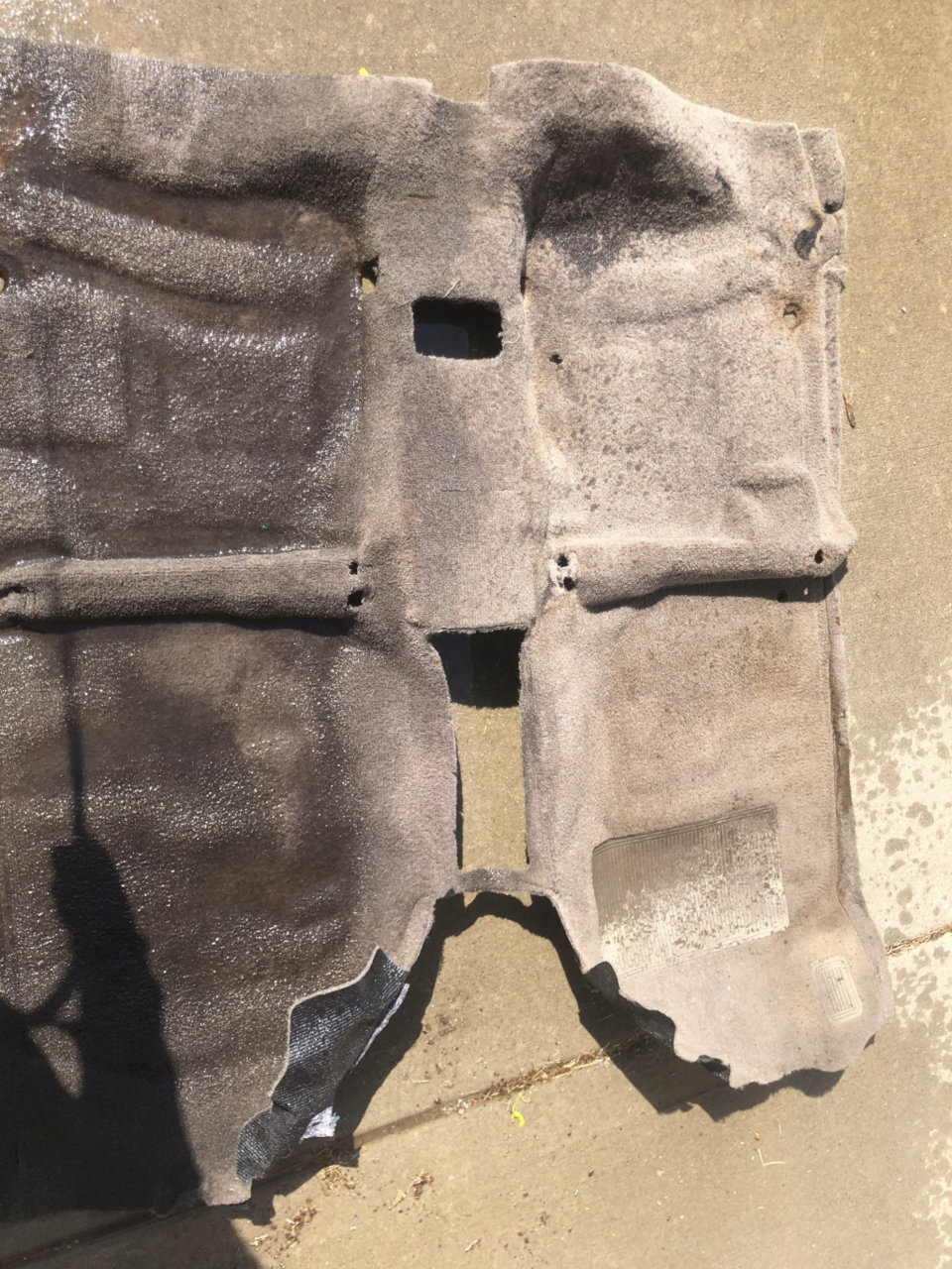

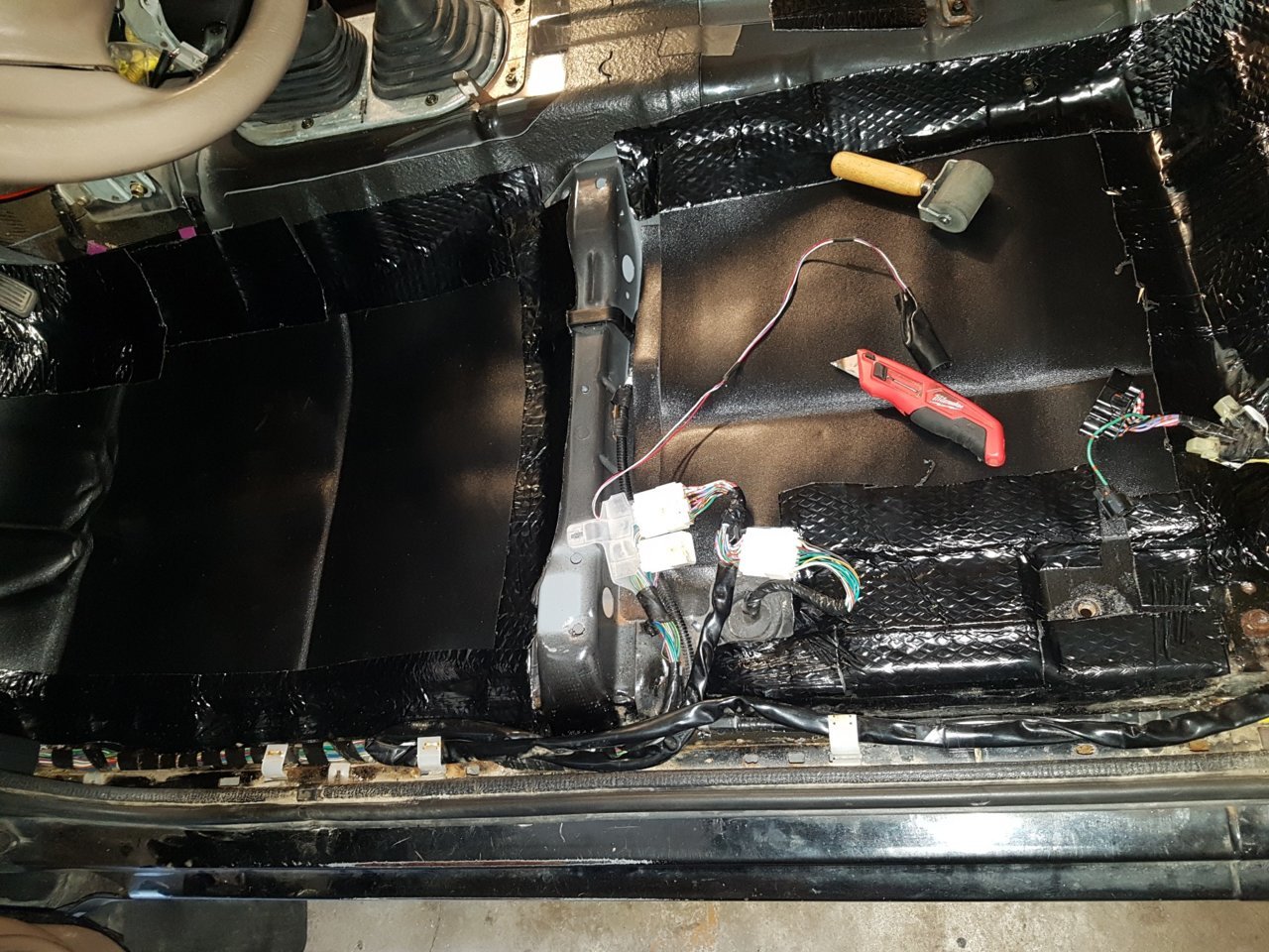

    So I started out installing some seat jackers.
    Then one of the bolts broke off on the front seat. I put a double nut on the back side, and that snapped the bolt, again, on the other side. So the next thing was, to weld on a new head and just turn it out, which meant pulling the carpet.
    And so while I had the carpet out, I cleaned it, and so while that was out, I changed manual tranny gear oil, and transfer case oil. Then I installed sound deadening :laughing:
    Then I didn't install the seat jackers. Productive, I guess? :laughing:
    Anywhere, here's pics:

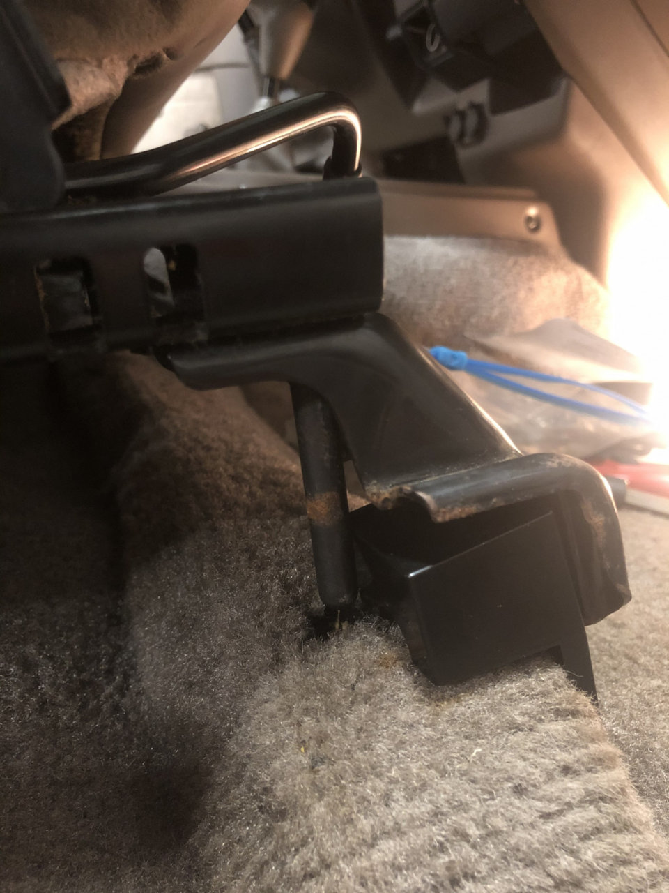

    And this is why i didn't install the seat jackers - I don't like how this giant pin gets pulled out of the floor. It seems like its there for a reason. So I might have to circle back to that:

    I’m pretty sure it’s just an assembly guide, makes it easier at the factory to align the seats and get the bolts started.
    As far as the simple upgrade that snowballed into a much larger project, been there done that, lol!..

    Hmmm thats a fair point. Something to think about.

    @0xDEADBEEF
    I'm sure the carpet looks and smells better. Did you notice much of a difference in sound and how's the new chair angle?
    I also thought those pins were just guides for installation.

    I haven't gotten around to doing the seat jackers yet. The more I think about it, the more I think they are just guides. Those big boltsl at the back would be what holds it all together in a crash. If I have time I'll get them done this morning, but I'm also going kayaking today so I gotta get that all sorted out first.
    I think road noise is reduced, but I didn't take any measurements. Still can hear plenty engine noise. I've got about 3 hours to drive today so maybe I'll have a better feel for it tonight.
    And yeah its always that one bolt that turns something small into something huge :laughing: I ended up drilling the stupid thing out and then using the die grinder to erase it from existence. There's a new bolt there now.

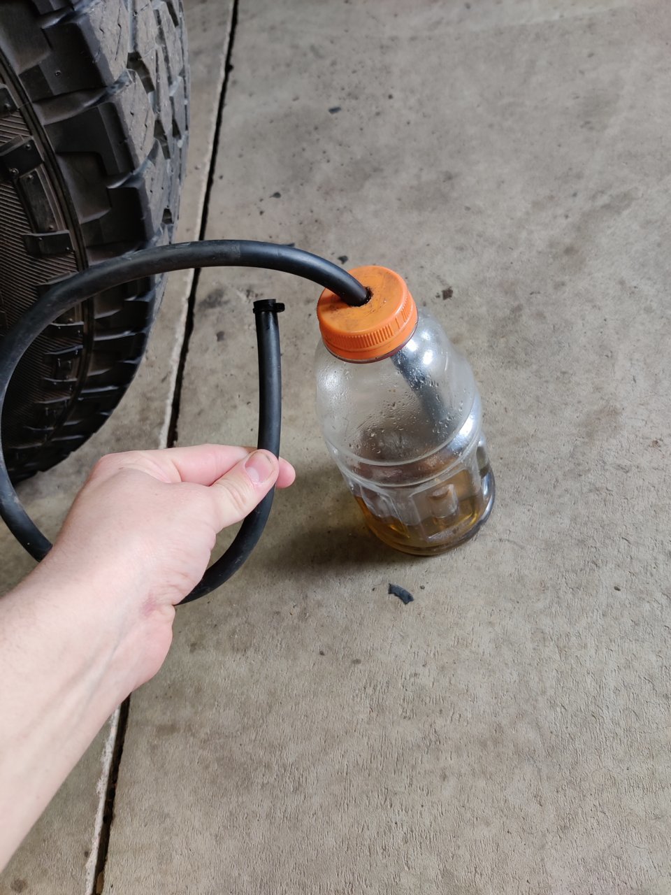

    32oz Gatorade bottle and some tubing is my go to brake bleeder method. Chris fix on YouTube has a pretty good video on how to make one and another video detailing how to use it. IMG_20210425_114844.jpg
    Clear hose is recommended but this is what I had on hand

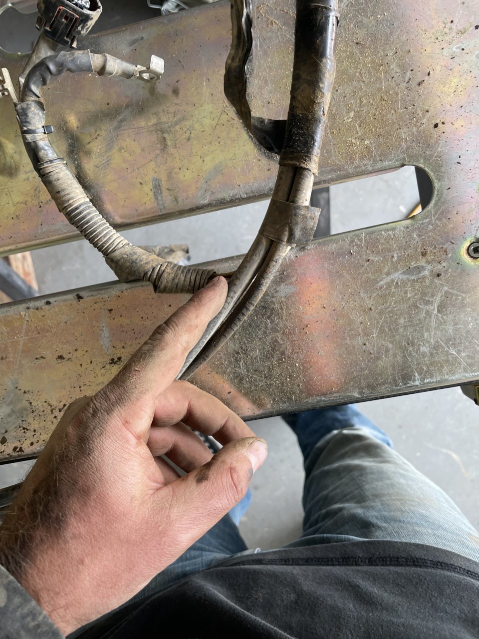

    Starting the big 3 upgrade, as my negative terms I am broke yesterday. Y’all replace the starter wire? Looks like 2 gauge already? 4C5335AD-C590-40EC-AAFE-821B39C3E443.jpg
