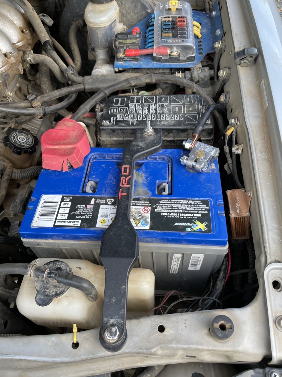

    Maybe 3’ of red 3’ of black. Still want to do the engine block to firewall tho so I’m not sure what that will be. I ordered 10’ of each, and I’ll be giving to a buddy to do his big 3.

    What gauge of wire did you go with? And you've got the V6 correct?

    2gauge, and yes V6 auto.
    10 gauge from battery - to the fender

    Ive got the 4 banger so my lengths are different, but I got a couple guys wanting me to make em for their v6s... You said about 3 feet, if I made em exactly 3 would it be too long?

    Probably, just measured red positive I used 3’-2” from alt to fuse box and black negative I used 2’-7” and like 6” of 10 gauge

    wait you only have 1 ground right now? Going to the fender? You should really run a ground to the block, the stock location is just below the oil filter. Frame is a good one as well, can do it right below the battery.

    Looks like I need to look into this big 3. The ground going to my fender looks pretty freaking sad. Is there a thread on this big 3 that I should have already read by now?

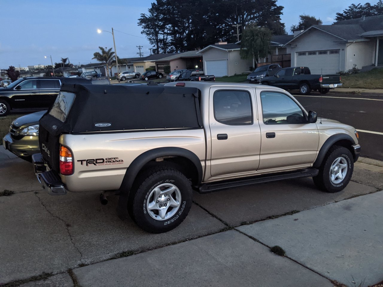

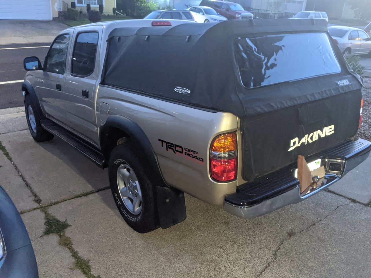

    ... Fitted a CL Softopper score! Came off a 2010, so I had to adjust it a touch, and I bought a set of generic shell clamps to convert the "utility track" clamps to "standard clamps". 4 months old and a bit under half price due to a separating back window (upper left corner). No problem for me, I would have replaced the rear with tinted as my primary anyway, and some well placed black duct tape will make this plenty serviceable in the mean time as I wait through the 10+ day line at softopper (good for them!)
    *Just noticed I only buttoned the corners of the sides, believe me it's lovely all buttoned up :)

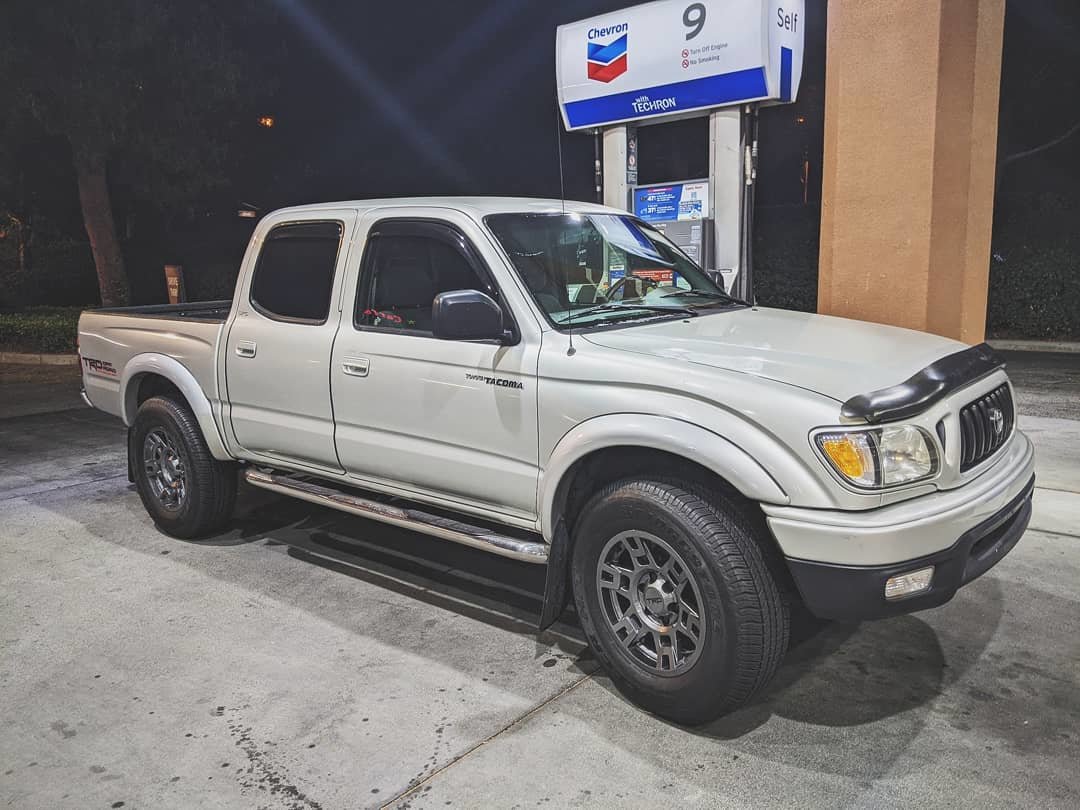

    Decided to hold off on a camper shell, cant decide if I want a hard top or soft top, and I am quite annoyed at how hard it is and expensive to source parts for camper shells, seems like a racket.
    Spent the money instead on RIMS :yay:

    I want those for my 4runner!

    The matte colored gunmetal ones are pretty sweet. I was originally gonna get those but the gloss seemed like a better match for a 1st gen. The rim options on the latest gen 4runner are all pretty dope though, even the non TRD ones like the offroad wheels

    I ran that ground to the block as well. Definitely wouldn’t have left that out.
