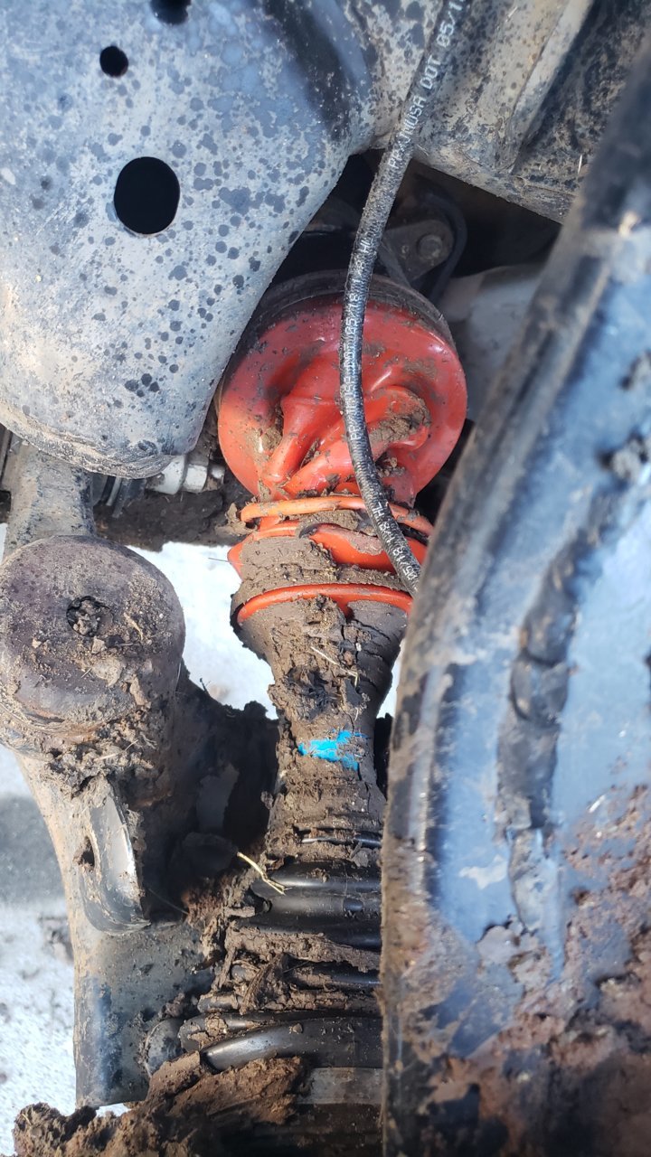

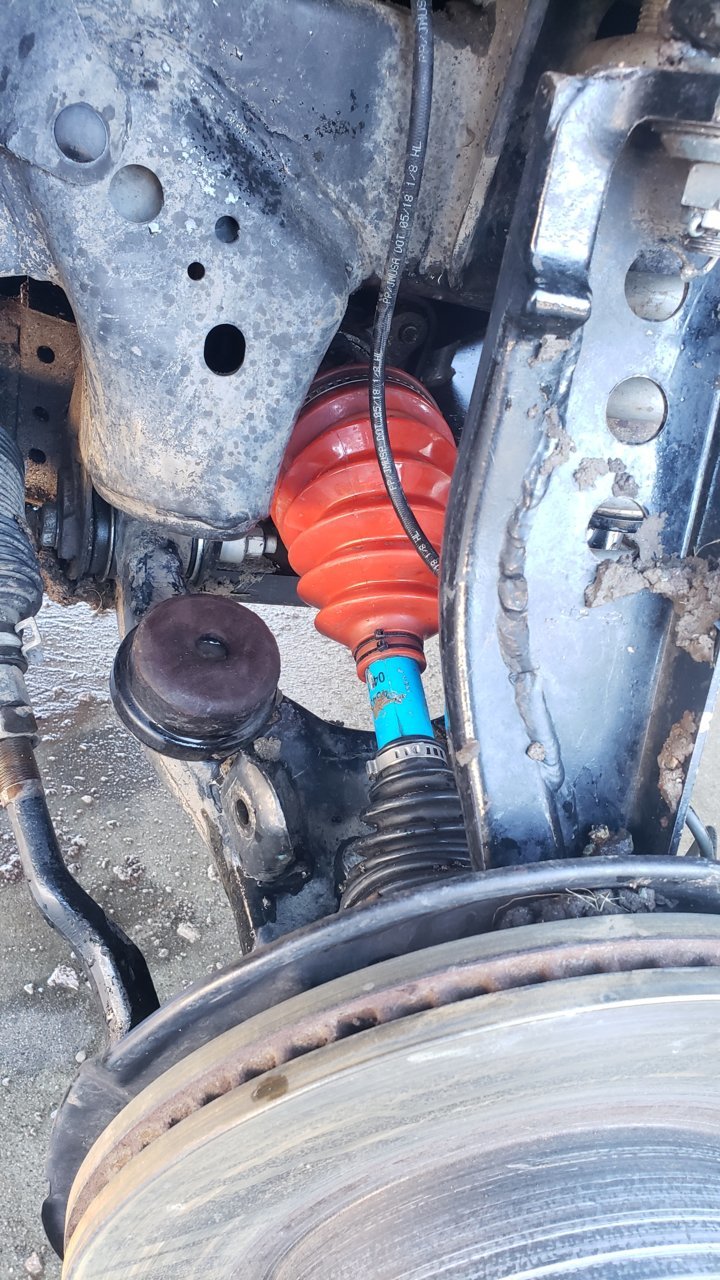

    I run the ORS red inners. With the boot slide mod. Have had absolutely no problems with them. In fact, we did a recovery run in some STUPID sticky mud, where the mud was stuck to, and in everything... did this to my CVs.
    I untwisted them, and they have still been fine ever since (two years ago)
    The All Pro outers have been good as well. The only reason I had to recently re-boot was my son was helping me with the front shocks and got a little aggressive... the lower shock bolt tore one of the outer boots.
    I would HIGHLY recommend the ORS red inner boots.

    Yeah i have been partial to the SDHQ inners but might give these a shot. @Uphillshunter how do those zip ties hold up? And when you say boot slide mod, you mean you ave a cut off inner boot end c clipped in there right?

    The zip ties actually held up better than I thought they would. They weren't ideal, but when I originally rebooted those CVs it was all I had to finish and get them remounted. They lasted over 2 years... with being twisted to shit in that mud.
    I cut them off when I rebooted a couple weeks ago, and they were still holding strong. But this time I had enough proper CV clamps that I used them instead.
    Yes I have a section of old CV boot clipped in there.
