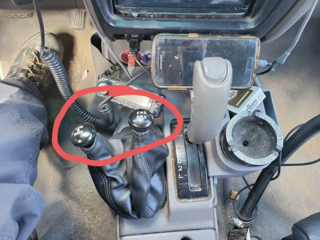

  9. Apr 26, 2021 at 1:54 PM
    vonellis
    vonellis Well-Known Member
    Mar 19, 2016
    #181748
    1,285
    04 DLBC x4 S/C 97 2X 04 DBLC 4X S/C
    Some and some more
    Where did ya get this thingy?
