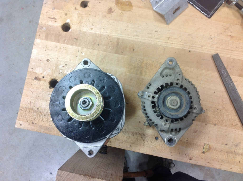

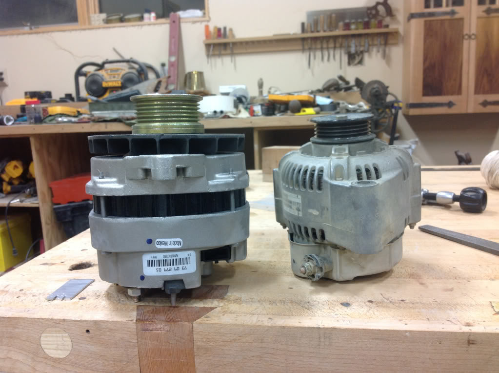

    Also of note, you can get two different pulley sizes, a 51mm and a 52mm, the 52 naturally puts out more.
    Not sure how you've missed this in our other discussions. It's why Mike and I have one.
    That said, considering how much you're driving, the 105 is probably fine. The CS144's party trick really comes in handy during winching if anything.
    But, it is cheaper, easily replaced at literally any parts store pretty much, and puts out more total amps and much higher at idle....so...yeah.
    All you need is a spacer which is easily found at a hardware store.
    I mean...it makes sense, look at the size difference:
    install with spacer here.
    Oh you also can just buy a plug n play pig tail to convert it right to the toyota harness for like 12 bucks or something instead of hacking together something like what I did. That wasn't an option back in the day haha
