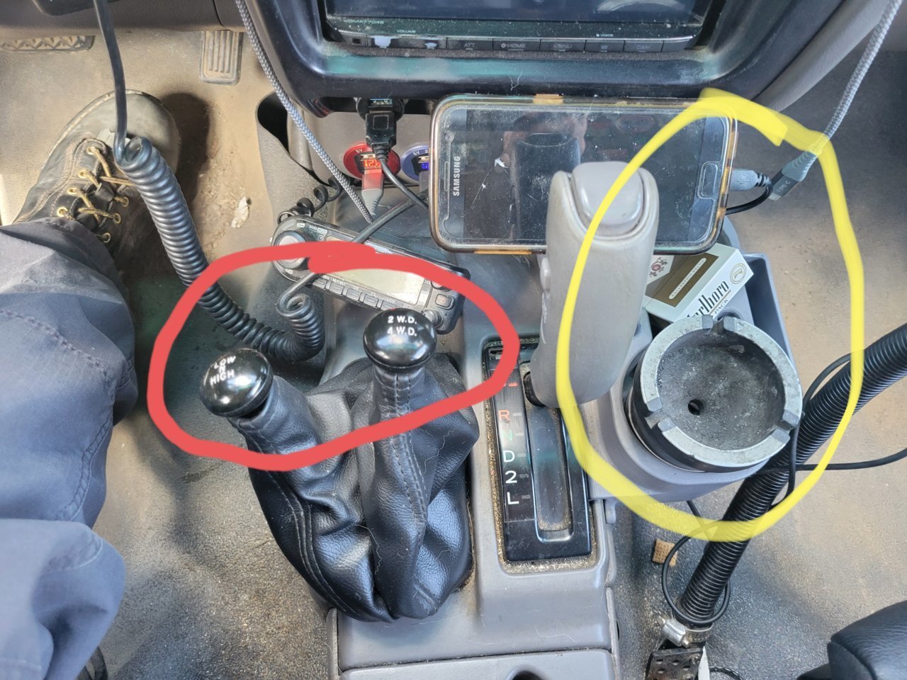

    I ordered it off someone on here... I think... I can't remember.
    I think @Fernando knows who does those.

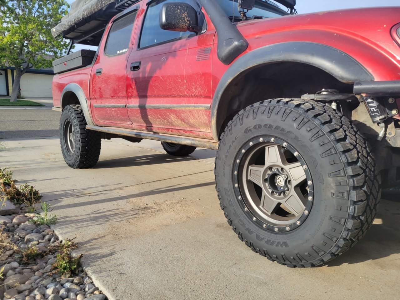

    All this talk about charging and wires... forgot to add that I got some new shoes yesterday.

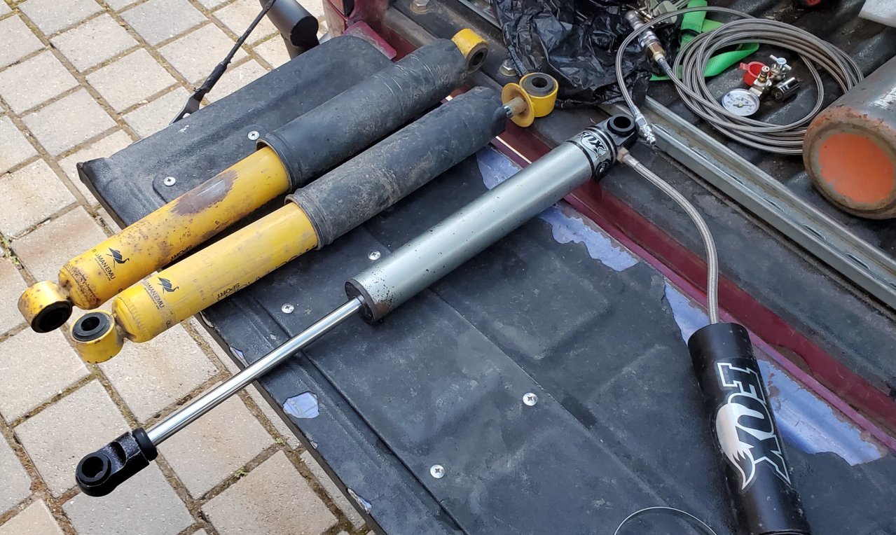

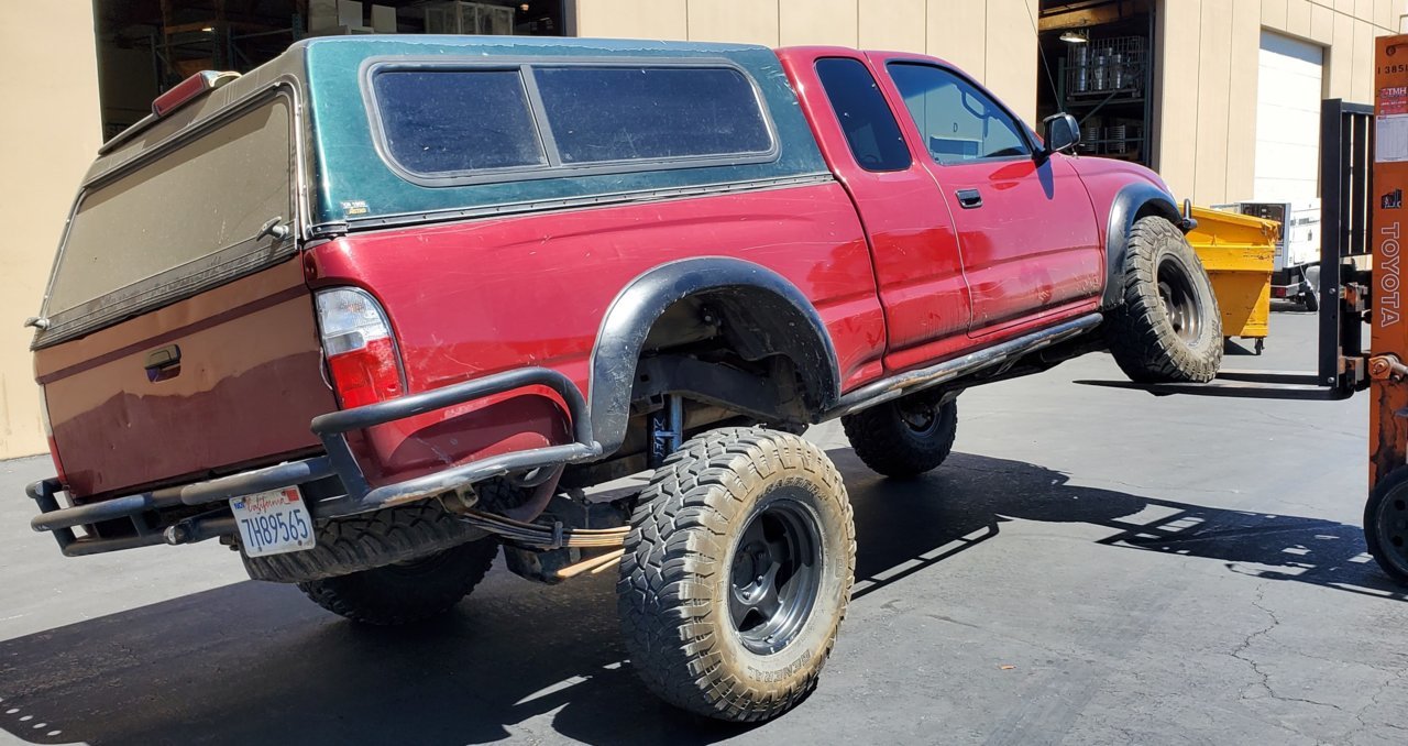

    Got some universal 10" stroke fox 2.0's to work in the rear
    Got a bunch more down travel out of the dakars as the nitrochargers were acting as limiting straps before.

    Stock location?

    Yup.
    Didn't wanna do the relocation and give up the ability to have my spare under the bed quite yet.
    This way I can still get full travel out of my leafs

    Are you bottoming out on uptravel?

    I like it, I cant fit a tire under there anyway so Im just shooting for a relocation. Do you have upgraded bumps aswell? Or are you not worried about bottoming out the shock. (I dont recall what the stock bottom out is on our trucks)

    No I'm not. I'm about a 1/2" away from the rubber shock shaft bump on the driver side on full stuff sitting on the bumpstop

    I feel that. I'm running 4.25in durobumps in the rear and hit those before I bottom out the shock. I put those in there beforehand to help prevent the leafs from going too negative. Check my build thread for more pics and measurements

    Shit. I forgot who sells them. Im sure another member can chime in? The extra cup holders?
