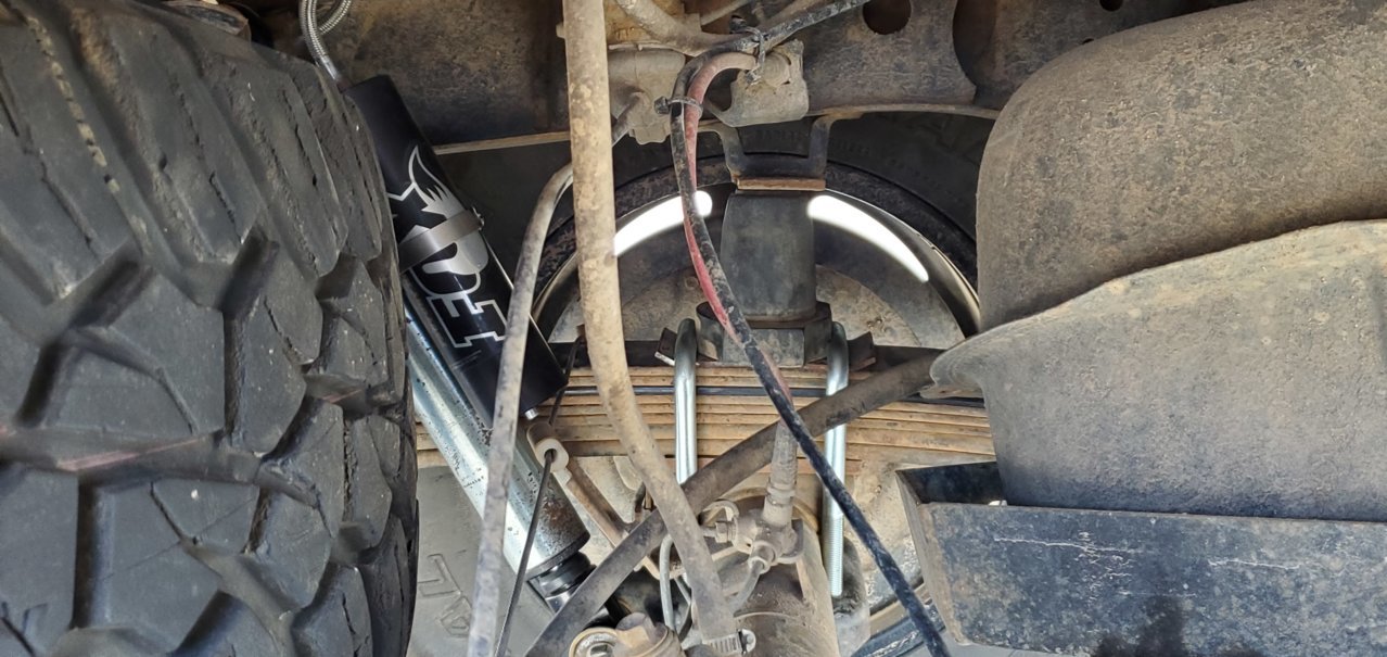

    How much do the duro bumps collapse? Might be close to bottoming. Or is that 1/2” at fully collapsed bumps.

    That was with basically only two tires on the ground and it was squished pretty good so I'm not too concerned about it bottoming out before the bumpstop. If it does, there is a rubber shaft bump on the shock to help with that last little bit. It is close though. Just over a 1/2" left if the rubber shock shaft bump wasn't there

    There will be more travel used vertically (like a hard bottom out) vs flexed. You'll probably be fine, but at the very least you could measure shock shaft showing at ride height vs. the distance between your frame and roughly how far down your bump you think it will compress.

    Yes you are right. I already took those measurements and they are within 1/2" of eachother on the driver side so I should be good there.
    Worst case I add a small spacer to the strike pad or under the bump to increase it's height.
