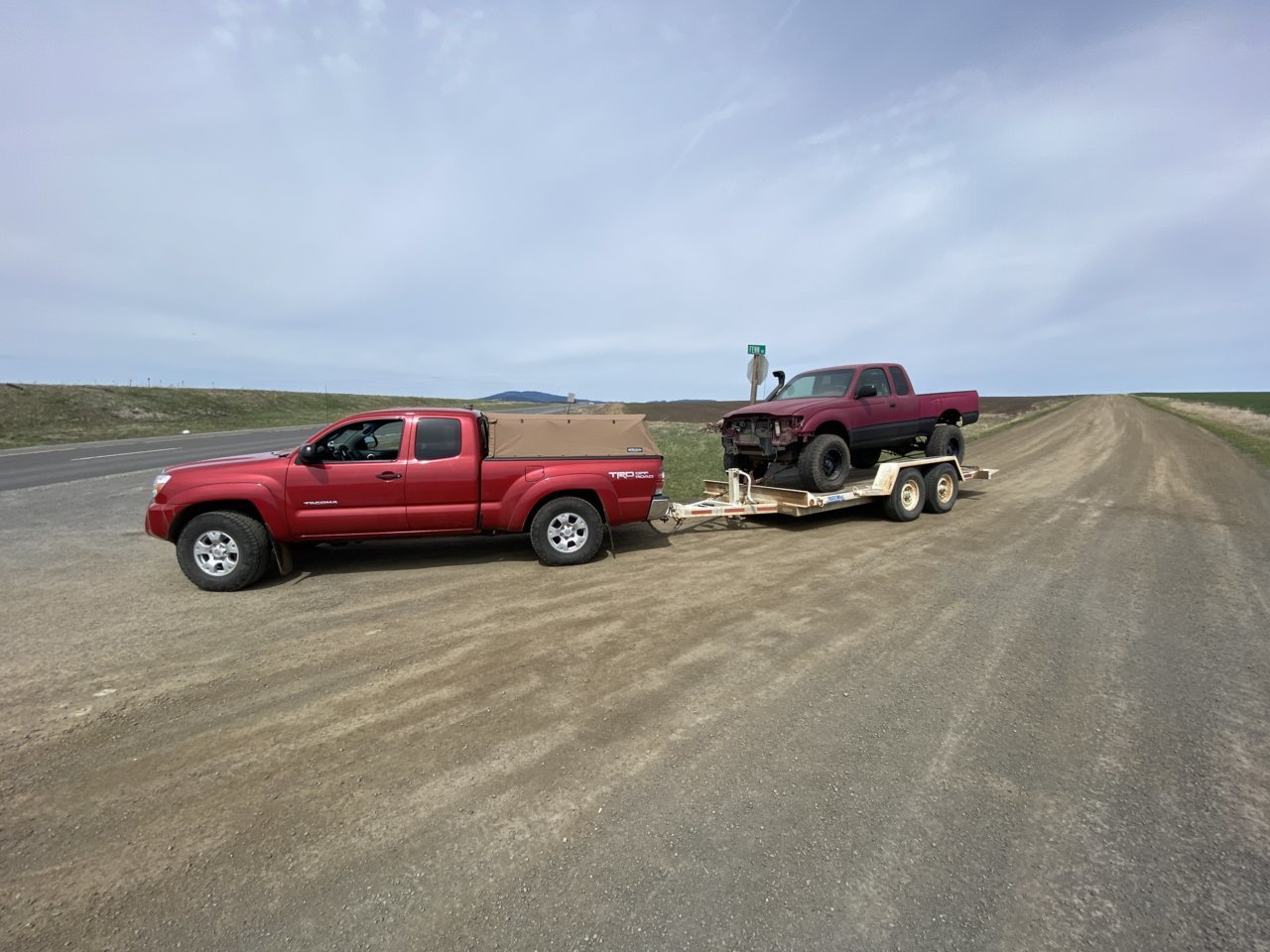

    Got her all moved down to the new place today. Took my enclosed trailer up to load the parts and tools I have lying around up there and borrowed a tilt deck to bring her home.B1985DD2-0A7F-4573-BE22-69661B32396B.jpg0A7B8AC1-F58B-497F-AF88-6FD1B56ADAB6.jpggot the bird shit pressure washed off.5CB7F469-C39B-4D3F-9925-2410A7CF8CCC.jpgbed will be coming back off Monday so I can start wire wheeling the frame. Feel like I starting to get close!
