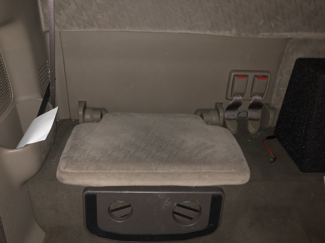

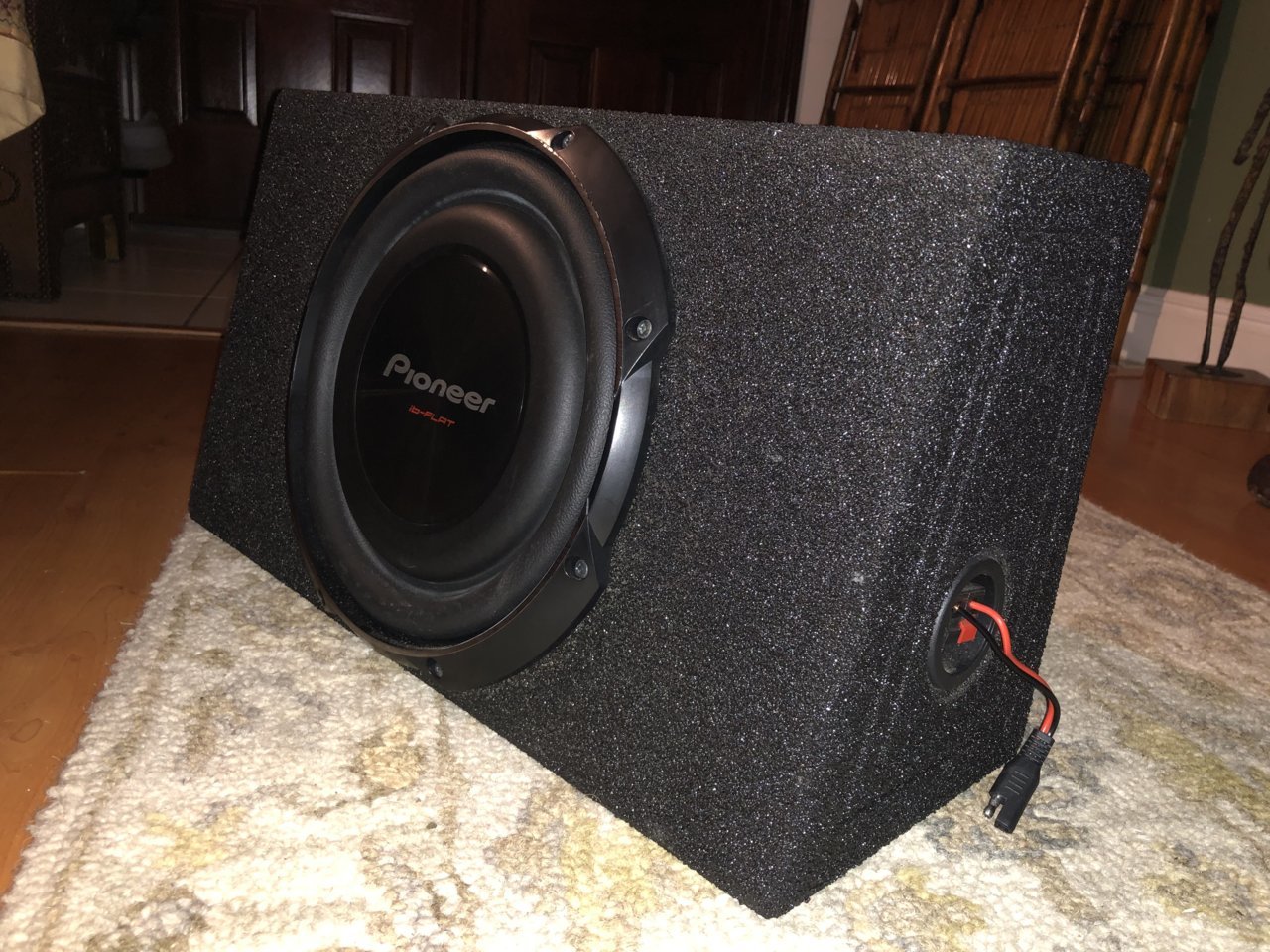

    Added quick disconnects to the subs incase someone actually has to sit back there

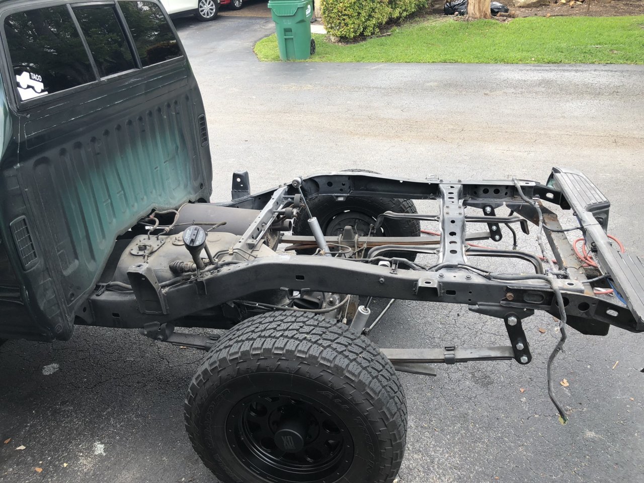

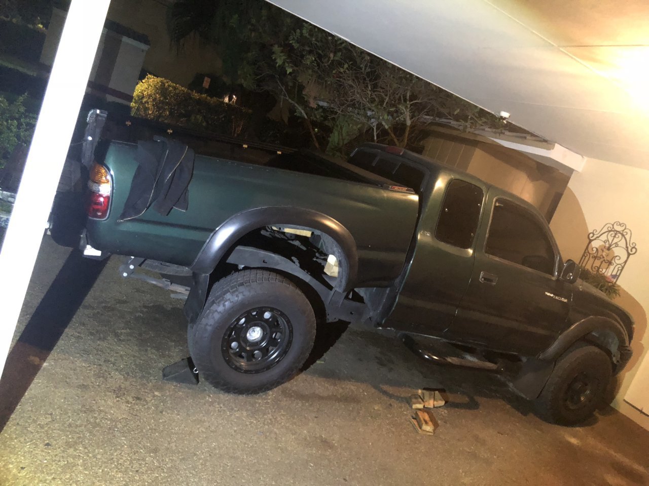

    The perks of these Extra cab models - you can access the fuel pump by lifting the bed... was able to get enough clearance to swap the pump out with some blocks of wood wedged between the bed and frame #shadetreemademe
