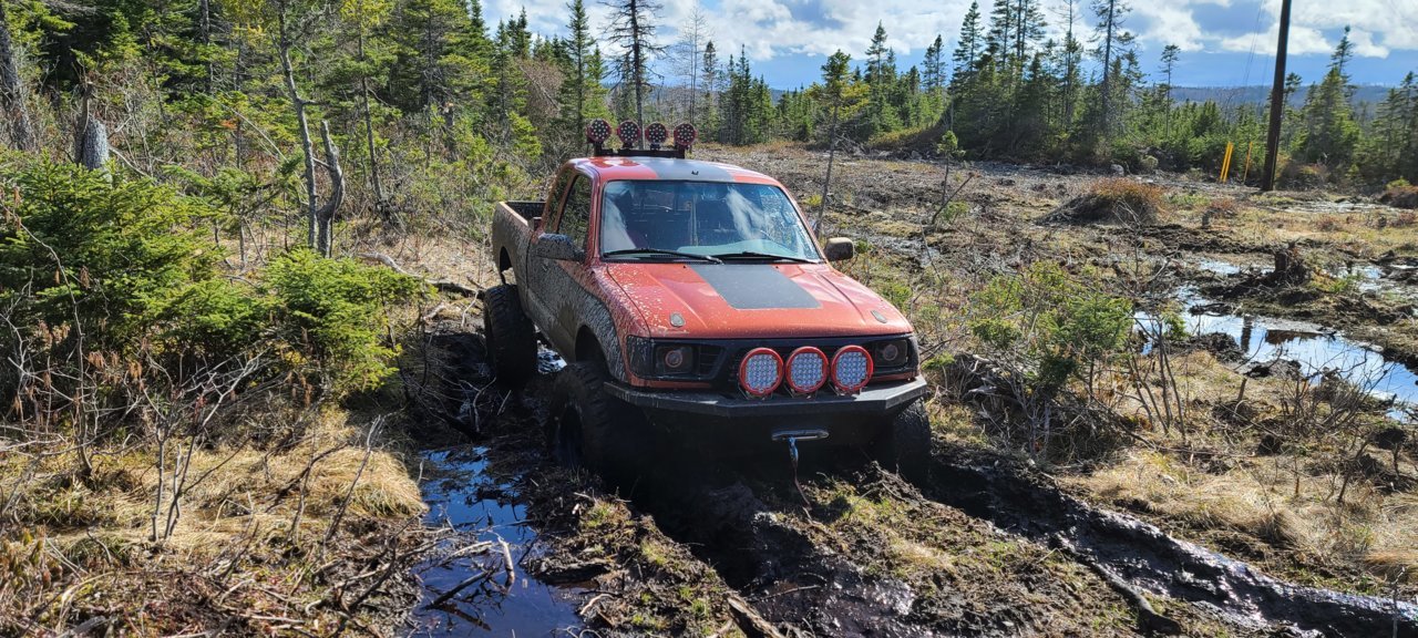

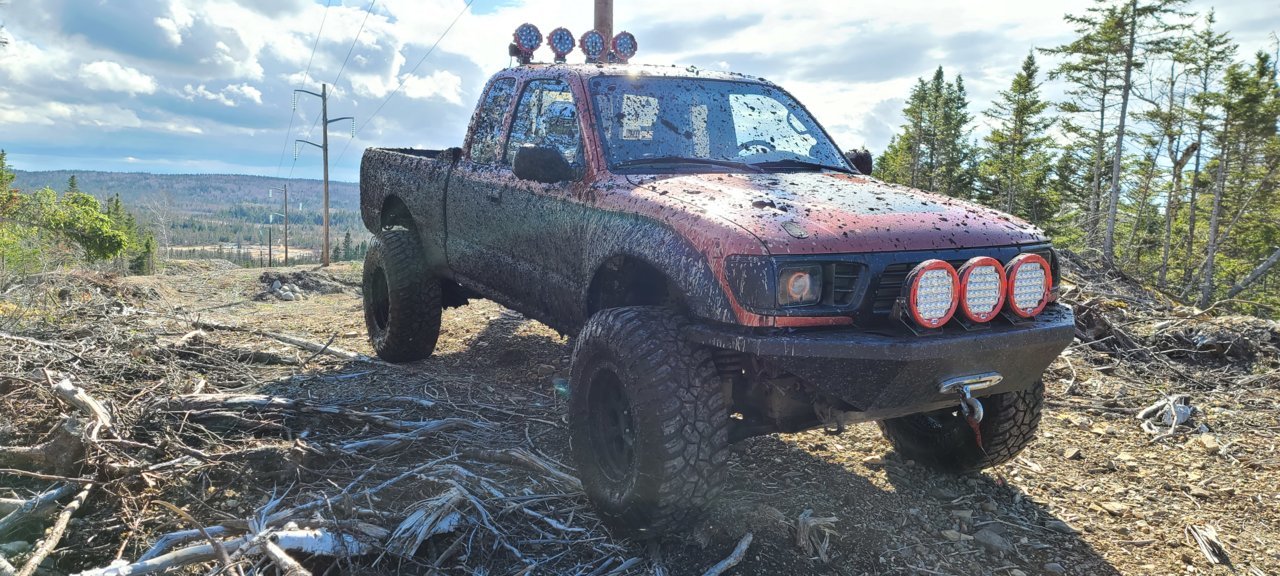

    yesterdays pole line run

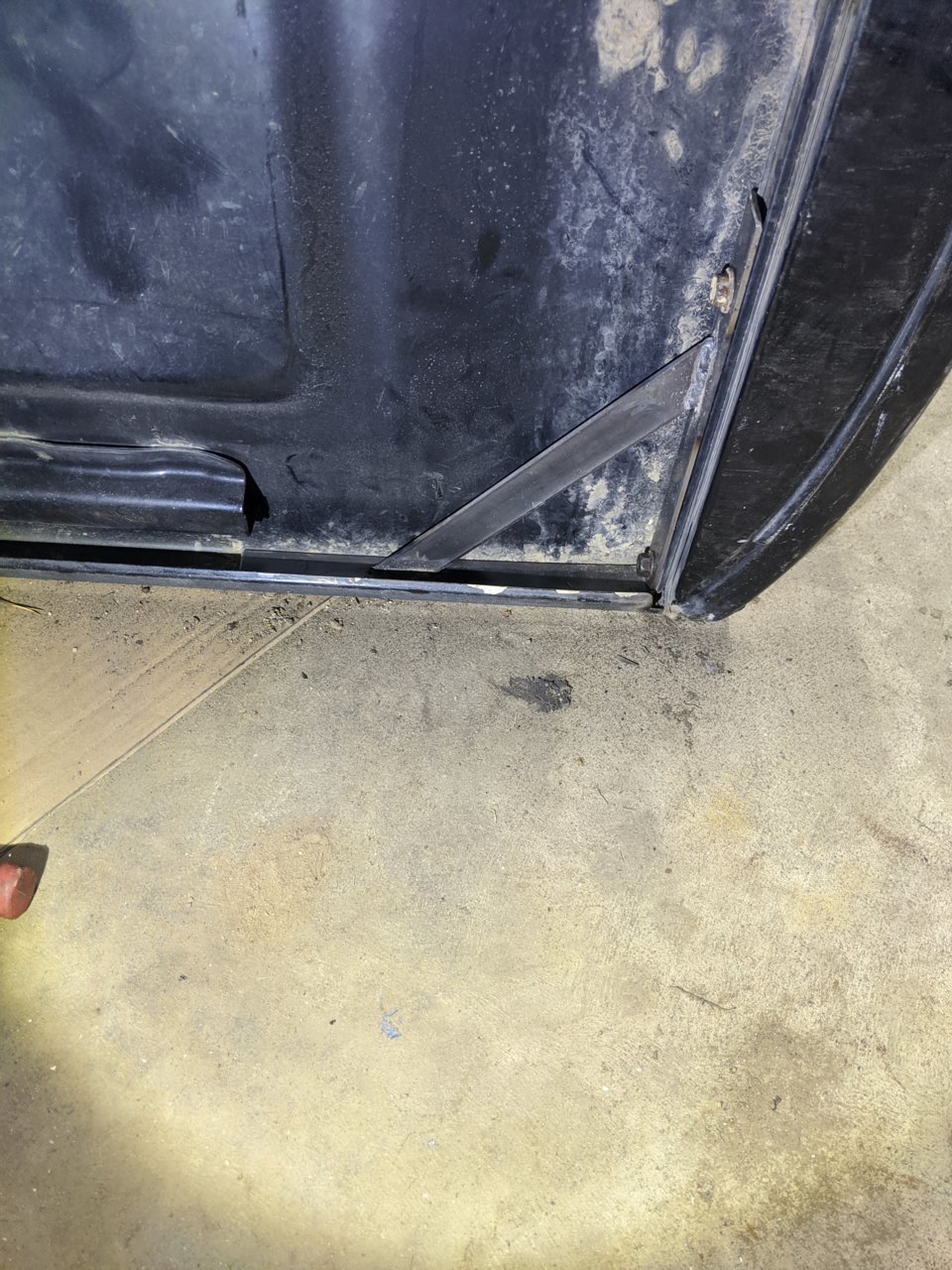

    I figured I'd have to pull the bed to do that.
    What size rivets did you use for the top side?

    Don't recall exactly. Guessing 3/16" stainless. Length would depend on how thick of steel you use for the brackets.
    No reason you couldn't use bolts either, just wanted something as low profile as possible to work with my GFC & seal.

    Yea I can't really do bolts for the sake of my topper and seal as well.
    I'll look into some appropriate rivets for that part. :thumbsup:

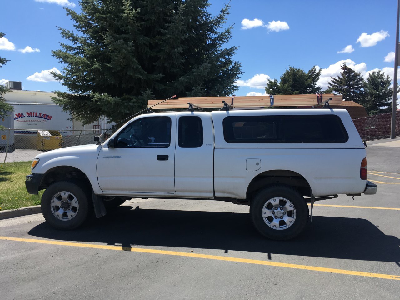

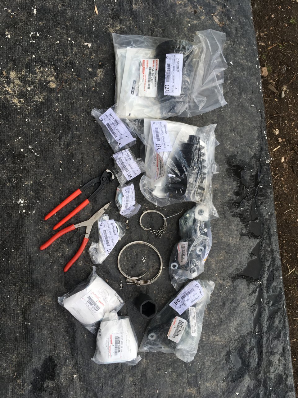

    Hauling lumber and watching parts stack up! Still waiting on shock absorbers to arrive. Stoked to do the steering guide modification to the newer style. I love making vehicles handle better and can’t wait to start installing this treasure trove of parts and more!

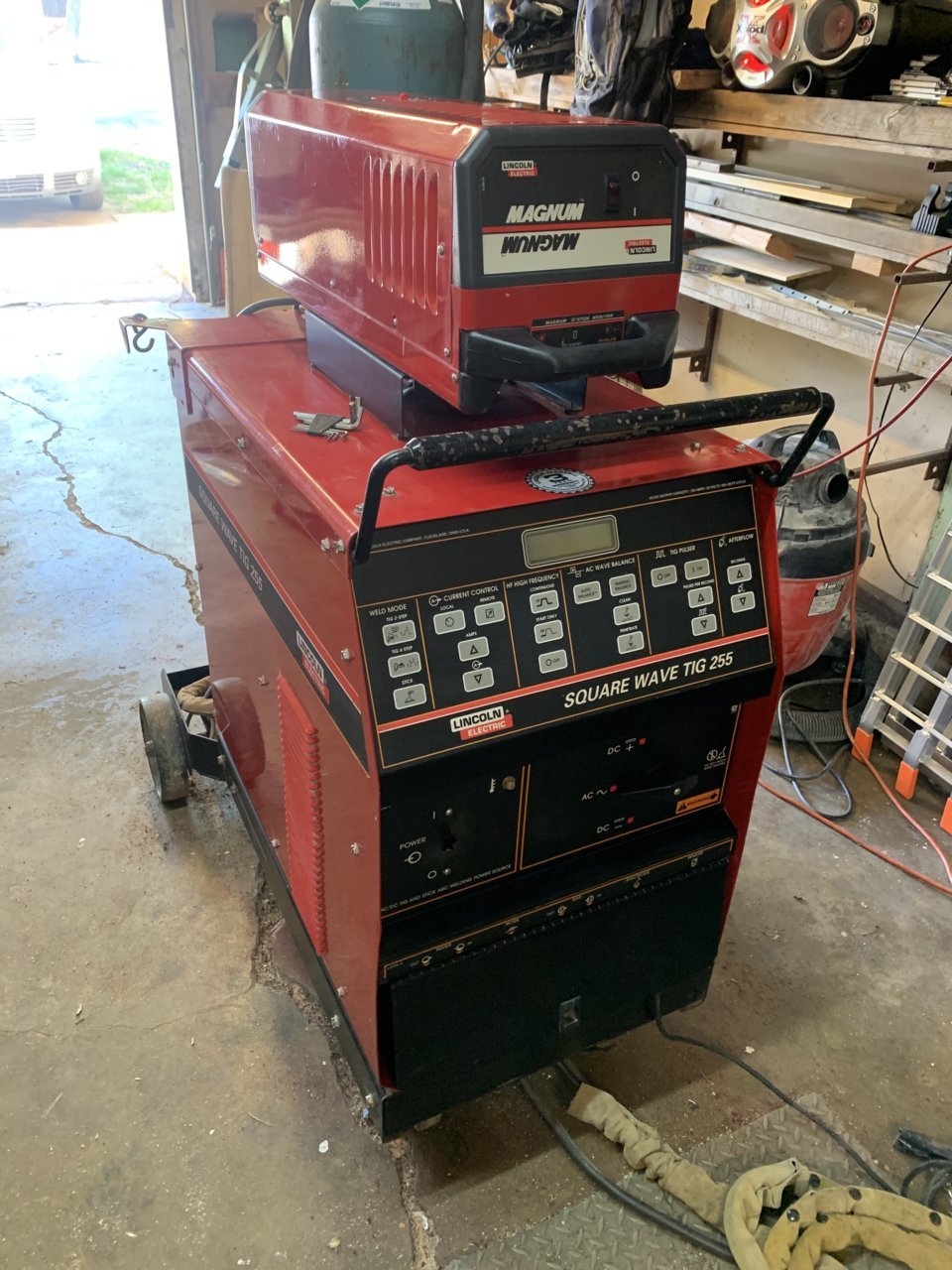

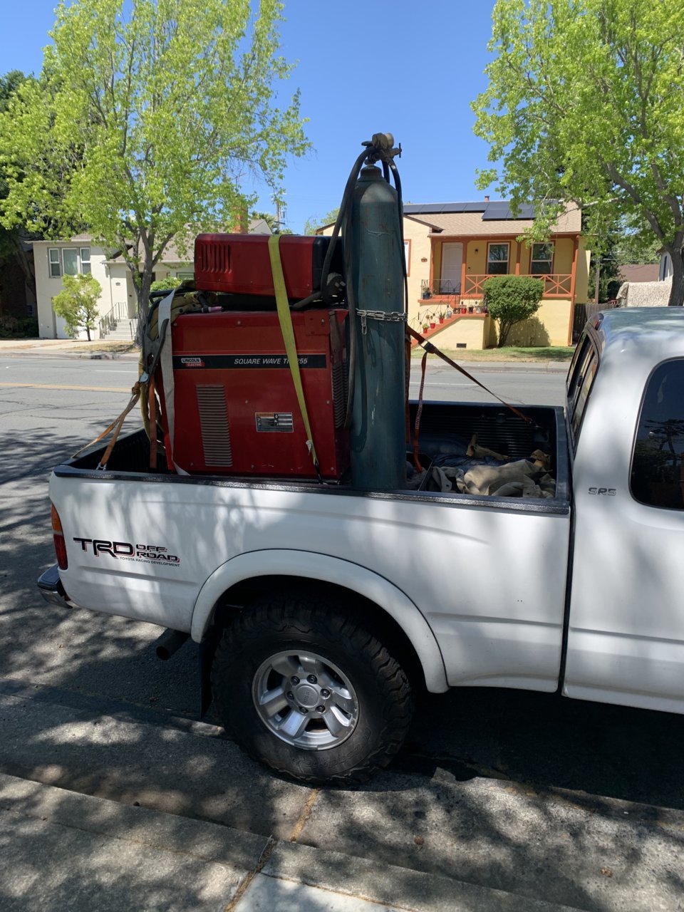

    What I “picked up with my Tacoma today “. Finally talked my dad out of this TIG, been working on em for years and he finally admitted he doesn’t need it any more. Comes with free lessons from him as well. I’ve been welding MIG for over 30 years but always wanted to learn TIGFE8DF1B7-D055-43DF-BC8F-203C7E9C5699.jpg433F021E-BF91-432C-ABAD-58AB94715FBF.jpg

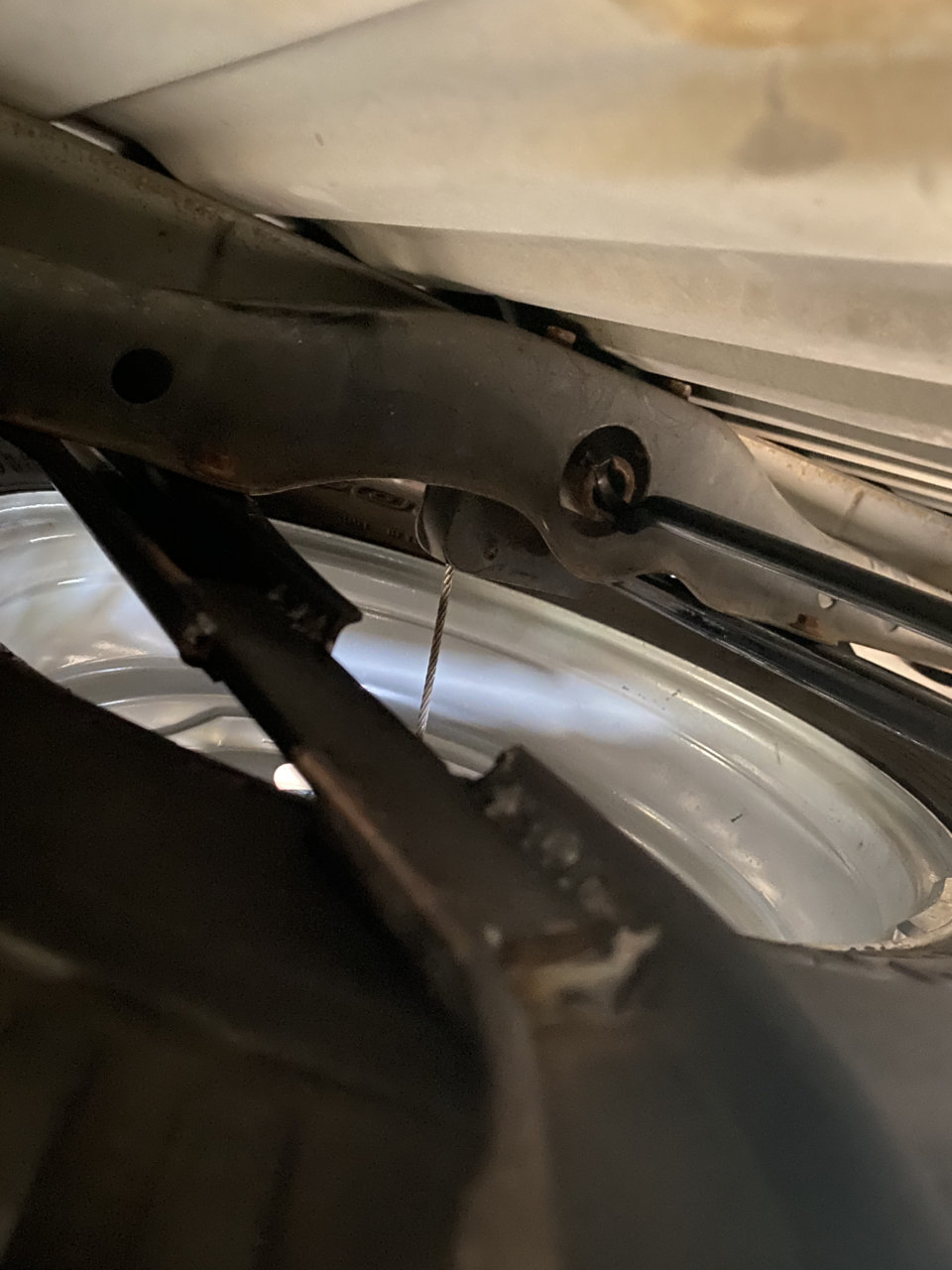

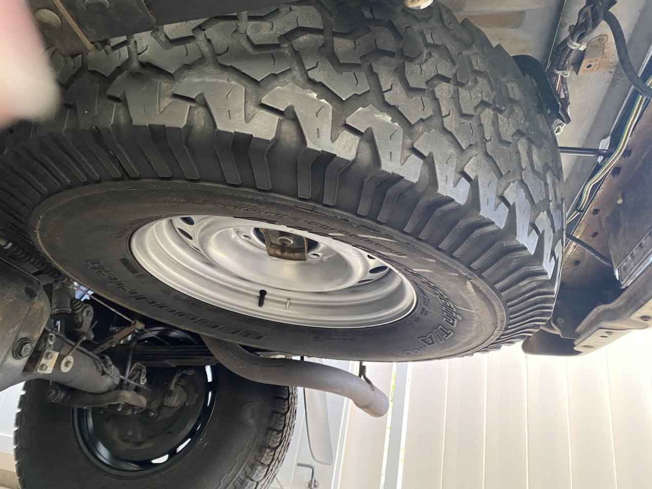

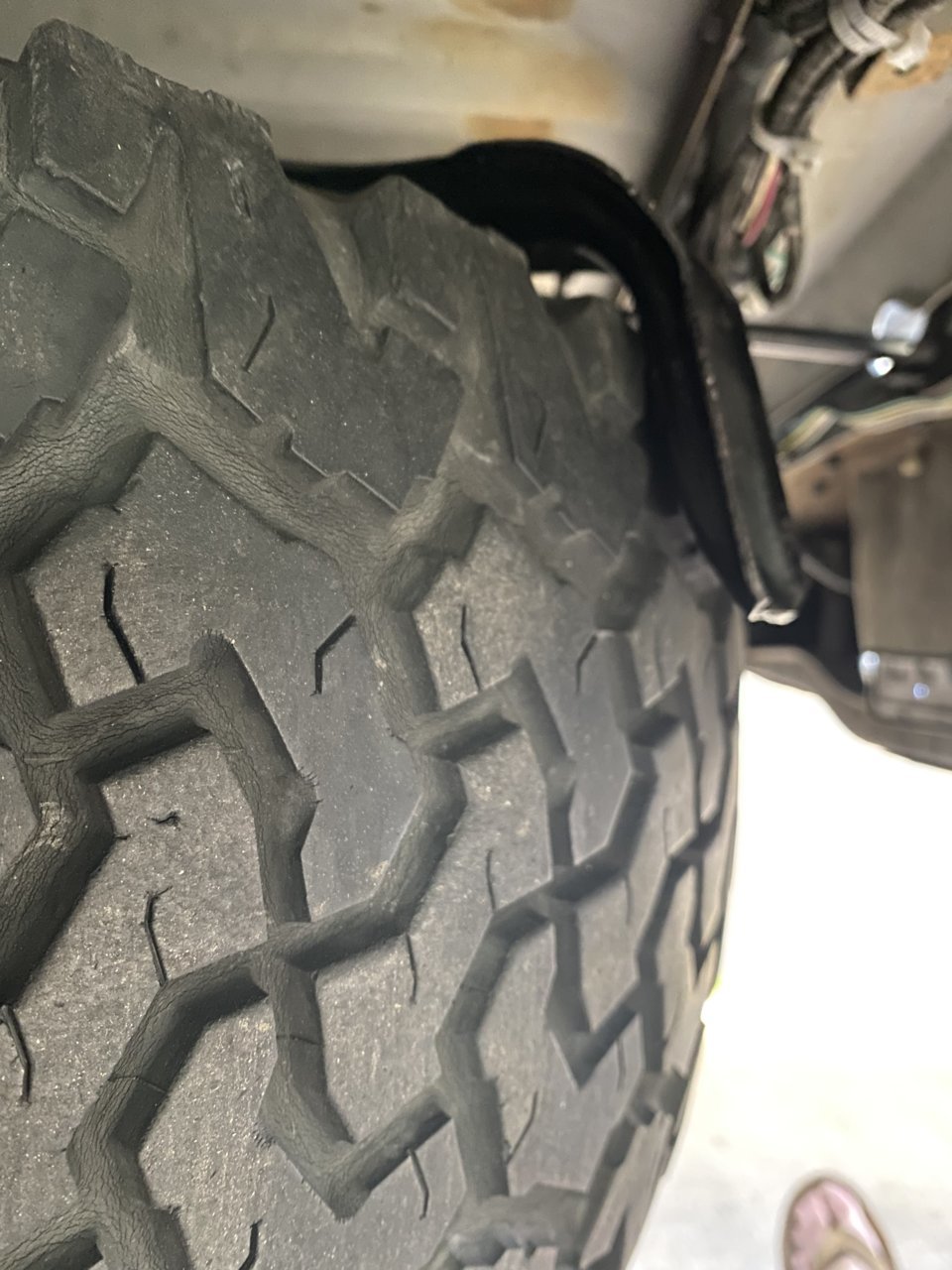

    515CB5F3-E621-452B-AC8C-8774FEB27434.jpg A73E69B4-39A1-48CE-BB6F-D05FAED03CC9.jpg FCAA83F5-DE70-4329-815A-B9C685E76861.jpg Got a 33 for a spare tire now. Didn’t want to bend the brackets to fit so I had them extended 2.5 inches to the rear and welded on. Clears exhaust and brake lines. Bad pics but you get the idea

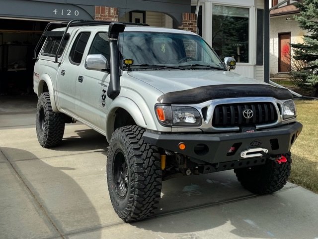

    Was busy today.. Dorkel is in, rtt rack over the canopy. Rago bed stiffeners and ditch light brackets. Some cheapo Colight ambers. I’ve given up spending big cash on lights just to have them crack from rocks. Tomorrow tackling the Cats, O2 sensor, catback. And if the wife feels up to it, mount my rtt on this klunker haha.

    Did you up size the exhaust pipe?

    magnaflow is 2.5" piping.

    How did you attach the top? Any reason for not connecting it to the other side?
    I didn't either tell i did solid motor/trans mounts and heard my bed and fenders vibrating. I'm almost scared to pull it and see what all is cracked.
