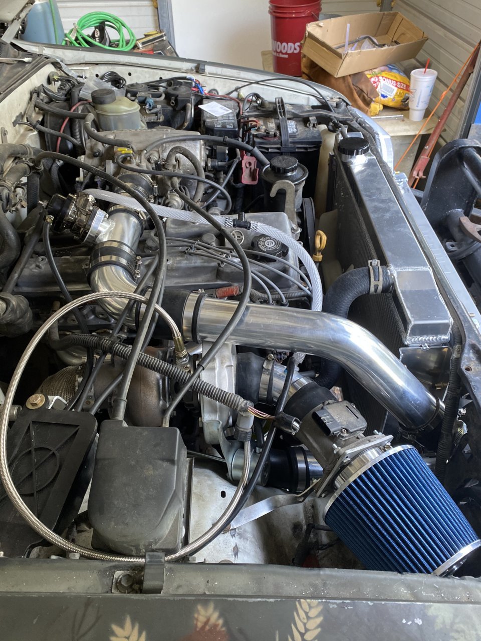

    Only this...

    Taken it for a drive yet?

    Yes... but I’m being cautious until I put a gauge in

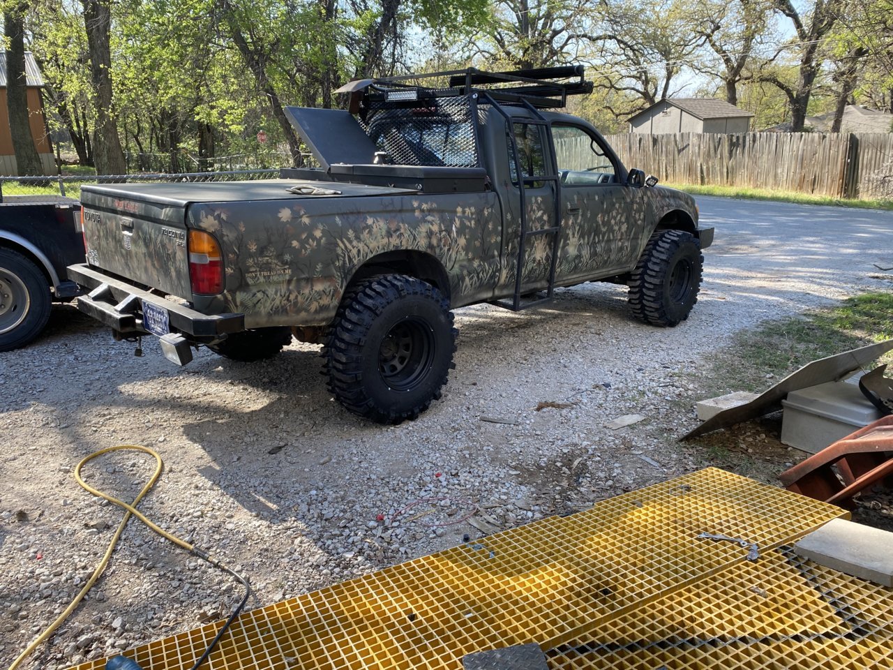

    Bed Liner and Bed Tool Box - nothing much...
    Niiiice - but I think it needs a .50 Cal mount somewhere in the back. That would make it perfect.

    Any stalling issues?

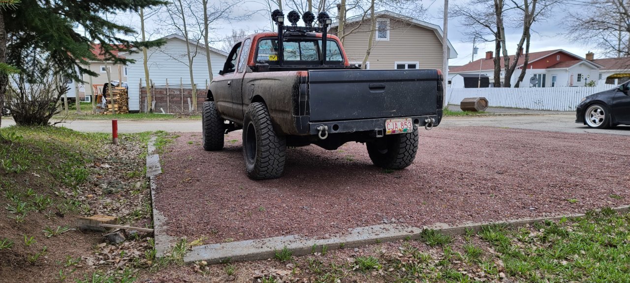

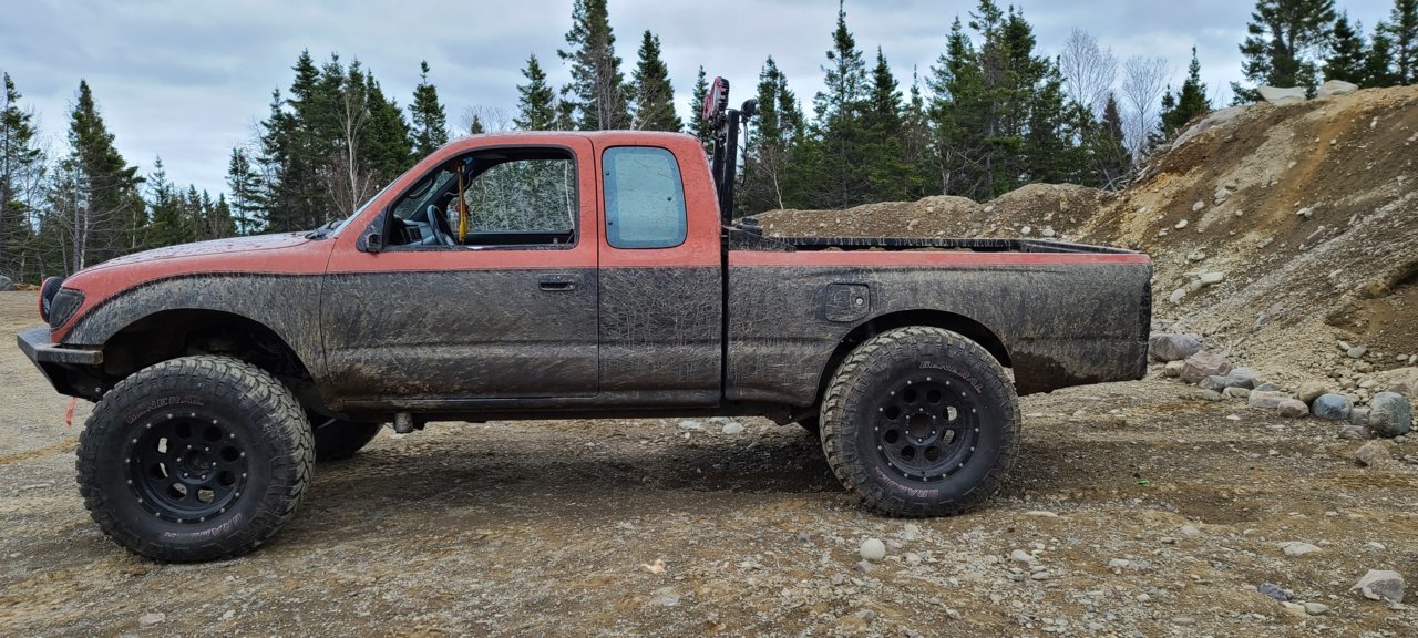

    joined the squat gang.

    A few... right now I have an idle that surges.

    Your stalling issue is probably attributed to where your blow off is in relation to the MAF. The ECU thinks its about to get x amount of air and then your throttle body closes and that x amount of air gets dumped to atmosphere. Meanwhile the ECU is still injecting the appropriate ratio of fuel to match x air. I used a hybrid recirculation valve, 75% gets fed back pre turbo, post MAF and the other 25% to atmosphere. 100% recirculated would cause to much turbulence and mess with the MAF because it is too close to the MAF.
