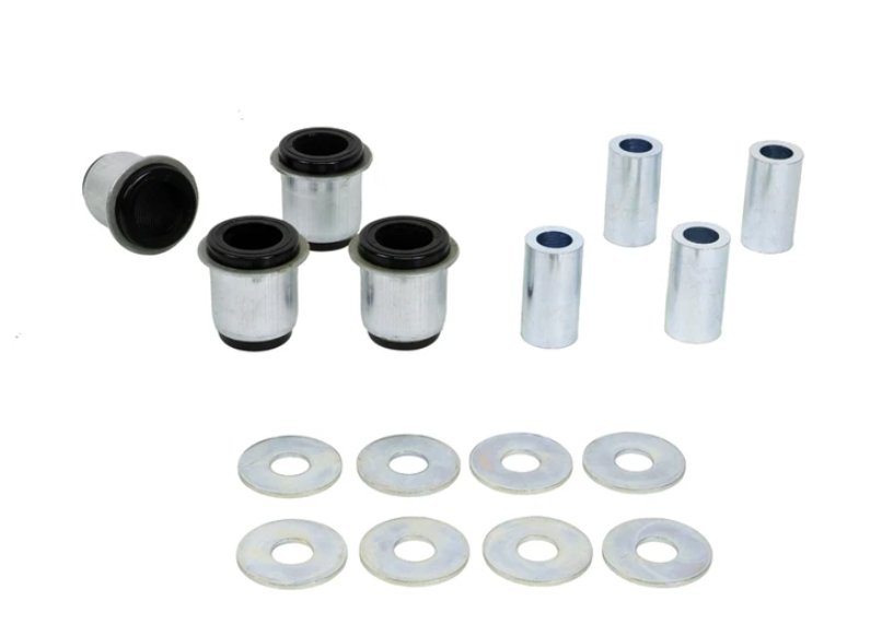

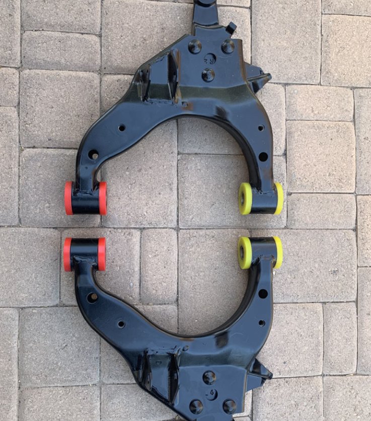

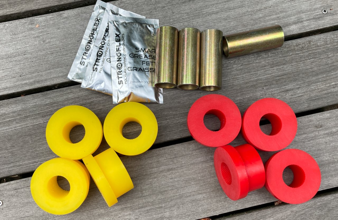

    OK, so in trying to make sure I'm ready to go for all my bushing installs, I'm looking at the Strongflex LCA bushings and wondering if I need to go source some large washers.
    What's in the Strongflex "box":
    What's in the Whiteline "box." (note the 8 washers) As I recall, these go on either side of the bushing, against the frame, to prevent the bushing from rubbing on the frame.
    Is this just a design difference from manufacturers, or an oversight from Strongflex?

    no washer. Goes right in the LCA mounts. Just like my Solo arms and MCM arms.

    turbodb[QUOTED] likes this.
  13. May 11, 2021 at 10:14 PM
    turbodb
    turbodb AdventureTaco
    Feb 9, 2016
    #177696
    8,539
    Dan
    PNW
    2000 Tacoma Xcab 4x4 SR5 V6 TRD
    AdventureTaco
  14. May 11, 2021 at 10:17 PM
    Blackdawg
    Blackdawg Dr. Frankenstein
    Dec 31, 2010
    #48500
    81,623
    Monte
    Wyoming/St. Louis
    The Trifecta of Taco's
    pretty much yes. Think about your leaf springs. No washers there either. The idea is that technically you don't want the bushing turning in the arm. You want the arm to pivot off the bolt inside the sleeve. So if the bushing is being squeezed between the mounts it's less likely to turn. You also don't want the arm to pivot with the bushings as the pivot.
    Now...that's idea. But also noisy. I still grease mine when they go it and if they move..they move. No biggie.

    This is the part I was wondering about. Good to know it's ok if there is some pivot of the bushing in the sleeve. Beats the hell out of squeaks.

    yeah i was less libral with it this last go on my solo arms...major regrets. Never again. Should have just done what I always do.

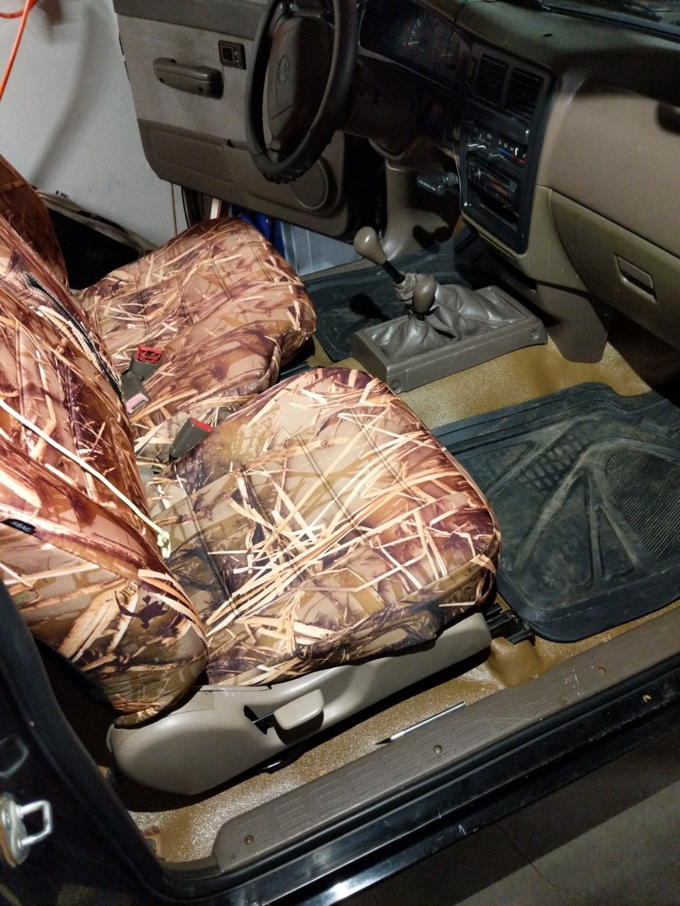

    Why vinyl over other materials? What are your first thoughts and impressions on it? I wonder how uncomfortable vinyl is on a hot day..

    I would make sure the inside surfaces of the frame mounts are flat and smooth. Mine were all sorts of bent from years of wheeling, and gouged from where the washers previously contacted.
    I would also highly recommend adding a grease zerk to your LCA. I try not to install poly bushings anymore without them.

    East to clean and maintain? I plan on doing vinyl in conjunction with sound dampening. With the combination of the two im banking that it will be cooler overall on a hot day.
