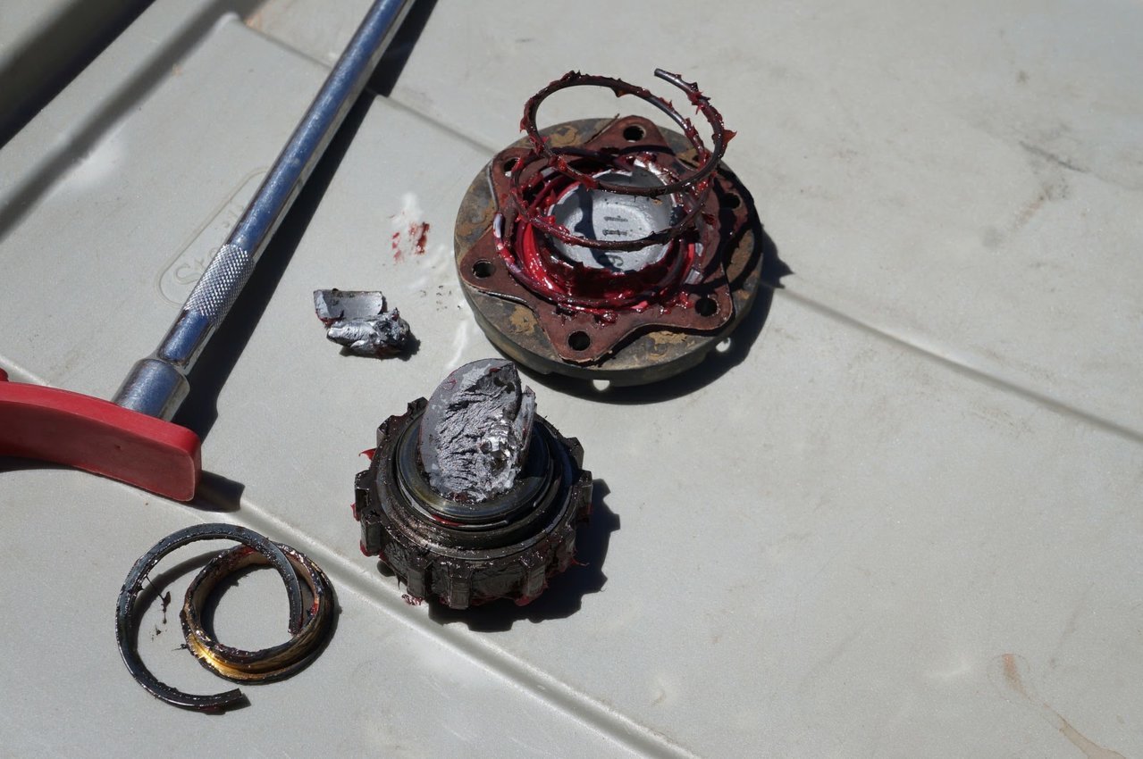

    Don't count on being able to free wheel if you break. When mine broke it took the hub out with it. It turned into a blender just moving 20 yds to a spot to fix it.

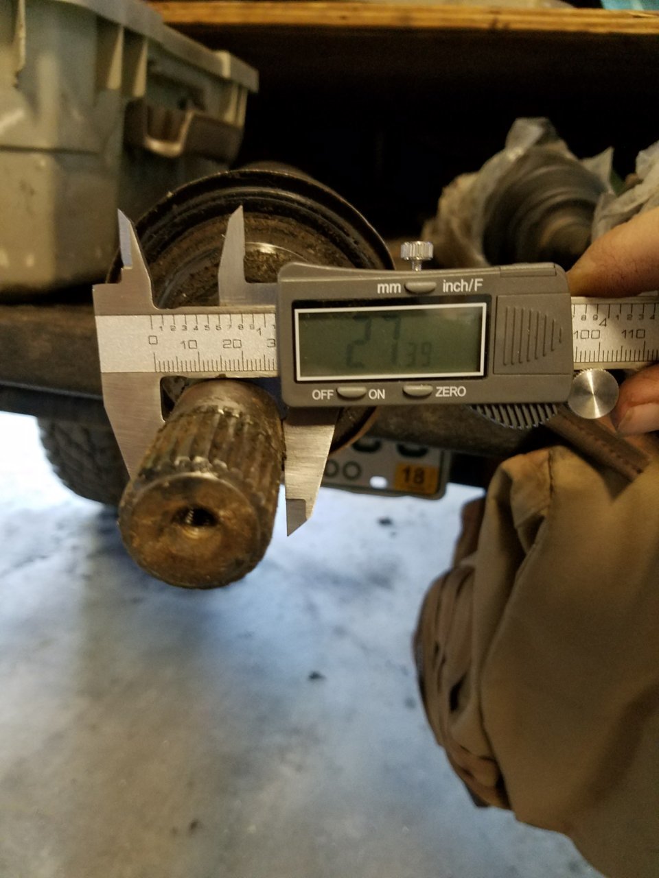

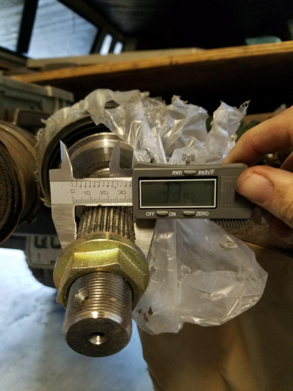

    #48500

    Here's what I have.
    You can see the engagement nob was destroyed and the brass bushing had some pretty good scouring and deformation. (5 year ago you could not order just this part, maybe it's changed since.) The needle bearing was pretty well chewed up also.
    ADD vs Manual stub axle difference.
