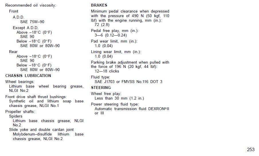

    Interesting. I've never heard this before. Where is that recommendation located, the FSM?

    The Toyota Owner's Manual and the Factory Service Manual both recommend an NLGI-2 moly grease for the double-cardan joints, and an NLGI-2 lithium-based grease for the u-joints and slip yokes.

    Just the regular owners manual
