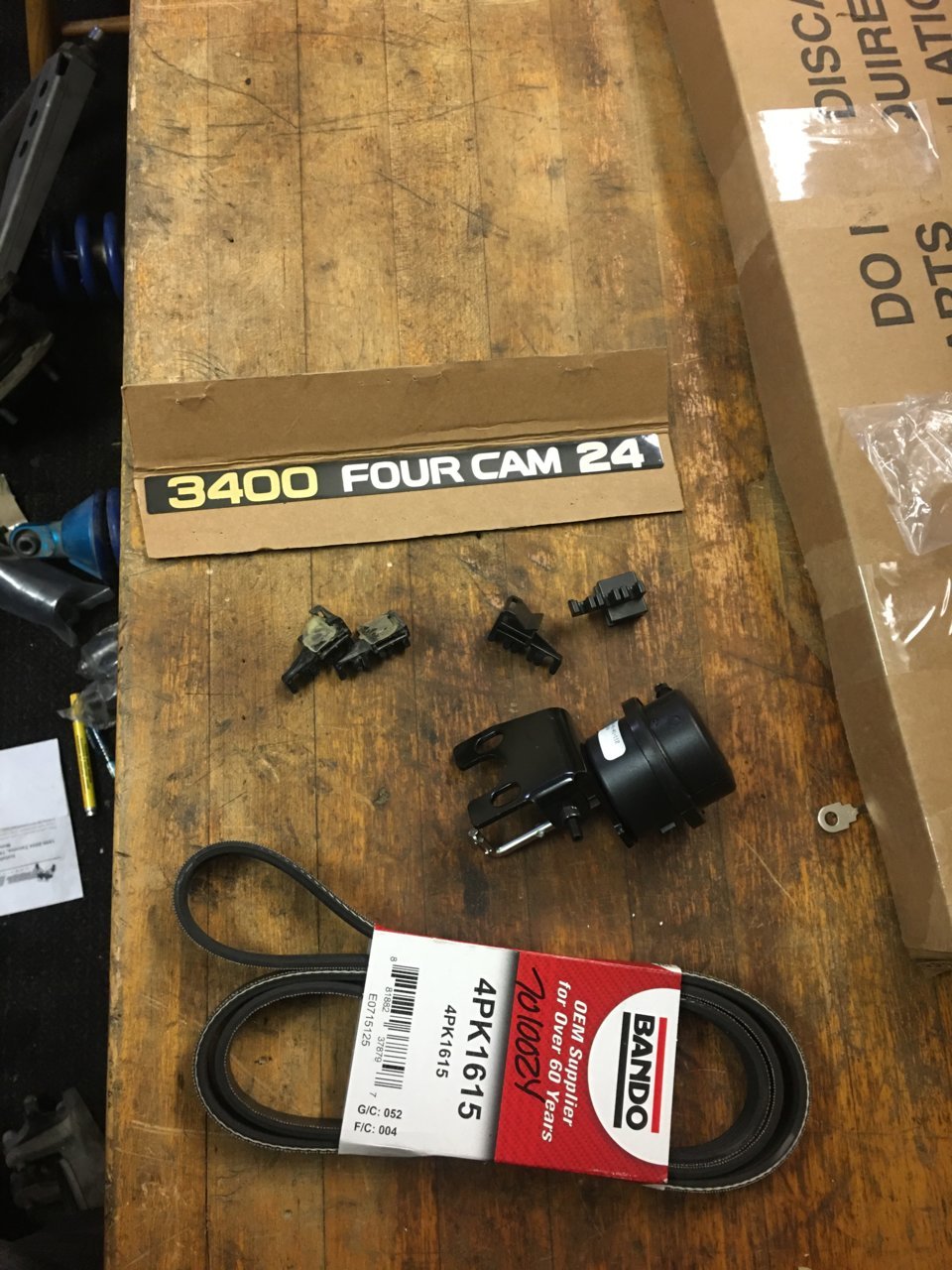

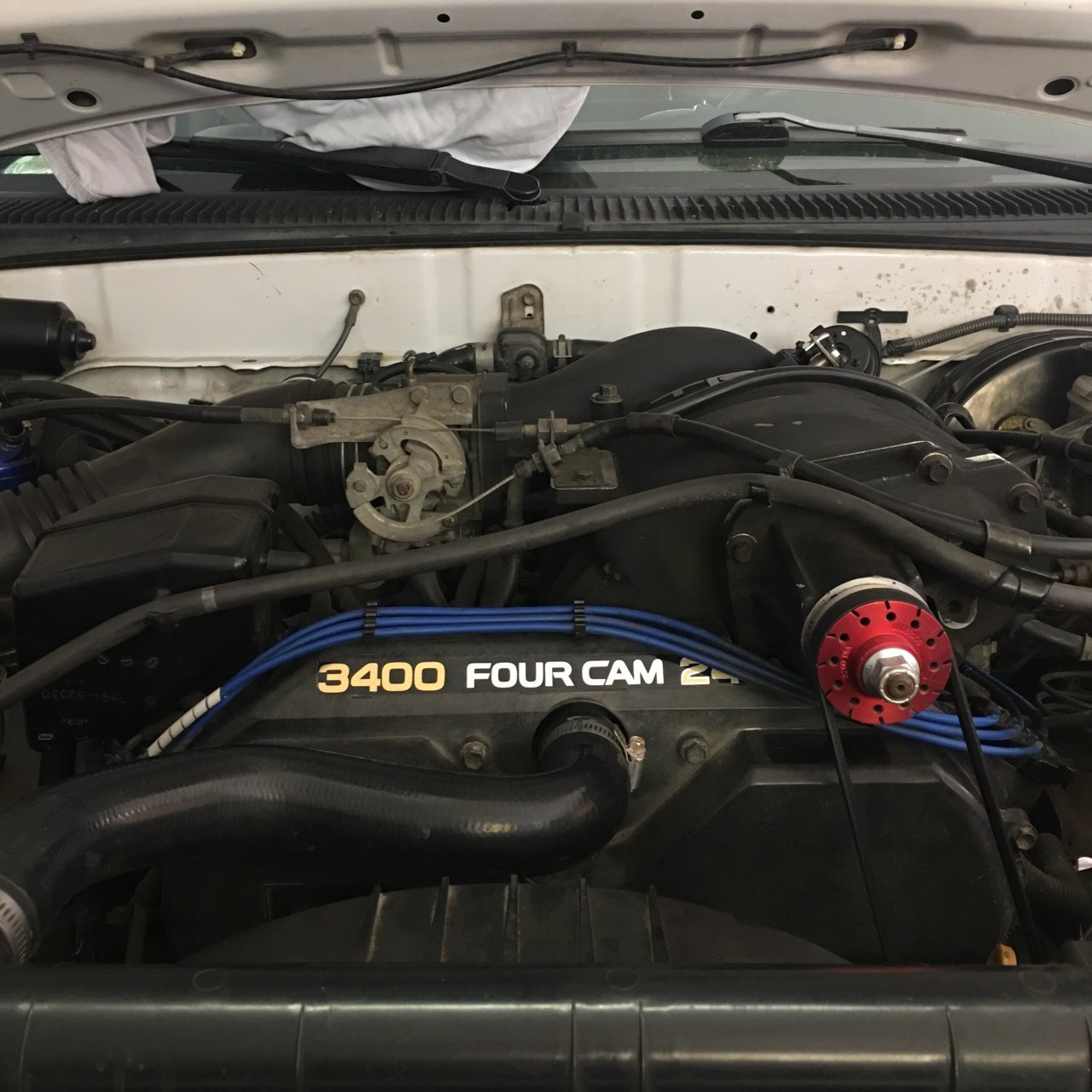

    Truck parts
    Little engine bay clean up pieces and fresh S/C goodies. Old plug wire clips broke years ago
    0E12976F-9D67-4D73-9939-5FBCFB5A35D7.jpg 400B670E-979F-4BB8-A868-A66A2D71DBE8.jpg
    Clip PN is 19944-62010 for anyone looking

    Love the fresh sticker

    Thanks! picked it up when I trimmed the plastic for the s/c. only took me 3 years to put it on...

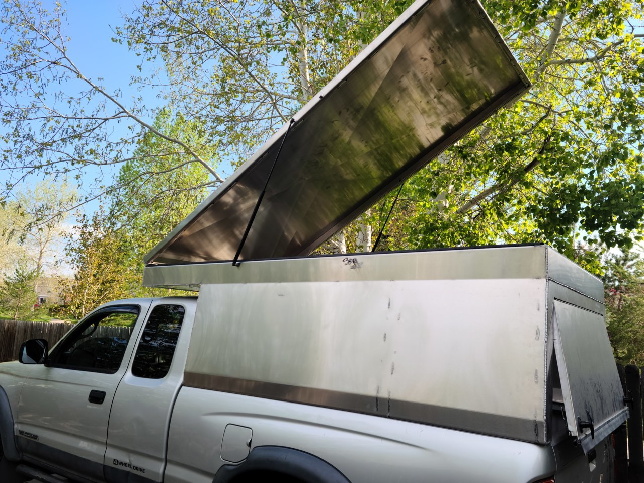

    Custom Aluminum Camper
    Amateur hour camper build, just need to get the canvas done. There are a few more pictures in my build thread and I'll probably add more as it comes along.

    Nice! Is that stainless steel?

    Its Aluminum, just looks shiny.

    Ah ok, hard to tell from the photo but looked like mig welds - not very common for aluminum. Nice work!

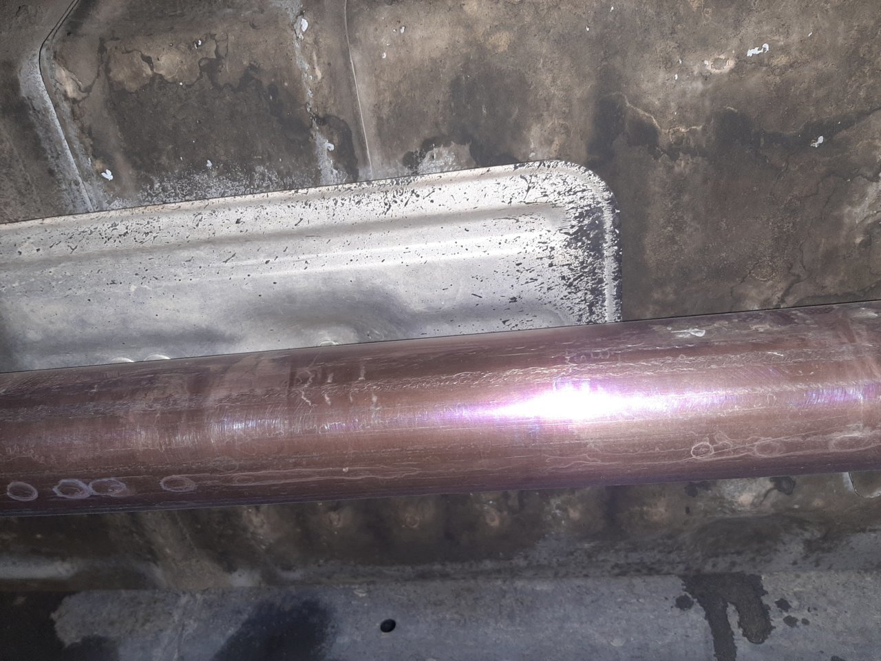

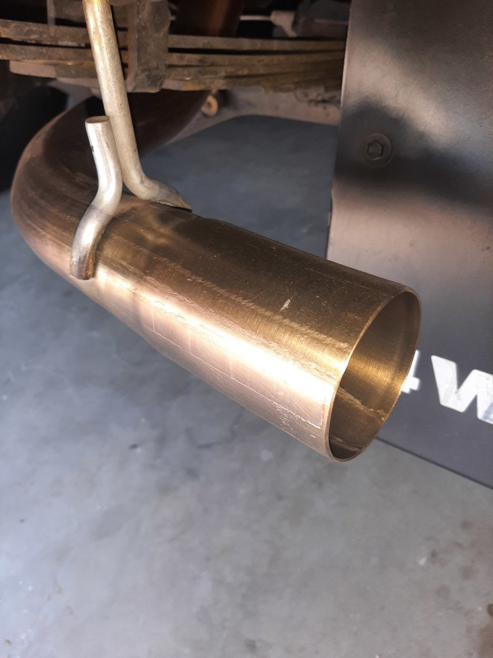

    -=One Year Update=-
    I scrubbed the surface rust off my exhaust and muffler a year ago with phosphoric acid and here's how it looks now. There's some natural discoloration from the heat but otherwise the stainless properties were preserved by using the correct type of acid. I never did bother to use the VHT clear coat I had planned. This is just bare metal.

    Perfect, been wanting to replace those clips for soooo long!

    Where'd you get the new sticker?
