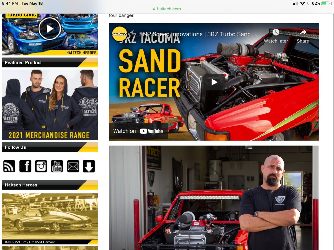

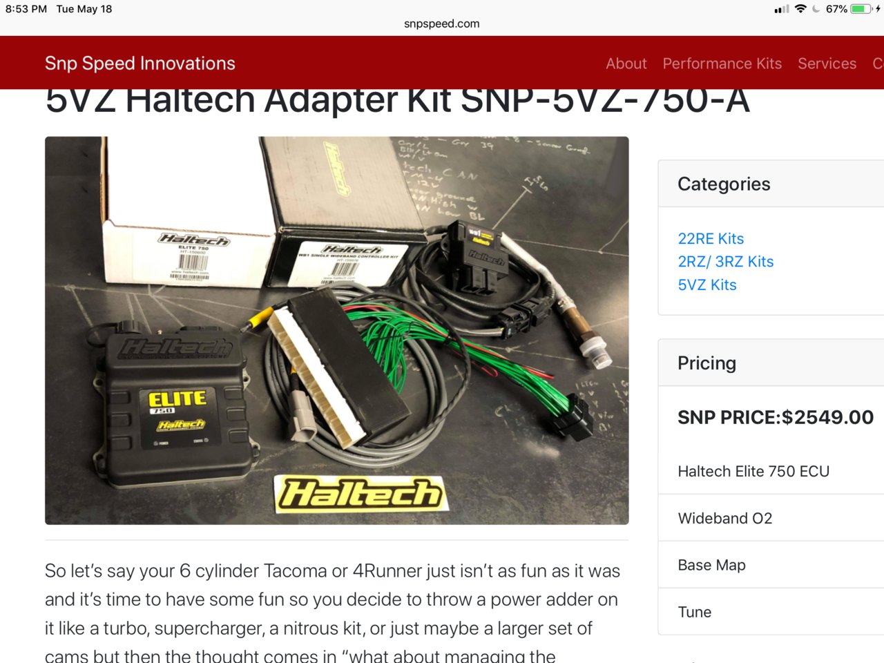

    I didn’t you could get a Haltech with the harness and a base map that’s available plug and play,
    I talked to this guy today Gabe,
    He knows everything!,, 900hp Tacoma 4 banger
    https://www.haltech.com/haltech-heroes-snp-sand-drag-tacoma/

    I would love too, can’t, I need the reliability because this is my daily driver at 30k a year.
    AND the earlier tacoma has zero space in the grill area for an intercooler,
    1998 forward have like 3" or so more area behind the grill, with my AC condenser there is zero space 4 me
    This guy can actually do an internet remote fine tune too for these Haltech units
    http://snpspeed.com/SNP-5VZ-750-A.h...eGq9AMb8DKJErK8yLX0pJAdgUSYpSwS5xbjgefs5mZRgk

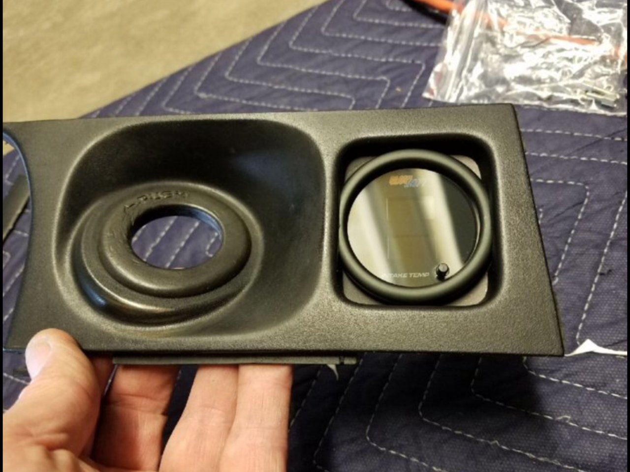

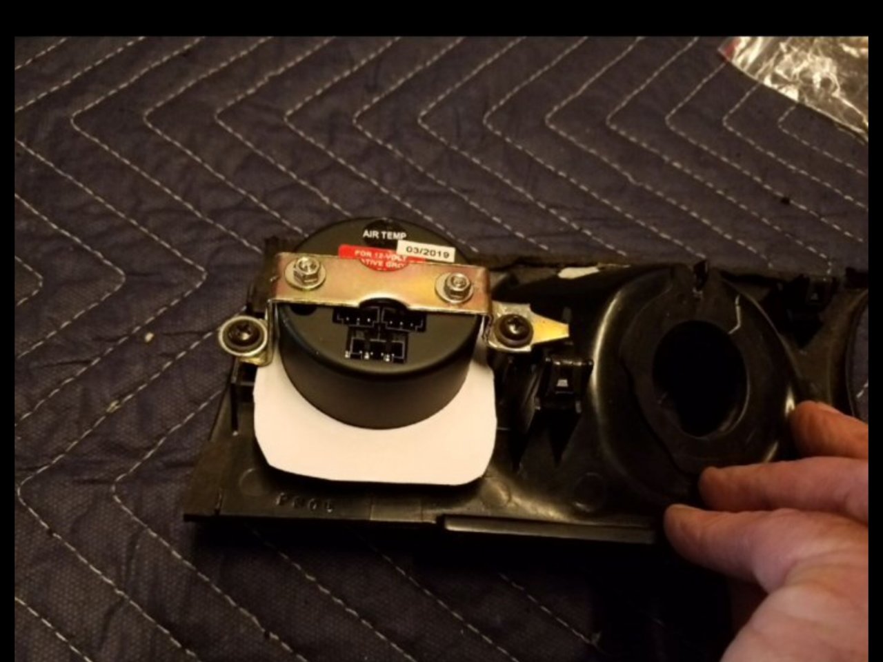

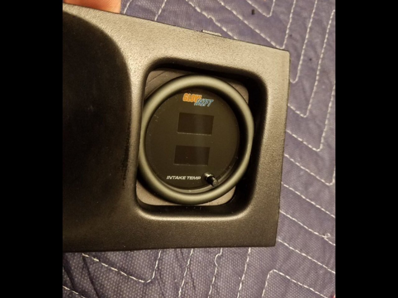

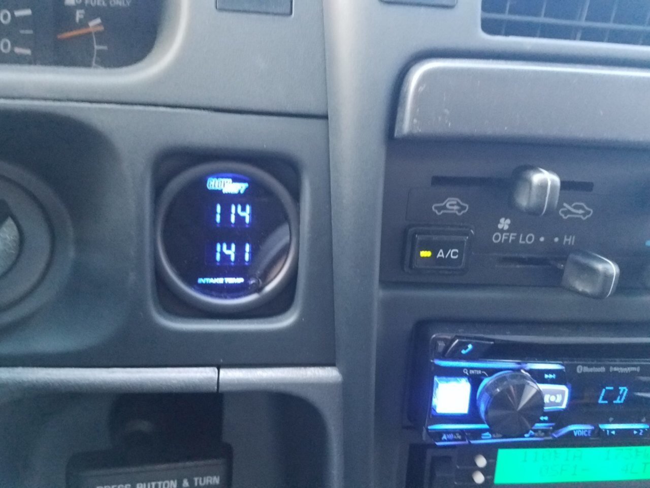

    Is your glowshift gauge to your oil pressure digitally? The one I got here is analog if i remember correctly

    The Haltech 750 is not OBII compatible, so its not functional.
    The Haltech 2000 works with the OBII and is functional.
    And he said you can unplug the wires and go back to the stock ECU for Emissions and only takes
    30 minutes to do this

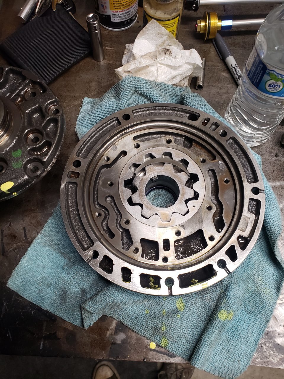

    Getting there

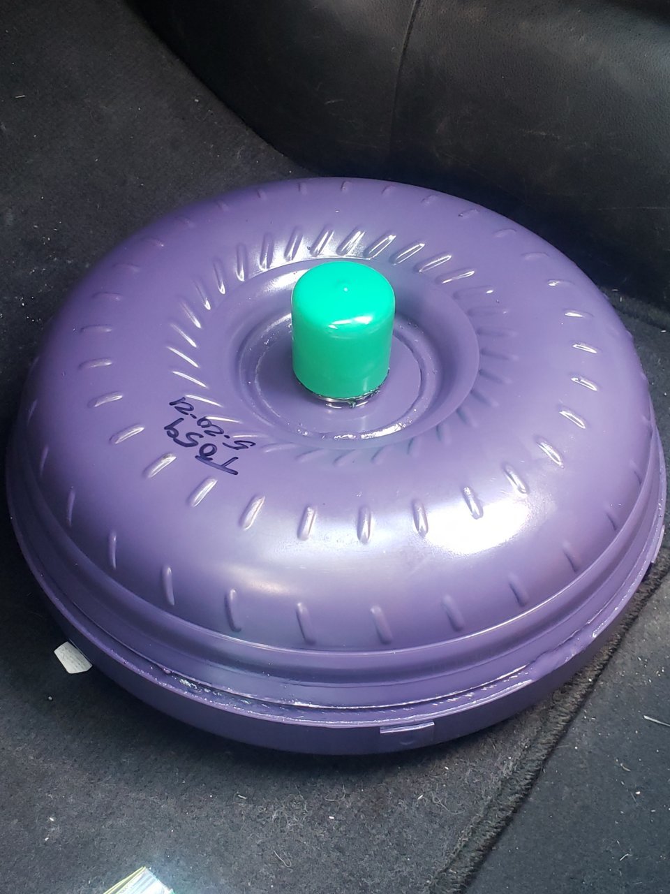

    20210517_090144.jpg Deleted rear stock proportioning valve and did a solid line crowne ss line and wildwood proportioning valve..old one was leaking and worthless..

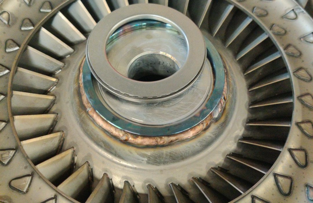

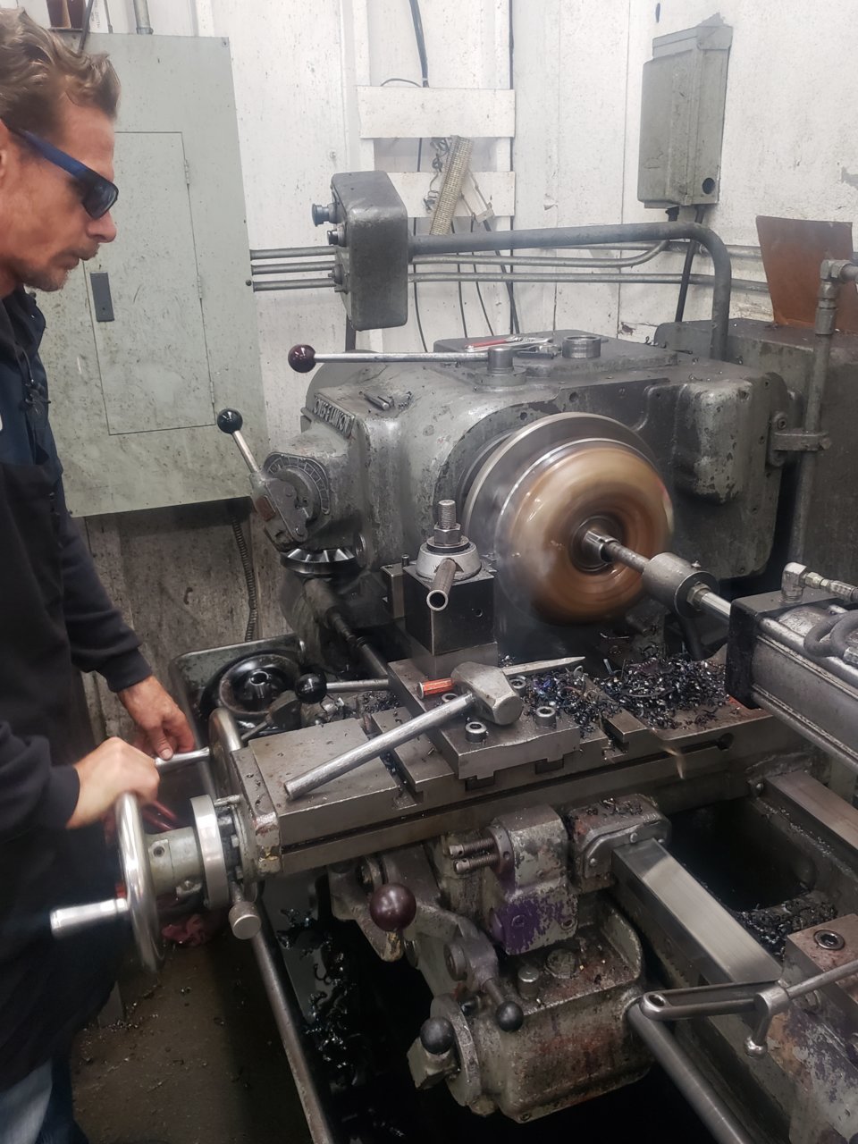

    Had torque convertor cut open at Dalenzie torque convertors and Josh pulled the 2 piece bearing out machined the bearing seat and did a larger 1 piece bearing as well as looked for any chunks from blown tranny...clean..filter did its job
    Rebuilt my tranny pump and replaced transmission
    Did a tranny cooler as well..20210514_101418.jpg 20210517_140751.jpg 20210517_090144.jpg

    Yup, you use the Haltech O2 sensor that replaces the Toyota 02 sensor in the same location and the rest is unplug and plug and he makes a start up map for you with all your info,
    He says he has plenty of maps on file to get you going,
    The final tune he says takes two hours if he does it remotely with you.
    I have some serious thinking to do now, it’s just a lot of money but probably the best solution of all the options for engine management.
    They are 6 weeks out (back order) on getting these available or made but probably going to pull the trigger on this in the coming month or two,
    IF I ever went turbo at least this part would be done
