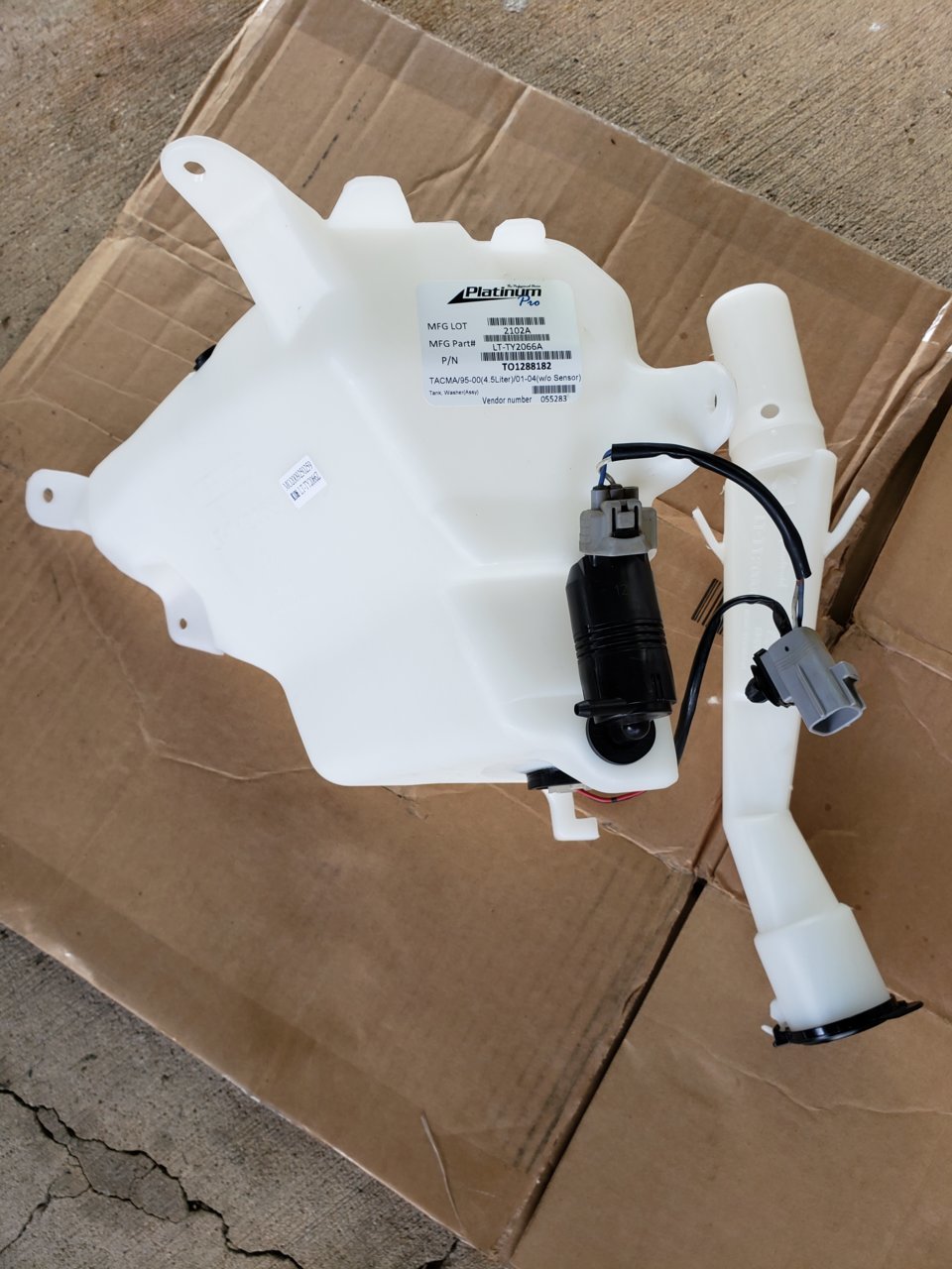

    Replaced my old cracked up washer fluid reservoir with one from Amazon. Had to drill a hole in the bottom for the low fluid sensor. Used the old grommet and some RTV. Holding fluid so far...

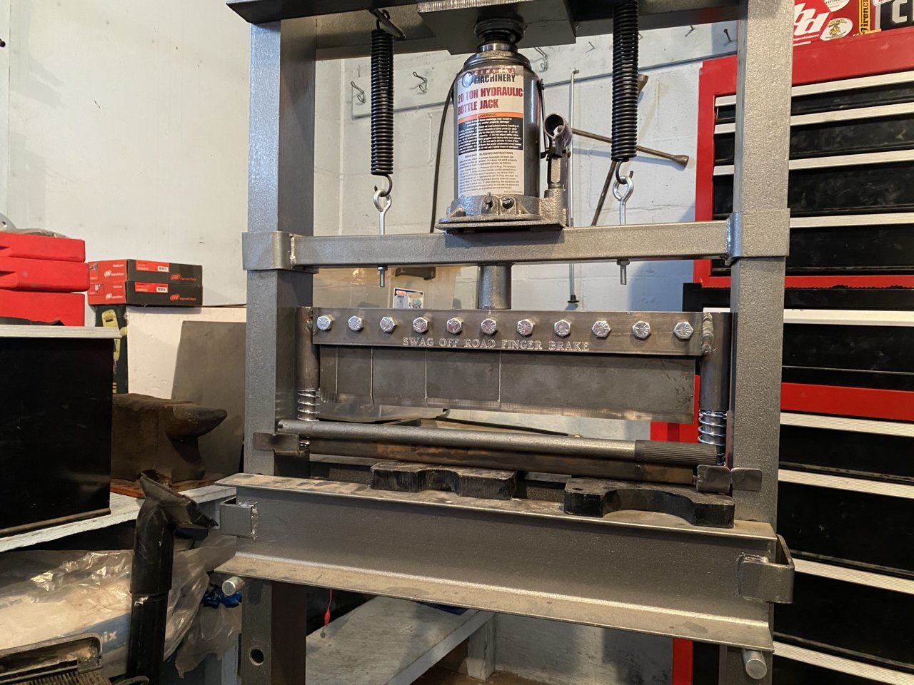

    Progress completely stopped on my tacoma the last week (again). I realized I had to finally buy a welder... I also realized that I hadn’t spent any time welding for the last 10 years. So, I figured that I’d better practice.520A9D3E-CC09-40DA-B3CF-6302558D1B1E.jpgit isn't finished in this pic. SWAG Off-road finger brake press was my guinea pig for my new welder... if I were to build a dog house. I’d likely currently be sleeping in it.

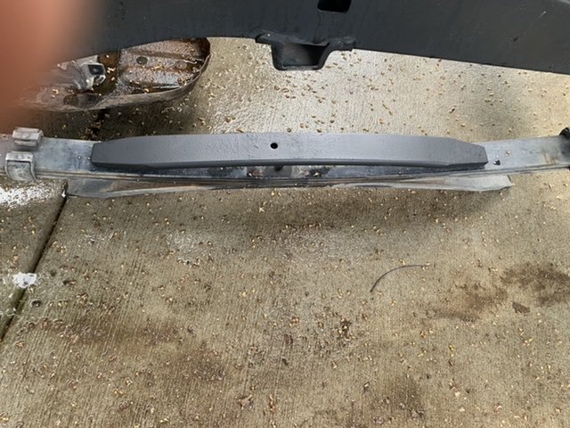

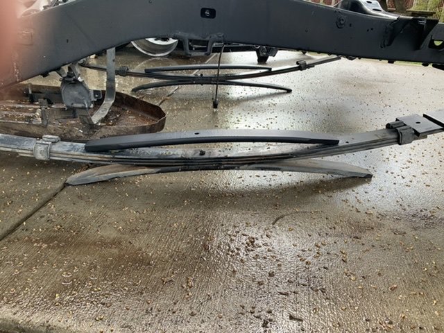

    Made some double overload leafs to put below existing overloads

    Are the dies/fingers tool steal/hardened? Or cold rolled?

    Honestly, I don’t know

    I have the same press brake, they just look like low carbon HRS with a milled edge to me. The instructions said not to bend round stock as it would deform the fingers...
