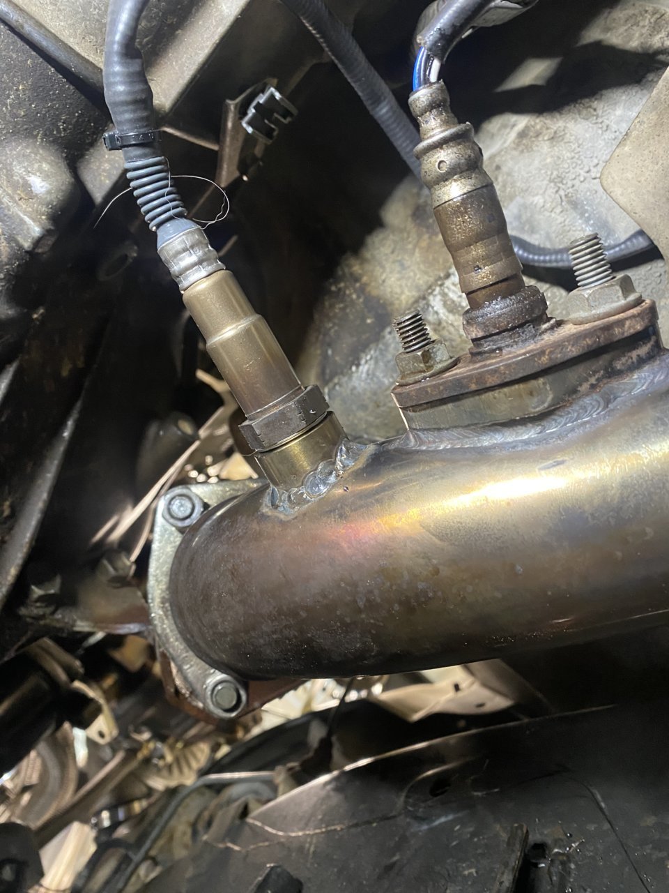

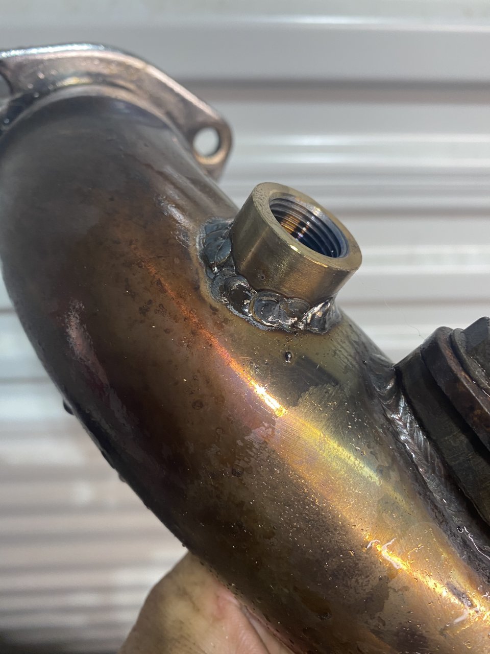

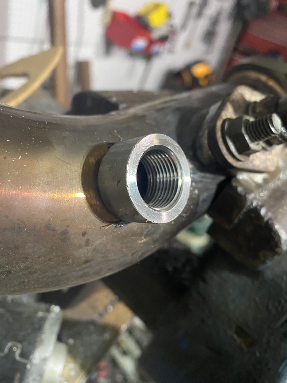

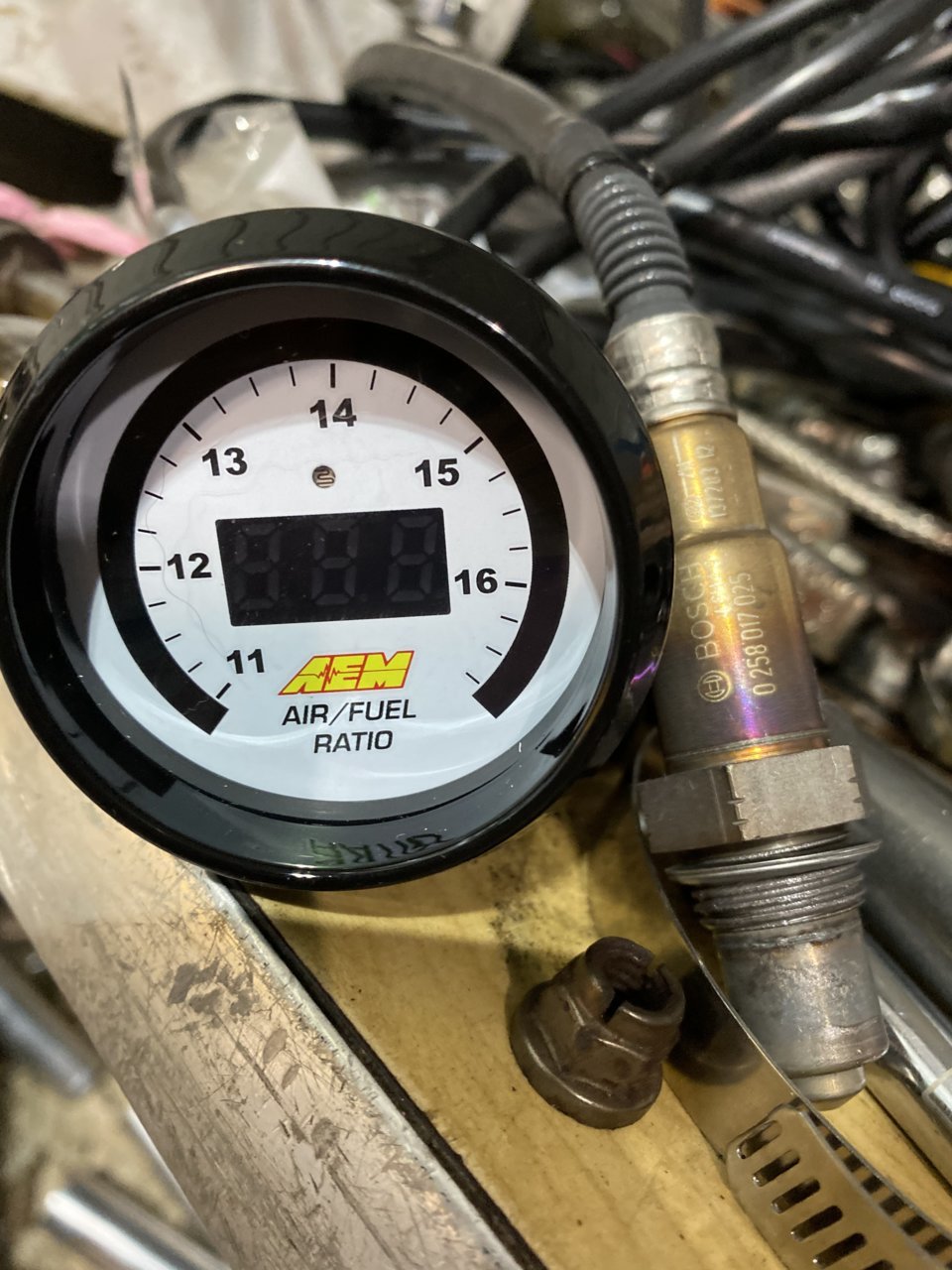

    Got my wideband in today...

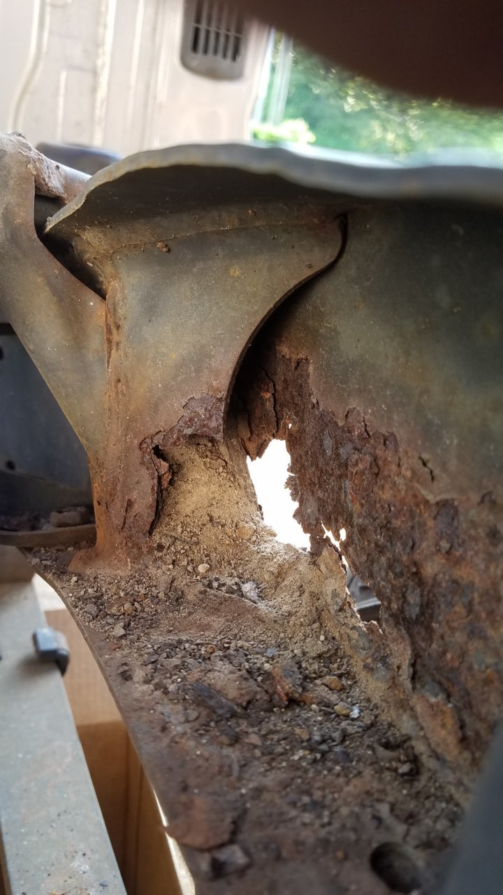

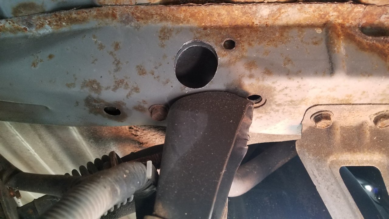

    Got started on a upr RH shock mount area frame repair today.
    Need a new muffler and decided to do fuel pump and fluid film too, so I removed the bed.

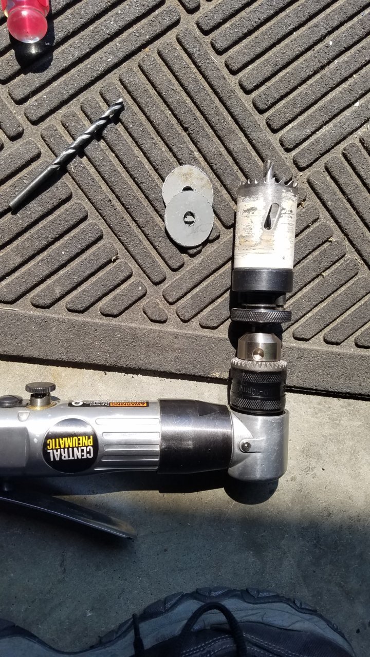

    Wanted to share with my rust belt brothers a method I used to get the LH FR bolt (near fuel tank) out. Of course it broke the weld loose before it freed up. It's too close the the tank for me to feel okay about plasma or oxy/acet.
    I ended up using a right angle pneumatic drill with a hole saw to get access to the head of the bolt. It has two flat sides (not a hex bolt head) that can be held with an 18mm open end wrench. Key Point: make sure to use a hole saw that is at least 25mm in diameter so the wrench will fit through and have some clearance.

    Good grief, how do ya’ll get stuff done in all that rust?

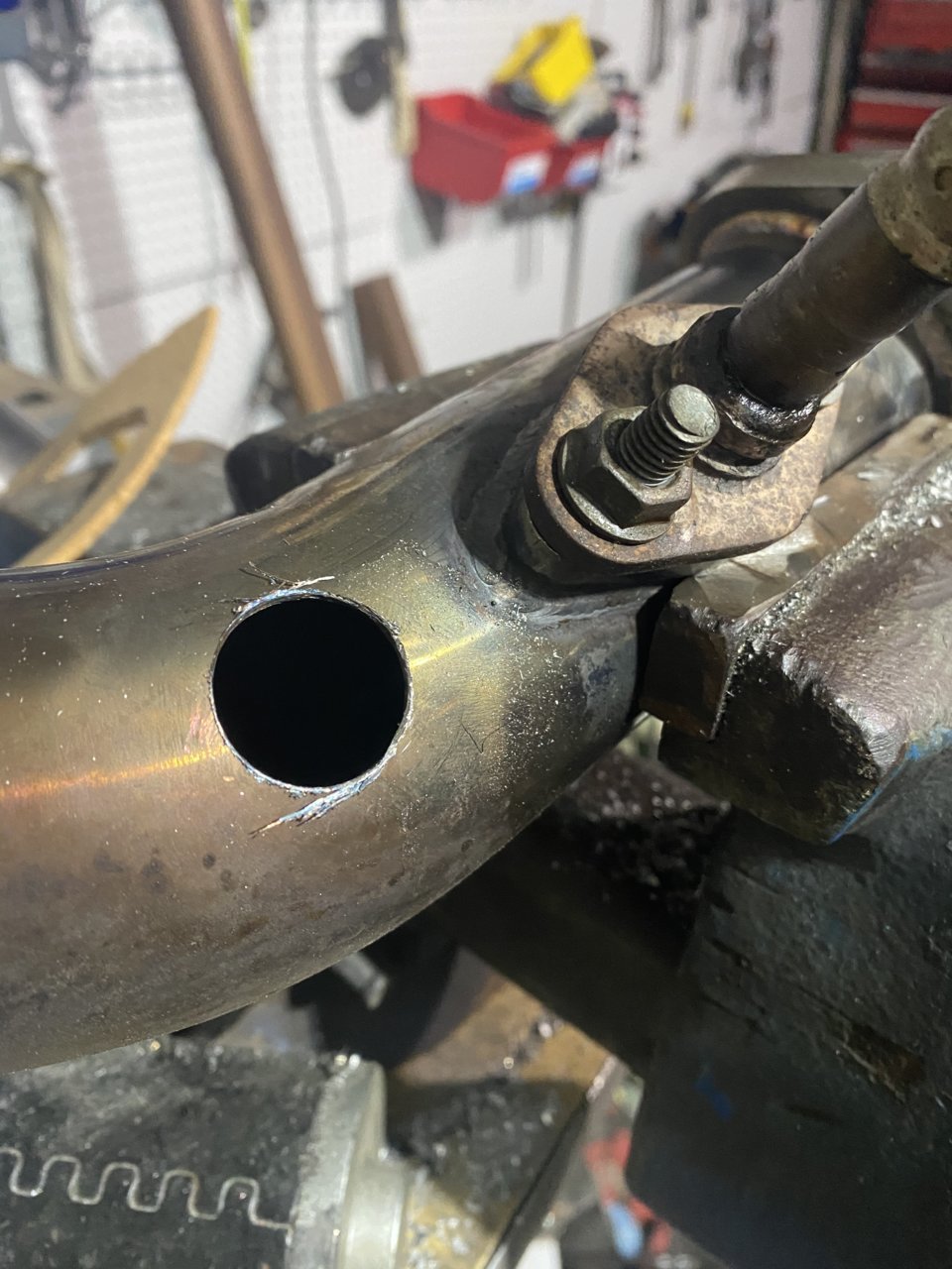

    swearing. heat. special tools... it gets done.
    heres a nice one that was at work one day...
    you get really good when you use to do these all the time..

    Well, it definitely takes some of the fun out of it knowing most any repair under the truck will mean extra work dealing with the rust. Bleeder screws, brake lines, and fuel lines are some I especially don't look forward too. Anything less than 14mm usually the heads snap off the bolts.
