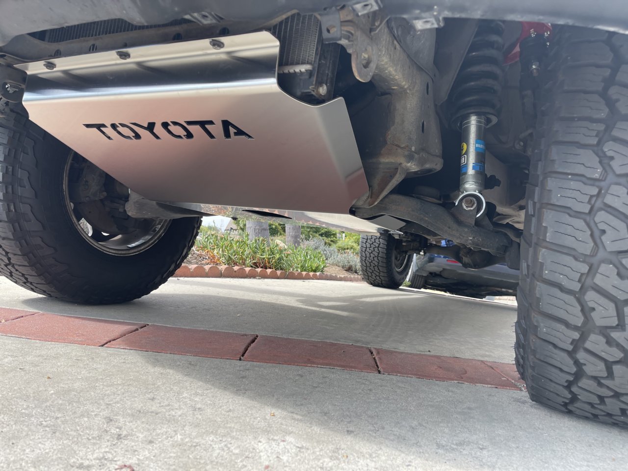

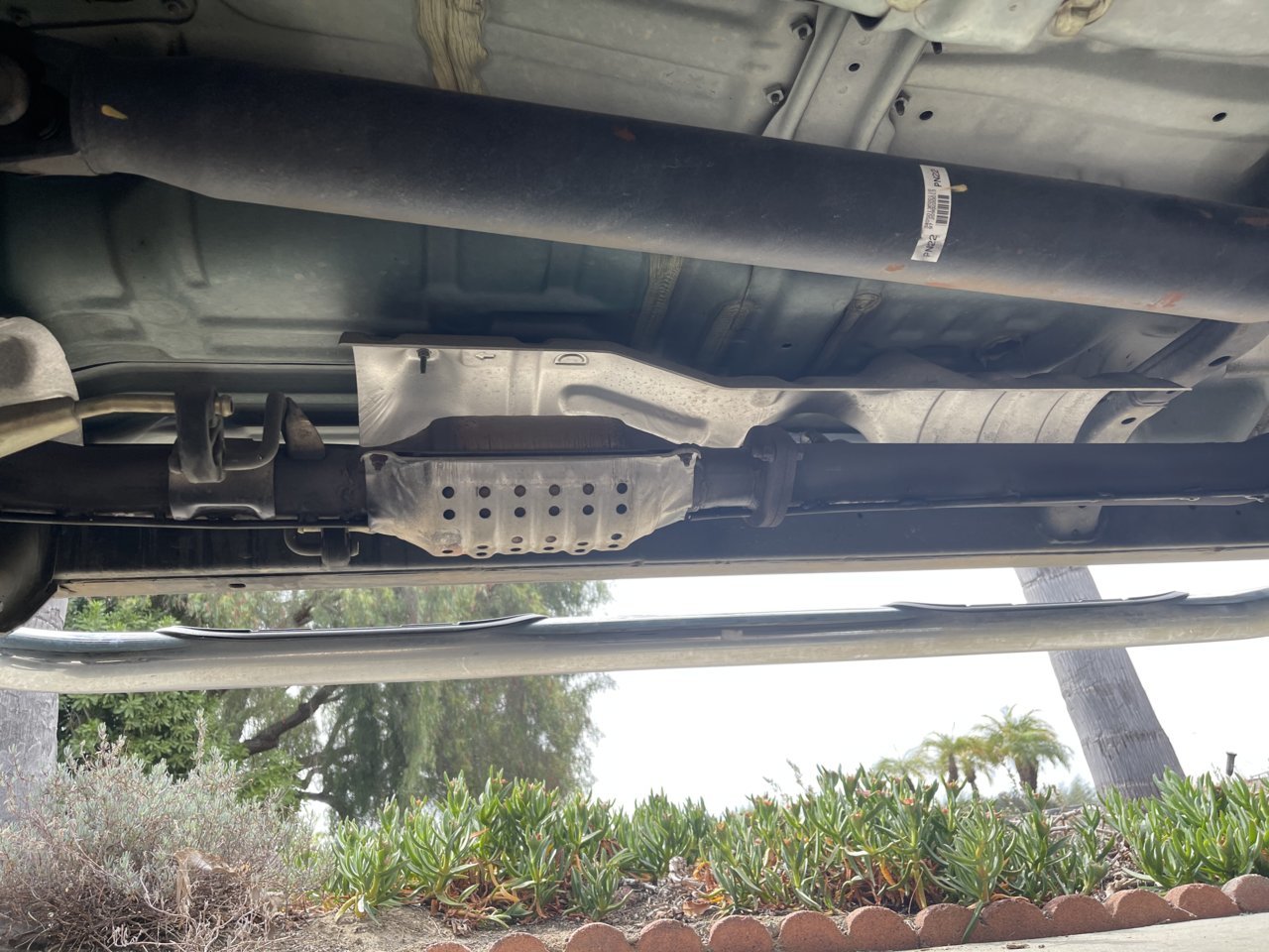

    Installed skid plate from Ethan and welded a few bars to slow down the cat stealing.

    What is the thickness of that skid? And are they sold on TW?

    He offers two different thicknesses, 10 gauge and 7 gauge.
    I emailed him directly and he responded pretty quickly.
    They’re obviously more money now, like everything, but it really is a quality piece.

    What he said!
    Really good quality.
    it weights about 35 lbs. 10ga.

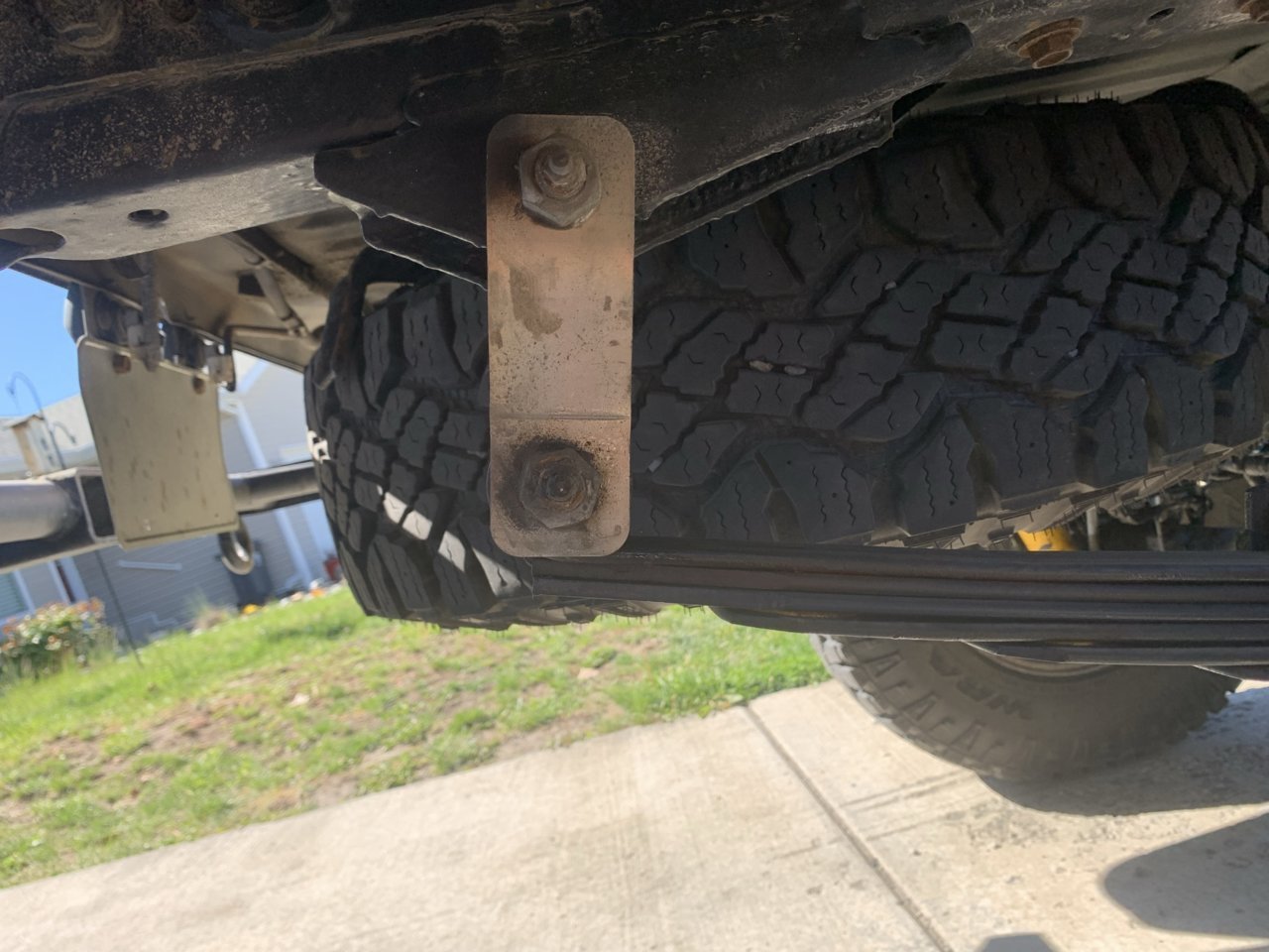

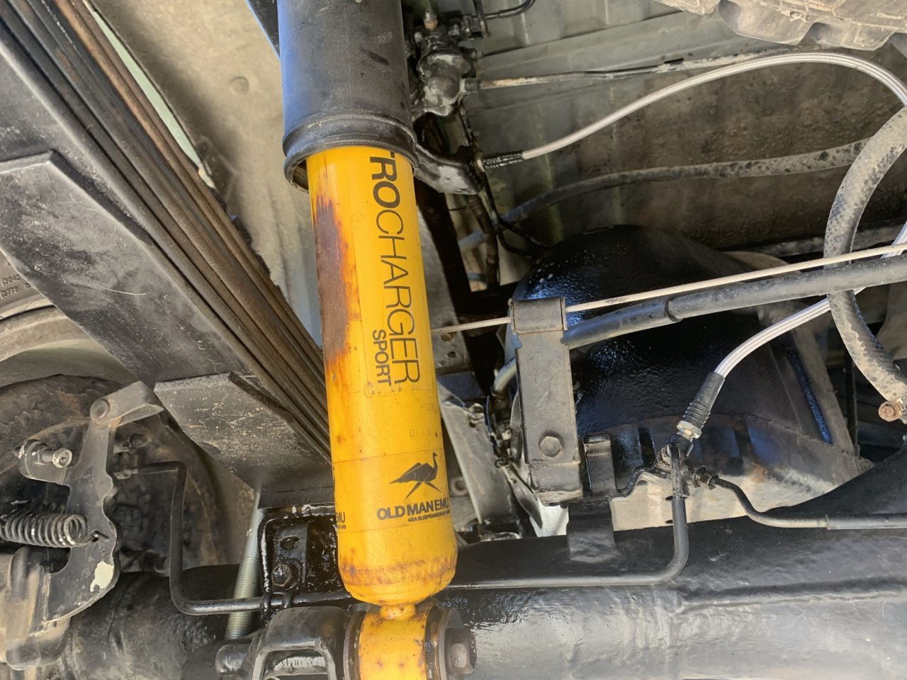

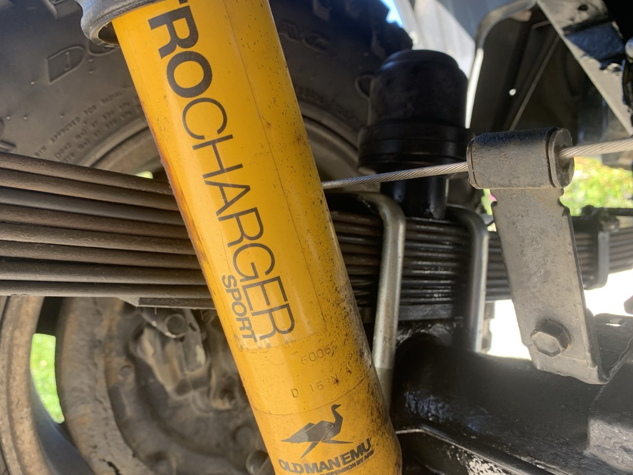

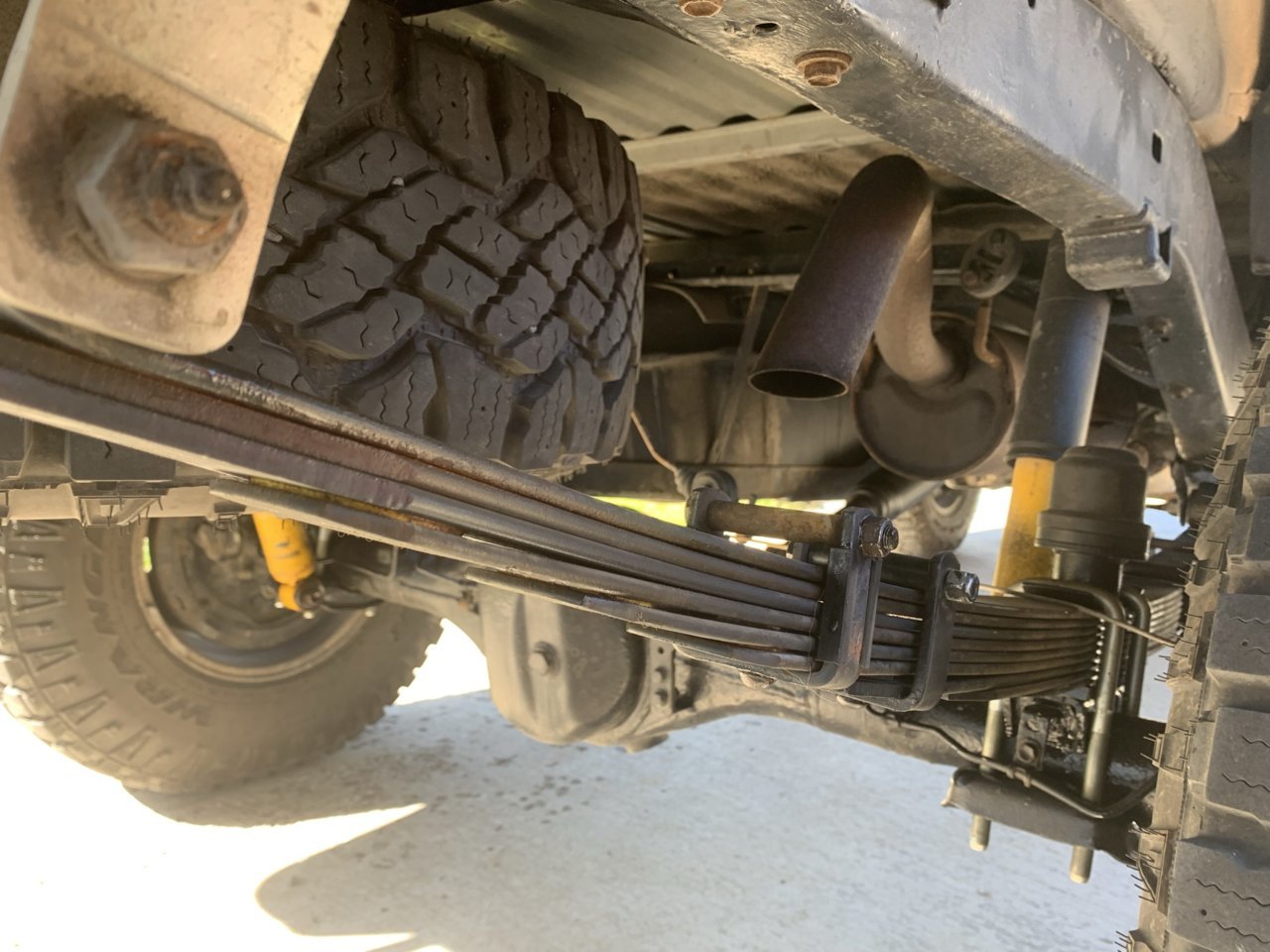

    Ditched the overload springs on my Dakars - installed the OME AAL, and the Wheelers 3-leaf AAL. Took sort of a gamble, but the shackle ended up almost perfect 90° angle to springs, which I have read = good geometry. They certainly ride smoother as a 9-leaf pack than the 5+2.
    Installed axle relocation plate to push the wheels back where they belong.
    And new extra-extended brake line, and 3/8ths superbump spacer.
    Now to measure flex and get longer shocks!

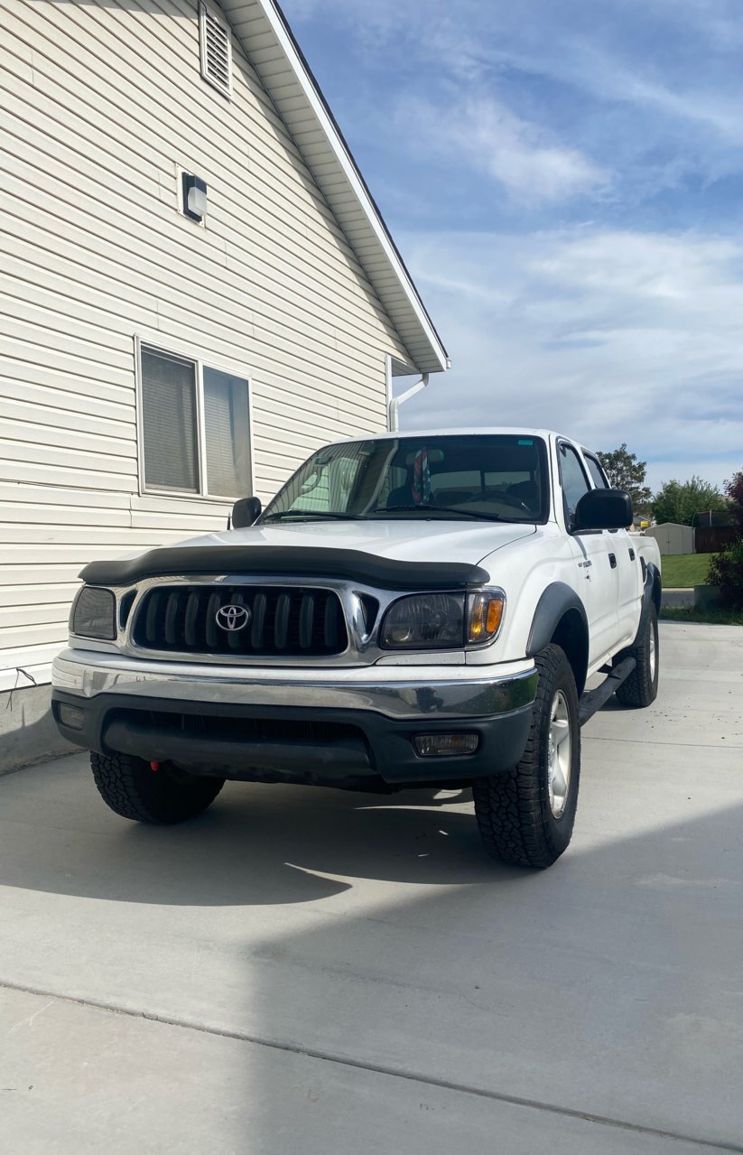

    Just changed the oil! I finally have the time and finances to be able to do what I would like to my truck. 3C648154-814A-4234-8BB4-84EA394C41DA.jpg

    Won't a full set of skids cover it? Think so..
    Fair warning. It doesn't cover the steering rack for shit which is a bummer. And I had to modify mine to fit on my relentless bumper a tad.
    Personally for a serious skid plate since he never developed a mid/full belly skid I'd get something else.

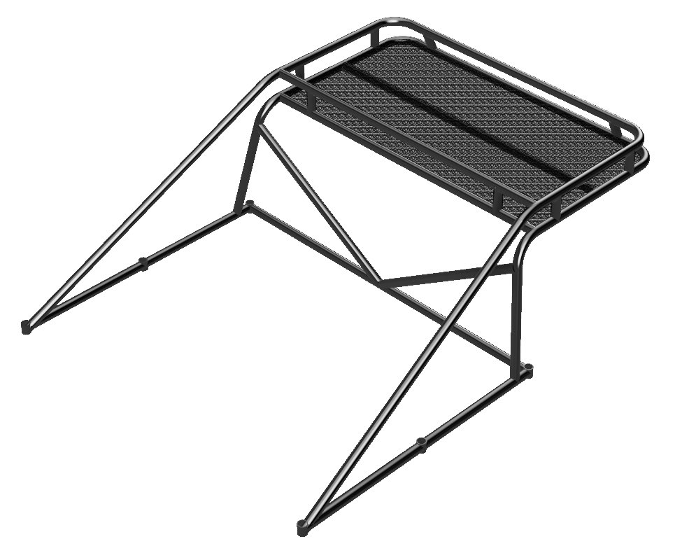

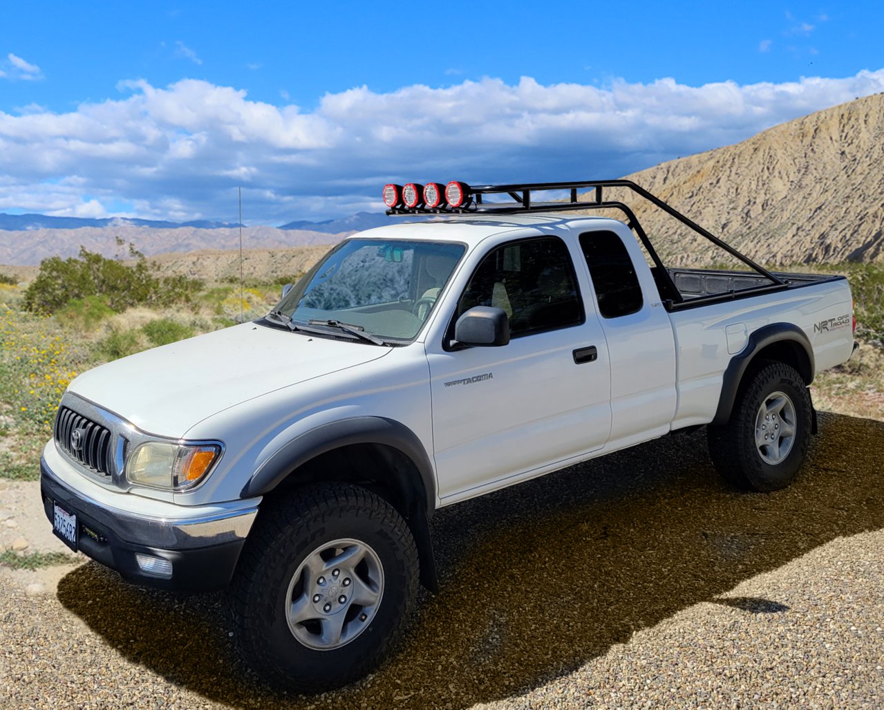

    I Finished installing my custom chase rack with LED lights. The rack started it's life made for a 2nd gen Dodge Dakota. I cut an inch out of the middle to adjust the width and added the rear upper tubes, light mounting tabs and mesh. After that I had it powder coated satin black.
    I thought about using an LED light bar, but decided I liked the look of these.
    The two outer lights are flood lights and the inner two are spots.

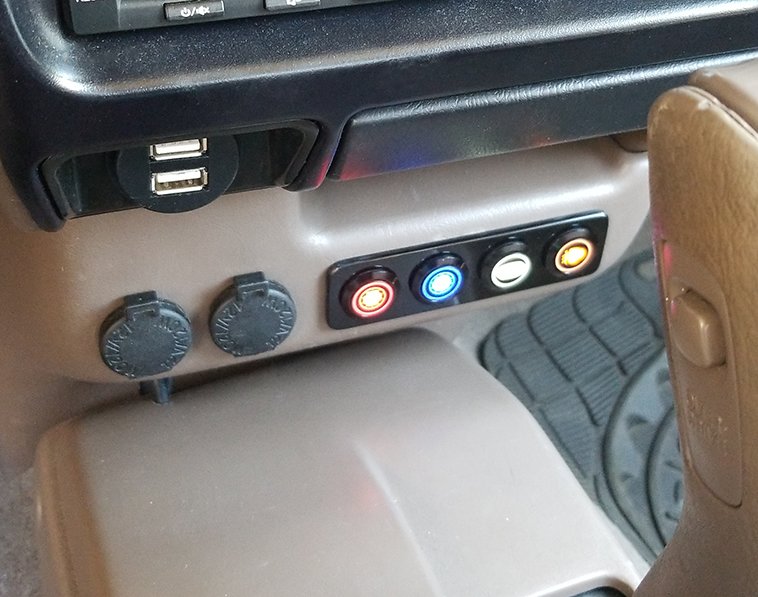

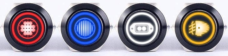

    The four switches I had made with artwork that I designed for them for the spot and flood lights as well as the rear bumper lights and fog lights. The switch plate is black acrylic cut on my laser cutter.

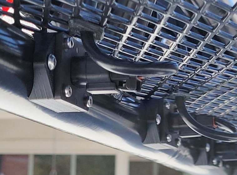

    I used 2 pin bulkhead deutsch connectors with adapter plates I designed and 3D printed to mount the connectors to the 1-1/2" tubing. You can also see the diamond shaped 2 piece grommets I made for where the wire passes through the mesh.

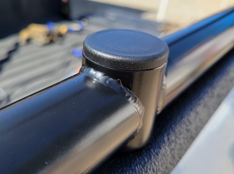

    7/16" grade 8 mounting bolts come up through the bed rail into the short vertical tubes that I covered with plastic caps. There is a 1" 90 degree steel angle sandwiched underneath the bed rail to strengthen the mounting.

    Fantastic effort on this custom rack!! Thanks for sharing

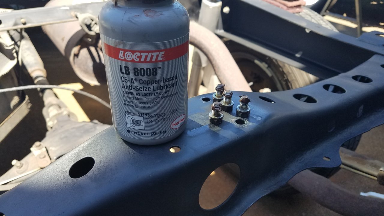

    Rehabing my spare tire winch this morning and as I was putting it back on the crossmember, something occurred to me: in the rust belt, anti seize is the automotive repair equivalent to Franks Red Hot sauce.

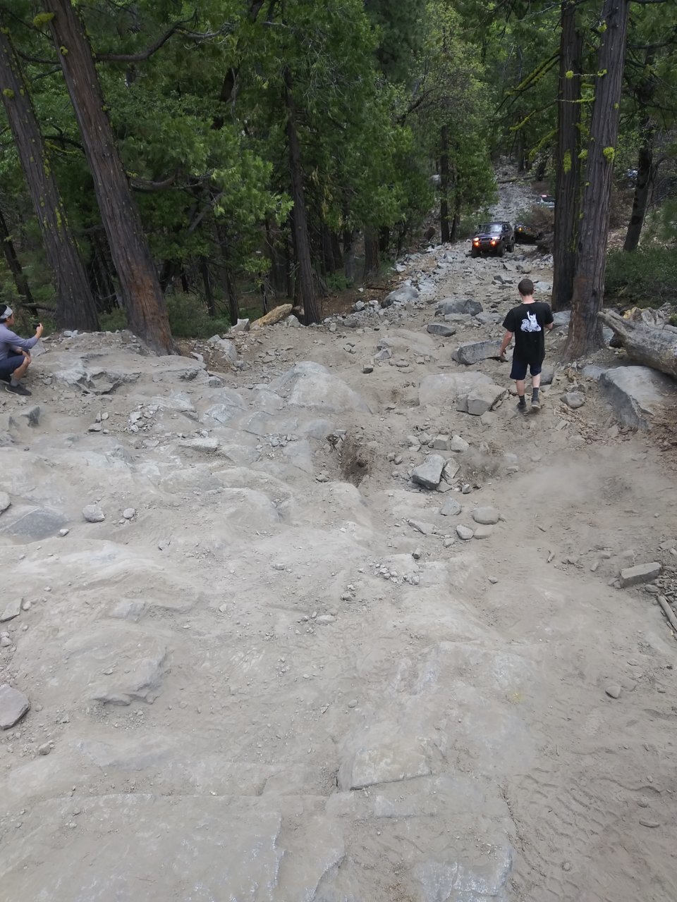

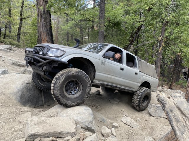

    Driveline hill... Check
    Crawlbox FTW

    Hahaha too true every bolt and nut
