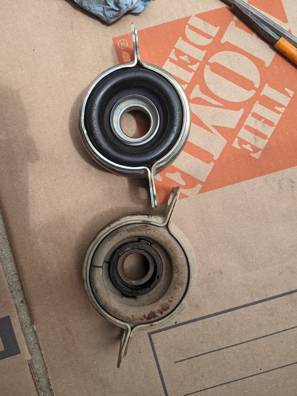

    Mar 4, 2016
    #180213

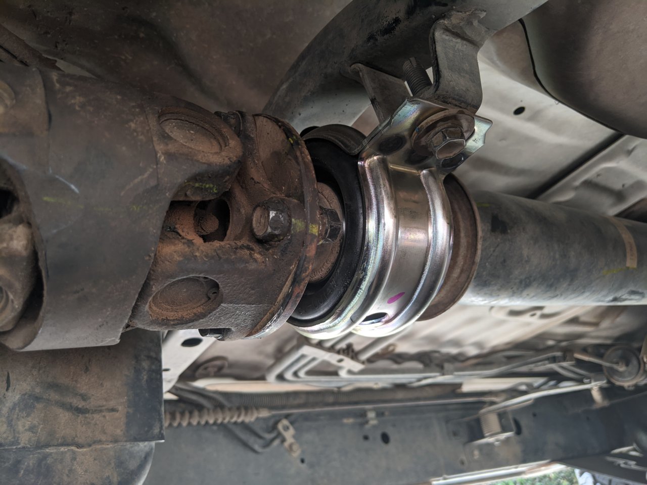

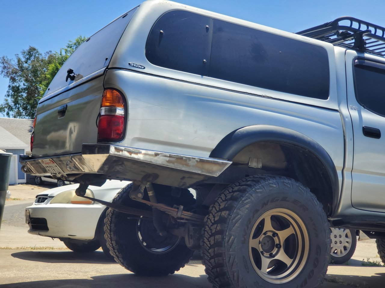

    Finally installed the Spicer carrier bearing, felt good to replace something on my truck and it actually solve a problem for a change.
    No more crazy highway vibrations from 60 - 70 mph

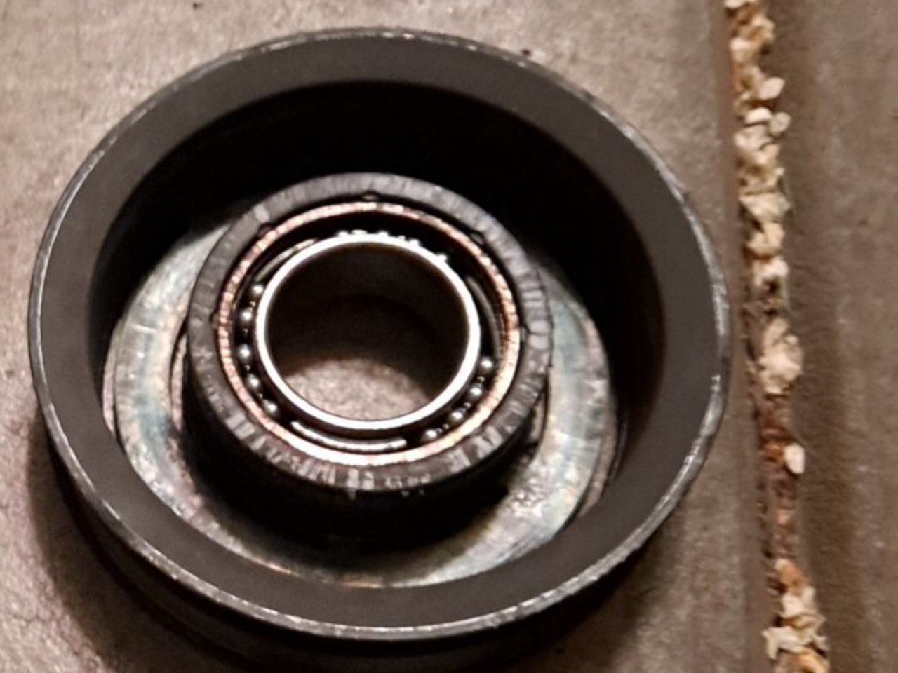

    There was a leak in the line a month ago, so all the fluid leaked out,
    That was all replaced with new fluids and then I replaced the clutch and pulley and pulley bearing.
    So it has the same dryer but new fluids and new clutch.

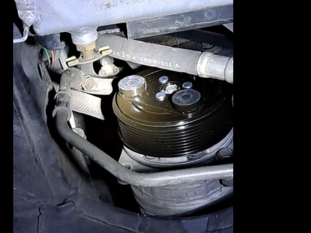

  6. May 30, 2021 at 10:04 PM
    Kevins60
    Kevins60 axle wrap tells me my rear brakes are working
    Dec 23, 2018
    #276677
    1,216
    Kevin
    Odessa FL
    ‘04 4cyl SR5 AT Pre-runner Garage Queen
    SCS Cruise Westin step bars Lund tonneau Jensen HU
    I tried to delete my post when I realized you never opened the system, just replaced the clutch. I’ve been told that 20 degree differential is good so 36 degrees must be phenomenal. My compressor has been making an odd sound like a cicada or locust whenever the clutch is engaged but it cools OK. Not great but OK and I’m just putting off the inevitable replacement of at least the compressor and drier. I would be thrilled to get results anywhere near what you did.

  8. May 31, 2021 at 5:37 AM
    1997tacomav6
    1997tacomav6 V6 5sp,RegCab,TVS1320 Supercharger,Haltech, 800k
    Oct 5, 2013
    #113940
    10,419
    John
    Denver
    97 reg cab, v6 5sp 300hp supercharged, Methonal Injection, 800,001 plus miles, Original Owner
    V6 5sp,RegCab,TVS1320 Supercharger, 56mm pulley, methanol injected Haltech ECU, AC Tvs1320 supercharger,(MUST DO) every 125,000- 150,000 needs rebuild Projector headlights HID 5 speed manual Amsoil for all drive train Smaller 56mm custom pulley, (MUST DO) 2004 DESNO fuel injectors, zero ping ping, 2004 side door mirrors Dick Cepek Rims, Michelin tires LTX, ATM Pathfinders Dynopro ATM ( that last 100,000 miles) Now running Dynopro ATM mud and snow tires KN cold air intake Cat back dual exhaust with ss exhaust tip, Raised exhaust tail pipe to 2" below body line Optima*dry cell battery,red top Alpine sirius radio, 200 watt amp, focal is165 split door pod speakers Focal door speakers Subwoffer behind seat Viper alarm, Electric Locks Dark tinted windows, bucket seats corbeau lg1 Tacoma Rubber floor mats TRD fender extenders, Bilstien shocks, King shocks JBA UCA trailer iv hitch, electric brake control, Drilled slotted brakes, High carbon steel (MUST DO) EBS green stuff 7000 series pads(MUST DO) TRD engine oil cap TRD stick shift, Marlin crawl shift kit. Rear sliding window 2002 4Runner functional hood scoop cut into Tacoma hood, 4Runner dual overhead map light Gentex Auto dim + Compass + Temp, garage,rearview mirror Snow Methonal kit stage 2 Custom 3 core aluminum radiator Linex bed liner Haltech stand alone ECU, Intake supercharger gauge. Stainless steel brake lines, Custom leather wrapped steering wheel, Haltech stand-alone ECU,

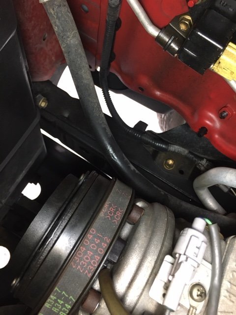

    There is a VERY good chance that noise is just the clutch parts in the front of the compressor.
    It’s a very easy fix and I was able to do it while the compressor was on the engine.
    Did have to remove power steering mounting brackets to push the lines out of the way and skid plate.
    You can buy a new compressor making sure it’s the exact same model and maker that the old one is
    and replace parts from it and have the compressor as a backup when it goes bad.
    Or buy
    1) the clutch
    2) the pulley ( with the bearing already pressed in)
    3) the pulley bearing ( it needs to be pleased out and pressed back in for the new one.
    Getting a complete flush and recharge with a new dryer will get you the lower cold numbers
    chrslefty and Winkle99 like this.
  9. May 31, 2021 at 6:37 AM
    Kevins60
    Dec 23, 2018
    #276677
    1,216
    Kevin
    Odessa FL
    Thanks for the tips. I’ve got the 2.7 so the compressor is relatively easily accessible from the engine bay. I replaced the idler and started to replace the clutch bearing but noticed it appeared the compressor was slinging oil so I stopped. Maybe I’ll go ahead and change the bearing and drier anyway, evacuate the system and recharge. Might save myself $200.9F634D54-3F9C-41AD-A792-D2789C5BFB7E.jpg

  10. May 31, 2021 at 7:08 AM
    1997tacomav6
    Oct 5, 2013
    #113940
    10,419
    John
    Denver
    When I looked at my compressor originally I saw oil leaking out the front of it.
    That’s why I bought a new compressor.
    After taking the clutch out just for grins I saw that it was actually the grease leaking out from the pulley bearing that had exploded,
    I had an appointment the following day for the compressor to be swapped out.
    I got lucky and saved 100s
    Kevins60[QUOTED] likes this.

  12. May 31, 2021 at 9:40 AM
    Kevins60
    Dec 23, 2018
    #276677
    1,216
    Kevin
    Odessa FL
    That decides it. I’ll try the bearing first. If that cures the locusts when the clutch is engaged then I’ll do the evac and refill. Really need to squeeze peak performance out of my AC when it’s Hell hot here in Florida.

    I’m suspicious of mine now too. I just made an 8 hour drive from San Diego to Sacramento and now I can hear the driveline squeak as I start to gas and then it goes away after a few seconds. How much physical play should be in the carrier bearing parked? I don’t think I have the 70 mph shakes like you said you did. It’s also never been replaced for as long as I’ve had it which is the past 80k currently at 280k. I know U-joints could also be the culprit but I’ve replaced 1-2 of those already.

    I don't recall mine squeaking but then again my truck makes a lot of noises so... What sold me on replacing it was the tear in the bushing that started getting worse.
    And after taking it off, you can see in the pic of the old one that it was starting to wallow out the center too.
    Probably a good idea to change it out if it's still original for good measure. Took me a couple hours for the first time but Im confident I could do it in under an hour after that. It's pretty straightforward.
    Recommend getting a new stake nut for the CB

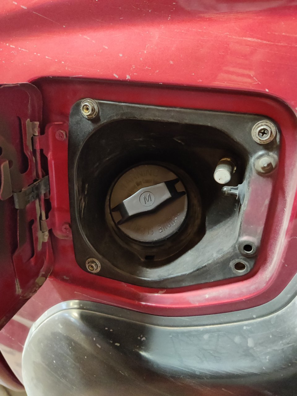

  16. May 31, 2021 at 12:52 PM
    unstpible
    unstpible Well-Known Member
    Aug 16, 2012
    #84909
    3,938
    Derek
    Cedar City, Utah
    03 4x4 boosted V6 Auto 341k miles
    CX Racing Turbo kit. TransGo shift kit. All Pro Apex bumper and skids. Smittybilt XRC 9.5 winch. All Pro Upper control arm's. Bilstein 6112's with 600lb coils. Eimkeith's lower control arm reinforcement plates. Perry Parts bump stops. All Pro spindle gussets and alignment cam tabs. All Pro standard 3" leaf springs. Bilstein 5125's rear. Extended rear brake lines. Rear diff breather relocation. MagnaFlow catback with resonator. Bluetooth stereo. Memphis 6x9 door speakers. Diode Dynamics SS3 Pro Amber fog lights. Single piece headlights. aftermarket grille. Anzo taillights. LED 3rd brake light. 4runner sunglass holder and dome lights. Master Tailgaters rear view mirror with 3 directional cameras, G shock sensors, and anti theft system. Honda windshield washer nozzles. Stubby antenna. Scan Guage II. 2nd Gen Snowflake wheels powder coated black. Cooper Discoverer ST Maxx 235-75/16 Denso 210-0461 105 amp alternator. Speedytech7's big wire harness upgrade. Aeromotive 340 fuel pump. Haltech Elite 2500. Tacomaworld sticker. Tundra brakes with Adventure Taco's hardline kit
    P0442 AND PO446 codes popped up and my back blinker burned out. Bulb replaced and I threw in a new gas cap however I don't expect that to fix my codes but it would be really nice if it did IMG_20210531_133647.jpg

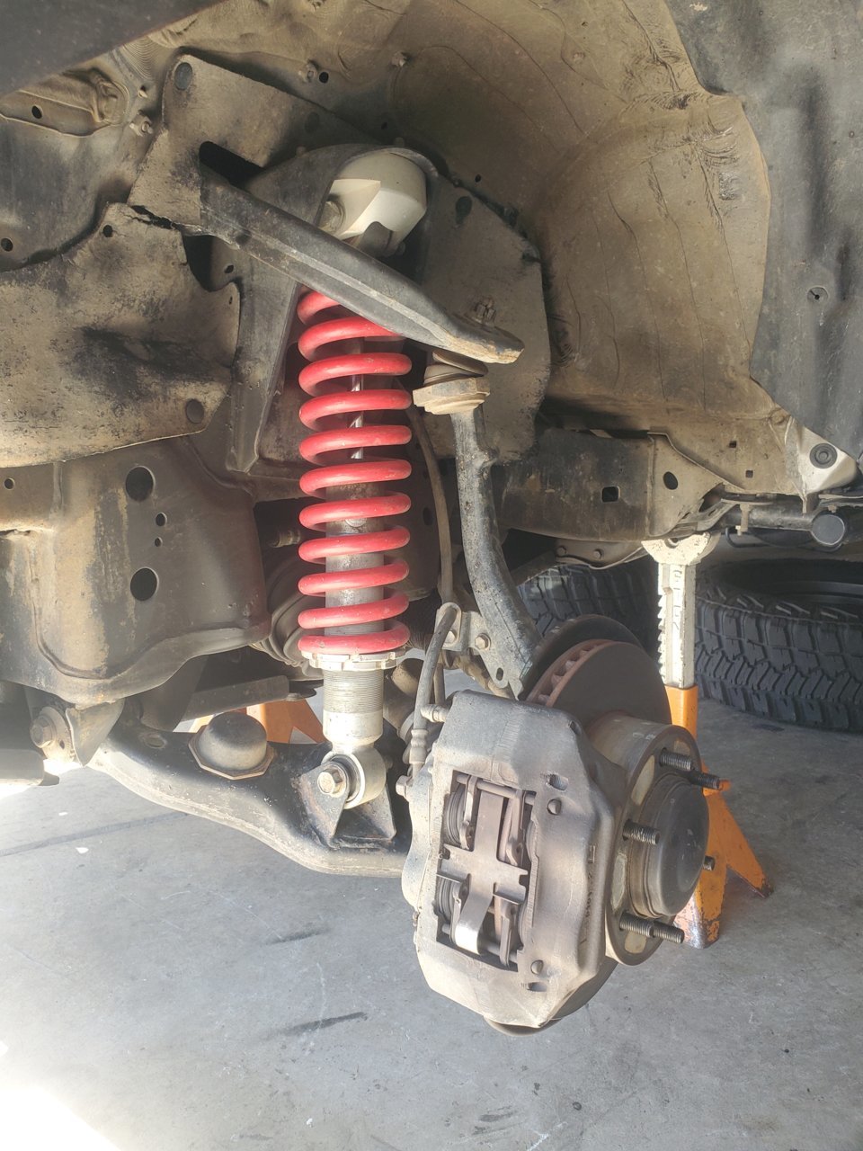

  20. May 31, 2021 at 1:59 PM
    Cheap Taco
    Cheap Taco Well-Known Member
    May 22, 2021
    #366431
    167
    2001 Tacoma Limited Double Cab
    New front pads and rotors, and changed the oil. Good day working on the truck and not being in a rush.
