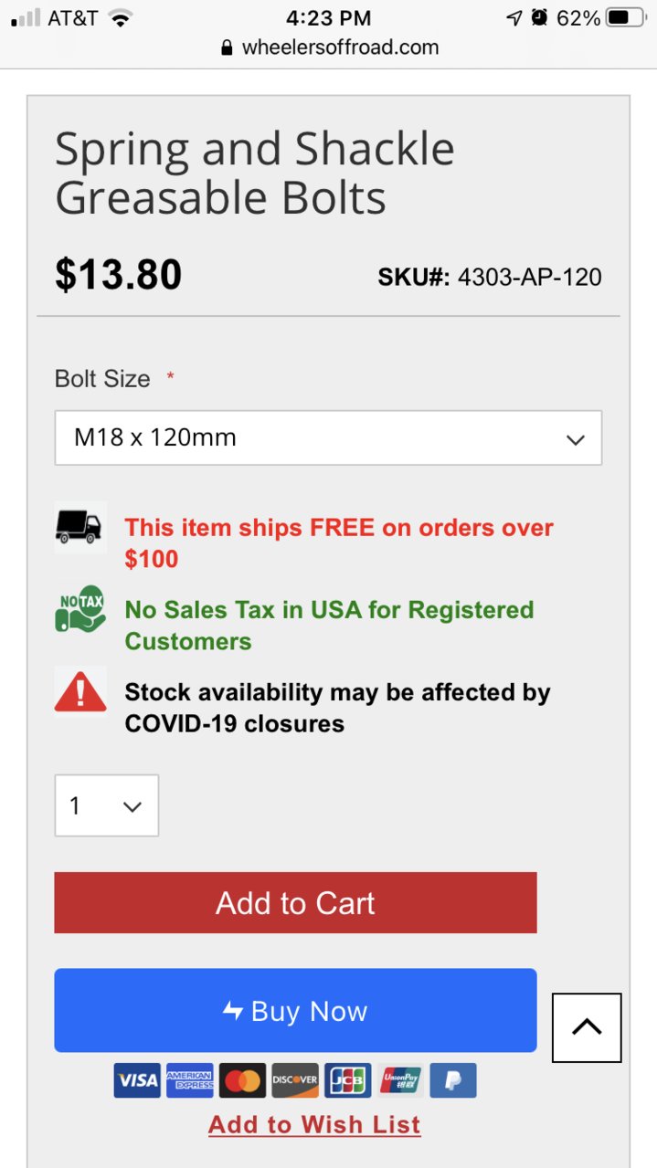

    Can anyone confirm that this bolt size will work for the front leafspring hanger?

    I thought the fronts are M14x1.5 x 100mm

    Good enough for me

    Saw another thread too where it was mentioned

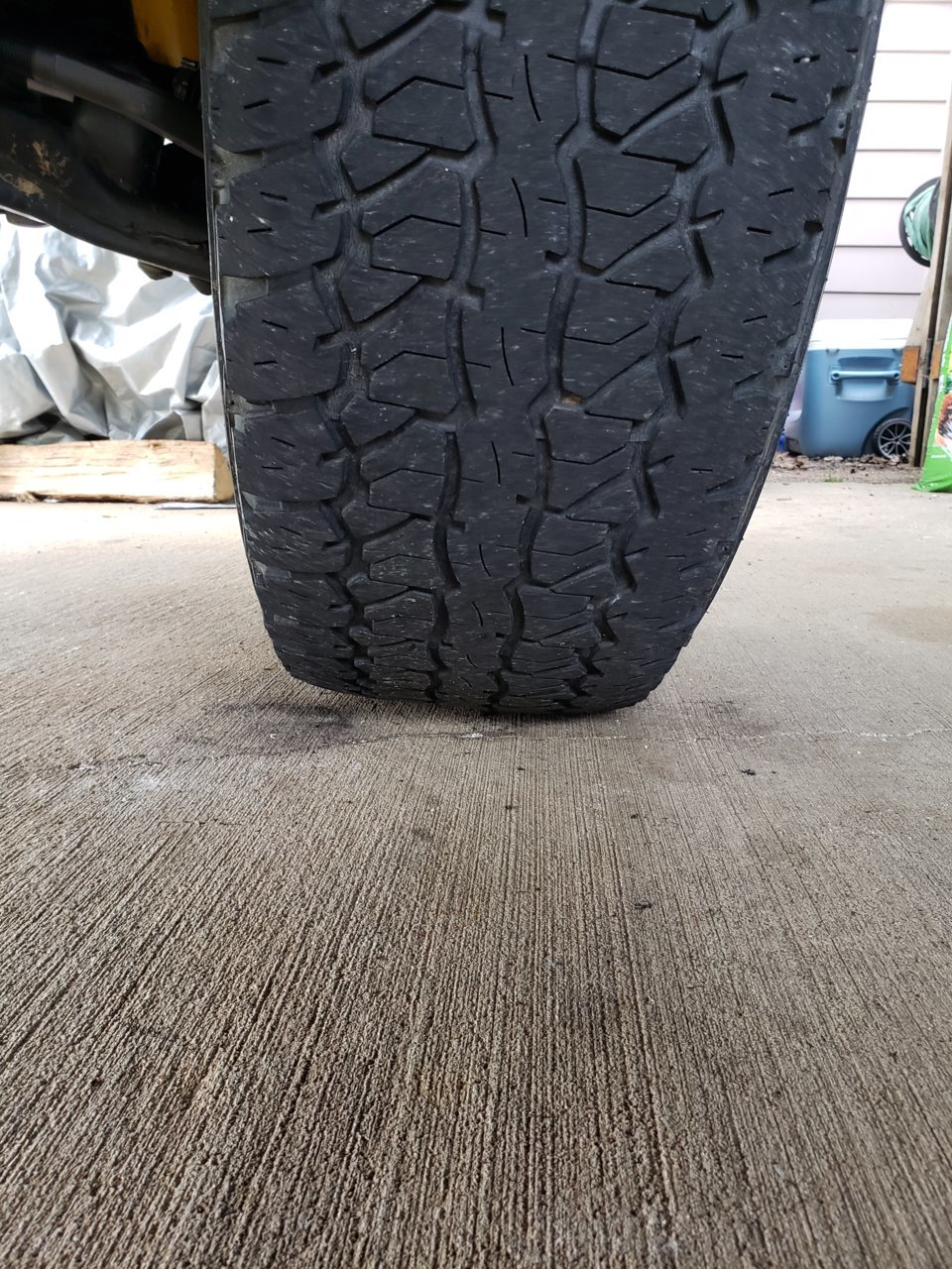

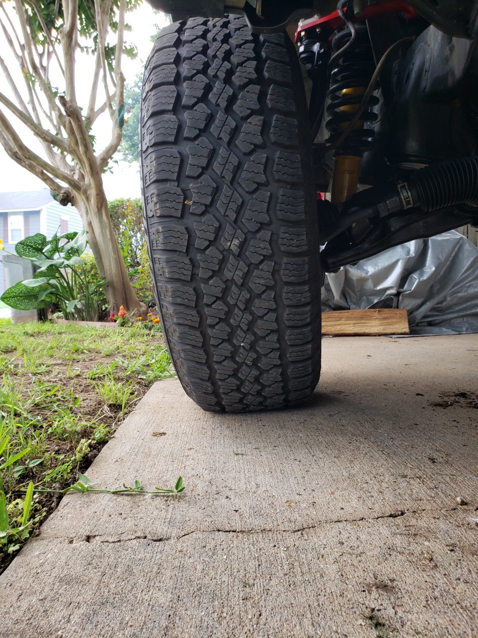

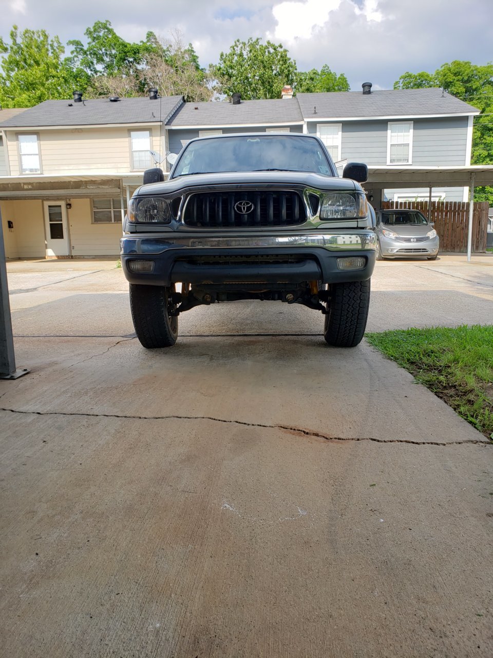

    Ok, so I finished replacing my inner and outer ties rods and this is what I've got...
    The tires don't sit flat on the pavement. Outer edge has too much contact while inner edge has none. I counted the visible threads on both sides and made sure the same number was showing when I finished up. The job was fairly simple, so I don't know how I screwed it up, but clearly I did. Planned on going and getting an alignment tomorrow, but this is nearly undrivable. A short drive around my block was terrible. Any alignment gurus out there who can tell me what I did wrong?
    Here are the passenger's side and driver's side in that order as seen from behind for clarity.
    I need to get this figured out!

    Wow that's crazy. My steering wheel was a little off after I did mine but not the camber. If you just set it back on the ground after being on jack stands for awhile it'll look a little more positive than normal but not that extreme. Curious to hear what others say.
    Hope you don't have to drive too far to the alignment shop lol.

    If you can limp it to the alignment shop then Don’t worry about it. If you need to adjust it, just unscrew the outer tie rod a few turns on both side

    Tires were off the ground when I replaced the tie rods.

    Is that just after letting it down from the jack? If so roll it back about 10 feet and pull forward again. Then re check.

    That's after driving about 100 yards.

    Do an alignment yourself till you can get it in. Take the tires off with jack stands under the lca to represent them at ride height and measure from a straight edge across each rotor on the front and back. Front should be about an 1/8 farther in than the back. Been doing all my own alignments for years this way with no issues. This should get your toe close and help fix the camber. Alignment shop will fine tune the camber though. I’m no help there

    So jack the truck up, disconnect the tie rods, lower the truck, adjust the tie rods enough to reconnect them to the spindle? The tires will sit flat on the pavement without the misadjusted tie rods connected?

    Tie rods have no effect on camber.
    Is the truck sitting higher than normal?
  20. May 31, 2021 at 8:14 PM
    Blackdawg
    Blackdawg Dr. Frankenstein
    Dec 31, 2010
    #48500
    81,652
    Monte
    Wyoming/St. Louis
    The Trifecta of Taco's
    Yeah tie rods only change your Toe not your camber.
    all 3 do have a relationship together but one being real off shouldn't change the others THAT much.
    Did you count the threads on your outers when you removed them and installed them the same?
    If not. Just take it to an alignment shop.
    You could try what Ben suggested with the tire rods at full droop. You might have bound something up. which is not good either.
