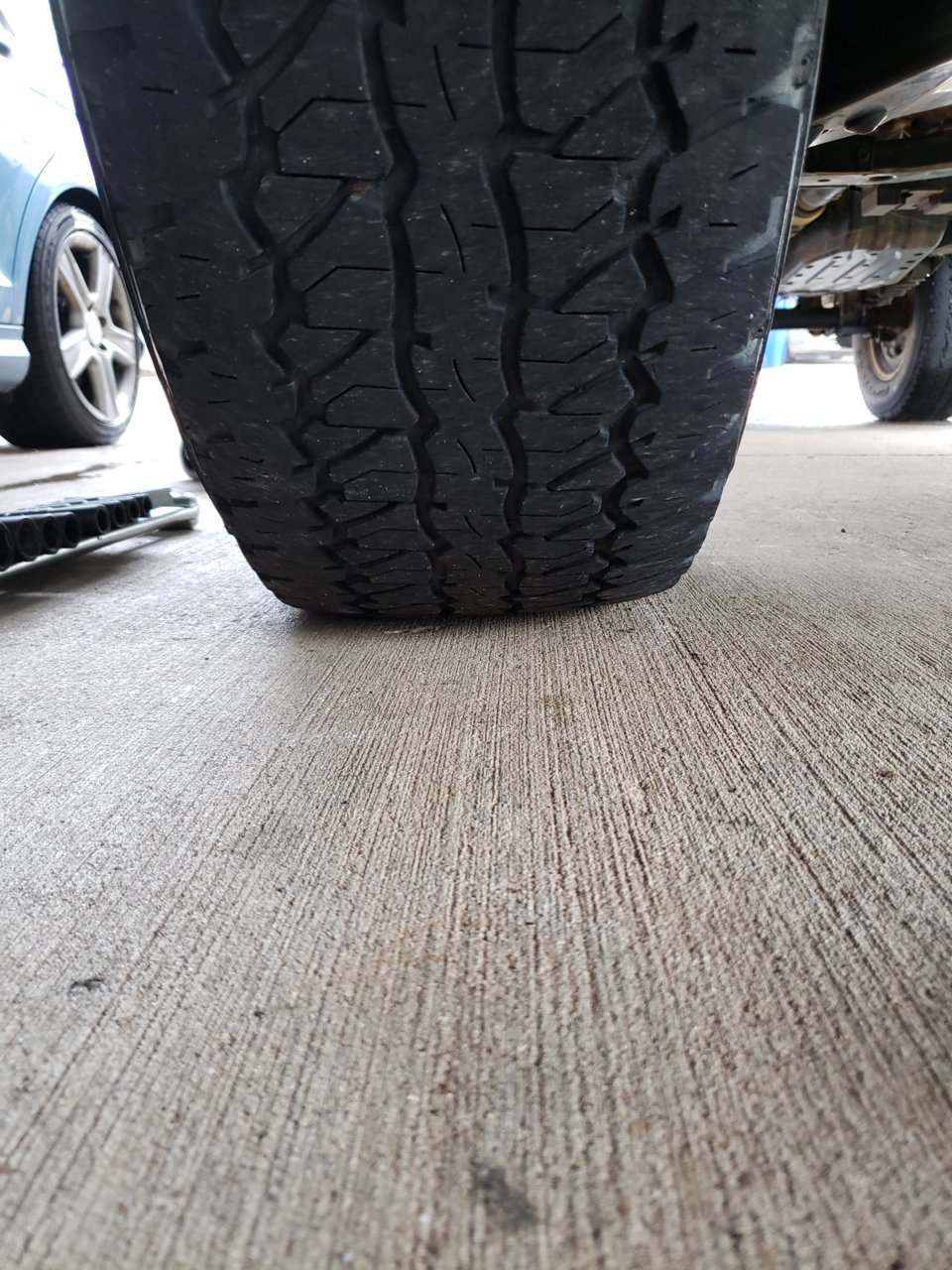

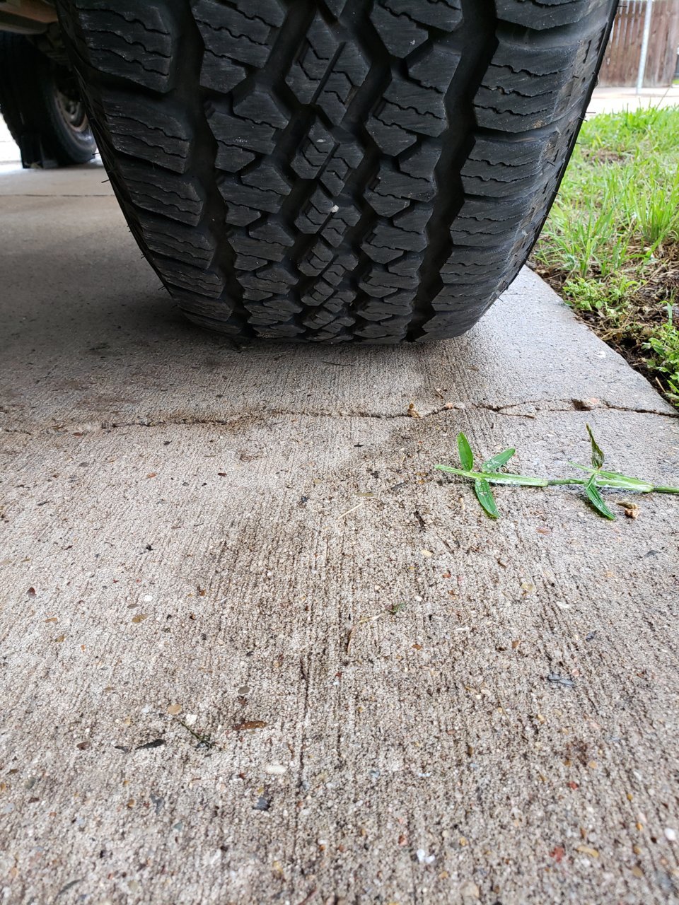

    1/8 inch at the rotor seems like a bit much to me. I used to shoot for that at the tire tread which would be much greater if I'd measured from the rotor.

    I think it is, now that you mention it. When I finished the work and was letting the truck back down I let the driver's side down first then the passengers side. Could this have caused my problem?

    My wheels looked like that after a suspension swap they went back to normal after driving it but I still needed an alignment.

    No.
    Did you try bouncing the front-end? Or drive over a couple of speed bumps.
    This is what I do after I mess around with the front and it looks like yours.
    The only other reason that I could think of is, your cam adjusters were loose and when you lifted the truck it allowed the control arms to move.

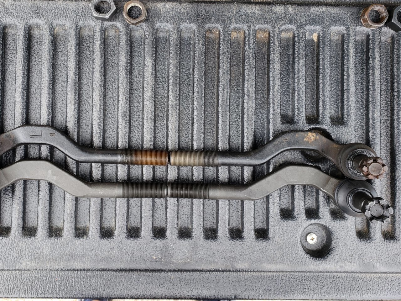

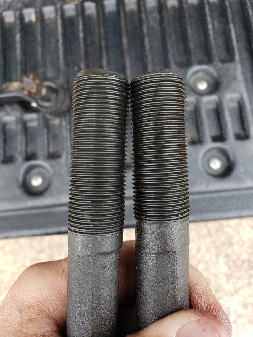

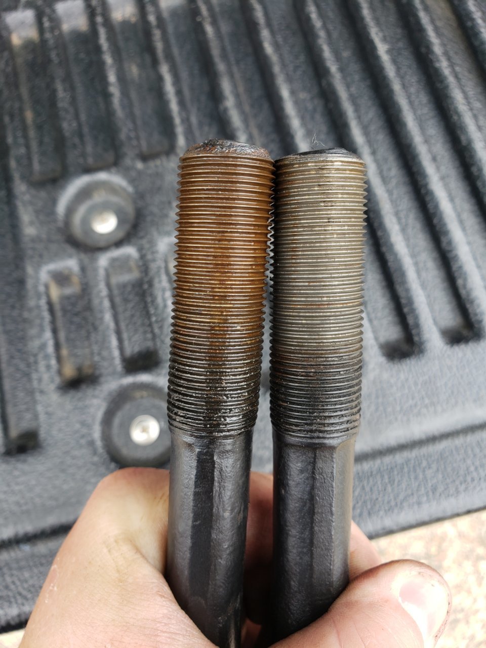

    So I pulled the new outer tie rods this AM and this is what I found...
    The old passengers side tie rod clearly has more threads than the new passengers side tie rod. I think this explains why there were 6 threads exposed on the driver's side and 13 on the passengers side before I replaced them. If you look at the threads on the new Proforged tie rods they are not perfectly equal either.
    The originals are the closest in thread length but still showed different exposed thread which I understand would be normal to achieve correct alignment.
    I checked my cam adjuster marks and they have not changed so this has to be the problem. The question is how do I figure out where to set the tie rods to get adequate alignment so I can drive to an alignment shop? I would think still 6 threads exposed on the driver's side since they appear approximately equal in thread length. But do I need more or fewer threads exposed on the passengers side to compensate for the shorter thread length of the new tie rod?

    I had the same thing when I replaced my inners/outers. The OEM outers I got had less threads on them than the ones I took off. I honestly can't recall if I accounted for that when installing the new ones or not, but I definitely didn't wind up with the positive camber issue you had. But I had the same thing happen with the new tie rods (less threads than the old ones).
    I'd just put them back on and get it over to an alignment shop (hopefully not too far away) and let them get it dialed in.

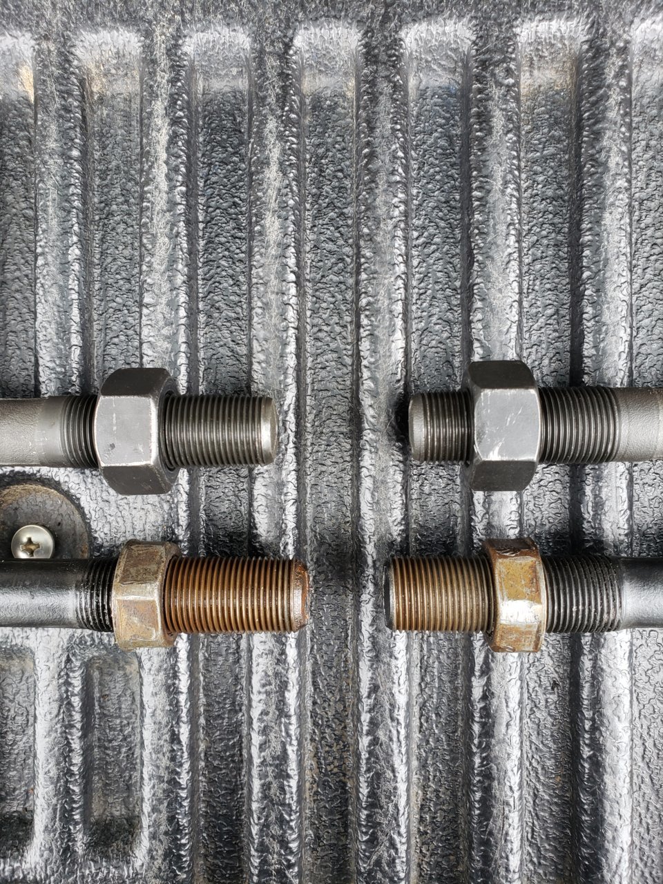

    And another consideration, the new jam nuts are far wider than the old ones. This would throw my exposed thread count off also, right?

    yes
