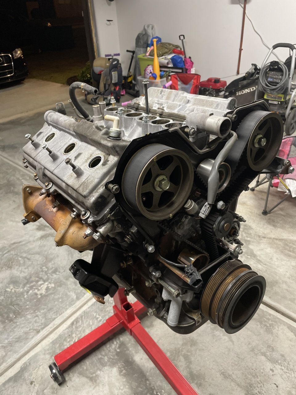

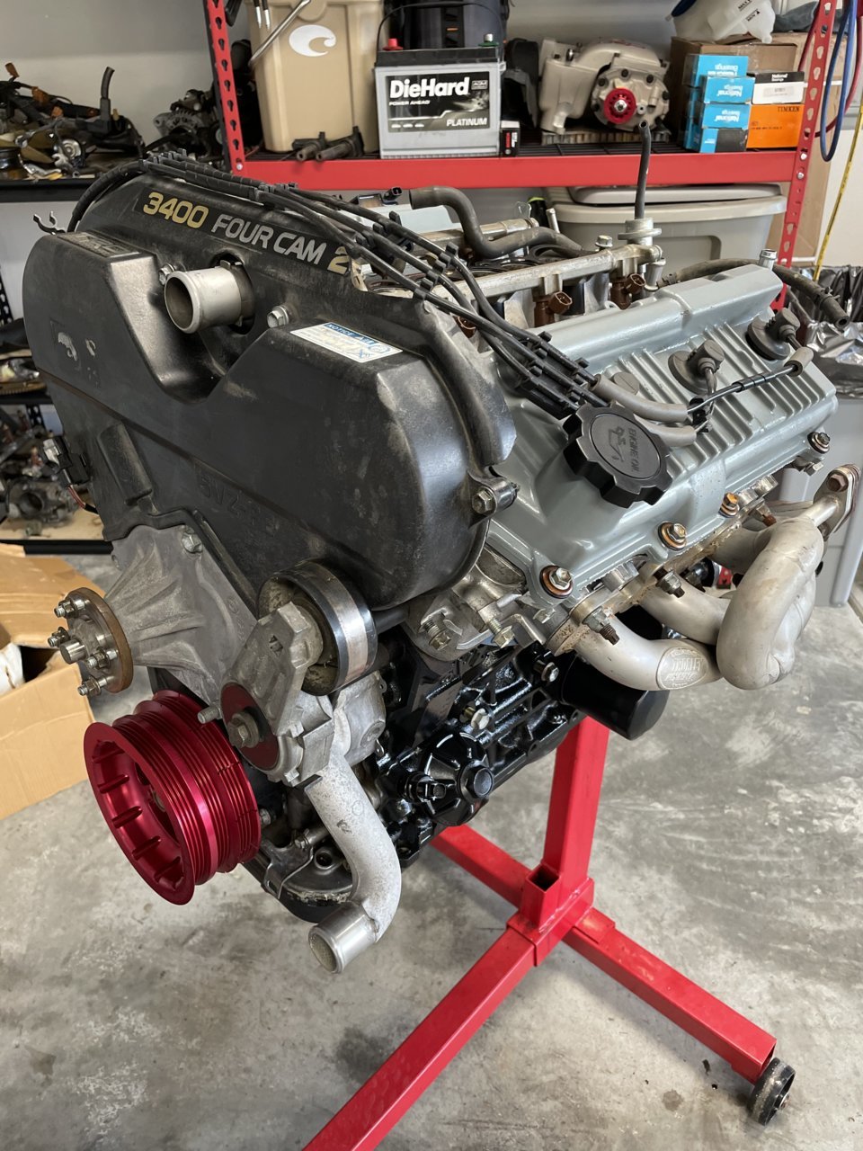

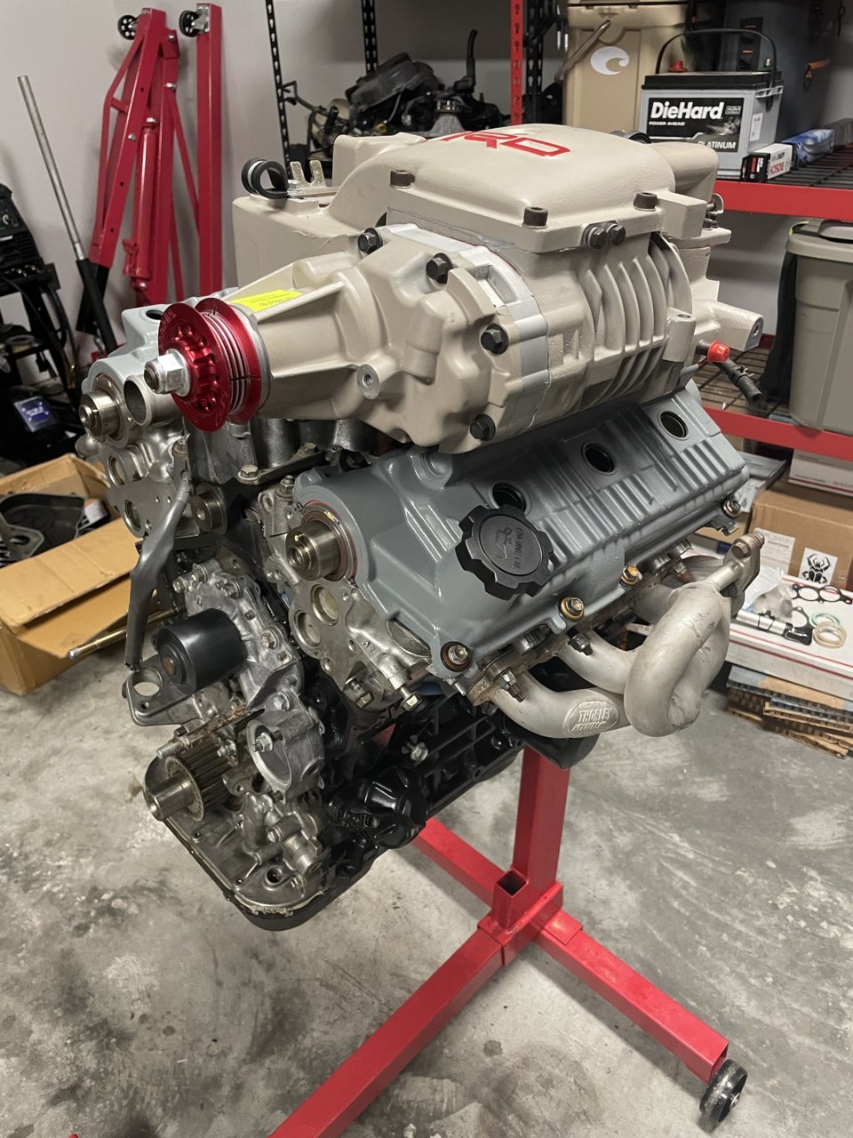

    I’ll let you know how it holds up. I’ll be keeping most of the old engine for spares. It’s not my daily driver either so 50k miles would last me a few years.

    My SC pulley is 2.2” URD as well. Will probably switch to the Pulley boys 2.0 soon. Just want to get it running at the moment so I have a good baseline. I did, however, install the Corolla thermostat and rudenium NGK plugs that were suggested in the SC thread.

    It's less Tacoma and more mod
    This is the nature of aluminum pulleys, not a fan myself unless they're an idler or something not really driven with a load. I don't like solid crank pulleys because they have no harmonic dampening and on a V6 (one of the least balanced engine configurations) that's undesirable and may lead to premature main bearing wear

    It’s looking good,
    Rebuild those injectors
    AEM fuel pump
    Fuel filter under seat

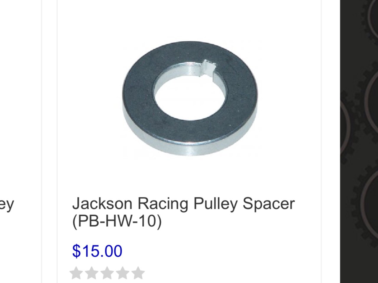

    If you get the 2” pulley you might need the back spacer that they sell too depending

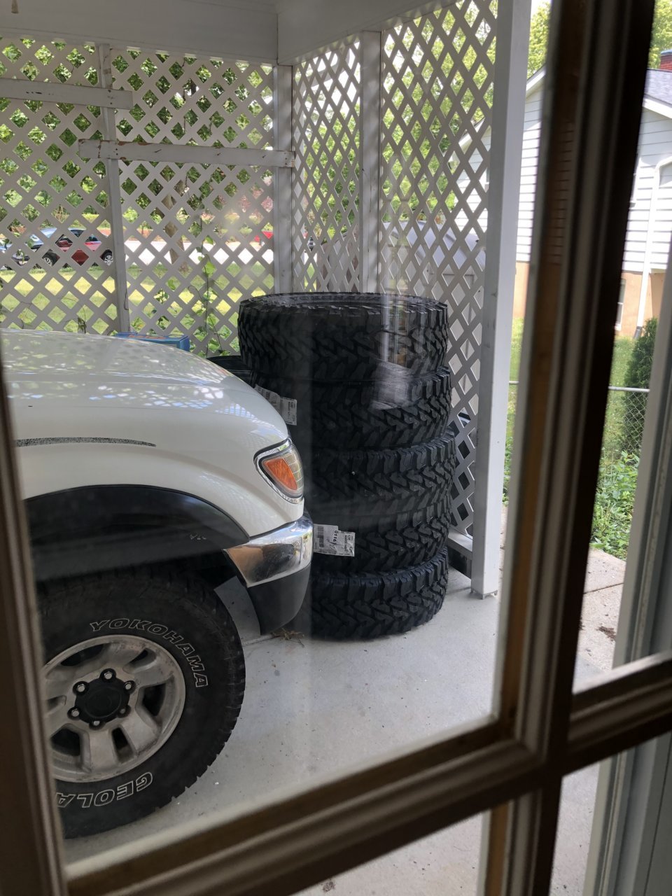

    Wife sent me this pic and said ‘I think your new tires are here’ haha well they’re not gonna fit on your civic!
  18. Jun 4, 2021 at 9:29 AM
    se7enine
    se7enine MCMLXXIX
    Apr 18, 2013
    #102322
    23,442
    Reno, NV
    Not with that attitude
