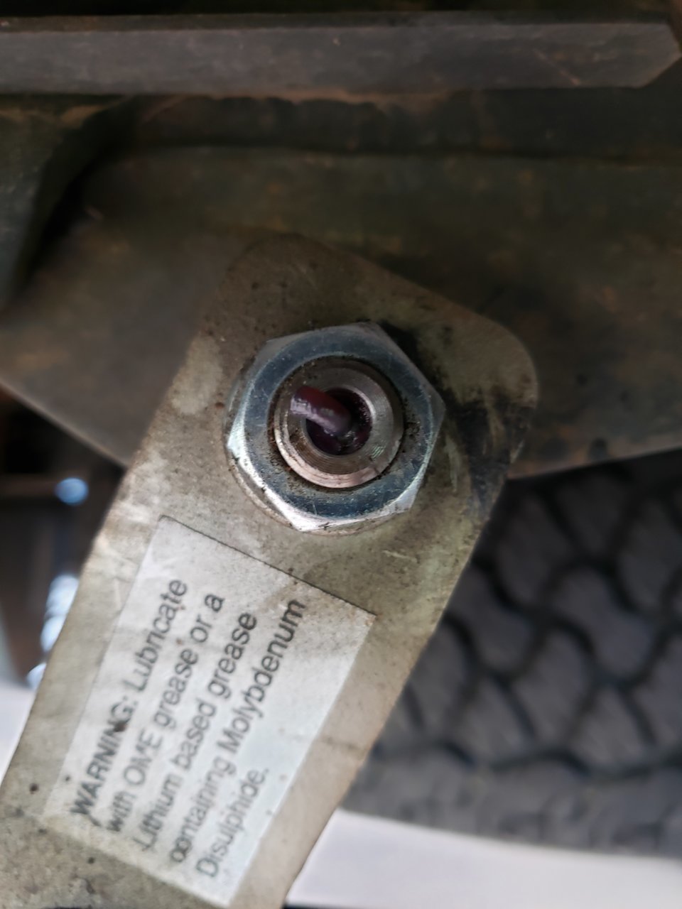

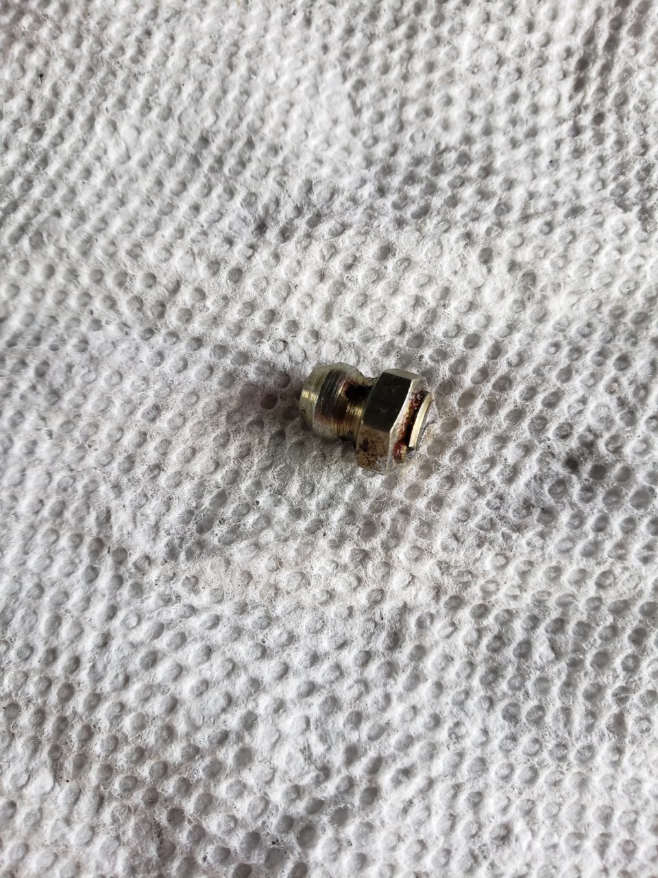

    So I was greasing my OME leaf shackles and this happened...
    Leaving for New Mexico at zero dark thirty tomorrow. How big of a worry is this and how do I get the threaded part out of the shackle?

    Mines been snapped off for over a year, it happens all the time. Nothing to worry about mechanically, it's just a zerk fitting.
    Easy to thread a new one in once you get the old broken piece out... Maybe try one of those bolt removal bits for when you snap a bolt. Still haven't tried to fix mine yet but you'll be fine for your trip

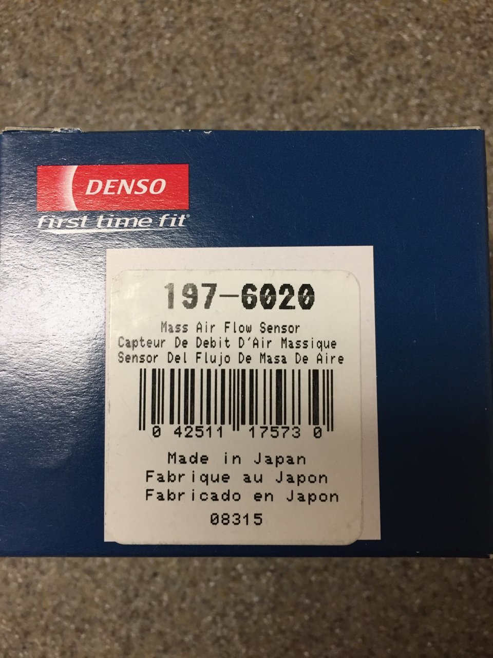

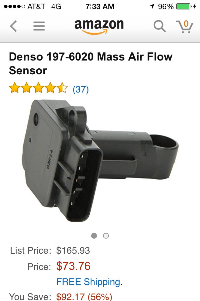

    Here’s the Denso MAF I bought from Amazon back in 2015. Been working great ever since

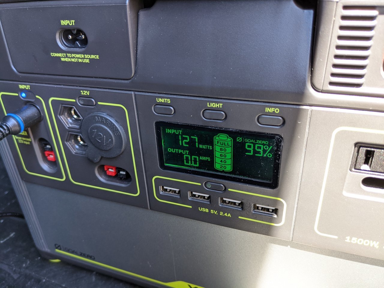

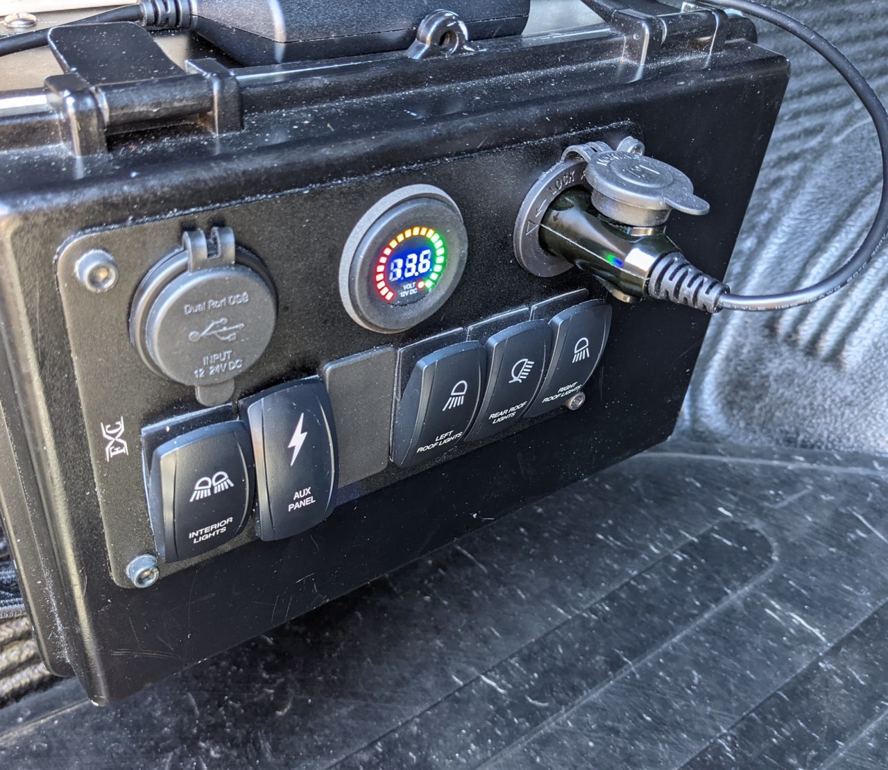

    Finally had a chance to test out charging the goal zero via their -
    https://www.amazon.com/dp/B07NRQ4KY3/
    I had originally wanted to replace the MPPT Solar Optimization Module with the Yeti Link and wire it directly into the battery but this seems to work out fine. The car charger has a 5A and a 10A selector. With the engine running, I placed it on the 10A setting.
    While I'd like the 200w Boulder solar for when the vehicle is sitting, the 100w Nomad panels the yeti came with are good enough.
    Still very satisfied with the Goal Zero. Had initially purchased this as a backup/portable for use around the house. Now instead of going with a second batt wired into the truck, I'm happy with this portable solution.
    Still working up replacing the Big 3/4/5 (whatever we're calling it these days) with 2 gauge welding cable. Wire arrived this afternoon so it'll be a day or two. I had extra 4 gauge and simply replaced what I could a few days ago just to see if there was any difference. Didn't wire directly from ALT to POS terminal but will go that route with the 2 gauge. More to follow...
    Also still working on ideas for some kind of partial divider/platform to accommodate one slide out drawer.
    Multiple projects list active :anonymous:

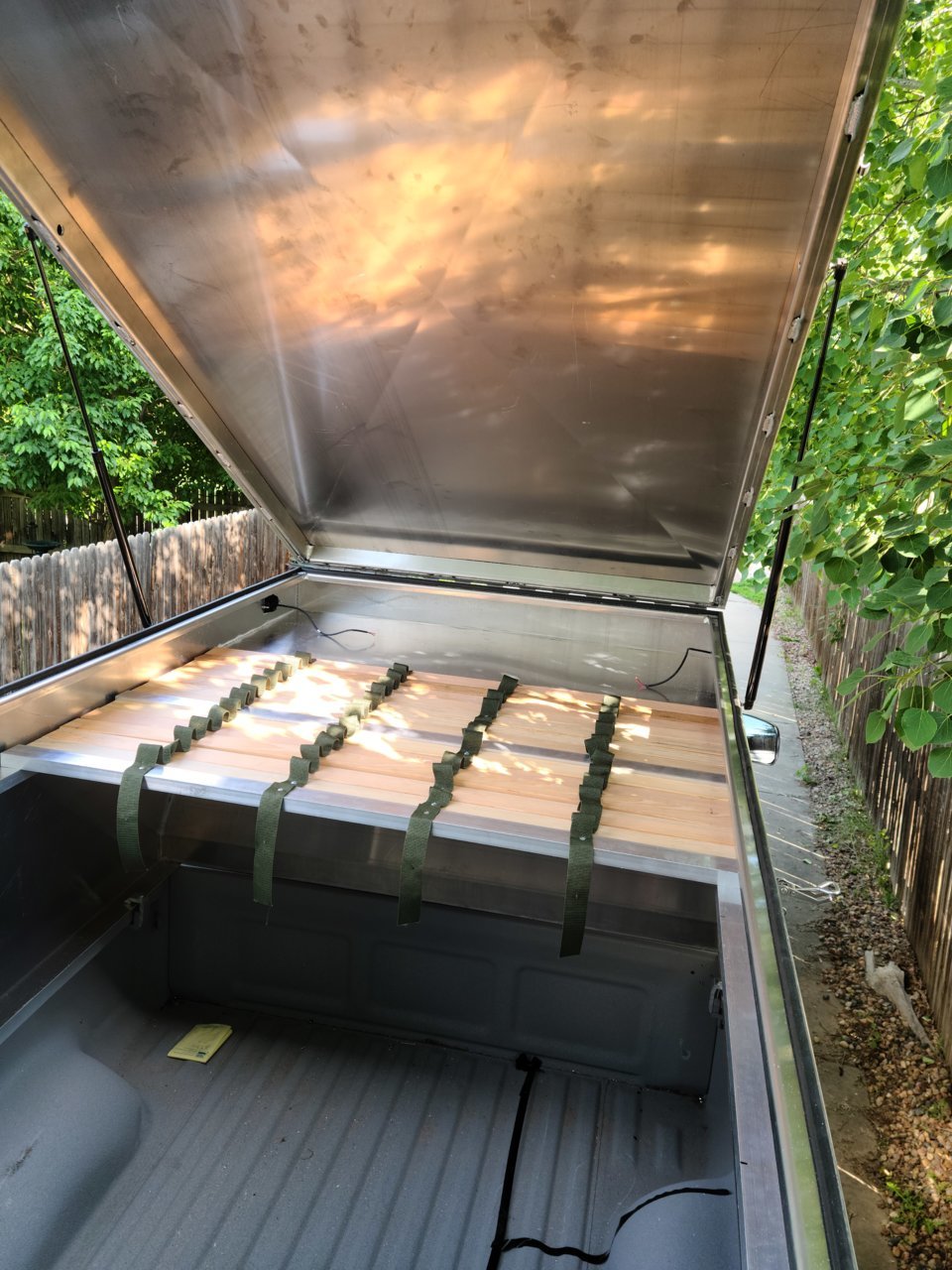

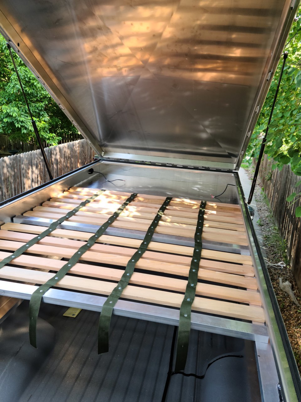

    Created the bed platform for the camper. Used mostly wood slats, but added two aluminum ones where most of the load will be placed when getting into the bed and where most of the mass will be when sleeping. I wanted it this way so it could be collapsed somewhat out of the way when not in use to give more room in the bed of the truck.
