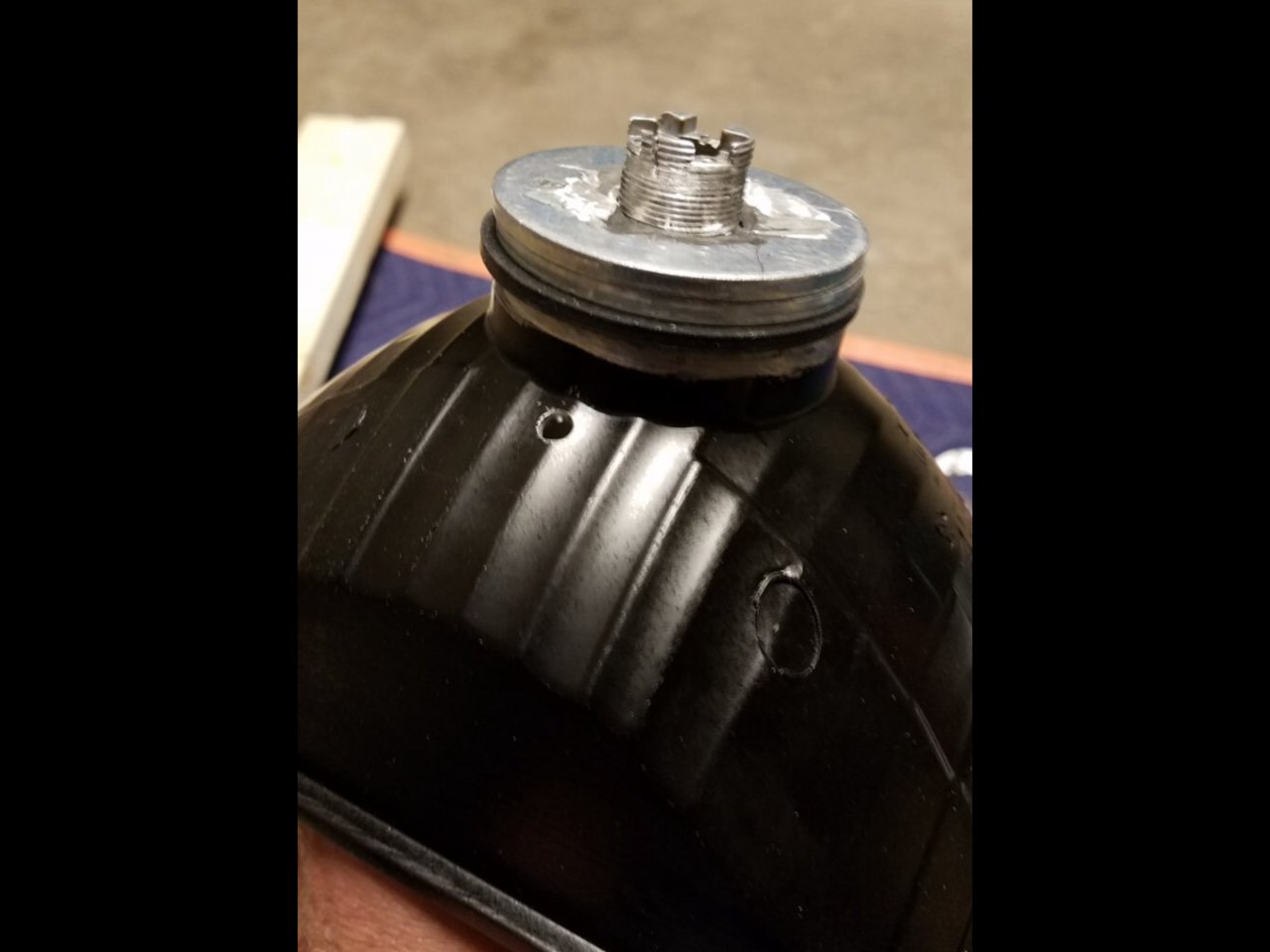

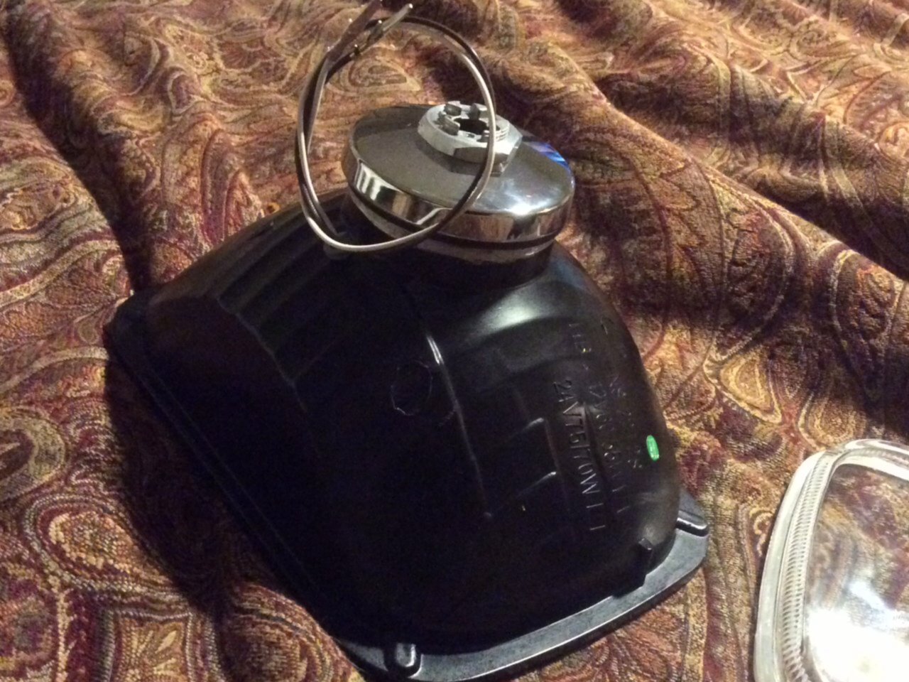

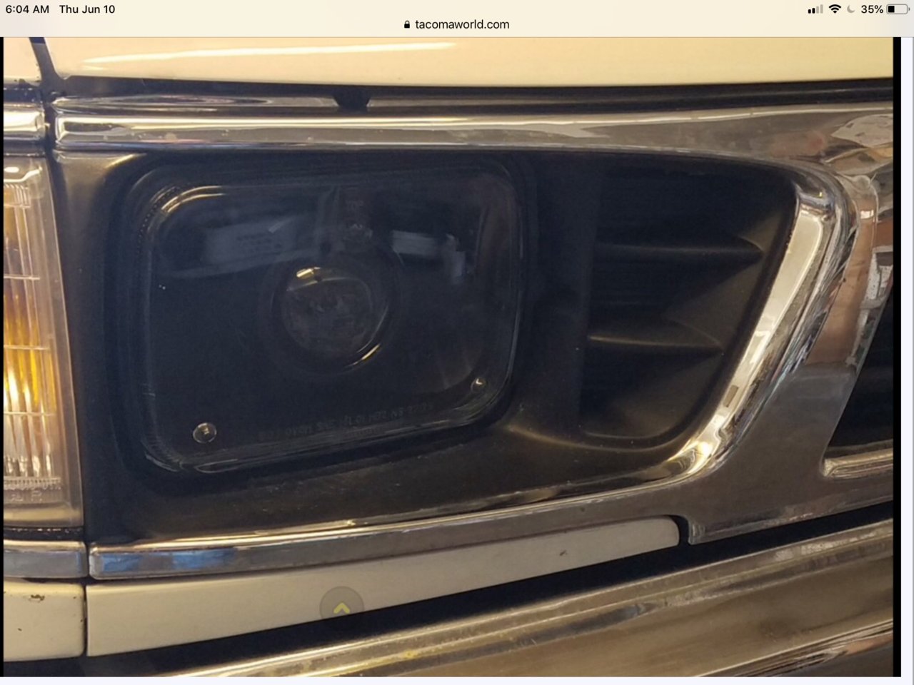

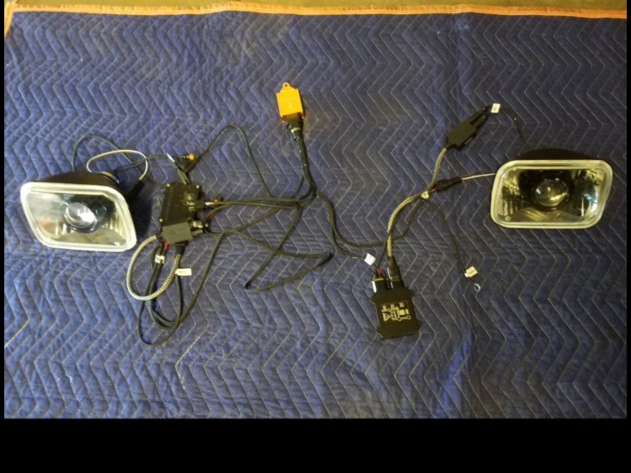

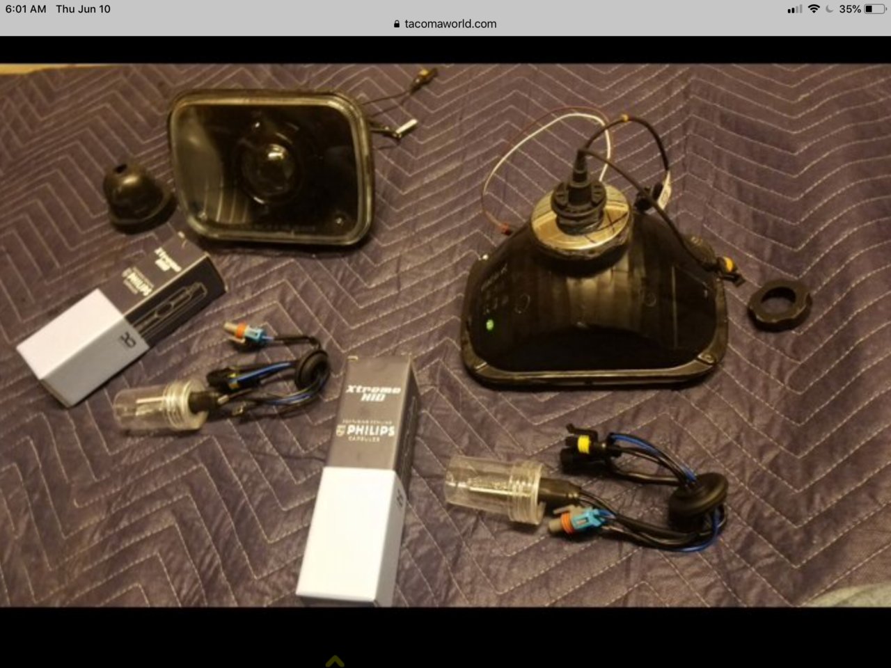

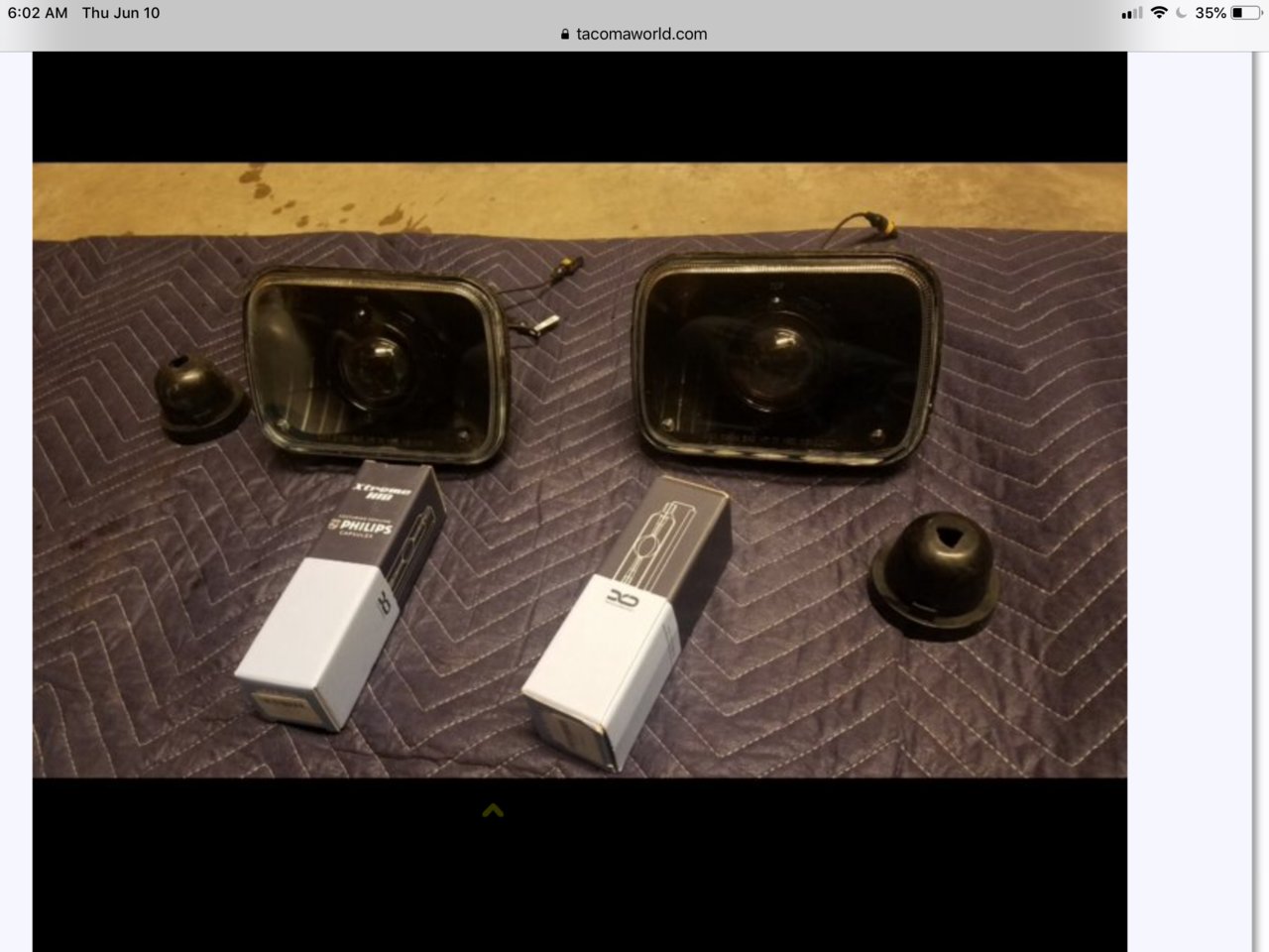

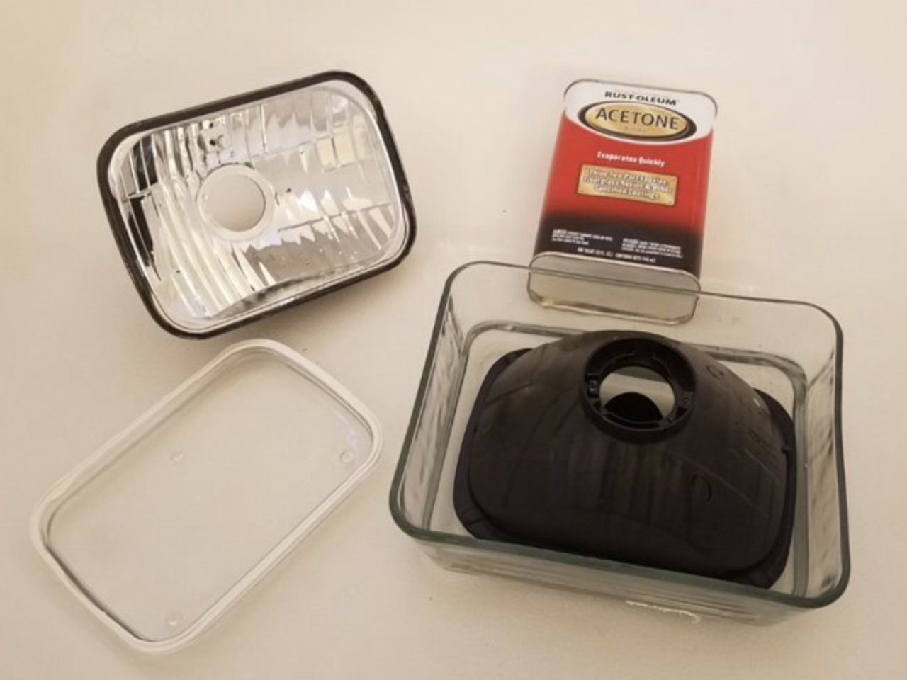

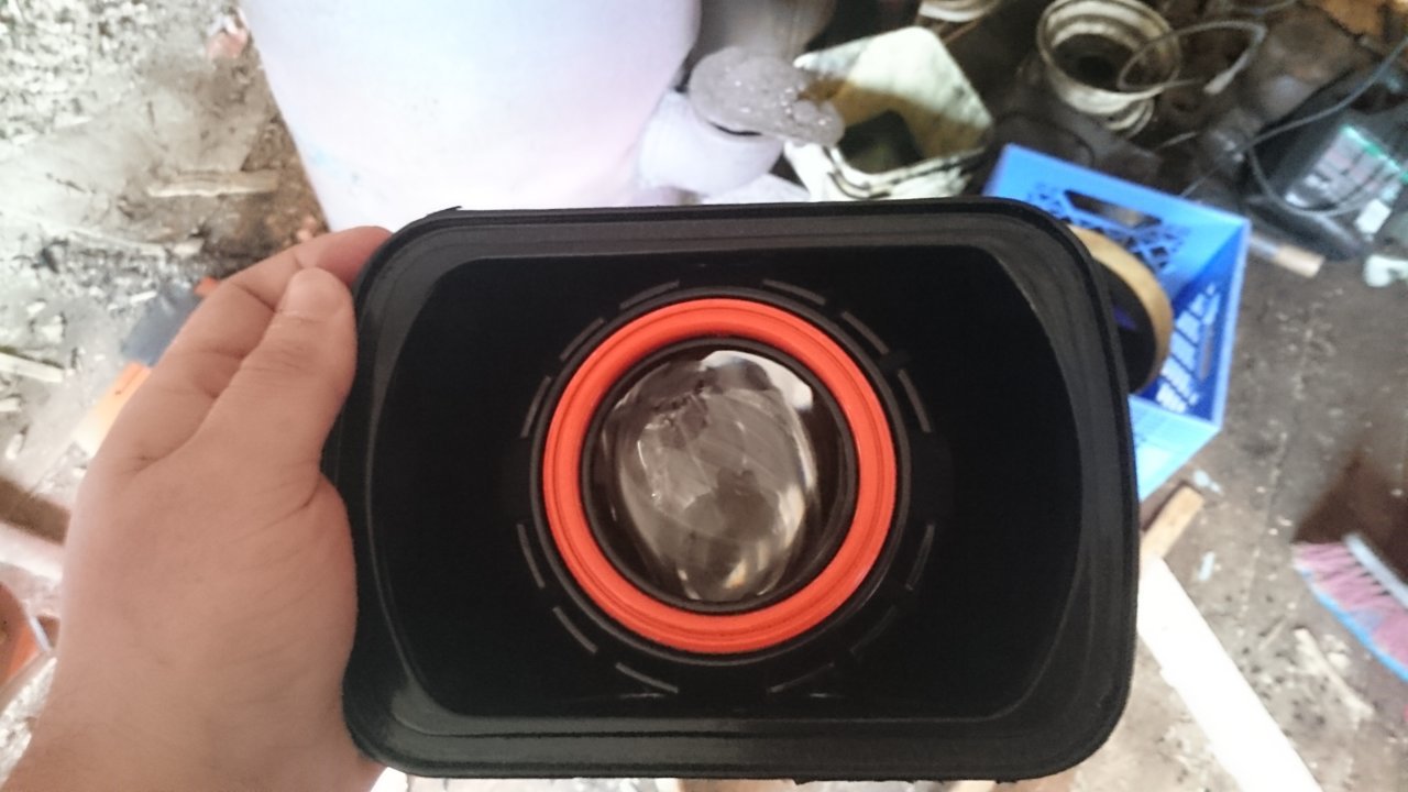

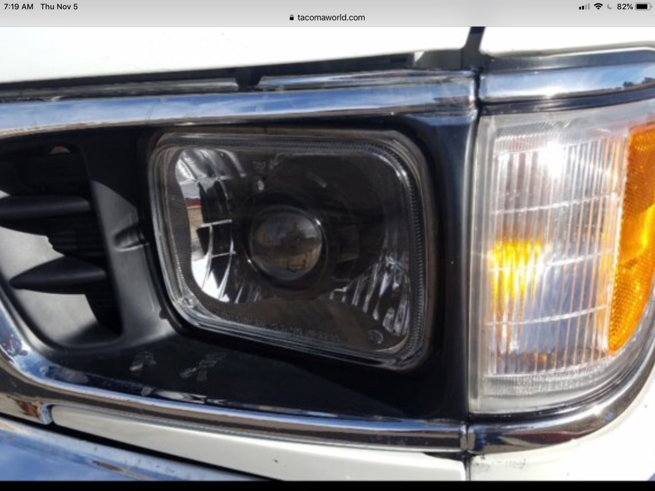

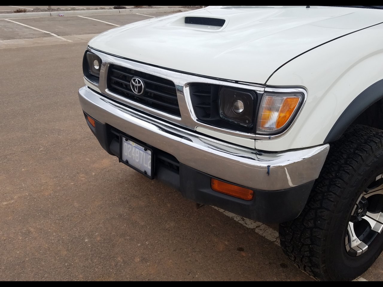

    I did mine 3 years ago, or so
    I used these, GLASS lens, ALUMINUM buckets, no JB needed ,NO PLASTIC parts, just a lot of runs to the hardware store to figure out the back end with adding washers and a metal chrome plumbing wall cover mount.
    Soaked the lens over night and the lens fell right out of the bucket too, no oven needed.
    Took a while getting the horizontal beams even but finished great,
    Was a tight fit to get the mini 7.0 projector to fit in the bucket but with a little grinding here and there inside the buckets and two layers off thin sealer inbetween the glass and bucket to get them a little more room to fit like a glove.
    There will be a number of areas to grind off to modify,
    The area where the washers stack,
    The inside wall area of the back of the bucket where the projector hits the bucket.
    Later Added Philips extreme bulbs (170.00), found some rubber boots to cover the back electrical wires on the buckets,
    painted the inside lens black
    Soo much light output power!,,,

    was to lazy to rig up a rear mount. jb weld been holding up for almost 6 years now. i actually soaked mine in gas to get them apart initially.
