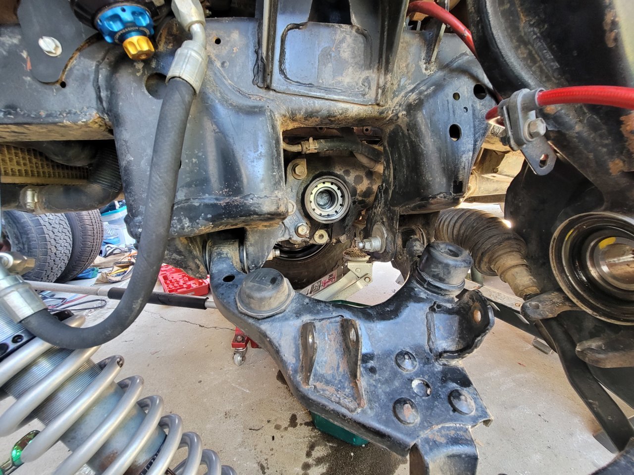

    Is it just that pic or is your driver side coilbucket about to explode?

    I was hoping that would work when I did it but about 6 months later it was puking oil again. Must've gotten damaged when the axle pushed it in or maybe it went in unevenly, IDK.
    We'll see if I can get it to actually go in with the cheap seal driver kit I got for next time, if not I'll do the axle method again and hope for the best.

    no chance that the breather is plugged is it?

    I'll give it a check just in case, hadn't thought of that thanks!

    Try freezing it, but be careful, it makes it much easier to push in too far.
    This. But also verify it's not coming from the breather.
