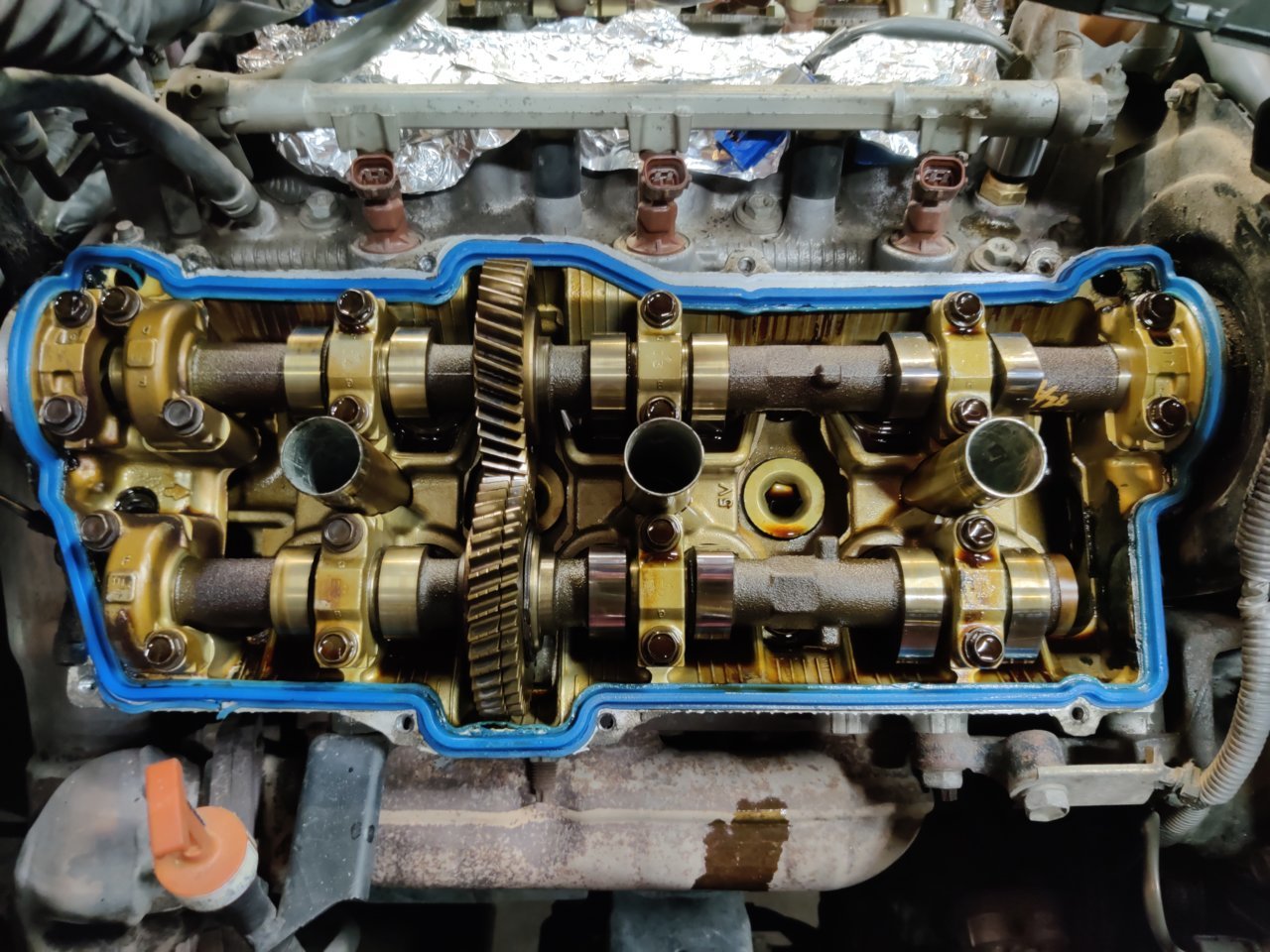

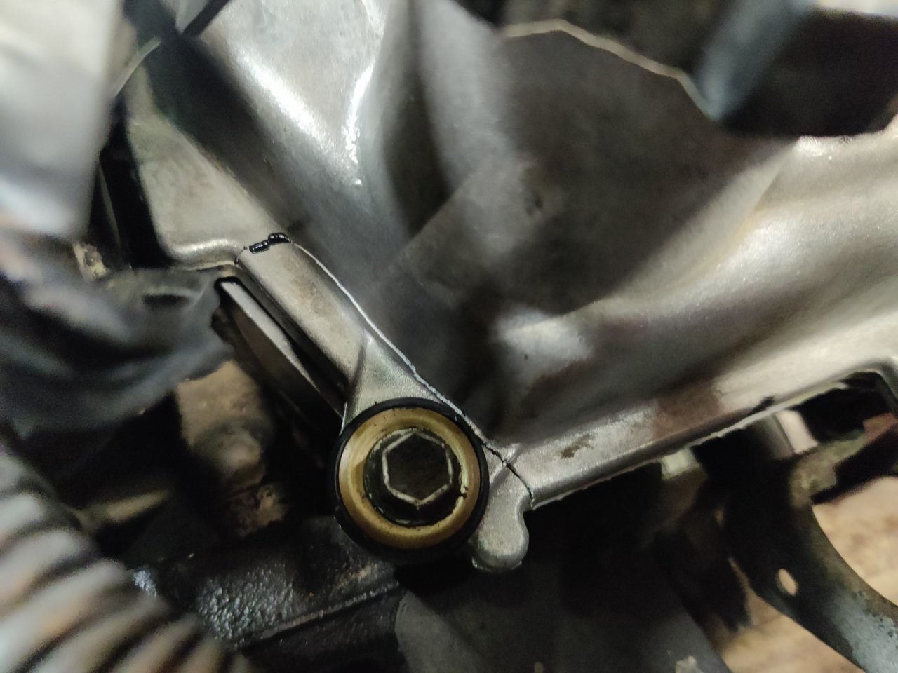

    It actually went pretty smoothly except for the part where I cracked the valve cover.
    I need to get a better torque wrench
    On the plus side I was pleased with how clean the engine looked underneath. I was a bit intimidated when I started and I didn't finish until 4:30 in the morning but hey I drove the truck to work today and so far no leaks. The last time I removed a valve cover was for an old Honda civic back in 2009

    how the hell did you do that? Only supposed to be like 9 in/lbs of torque. Like finger tight on those bolts.

    how many miles on that engine?
    Looks like it’s been properly maintained.

    I think it had a slight crack when I started but I know I over tightened it. I was having technical difficulties with my shitty cheep torque wrench. The locking nut loosened its self and I was adjusting the handle with out realizing it. I really didn't go crazy tight I think 12ft lbs is what I was aiming for.
    At least now I get the pleasure of doing it all over again once I get my hands on a replacement valve cover. Hopefully it will be a little less time consuming the second go around

    A little over 317,000 miles.
    The passenger side wasn't quite as clean but it still looked pretty good

    Okay but seriously. It's not ft/lbs. It's in/lbs. A standard torque wrench doesn't go that low you need a separate one for inch pounds usually.
    It's really just hand tight. Super light but important to get them all equal for the gasket to work properly.
    Not trying to be a dick just want to make sure you didn't read the spec as ft/lbs.

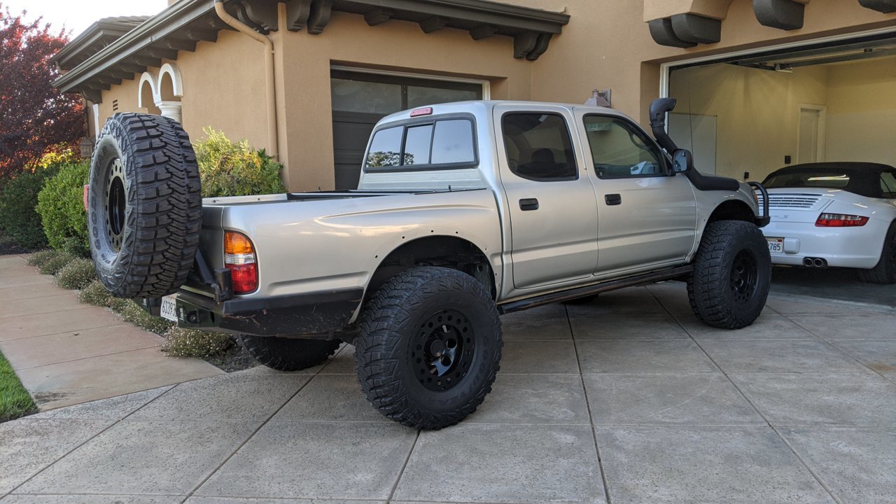

    I haven't posted here in a while, but I put 35s on my truck today.

    I wouldn't count on that too much. You're still stressing the tcase/transmission if you are sitting on that.

    Looks like a giant mud bucket

    saw the tub job on insta, clean fab work you did! Is the 911 your daily?
