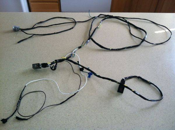

    ya, this is the wiring guide i used. i just made my own harness (with a relay) to use the factory switch, and ran that back to the locker. I left out the indicator light because i didnt want to deal with finding that in the dash
    Top left is the locker end of the harness, bottom left is the in cab ground lead and where i tapped 15a 4wd fuse. Bottom right is the in dash factory switch, and the middle where it all runs together is the relay i tucked behind the kick panel
    after doing all this work and having it for years..my opinion: buy an ARB, its just better in every way.

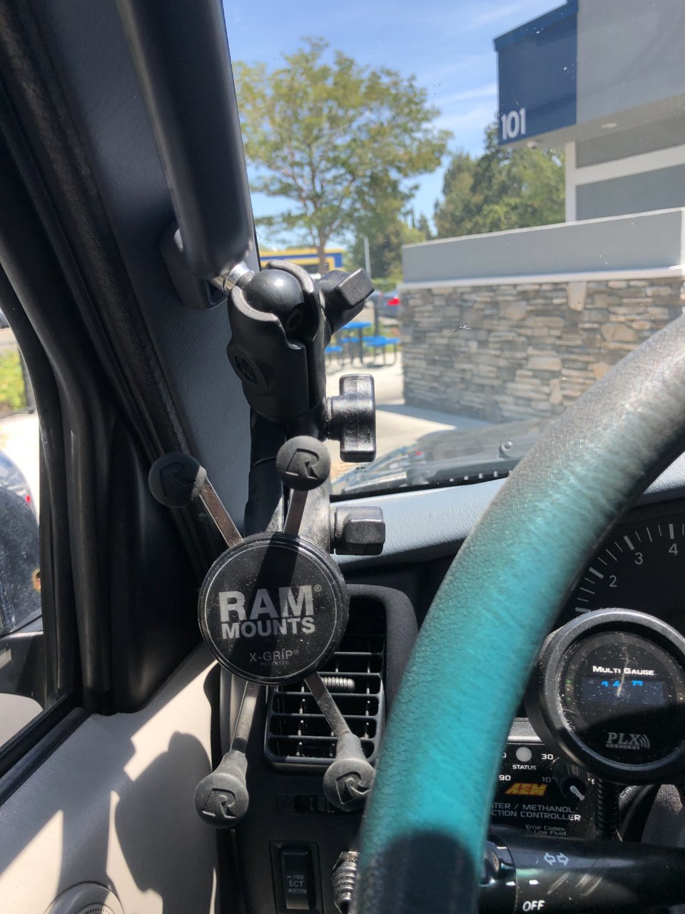

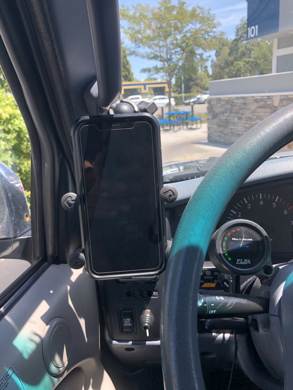

    It’s a RAM X-Grip. They’re good products, they put them in commercial aircrafts and motorcycles. I have it bolted to the grab handle.

    I've bought so many cheap POS phone holders that don't last more than a few months, I should just get one of these.

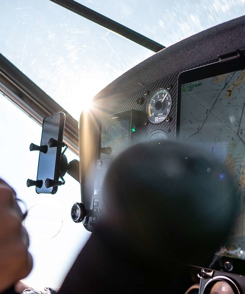

    I’ve seen them used on Boeings to hold chartplotters. Here’s one being used on a Cessna, same X-Grip.

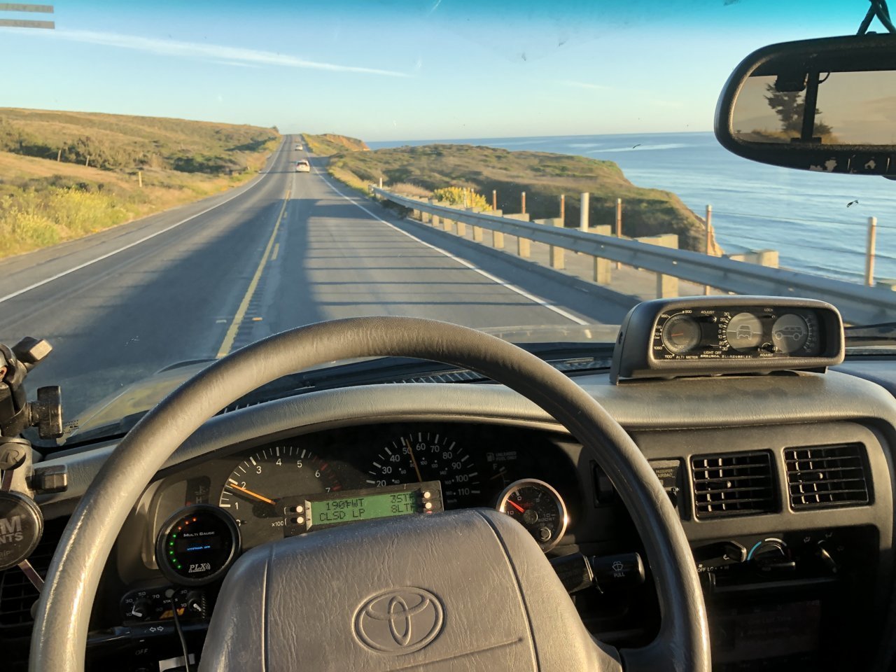

    my one complaint with that mounting location is that your phone blocks the air vent. The center air vents in my truck don't really do much, so I get pretty much all of my AC from that left vent

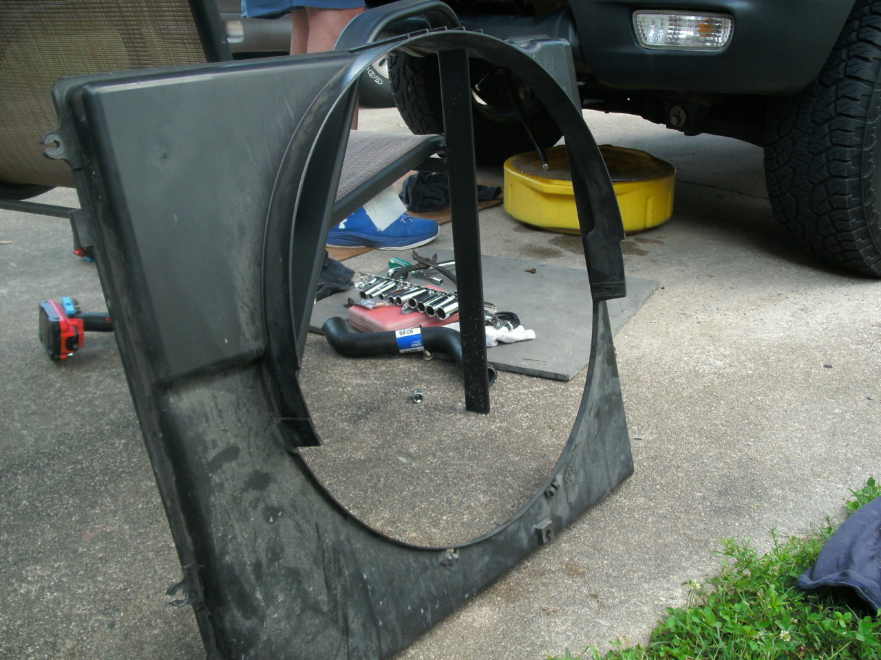

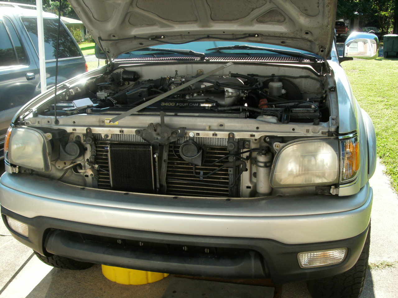

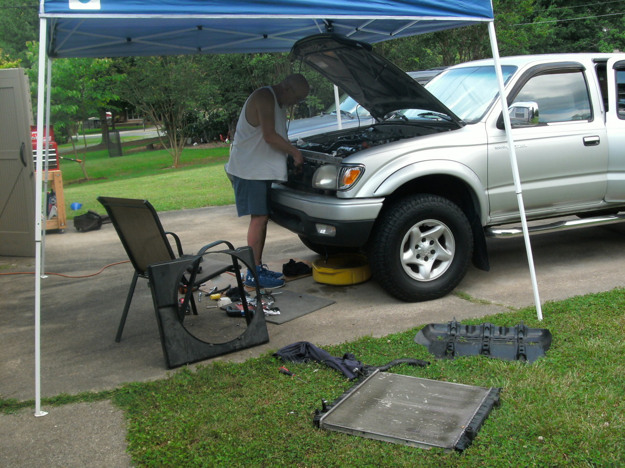

    Well I installed my new radiator, hoses, thermostat, and external transmission cooler today. Not completely finished, but only have to fill up radiator, burp it, make the last connection for the cooler. My body hurts so bad, like I just finished 3 rounds with Mike Tyson. I'll post a pic maybe later tonight, or tomorrow.
    Here's a couple of pics, and I'd like to give credit to Zero4 for his write up on mounting the external cooler. Also on the pic of just the fan shroud, am I missing a piece that goes on the bottom of the "half" circle.
    Update, learned a lesson today. I purchased a 180 degree thermostat and gasket from Napa. It didn't fit as tight as the one in the truck. when I put the housing back on to the truck, the thermostat slipped out of its place, and the gasket got pinched, and leaked almost a gallon of anti freeze out. really pissed me off, and cost me $20.00 dollars. So I removed the "Napa" thermostat and re installed the one that fit like a glove. Only reason to change it, was I wanted the 180 degree to try and keep my overall temps down. Lesson learned, this is one of those "I should have bought OEM Parts".

    pretty cool, thanks for the reply. I could only see the right two knobs, so it peaked my curiosity.
