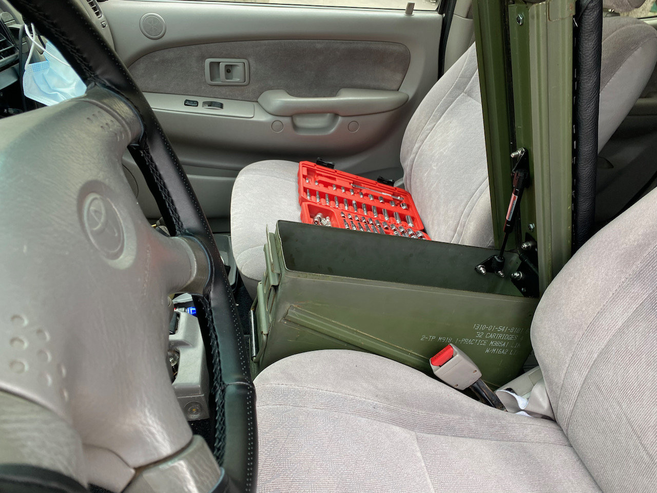

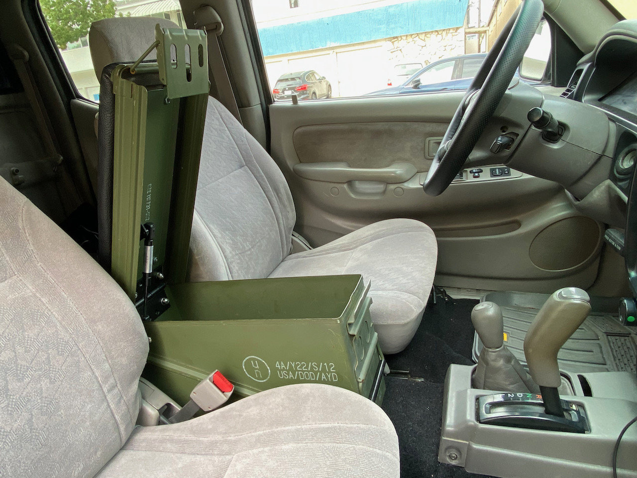

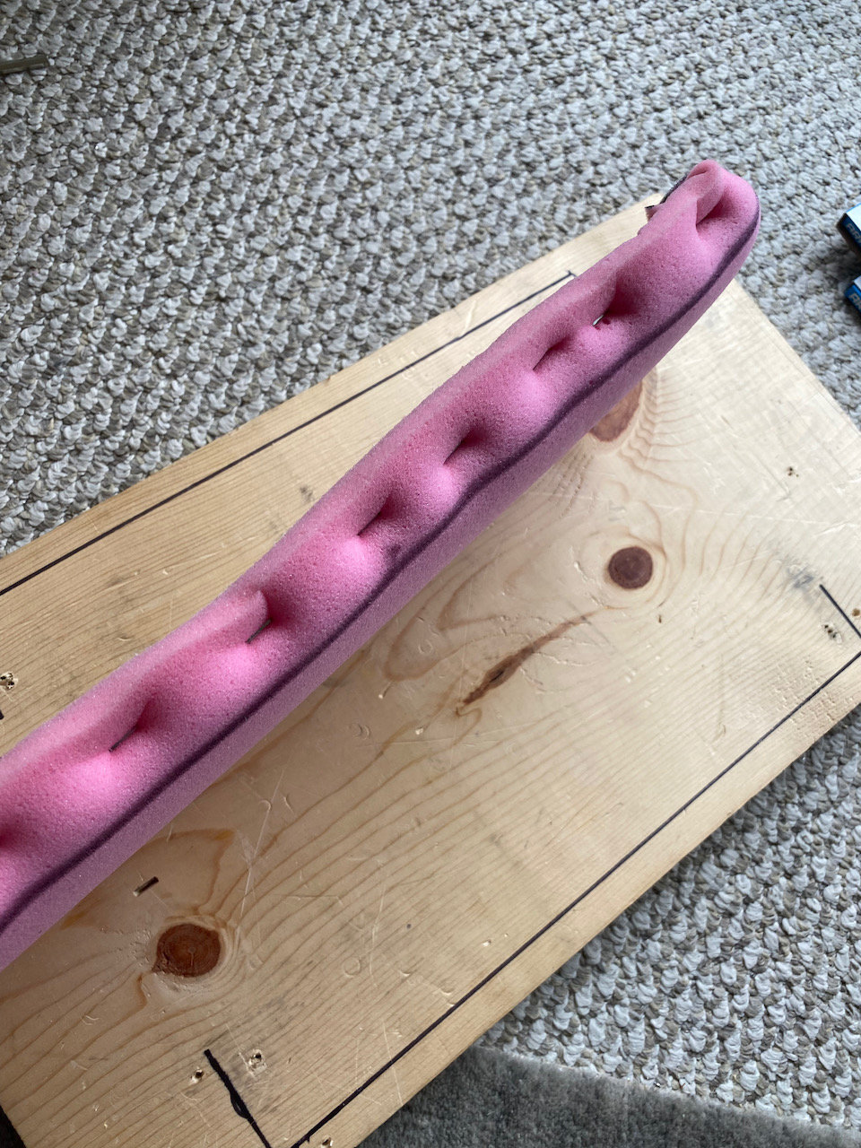

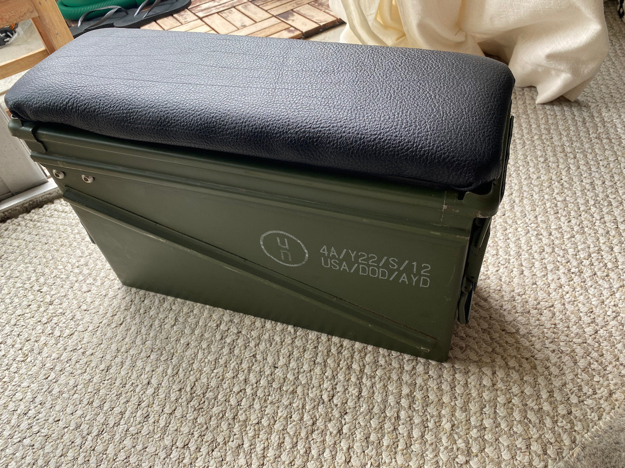

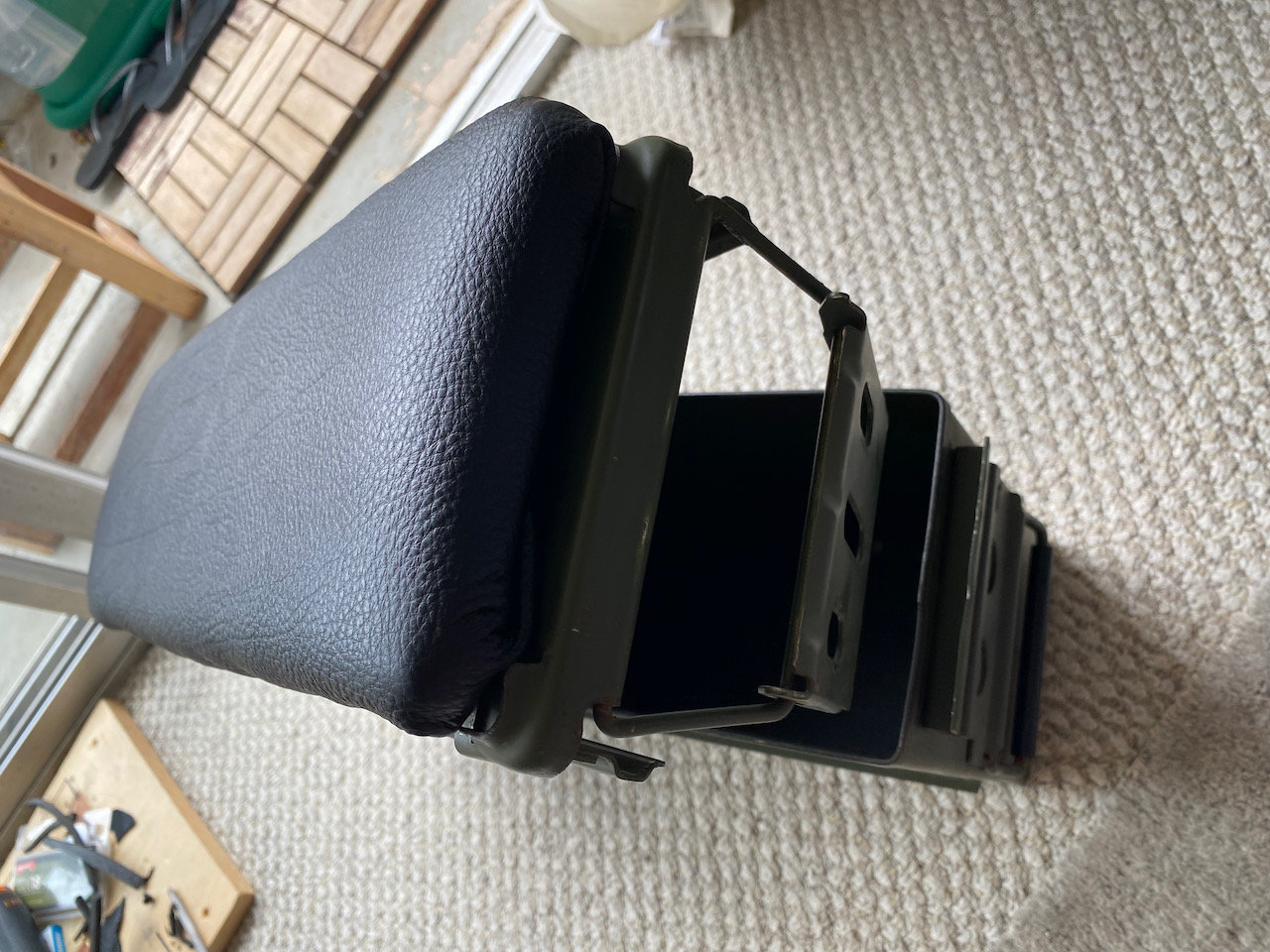

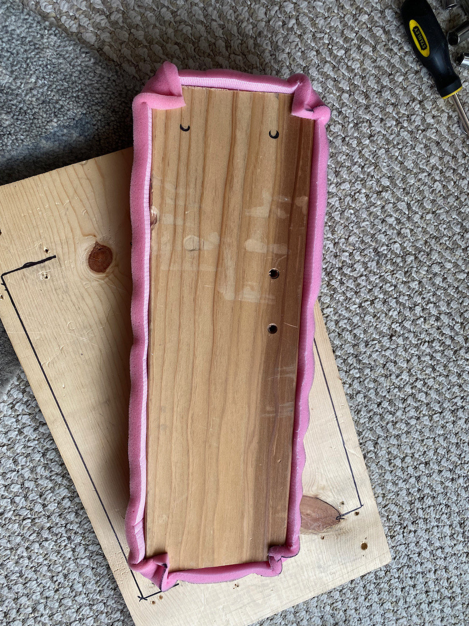

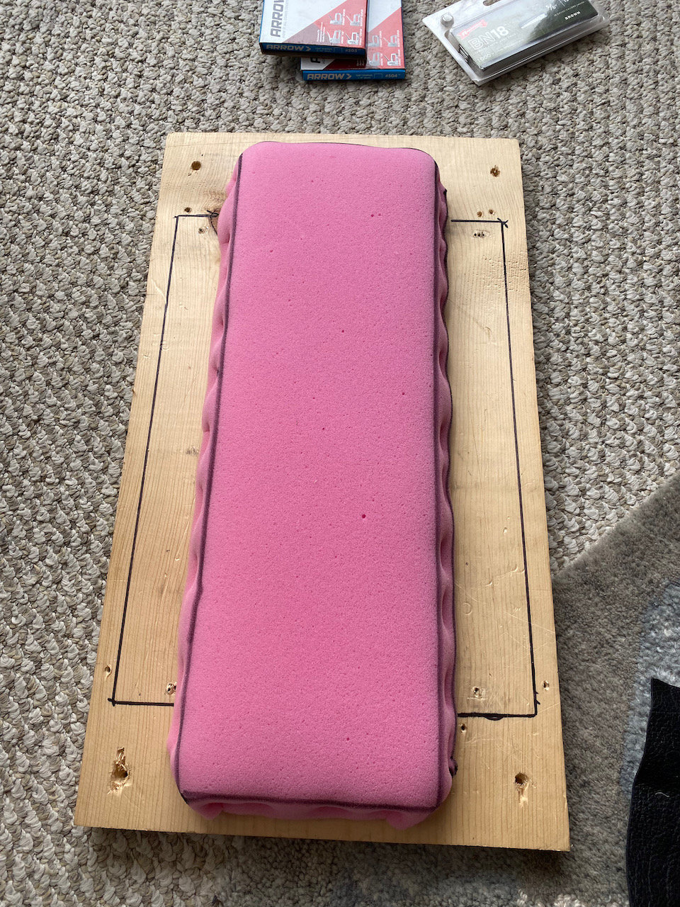

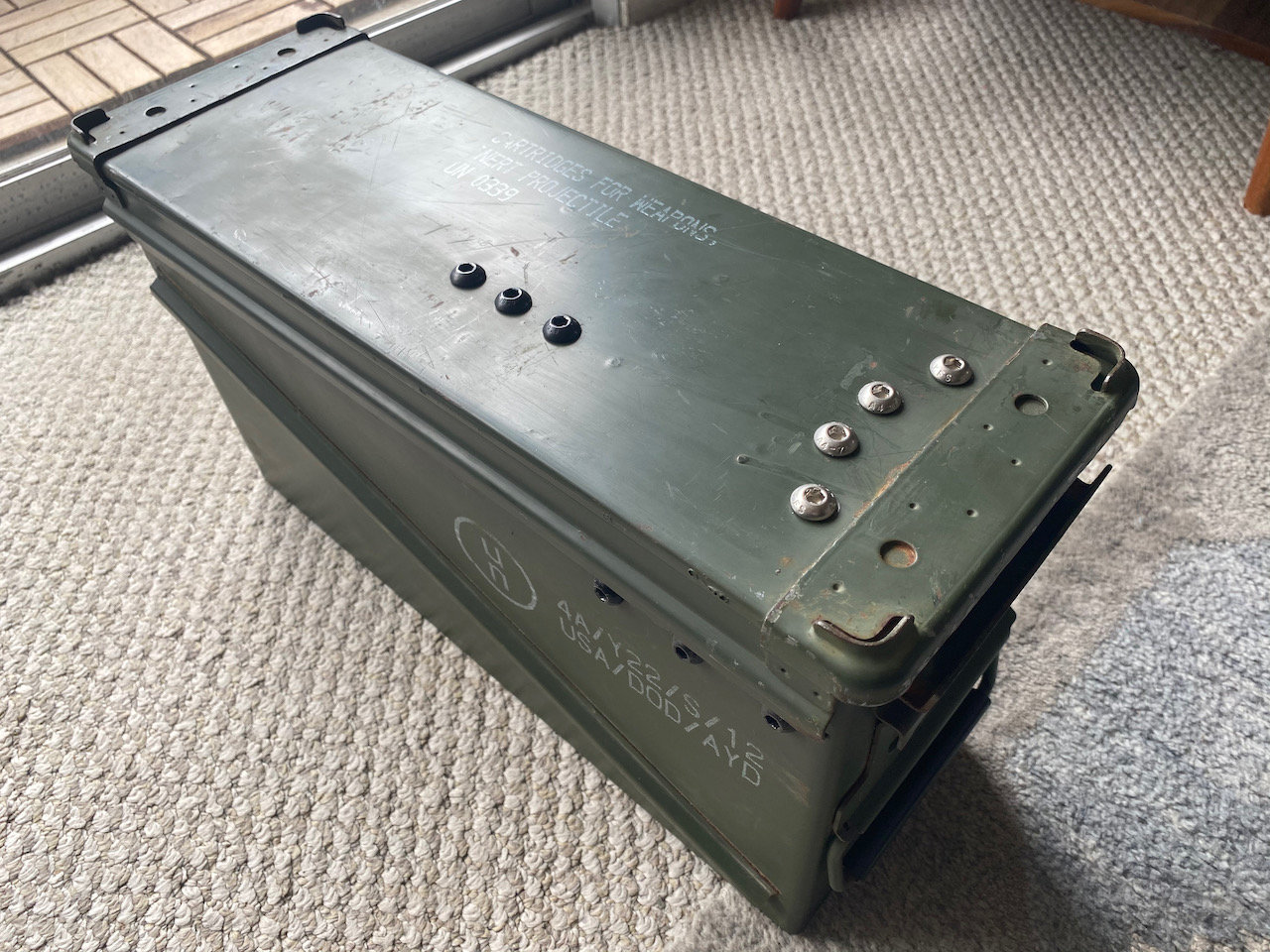

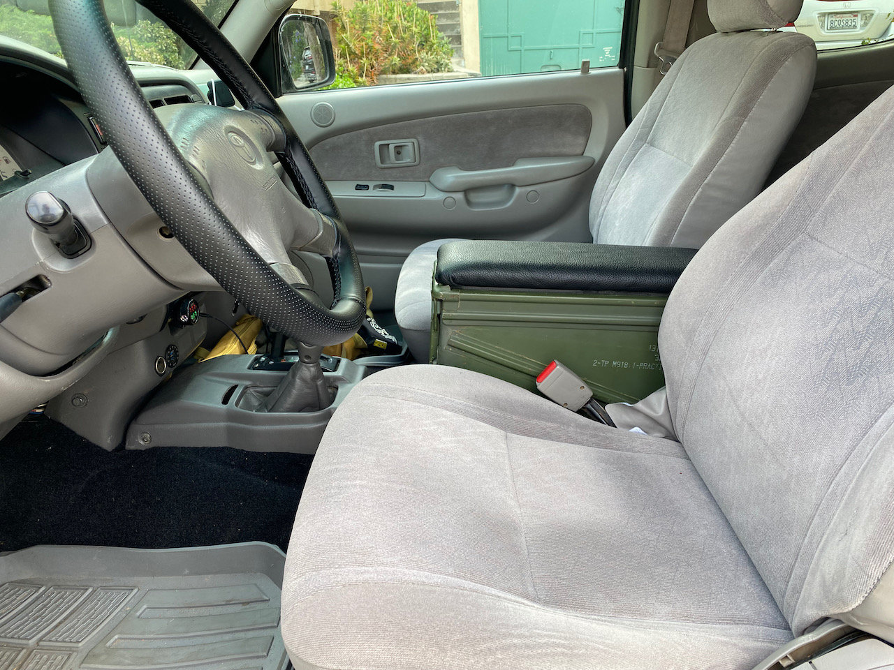

    its actually very comfortable. I should have double up on the padding. But it looks weird and puffy with too much padding. Over all I built 2 of these suckers actually. another one as back up :) in case this one was going to fail / but it all worked out

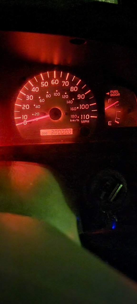

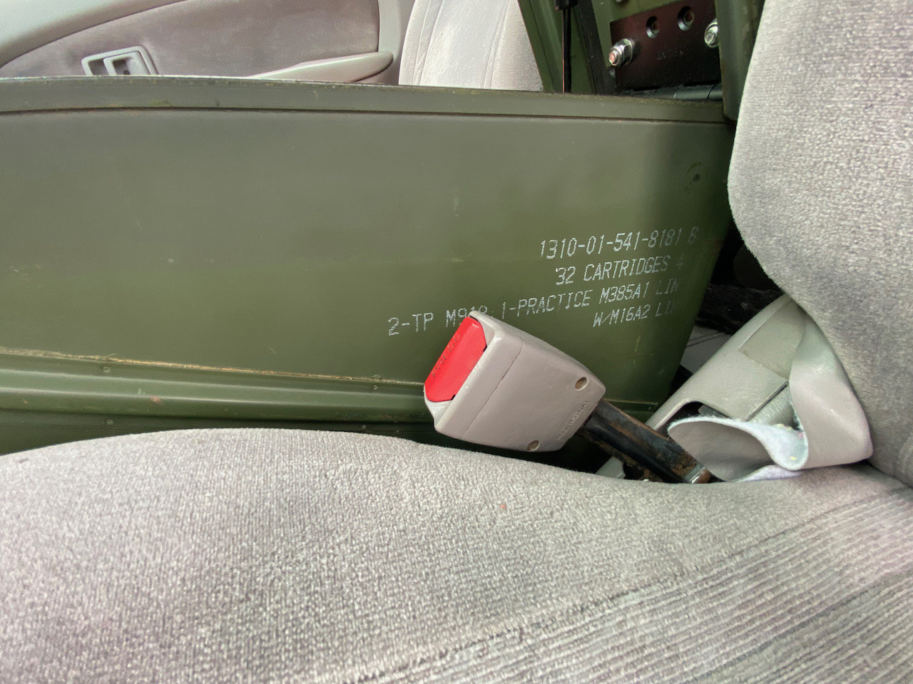

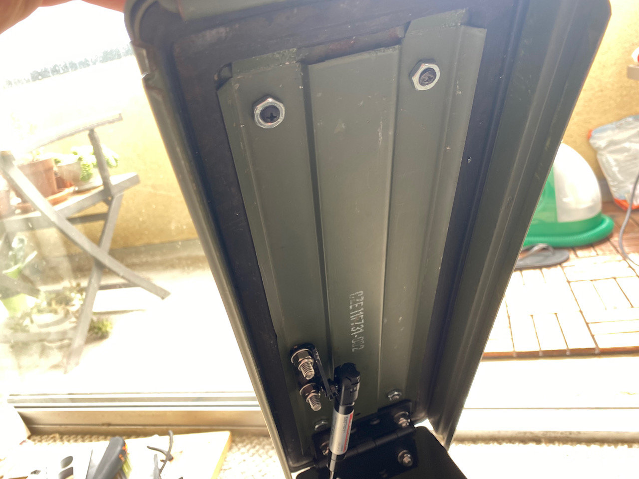

    Its a an MT120 ammo box purchased used via Amazon https://www.amazon.com/gp/product/B006A7L2C2/
    Gas Spring (lift support) also amazon https://www.amazon.com/gp/product/B00K2FVYNA/
    Don't forget to get bolt up hardware for lift support. Like ball joint.
    Also a HD steel hinge from amazon https://www.amazon.com/gp/product/B01ACLFPDS
    Bolts, memory foam and leather I already had.
    Measure, drill bolt it up. Rear portion of the ammo box lid I had to cut using a grinder.

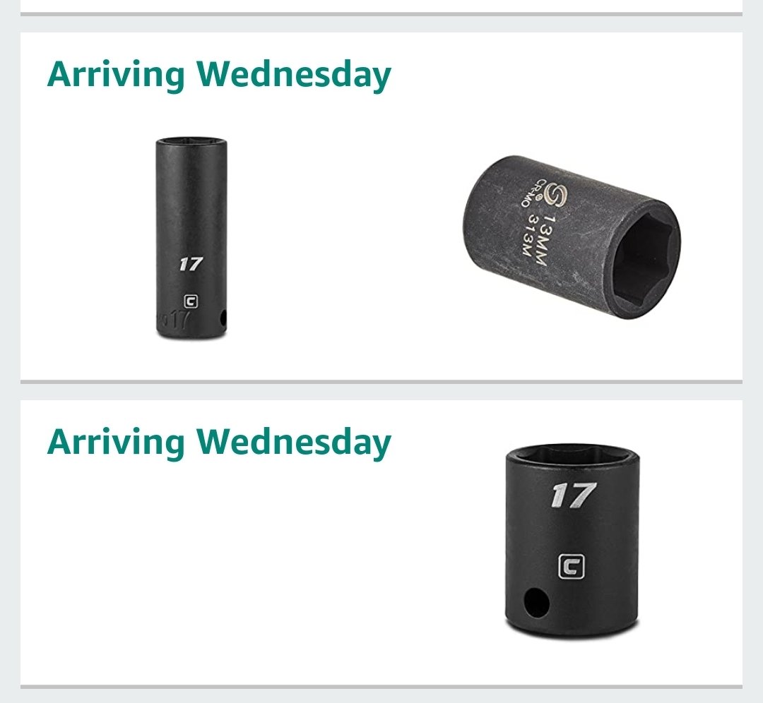

    Going through the tool kit, ordering the missing pieces.

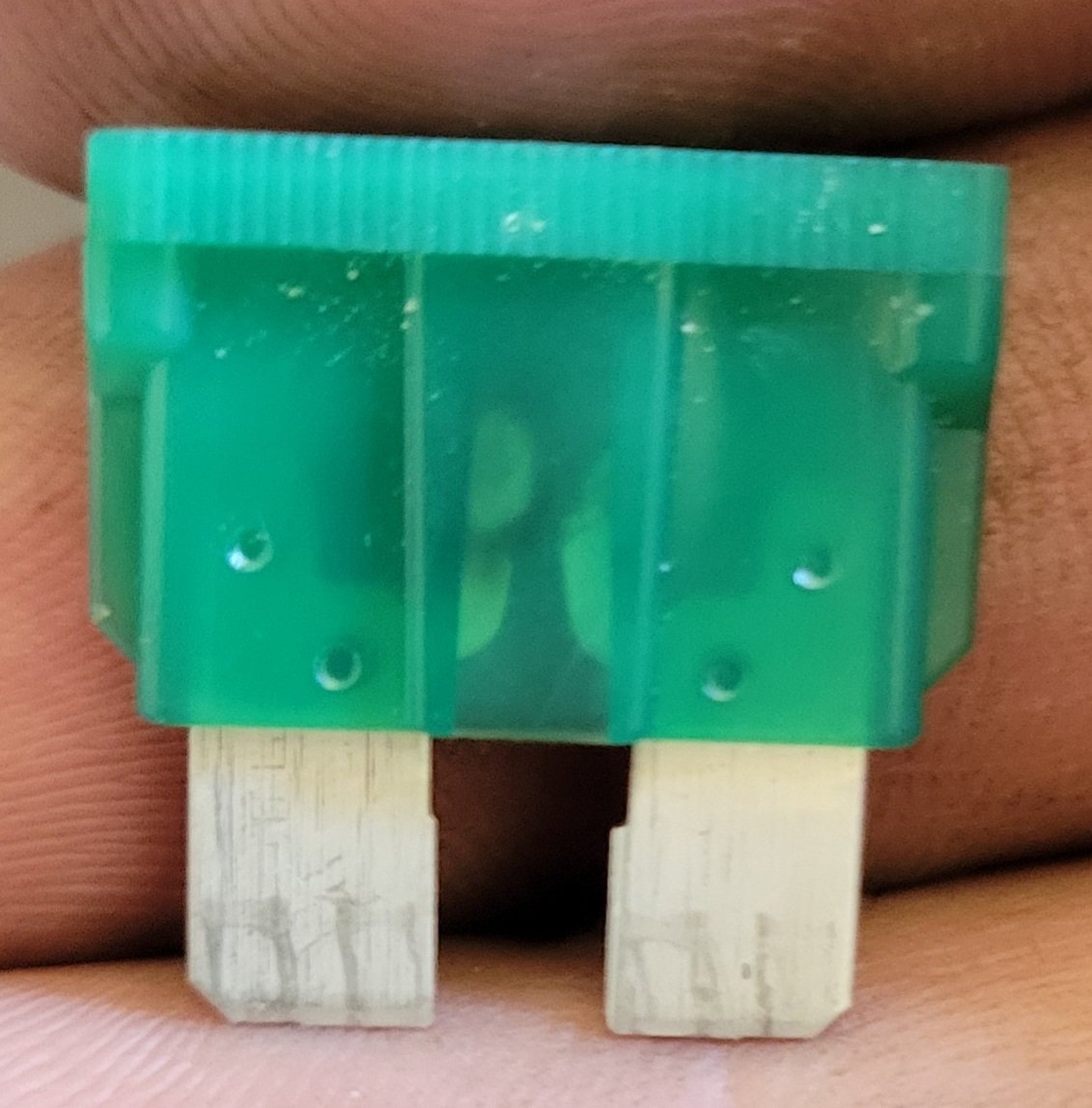

    Burned this one last trip airing up. I need to start being a little more patient while airing up.

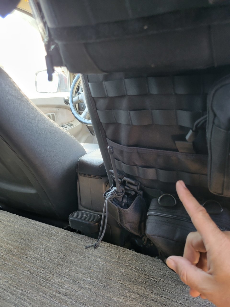

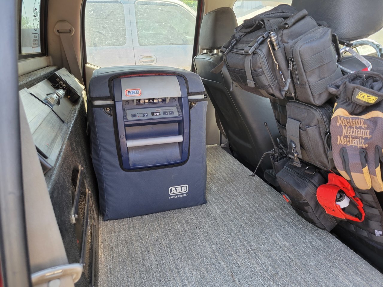

    Rearranged the molle panel and pouches since Jen wants the fridge on the driver side. The panel was on my seat, but with the fridge there, it was too hard to get to anything.
    Made a spot for a new pouch. I figure smalls like fuses and assorted stuff would work in this pouch... ordered.

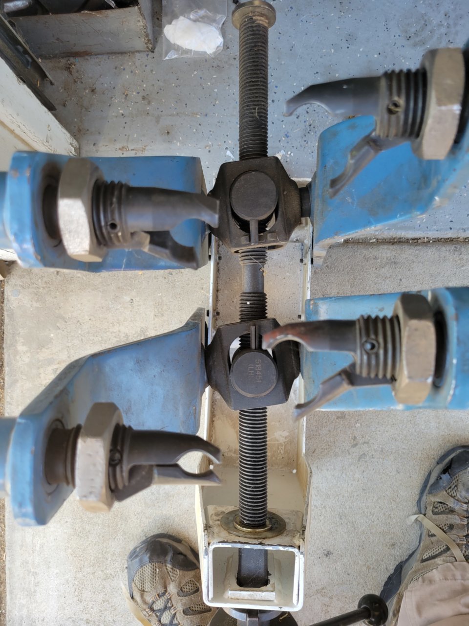

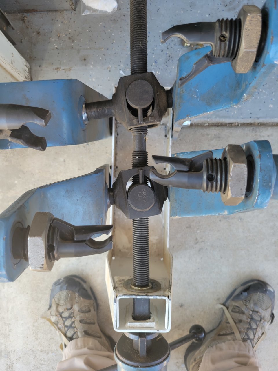

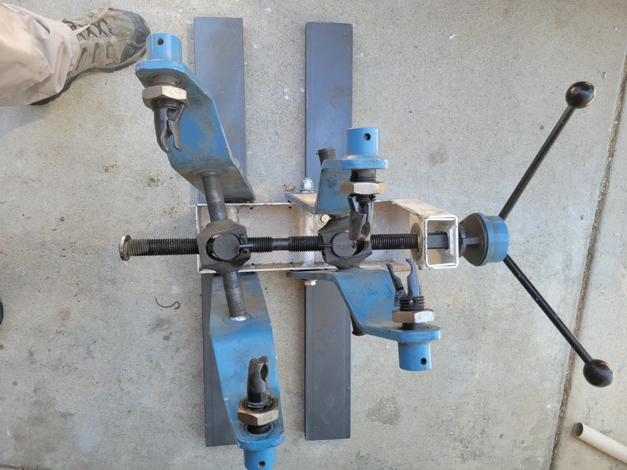

    Fixed the arms on @foxrcing07 new, improved coil compressor. (two of them were facing the wrong way.
    Before
    After
    Put the legs I made for the old one, on to the new one.
    Little crooked now, but they'll do the job. Also hosed down all the threads with Tri Lube.

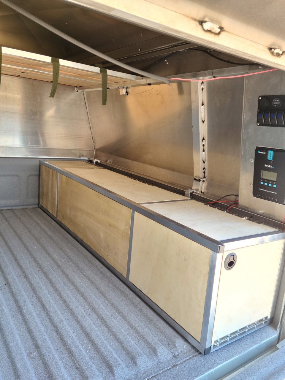

    Mostly wrapped up the storage bench for the bed.

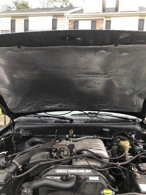

    Decided I wanted to preserve the paint on the hood from oxidation when I bought it in 2004. It's never been garage kept. This shielding prevents heat transfer which in some instances, accelerates the paint deterioration. It's remained in tact all these years and still does a great job.

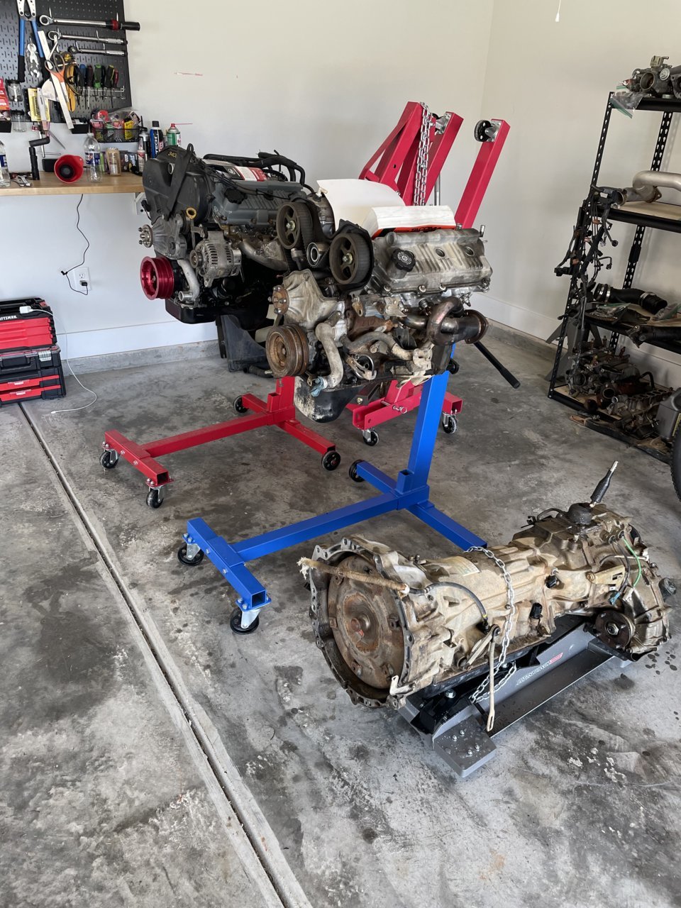

    Finally got the trans out and now it’s time to drop it off at the local shop for a rebuild. While the trans is at the shop and the engine is out, I’m going to be cleaning up some wiring in the engine bay, prepping for the super charger, and painting the engine bay black. Glad to be at this point in the build… finally.

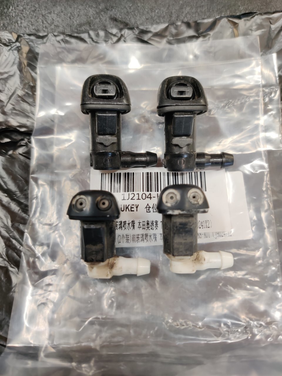

    Installed the Honda spray nozzles
    Don't worry guys I'll create a build thread with all the details later haha

    I have these and they are an absolute game changer. It did take me a while to get them adjusted where I wanted them though became the wind from driving definitely affects where the spray pattern lands. I have mine set to spray pretty high on the windshield while stationary but it hits near the middle of the windshield while on the interstate.

    Yup. Badass for sure. I wonder if i can add them to the 4runner

    I haven't even attempted to spray fluid through them yet haha. I just popped them in and closed the hood
