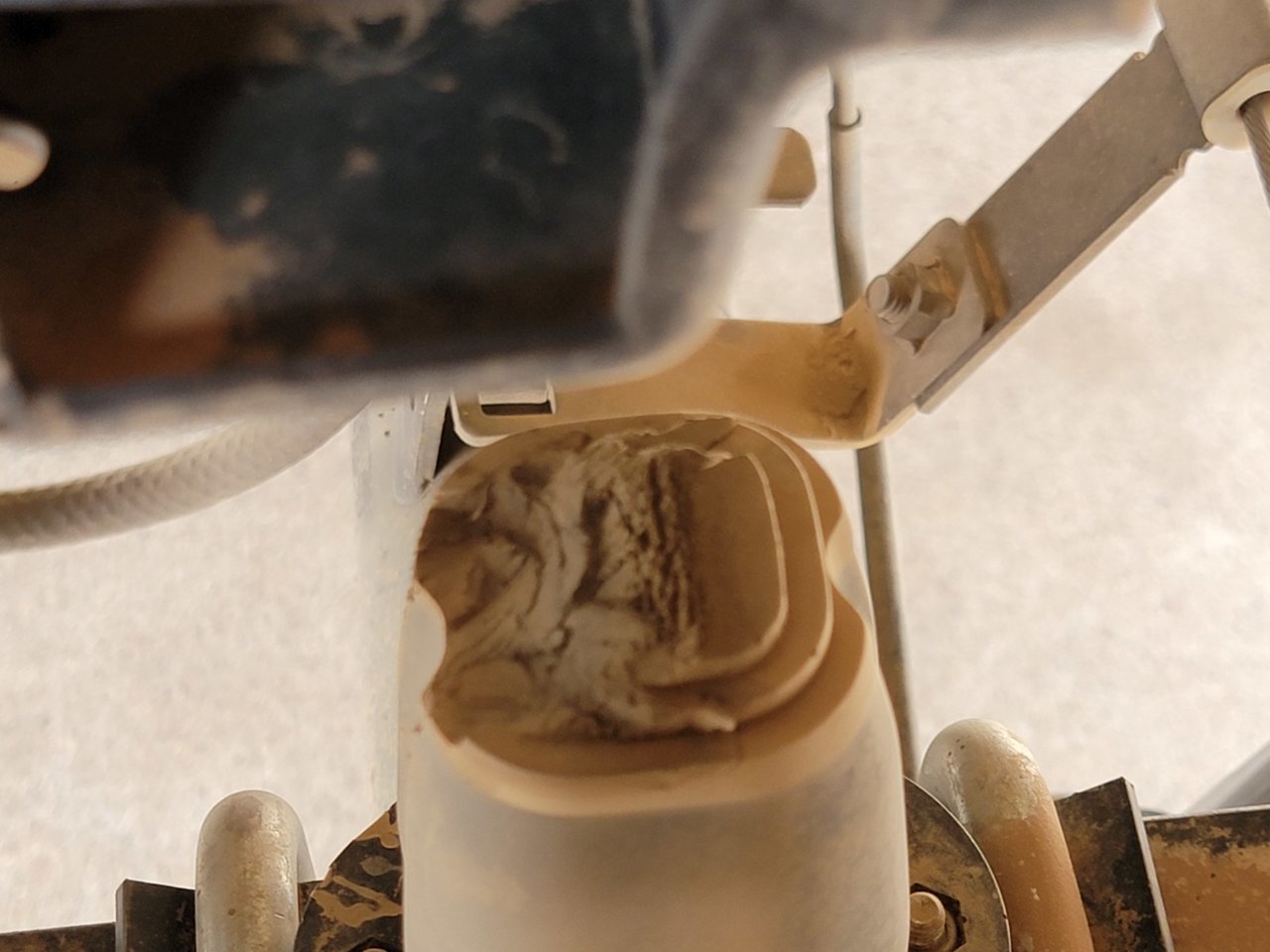

    It was a day of gems for me. Look at how great my rear durabumps are doing.
    Both sides are the same condition.Looks like my bumps/spring pad needs to be moved forward. But my tires run in the front already so I'll just flip them around someday. There still way better than hitting the stock bumps.

    Mine rear durabumps are doing the same thing, I’m going to weld some plate on to the landing to extend it out.

    That's a good idea.
