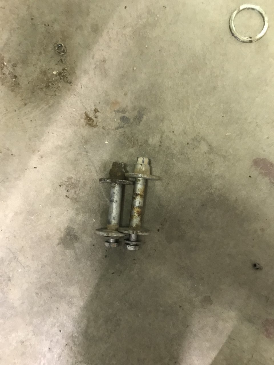

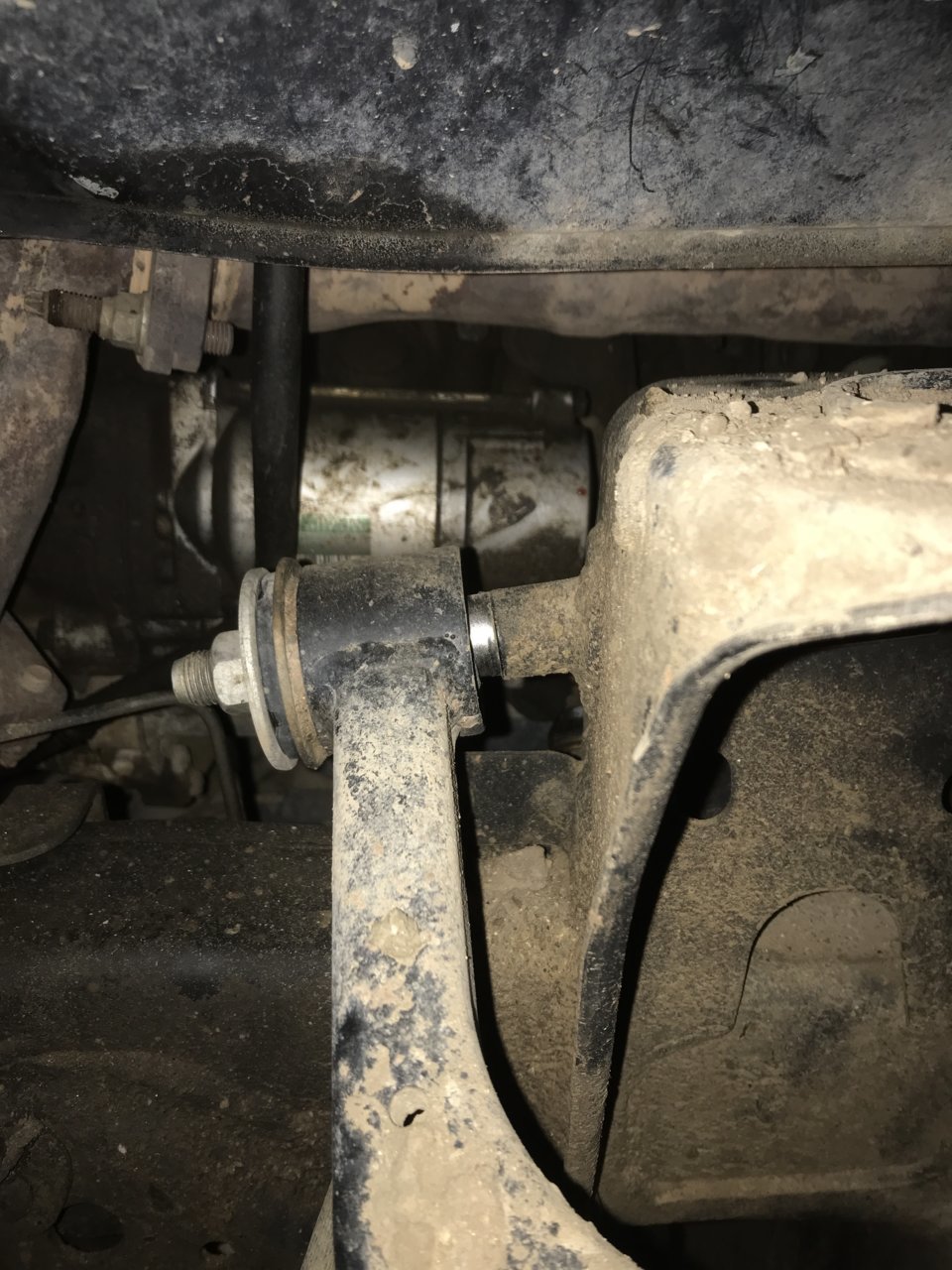

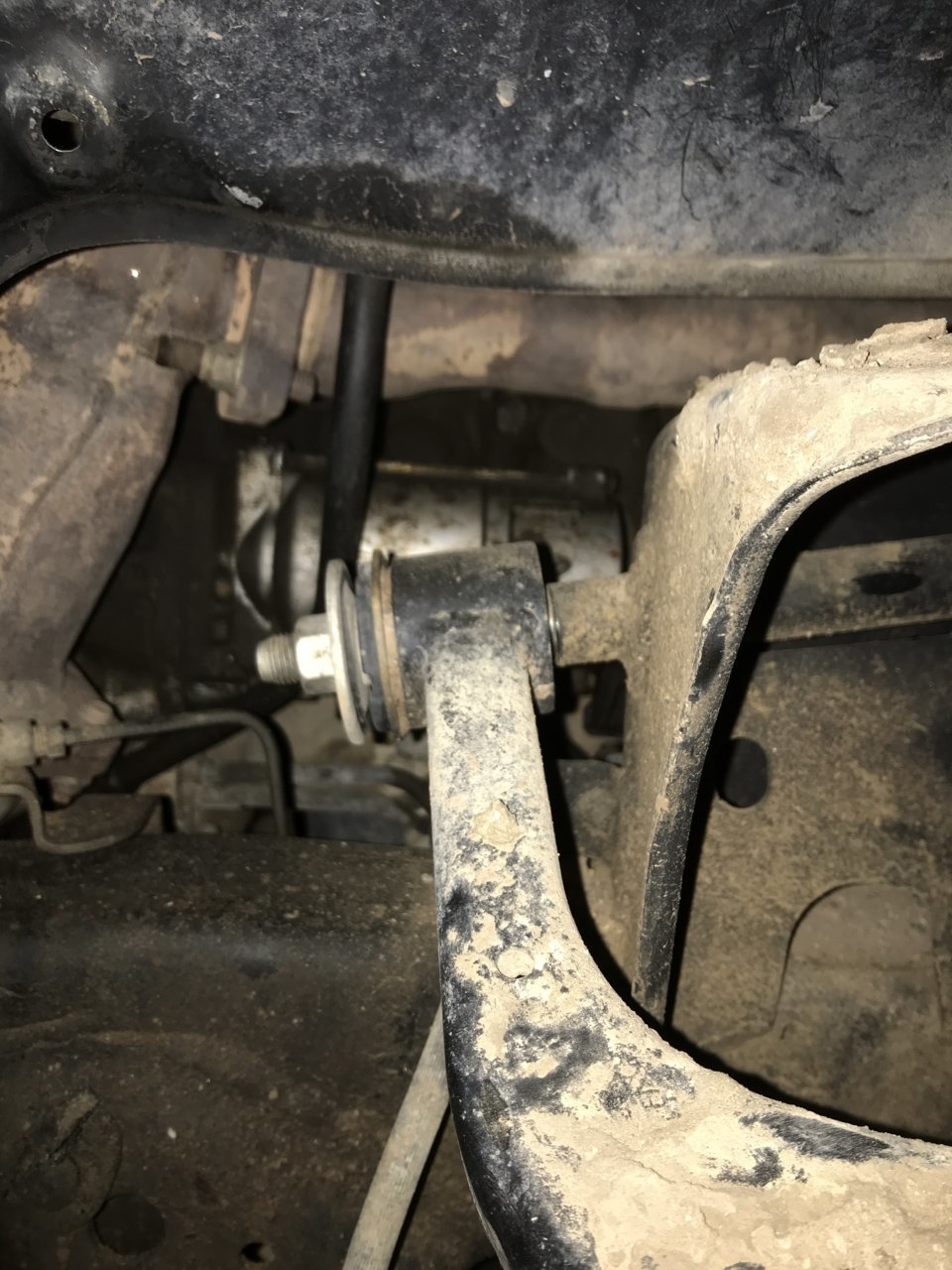

    I got the front bolts out of both sides, stuck in the tie rod ends, gonna have to go get a press.
    If I can move the uca like this does it mean I should have ordered bushings for them too? image.jpgimage.jpg
  4. Jun 24, 2021 at 5:41 PM
    eon_blue
    Mar 4, 2016
    #180213
    69,798
    Azusa, CA
    Yeahh...the arm shouldn't slide around like that.
  5. Jun 24, 2021 at 5:43 PM
    JKO1998
    JKO1998 Well-Known Member
    Jun 2, 2015
    #156578
    53,022
    Utah
    So much for having all my parts here.

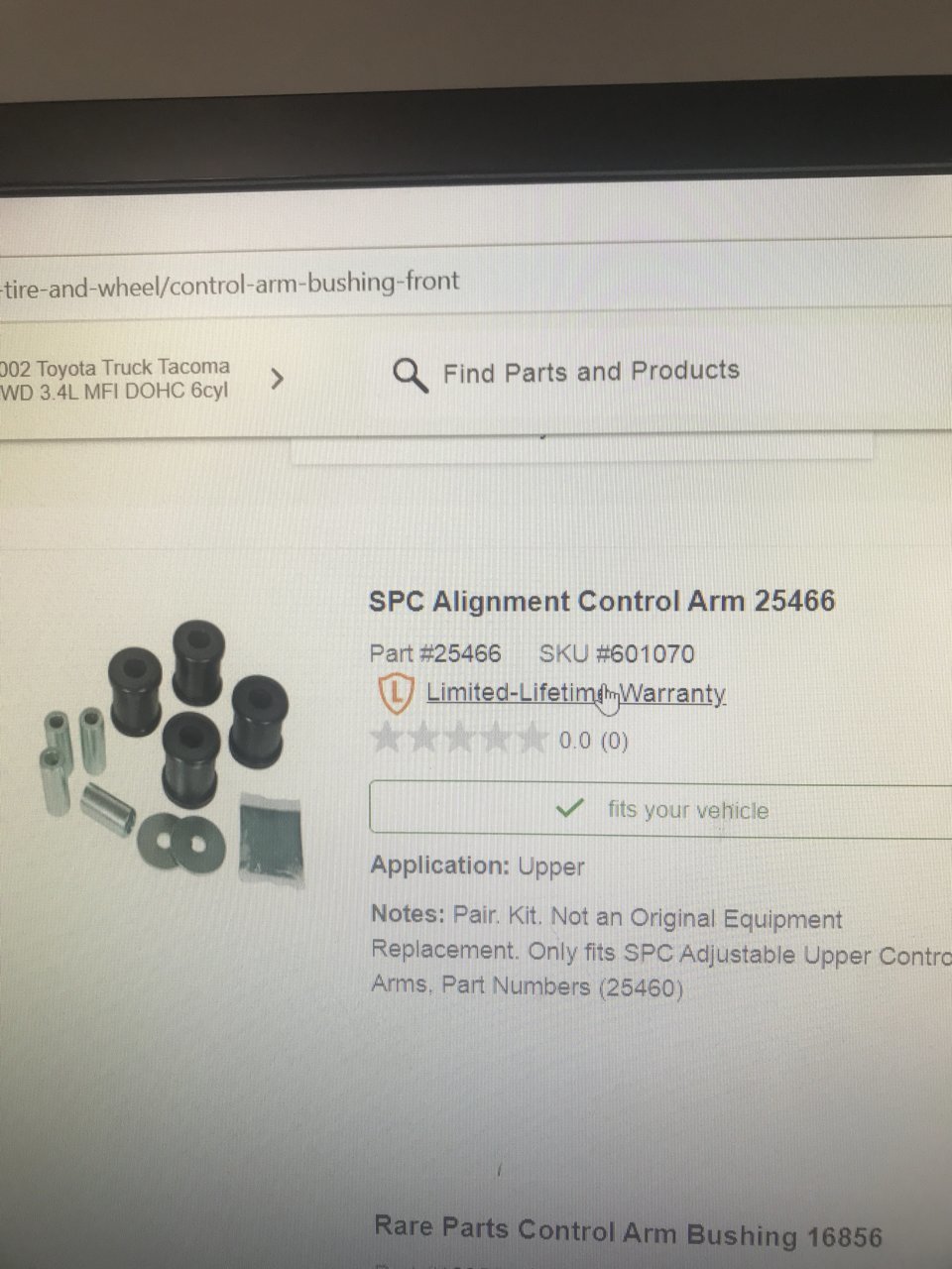

    ISO bushing recommendations
    Sonoran steel is sold out
  7. Jun 24, 2021 at 5:47 PM
    eon_blue
    Mar 4, 2016
    #180213
    69,798
    Azusa, CA
    For stock arms? Maybe Energy or Daystar sells some.

    Auto zone can get energy suspension and white line too.

    Shouldn't that gab get filled when you crank down UCA bolt?
  10. Jun 24, 2021 at 5:57 PM
    JKO1998
    Jun 2, 2015
    #156578
    53,022
    Utah
    I feel like yes, but gonna replace the bushing anyway
    Tour991[QUOTED] likes this.

    That pic you attached are SPC bushings for SPC arms

    I tried ti delete it

    OE bushings are part number 48632-35080. Technically a 4Runner part and technically not compatible with a Tacoma... but they fit. $30-35 each and you'll need four, so I won't be offended if you want to find poly bits for less money :) .

    I ordered some poly from autozone, the dude said they don’t work though, bolt won’t go through the sleeve.
    so I dunno

    Don't know how much faith I'd put in the AutoZone guy's word on that.

    He has a Tacoma haha

    I almost put that in my last reply 'unless he has a 1st gen too', lol.
    Well, IDK then. Seems odd to me that a company would make bushings for the UCAs but the bolt won't fit through them. My SPC's bushings work with the stock bolt.
