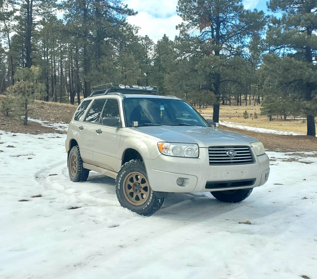

    I have all of the adjustments, I just wanted a manual seat. I found the set on craigslist for $50.00, so I figured they were manual, but when I went to pick them up, it was power.
    This is the reason I wanted a set, my other exploration vehicle has comphy seats.

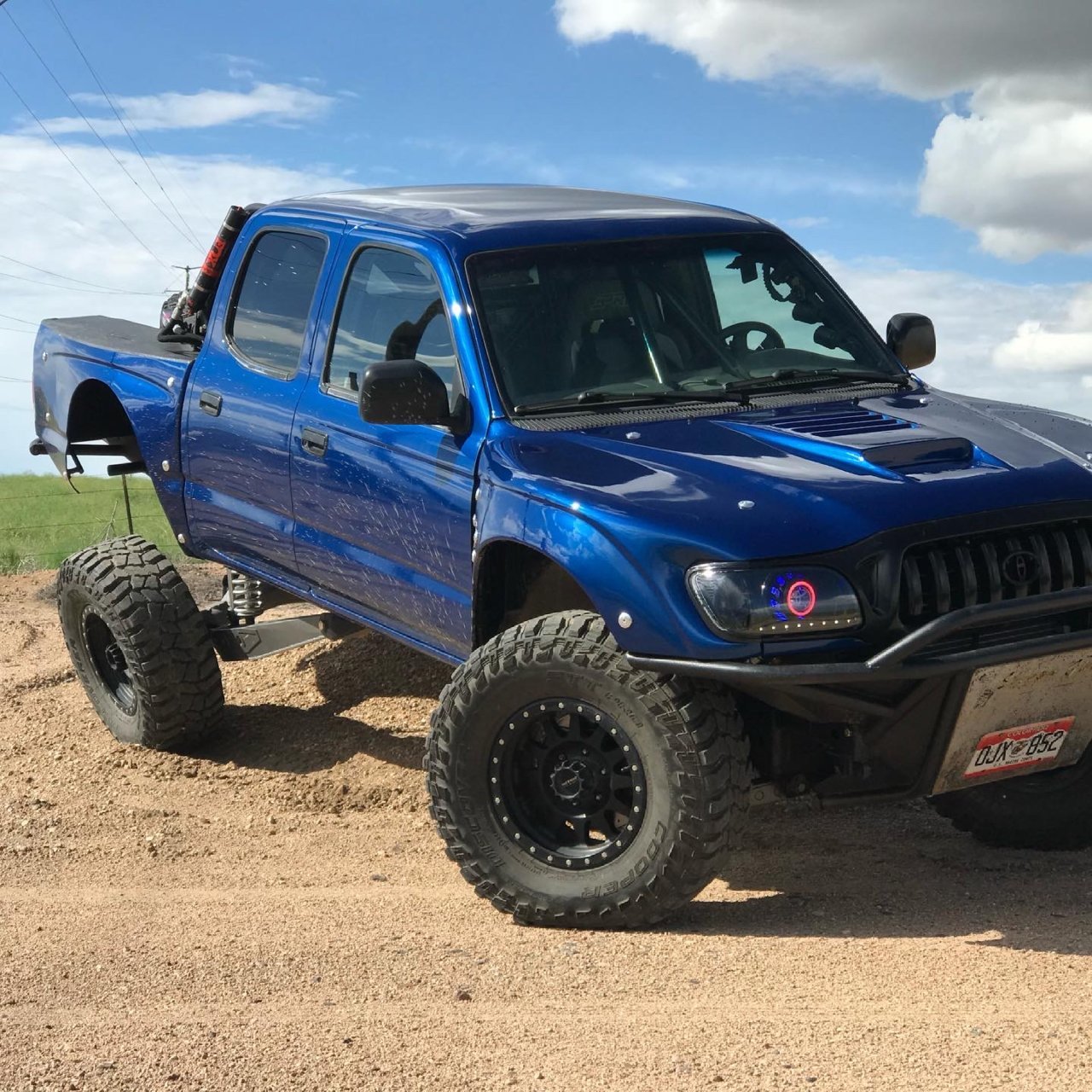

    This is bad ass if you ever want to sell or trade let me know :101010:

    Thanks man but I’m not going to sell it. Unless I get to damn old to drive it.

    Gonna jump it?

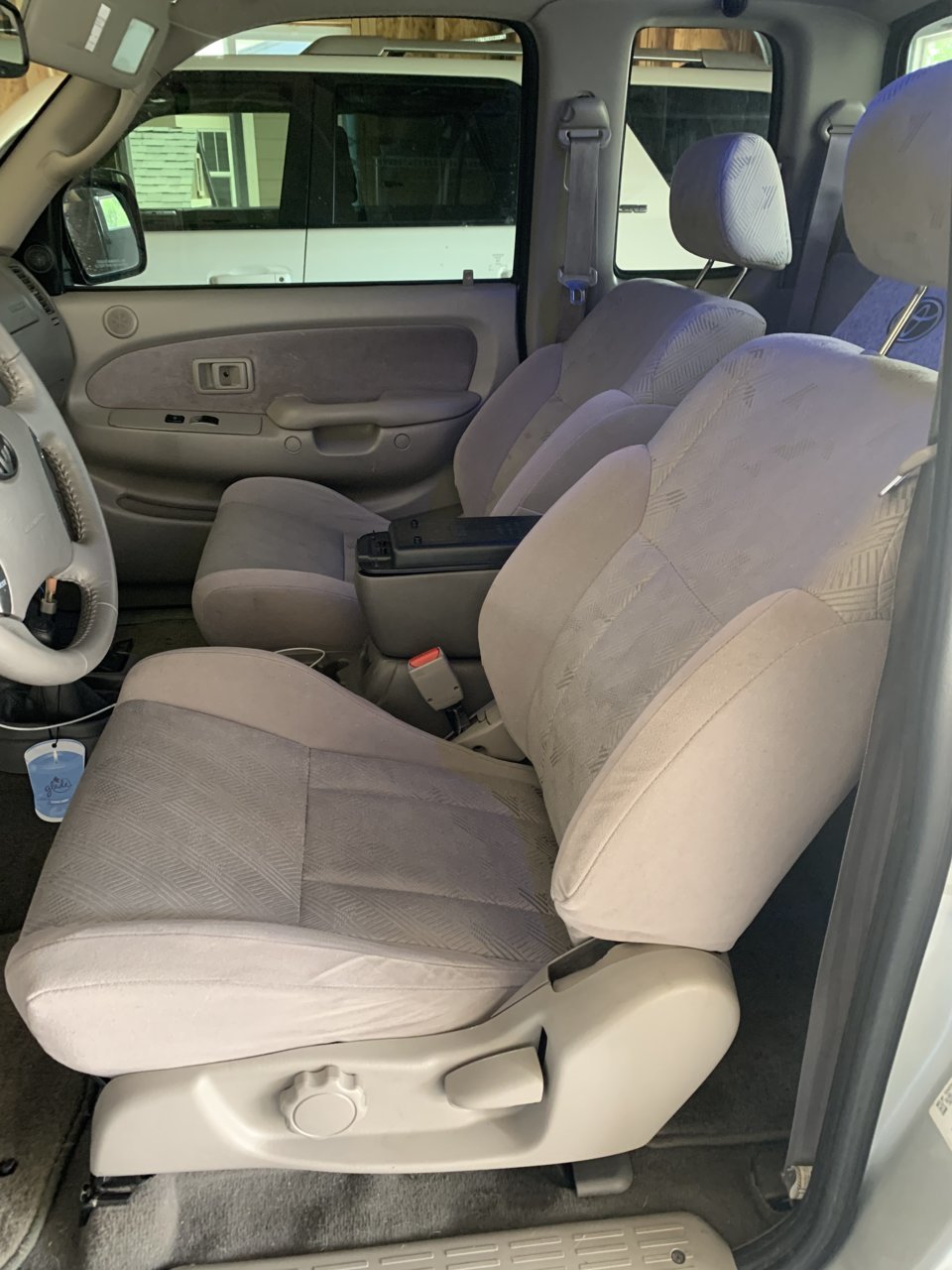

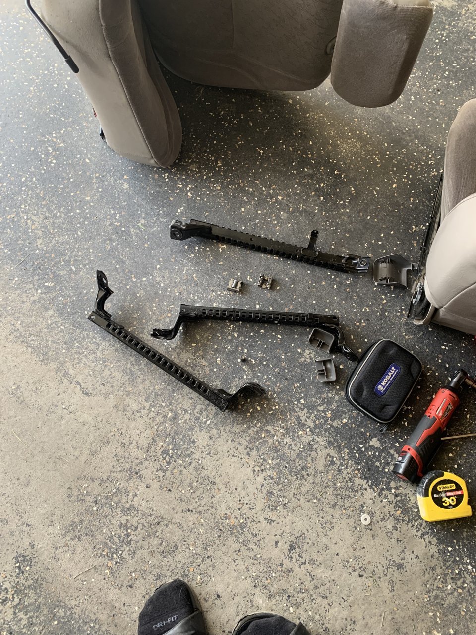

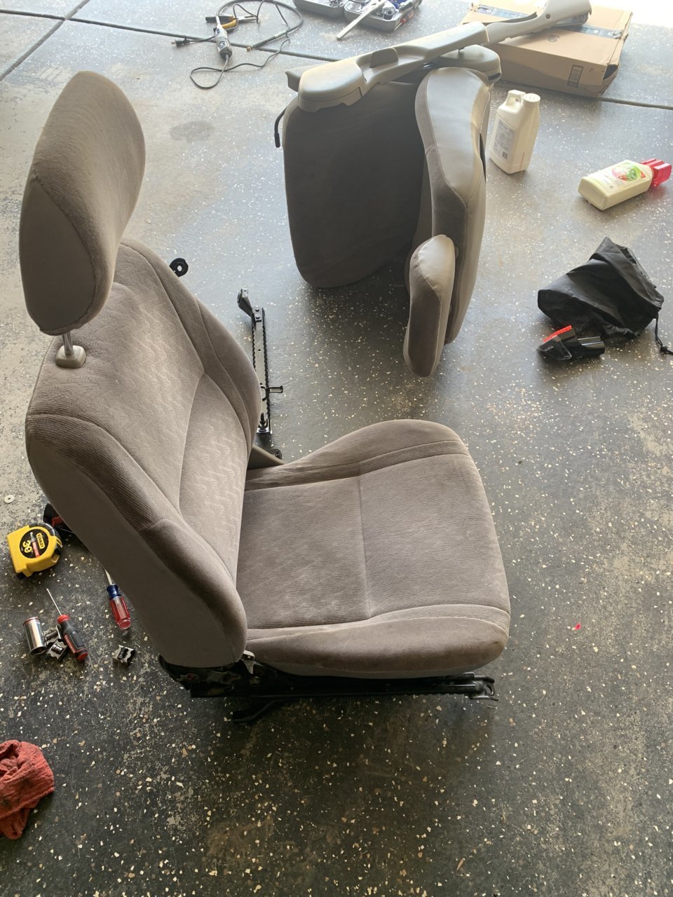

    Finally bit the bullet and brought some 3rd Gen 4 Runner Seats
    Used the rails replacement method. Only had to switch the outside rails from the Tacoma to the 4 Runner seats.
    pretty straightforward
    Grind off bump stop in front foot and two little ones in the back, slide out the bearings
    Reverse the process to slide the tacoma rails on to the 4 Runner seats.
    Much more comfortable!
    Plan on doing leather next spring

    when the time is right, yes

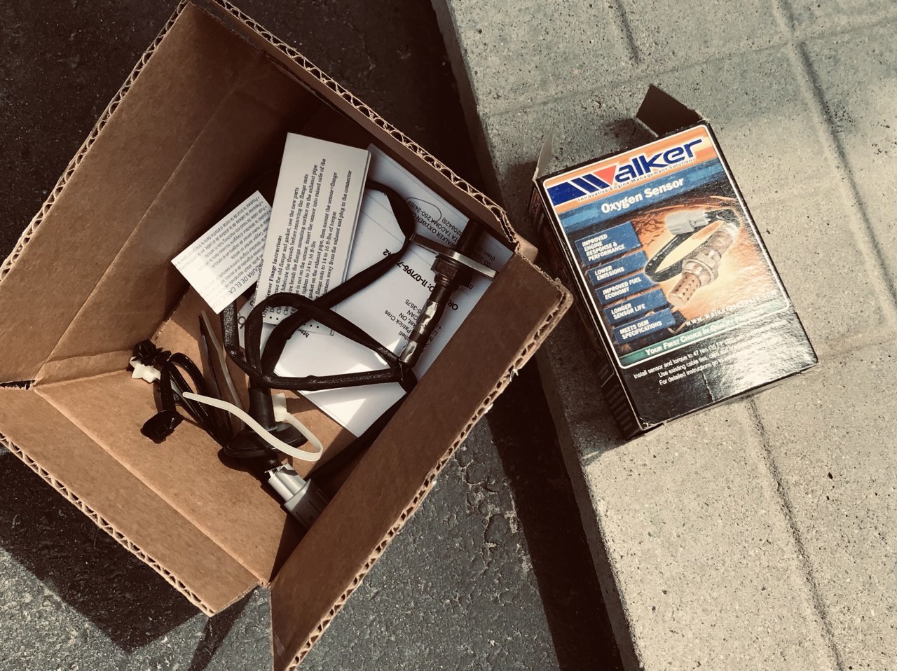

    1) Changed my O2 sensor. Finally cleared my “check engine light”
    2) POR-15 my entire frame
