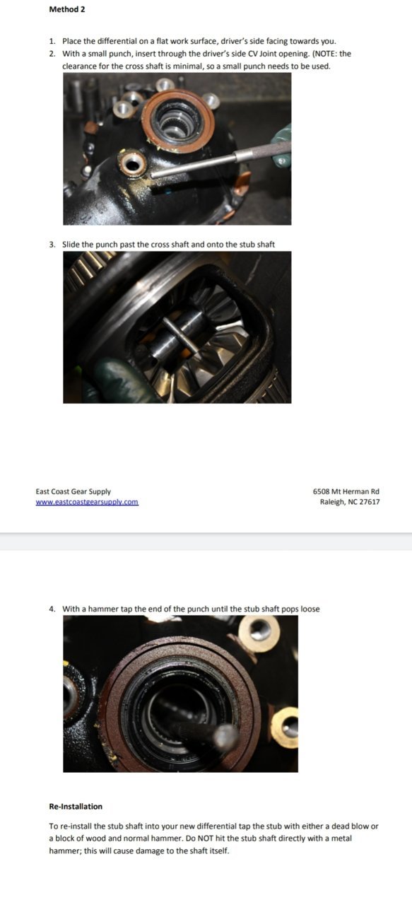

    Ok. Quick question. Anyone got pointers on getting this damn stub shaft out of the diff?
    I've done it before. I thought I just popped it out with a flathead screw driver, but it's not going the way I remember.
    Trying to get this clamshell ready to send to ECGS.

    Just pry a bit harder. I usually use 2 pry bars or long big screw drivers. One constant pressure and one to give a good jolt downwards.

    Actually, I got it... I used ECGS method #2
    I think thats how I did it last time. Once it pops out from tapping on it from the other side, you pry it the rest of the way.
    I forgot they had instructions published lol

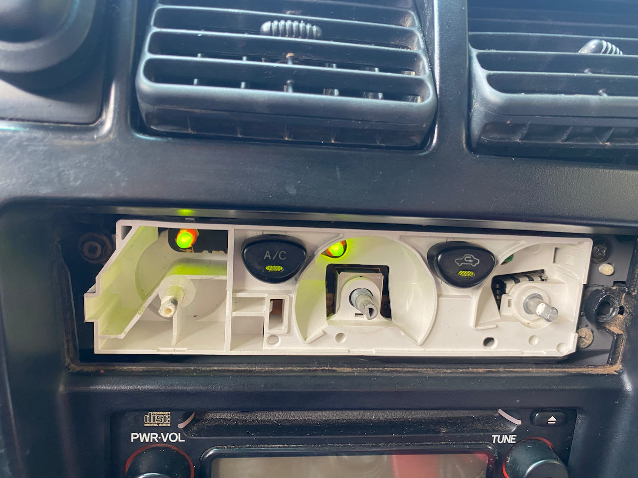

    anyone know if these light bulbs in the HVAC controls are replaceable?
    One of them is out

  16. Jul 1, 2021 at 7:46 AM
    Sicyota04
    Sicyota04 Slowly but surely.
    Jan 9, 2015
    #145940
    3,560
    Morgan
    California
    04 DC 4x4
    SiberianTacos[QUOTED] likes this.
