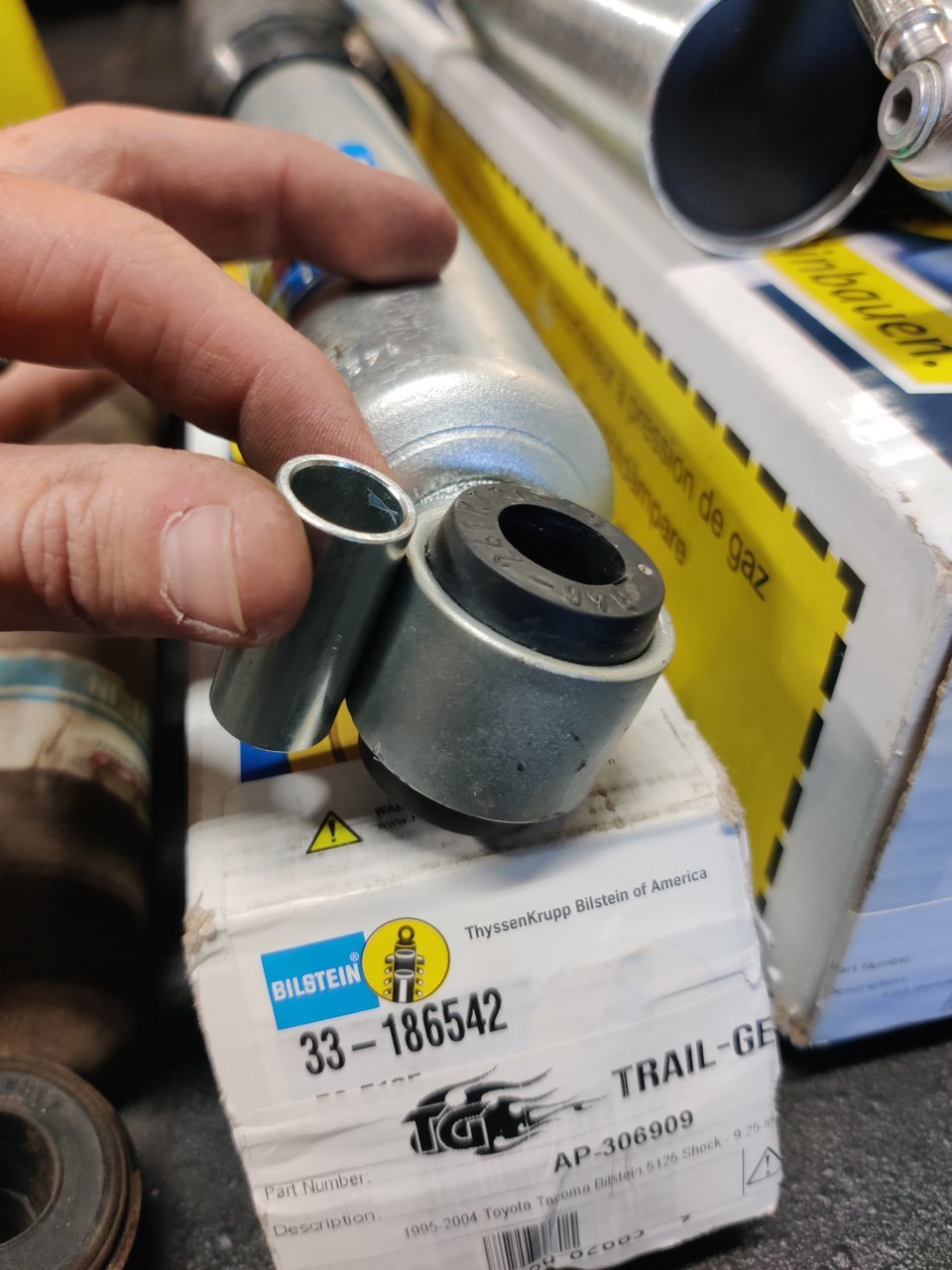

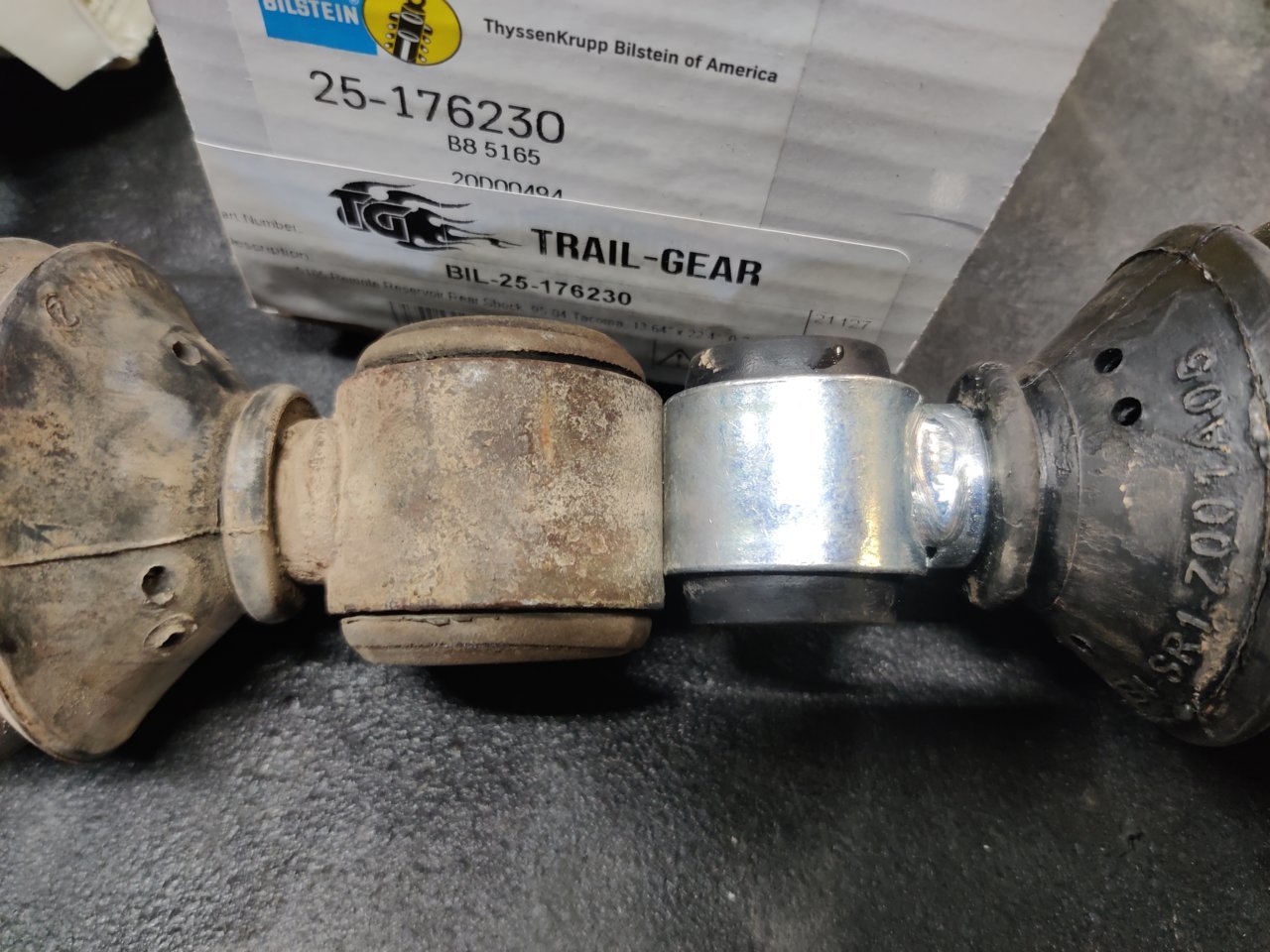

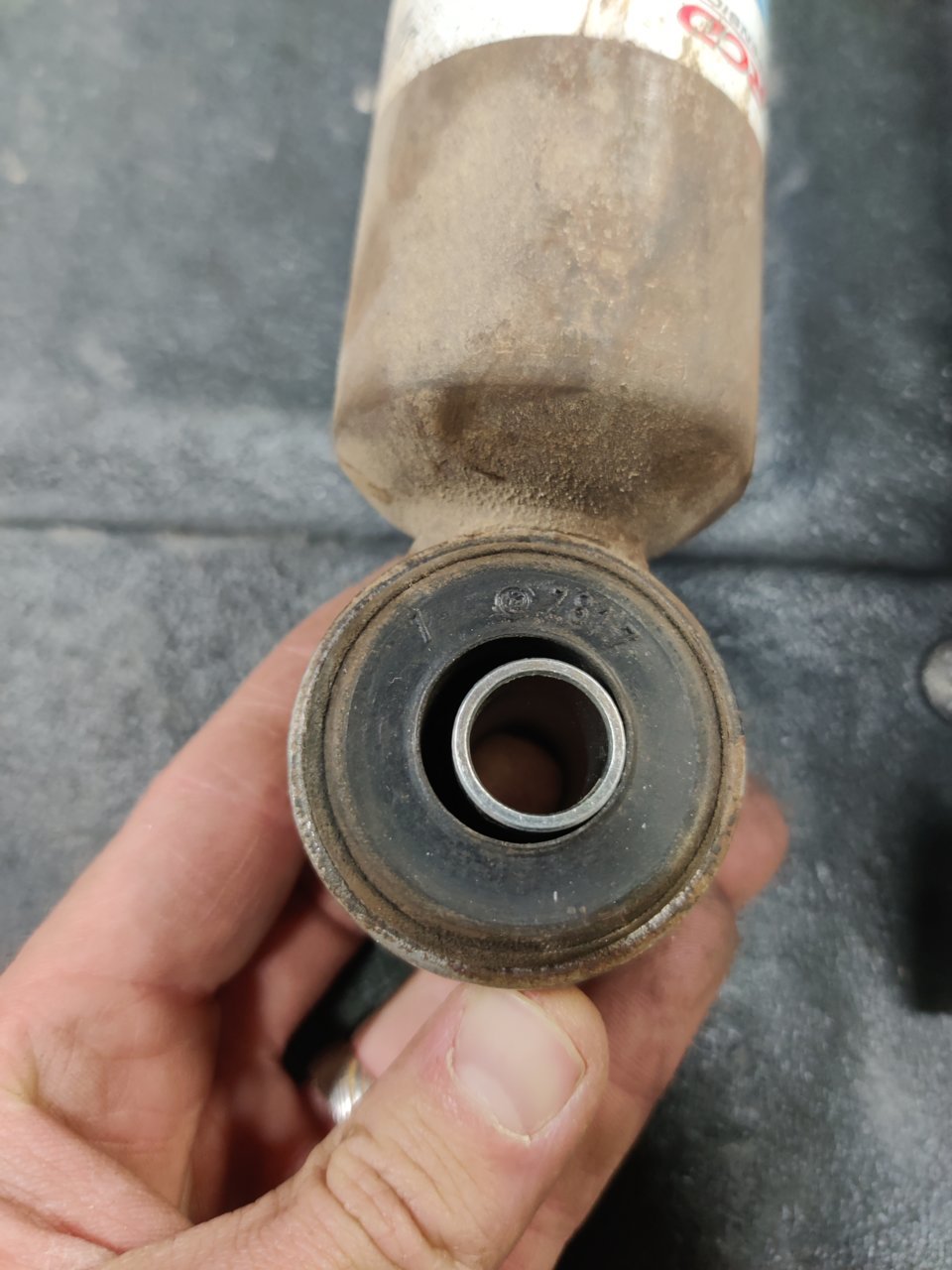

    My icons had metal sleeves I them from the PO, maybe those are still on the lower mounts?

    @JKO1998 All 4 mounts are the exact same size on the truck. When I pulled the bed off to restore the frame a few months back I checked to make sure there were no sleeves left on the mounts. I was expecting them and didn't see any

    Here's a picture of one of the new metal sleeves but even the outer diameter of the sleeve is small than the shock mount post

    Everything about the eyelets is smaller (except what i payed for them)

    That part number is a universal shock with 5/8" eyelet. You need 19mm ones.

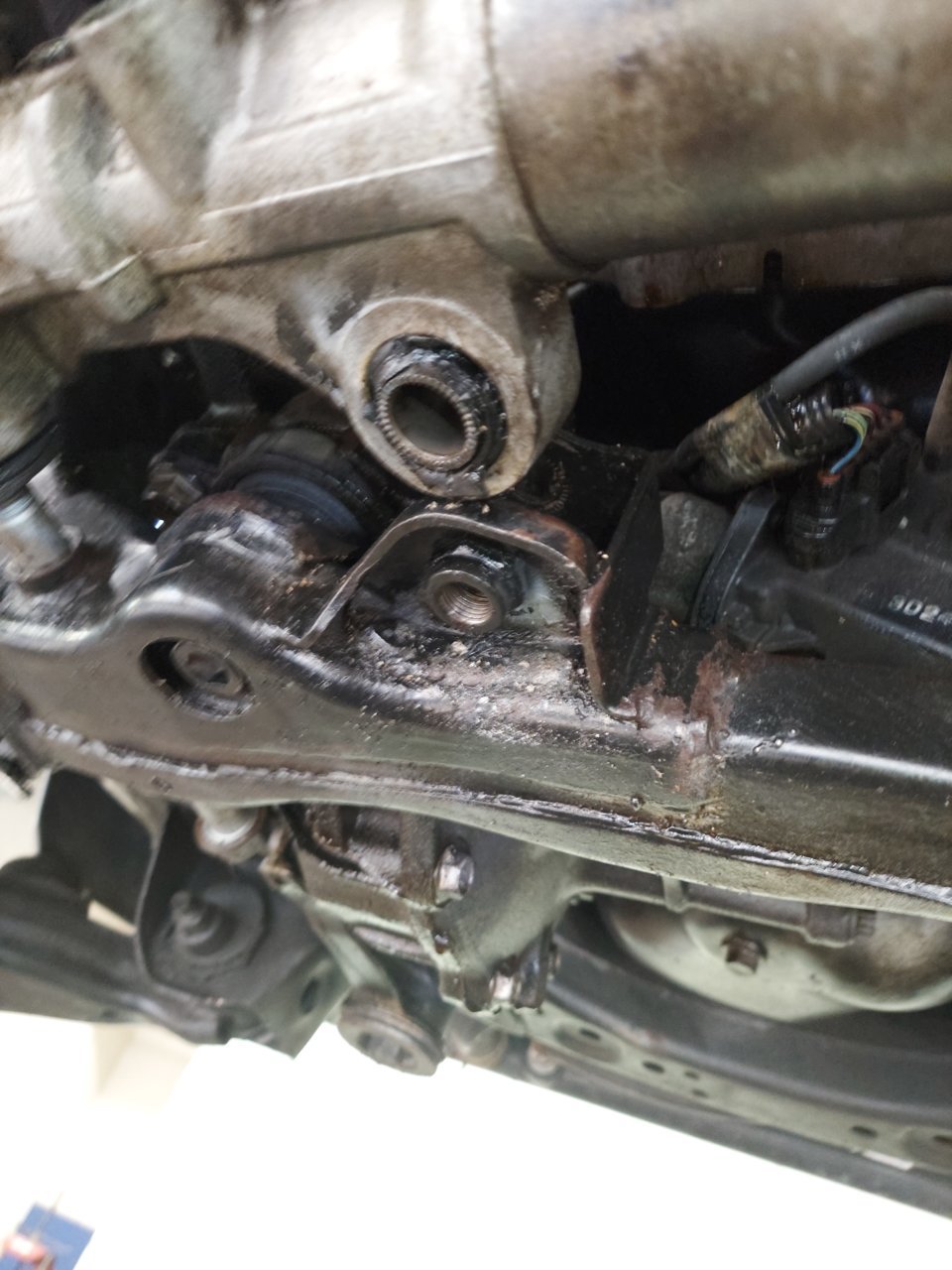

    Same issue here had I forced it on anyway:eek:

    @KANOA
    is that your steering rack busted loose, hard to tell from the photo.
