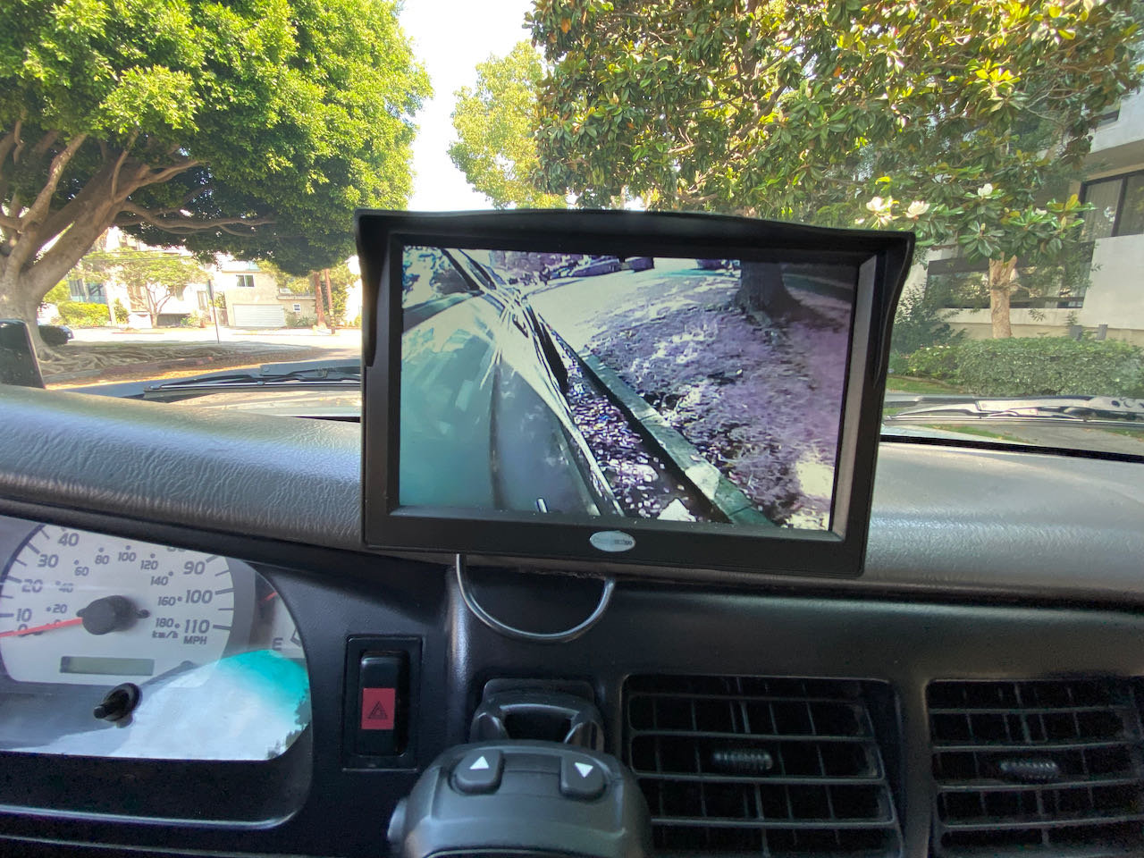

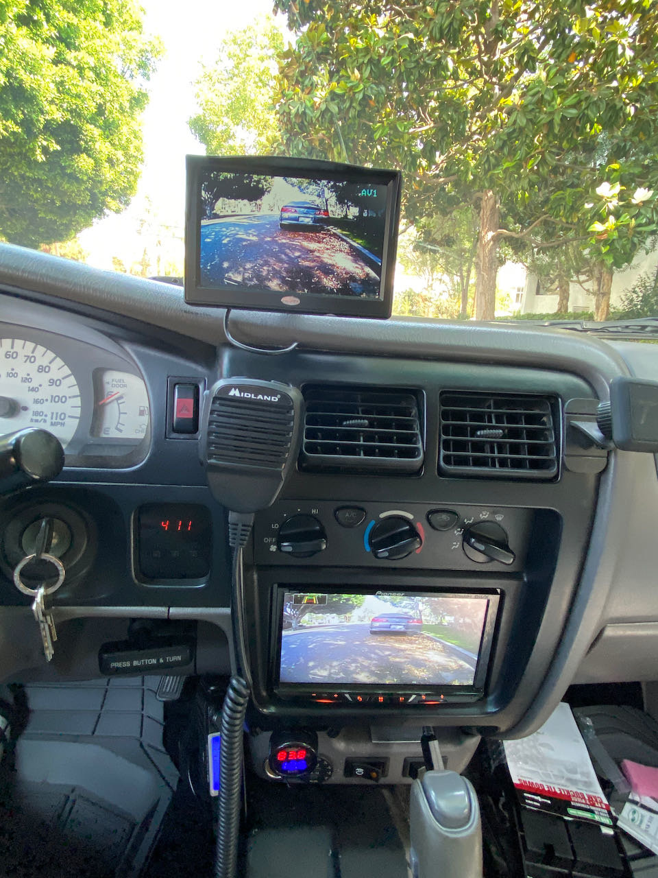

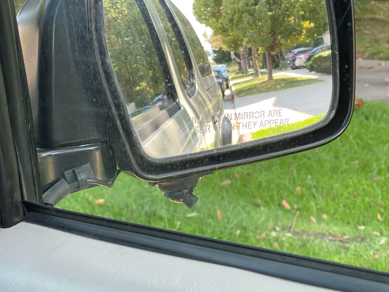

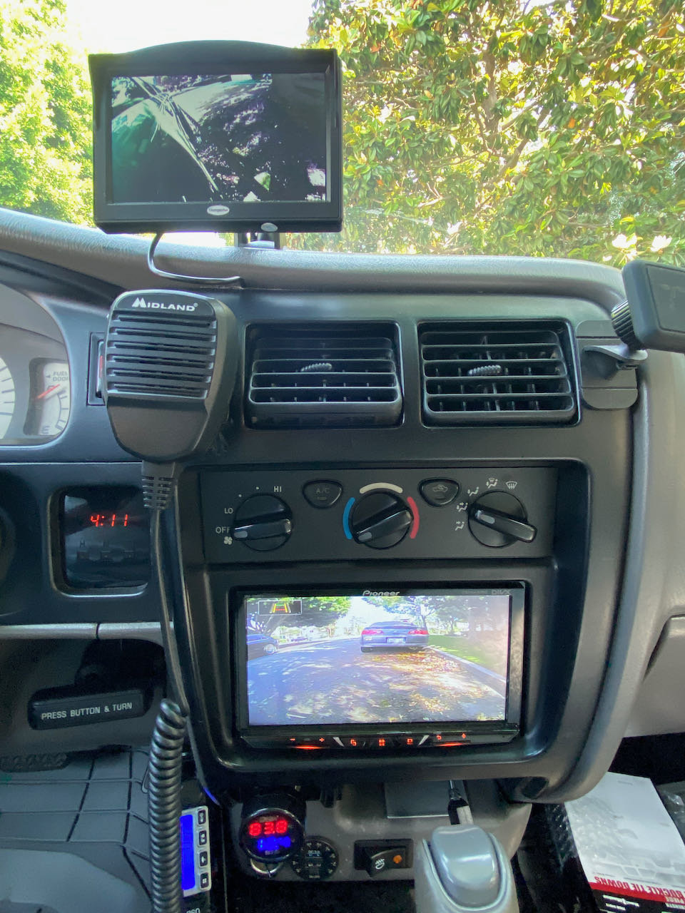

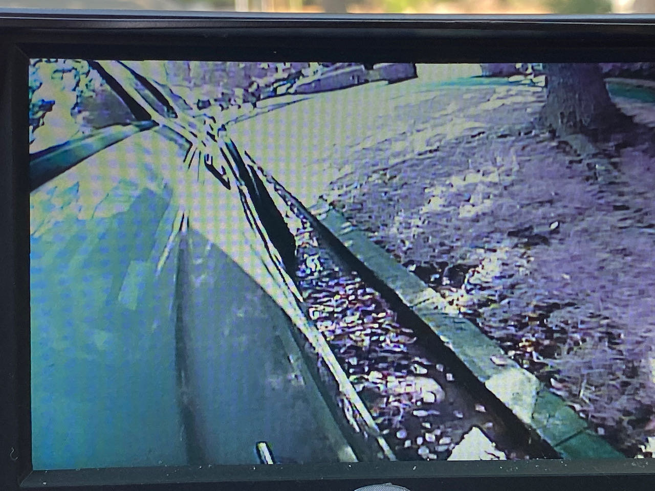

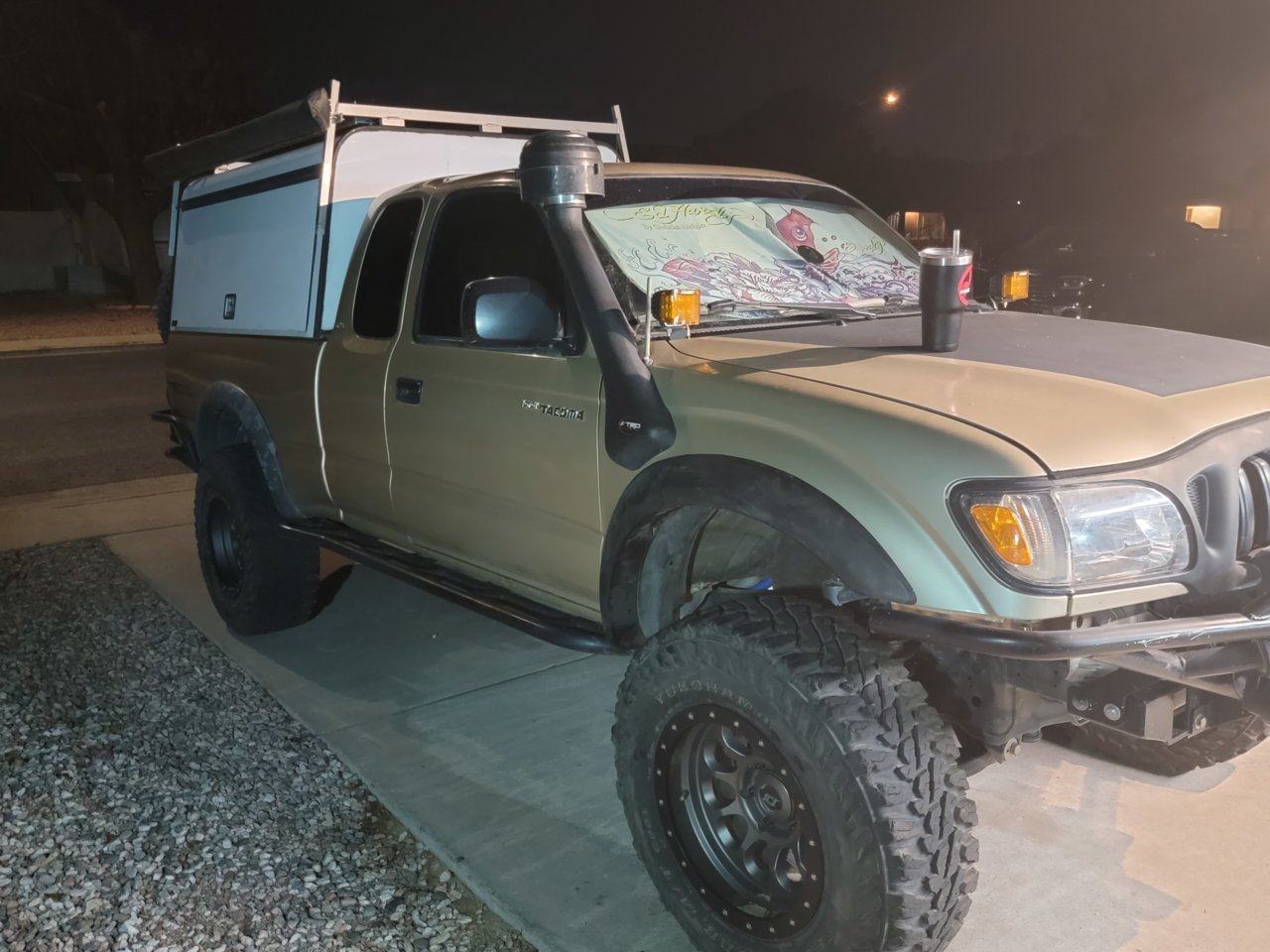

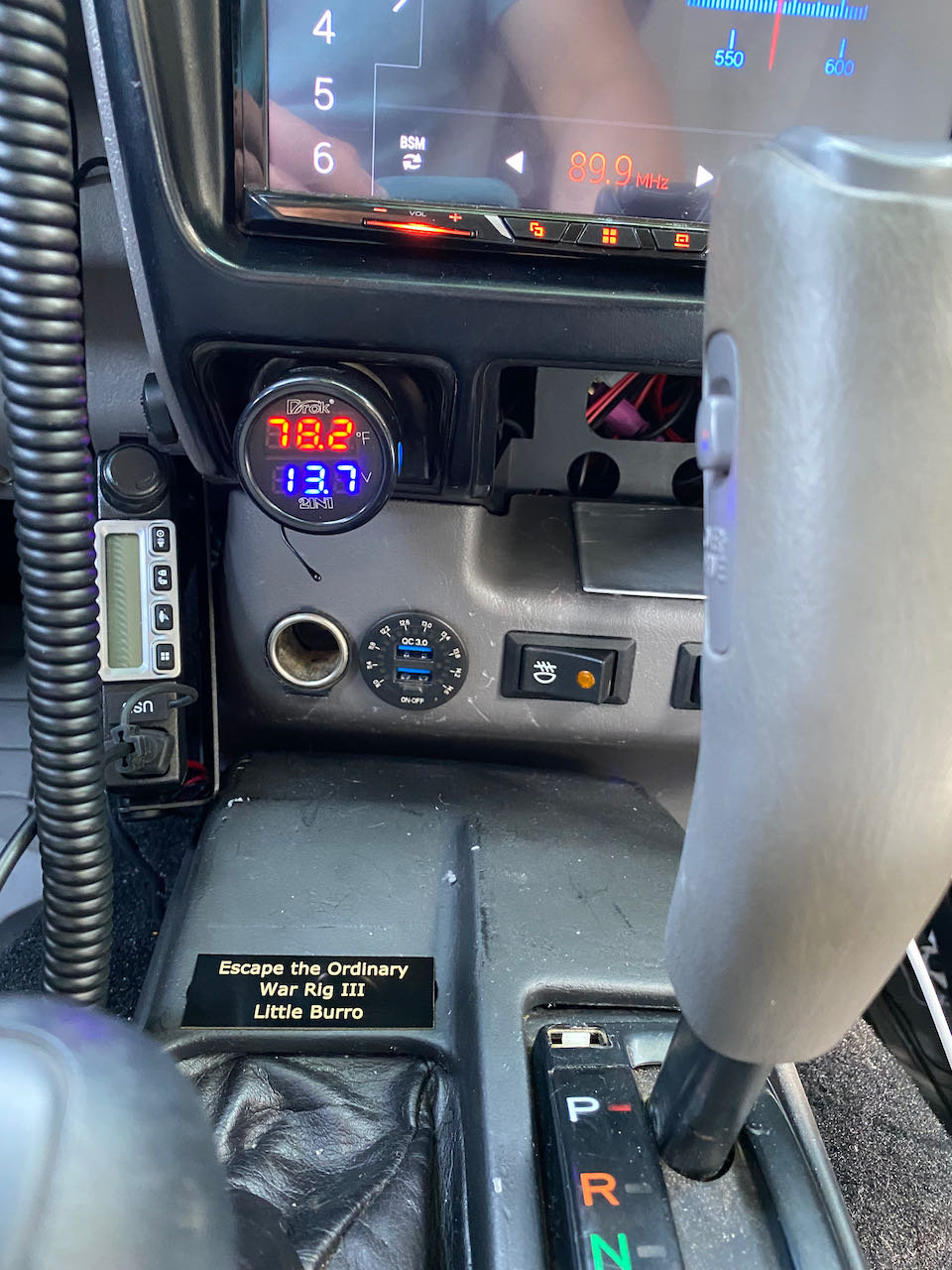

    finished my front rear and side camera switch. Added a monitor at eye level. Monitor will automatically display front and rear as you shift reverse and back to drive. You can also turn on front with a switch. Right side camera has its on switch and will only display on the top monitor. This way you can see both forward and side or reverse and side. See images for demonstration.

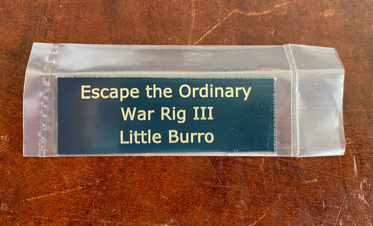

    and added a project name tag inside

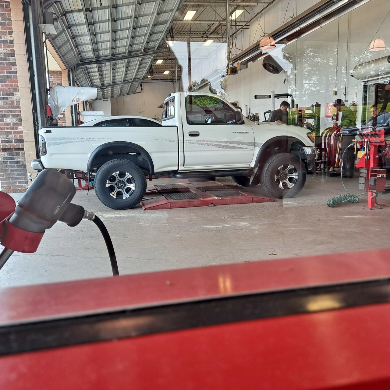

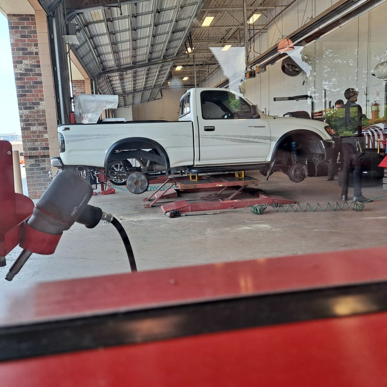

    Another 10k Mile balance and rotation at 670,000

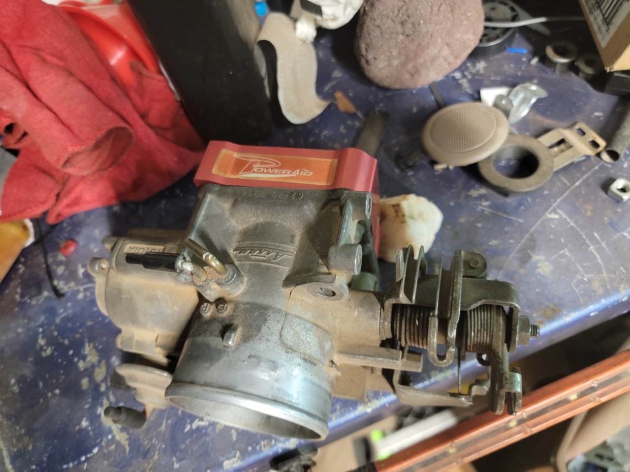

    Had to do some cleaning and rearranging of my shelf. Dug out some parts to get sent off for the boys 4runner.
    Going to send in the throttle body in for a rebuild and we'll get the TB spacer port matched.

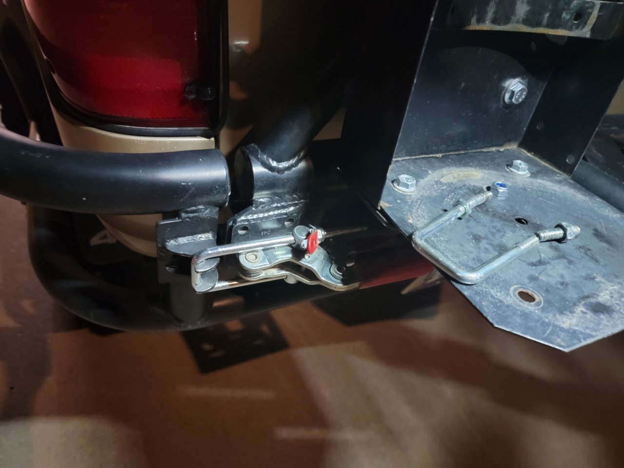

    Had to fix this guy the other day. It broke last time I was out. Luckily part of the u-bolt held and I was able to tie a strap around it to keep it tight. Might need to find a different latching method.

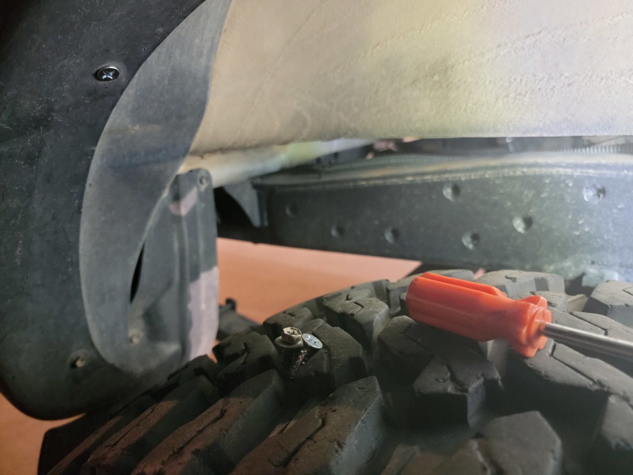

    I finally reinstalled my fender flares. I tryed to get a bunch of sealant around the snorkel connections before I put the liner back on.
    I think I need to pull the fender to get the top.
    I also started to change out the fender screws for a flat heads

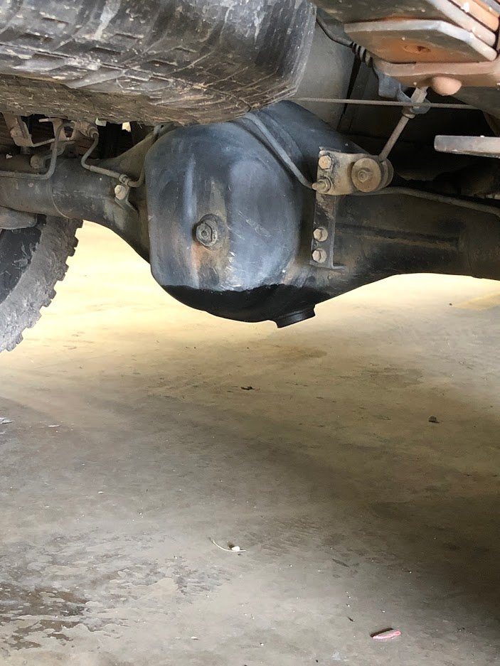

    Guess I didn't do a very good job of sealing my diff up when I swapped out 3rd member :frusty:
