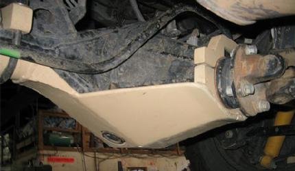

    Anyone know any available options for rear diff skid plates for our trucks? Preferably with a pinion guard.
    Or, are we 1st genners just out of options now because we're all "too cheap" to spend money on our trucks? :rolleyes:

    You can do a diff skid without murdering ground clearance. This guy doesn't make them any more, but this is what I'm looking for... except have the front bracket with bolt holes to add a pinion guard.
    That only gives up about 1/2 inch of ground clear (if that)
    The back of our axles isn't very stout, and I'm also looking for something that hugs the drain so I stop bending the ring to interfere with the plug.
    unstpible and Phessor like this.

    Oh, I'm aware that's an option. I've talked that over with some buddies.
    If I did a weld on option I think I'd do the LROR option. That would protect the rear from sliding over rocks and backing in to them. Which is a concern... but not as much of a concern as protecting the pinion, if possible.

    Wouldn't be looking to weld anything to the 3rd member.
    This one has a clamp around the nose of the 3rd member (much like Jerry's did). The 1/2 steel that makes the clamp would need to be more under the nose to give a place where the bolts would be able to be added all the way around it, for a pinion guard to be bolted to it.
    Pinion guards are often looked at as funnels that catch stuff, but they serve a purpose. It's a give and take some people are willing to make, some not.
    unstpible likes this.
