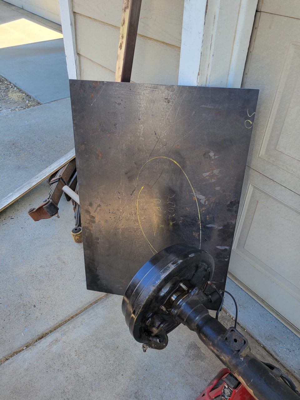

    Starting to click off some projects
    Bearings pressed... I'm fabricating a press fixture for the hubs. And still need to press hubs off a 3rd set of spindles in order to get to some brake backing plates.
    I've already verified the ring/pinion on the axle I bought is 5.29
    Also tested the elocker by hooking it up to the truck... tests good to go :thumbsup:

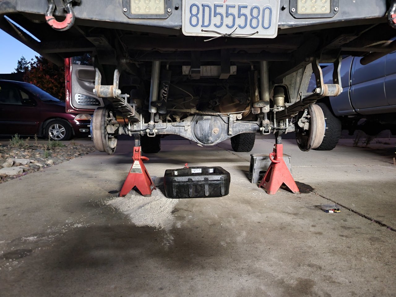

    On to more exciting things.
    Brakes, elocker, driveline etc disconnected. Rear end is drained. Axles are ready to slide out.
    3rd member is ready to be pulled and swapped in the morning... I'll be rolling on a 5.29 rear diff tomorrow.
    Another reason I love manual hubs. I don't have to do it all at once. Especially because UPS sent me a notification that my clamshell wont arrive till Thursday. The rear will be broken in before the front goes in.

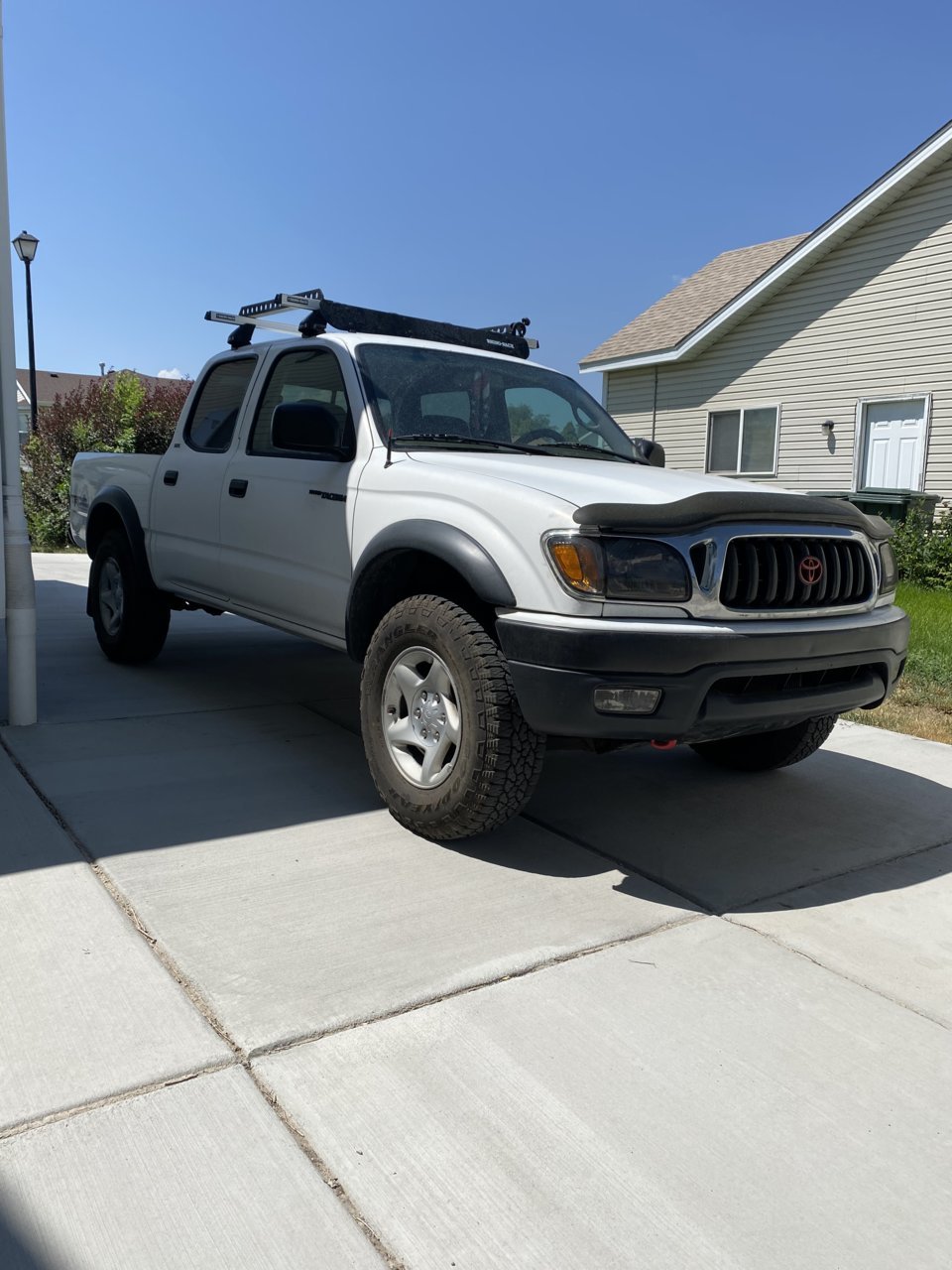

    Installed a roof rack today, changed the transmission fluid and put in a cooler. It was a good day!

    Hey how did you mount that? I've been looking for ways that don't involve drilling into the roof

    I couldn’t find one either so this is a rack off a second gen. I made a little slit under the door weather striping and hooked it in there.

    Can you take a photo of that when you get a chance?
    It seems like Yakima had a similar mounting bracket in the past, but I haven't had any luck finding it. Think I'll make one too
