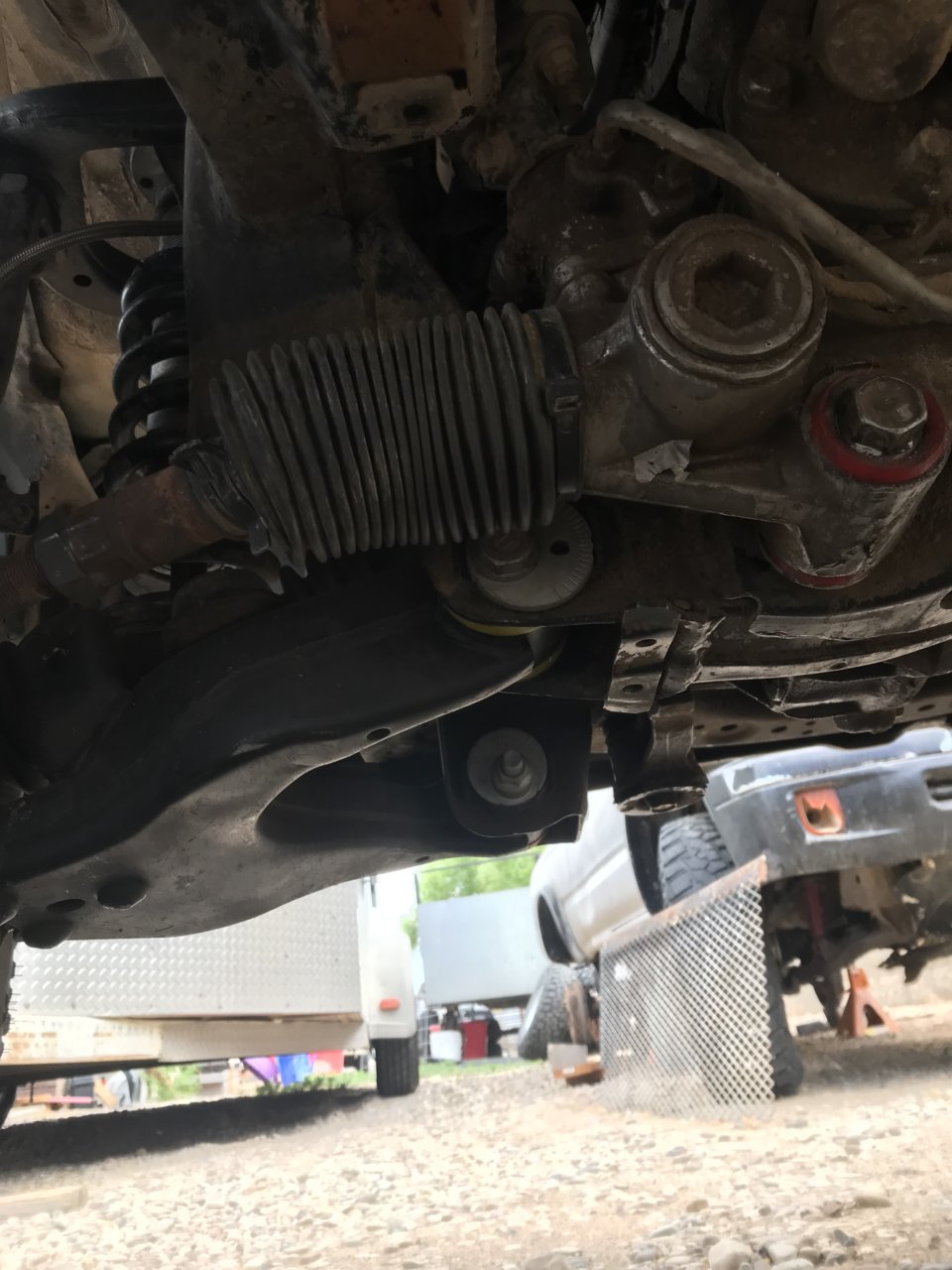

    They do. So you won't get much more castor.
    However the bad wear is due to the camber mainly the passenger side probably not being good. Plus the Toe was a little off. Might be better now with toe straight ahead now. But I'd think they could get the camber better, unless you have a bent coil bucket. What are the cams set at?

    I dunno, have to go look, I just got home from work and saw the paper on the table.
    buckets should be fine, truck lives a fairly easy life on FS roads

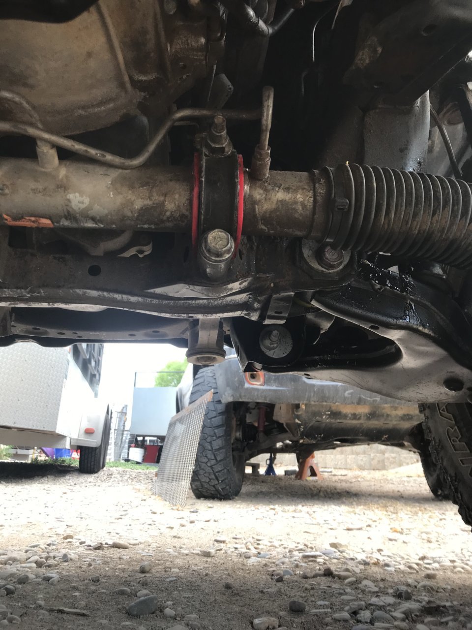

    well judging the sheet, they didn't touch your cams this time just the tie rods.

    And they should be able to do what they want with those?

    idk until I see photos of the cams.

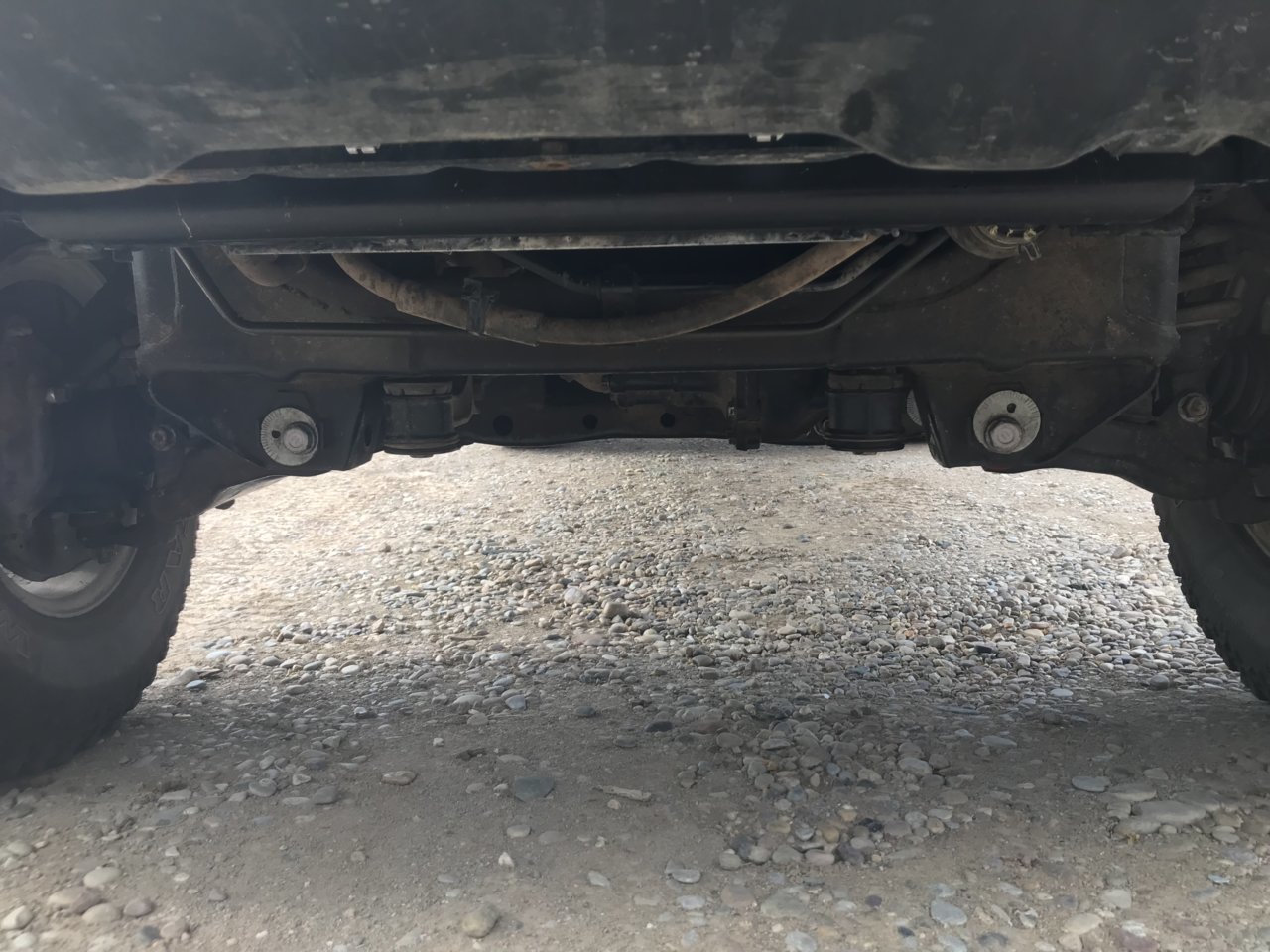

  8. Jul 21, 2021 at 5:29 PM
    JKO1998
    JKO1998 Well-Known Member
    Jun 2, 2015
    #156578
    53,123
    Utah
    Don’t mind the axle grease
    76129F5C-122F-48C8-9027-F626744BF169.jpg F7273415-DAD3-454E-80D5-608BB6055AFC.jpg F3F7CF45-196D-420E-A0CF-4C3CAE1D81B3.jpg

    Take it back to them and make them fix it and compensate you for your time to take it back twice. Doesn't look like the cams are maxed in either direction on the passenger side. That's one lazy ass tech, hopefully you get a better one next time in there.
