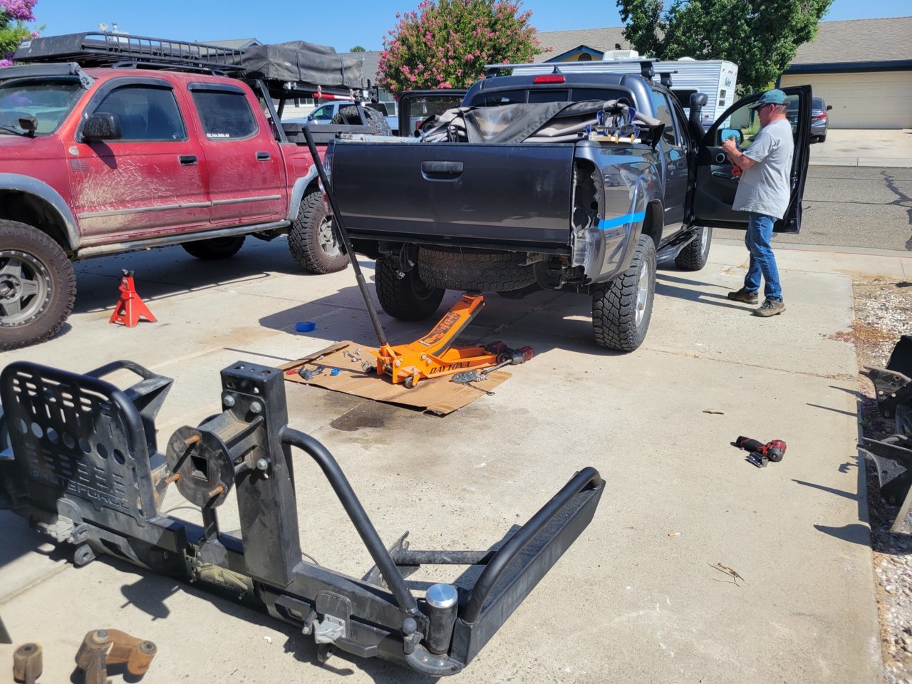

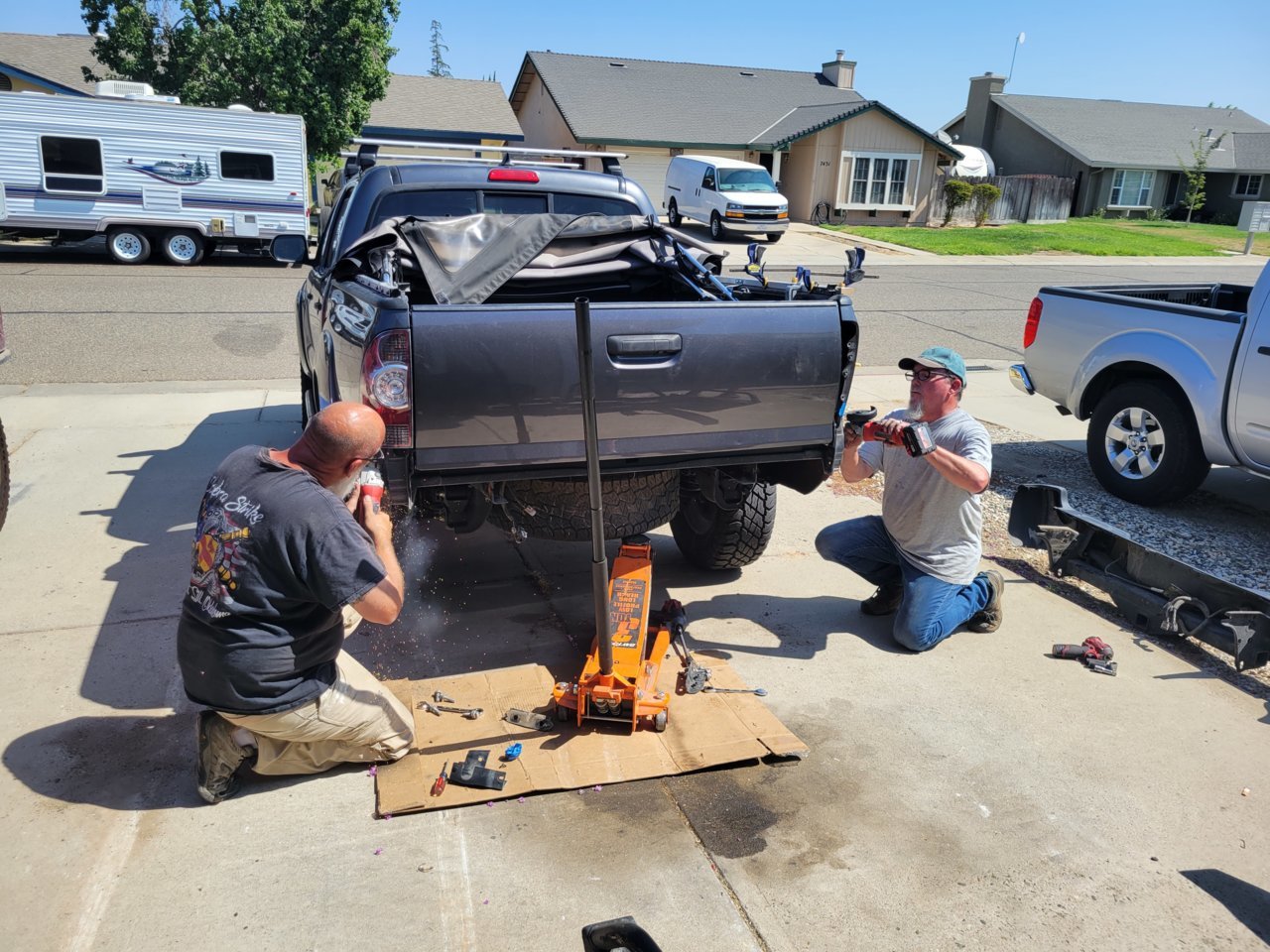

    @jberry813 old bumper found a new home.
    @essjay, @foxrcing07 @CalTacoma09 and I helped @Blue Canary mount it up.
    Larry's truck bout yo get to cut!
    Dualing banjos!
    Cutting weight
    Getting thing fitted
    Done

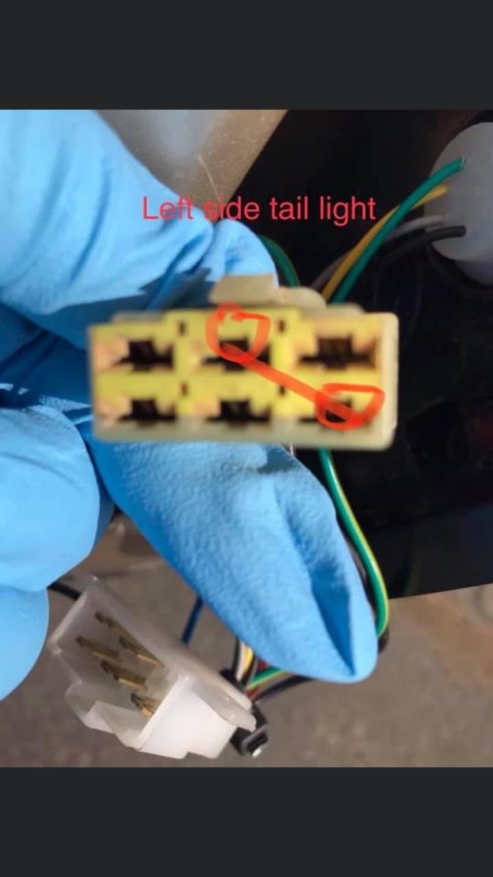

    Can you clarify what you mean when you say connect 2 wires together? I'm thinking it's something like taking a 2"-3" piece of wire, stripping both ends, and sticking each end into each of your marked terminals on the same side, then connecting the harnesses together (ensuring the wire is still connected inside both terminals). I did this for another car to eliminate the airbag light from staying on when installing an aftermarket steering wheel (called it a "jumper"). Am I correct? Is there a "better/proper" way of doing this?
    I have an '04 and using taillights made for '96-'00.
    Thanks for the help!

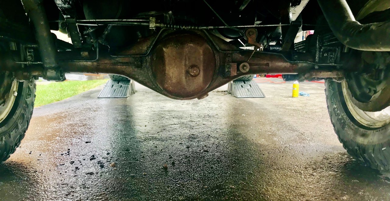

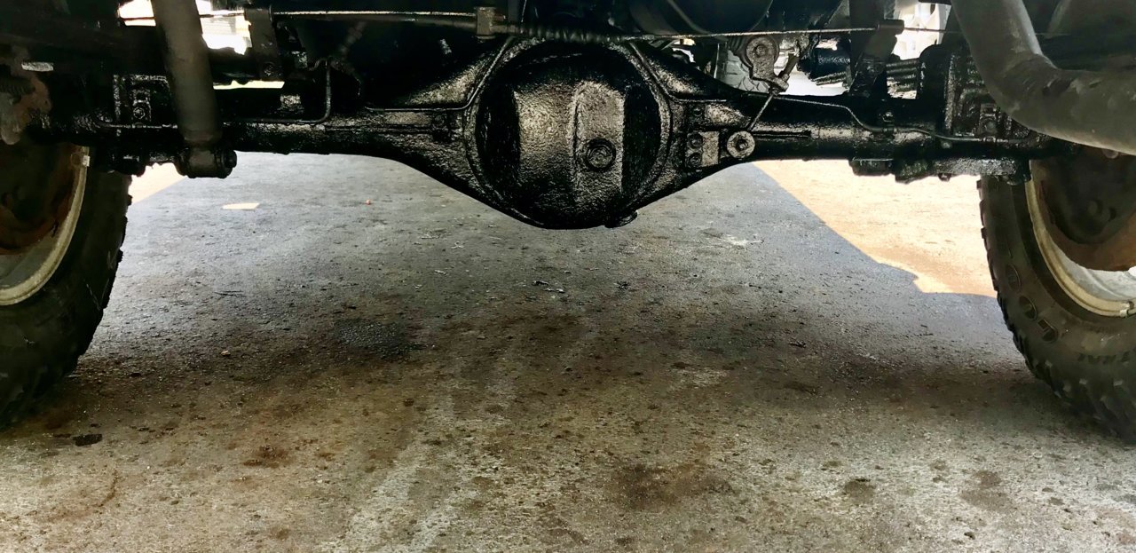

    Finished my frame with POR-15. This was the first time I have used this paint, really good stuff. Worth the money, In my opinion
    BEFORE
    AFTER

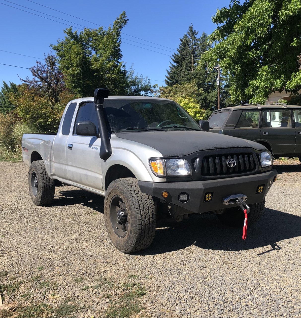

    2000 Tacoma Xcab Lunar Mist 4x4 2.7L TRD
    Snorkel done. Also replaced an air/fuel sensor.

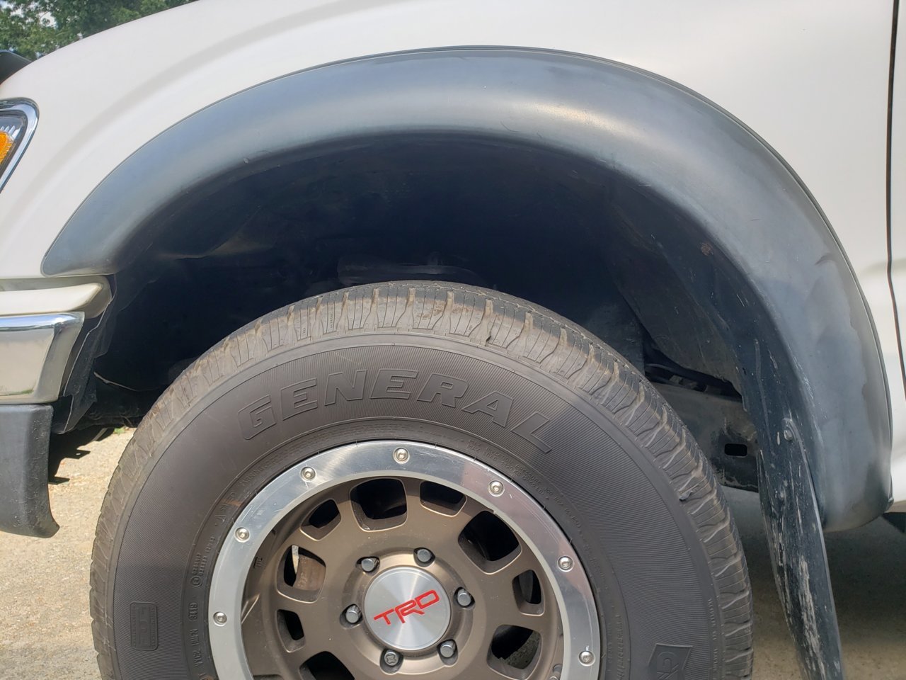

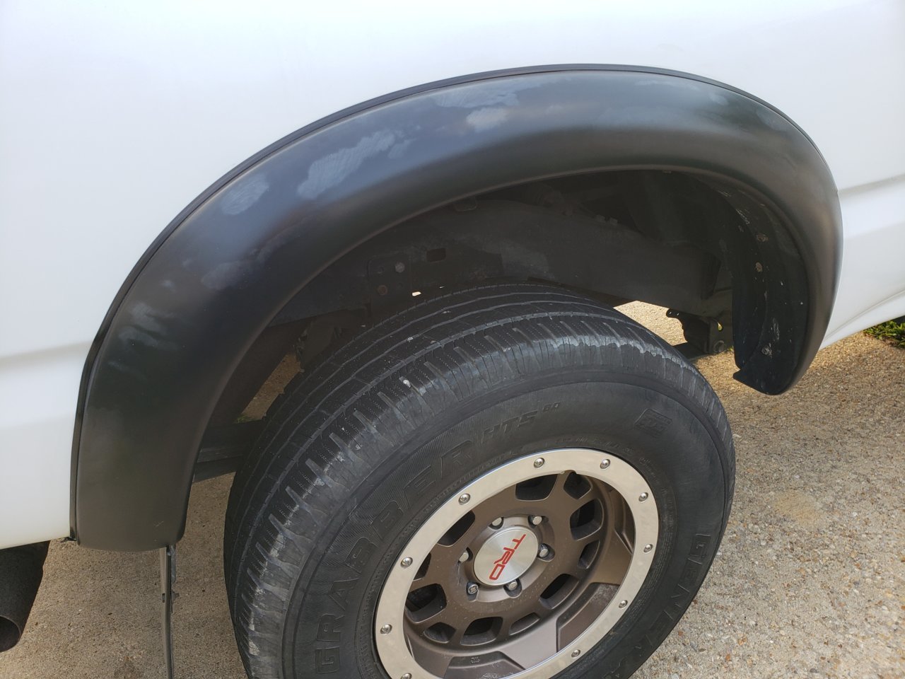

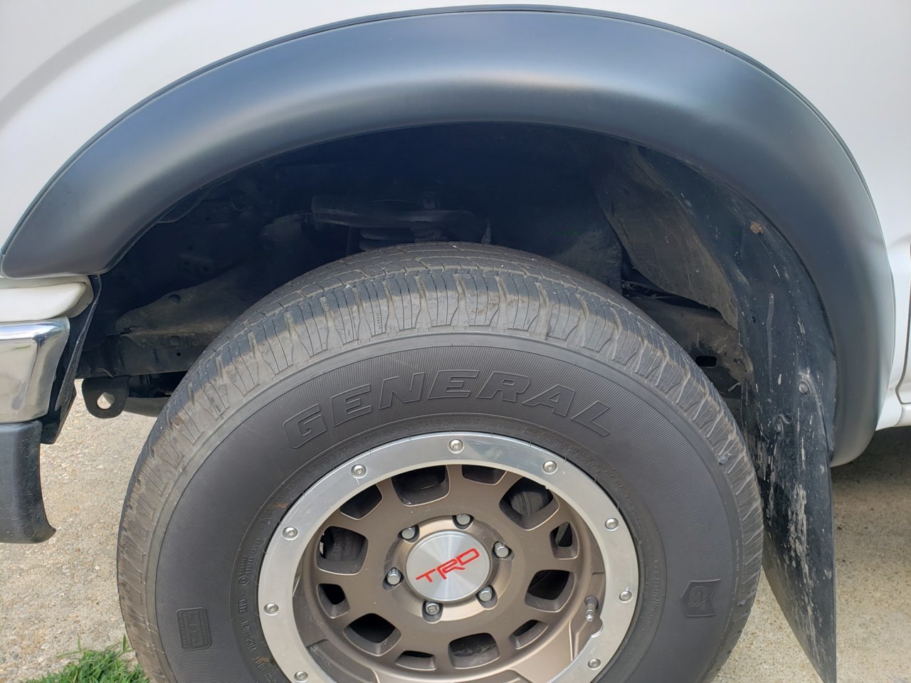

    Trim restoration!
    Not professional but it looks better than before
    Some pics of before and afters

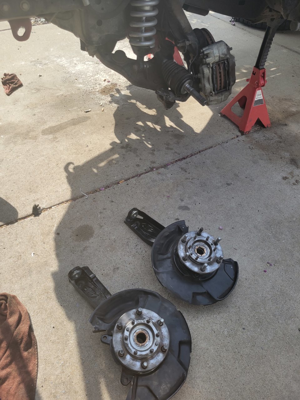

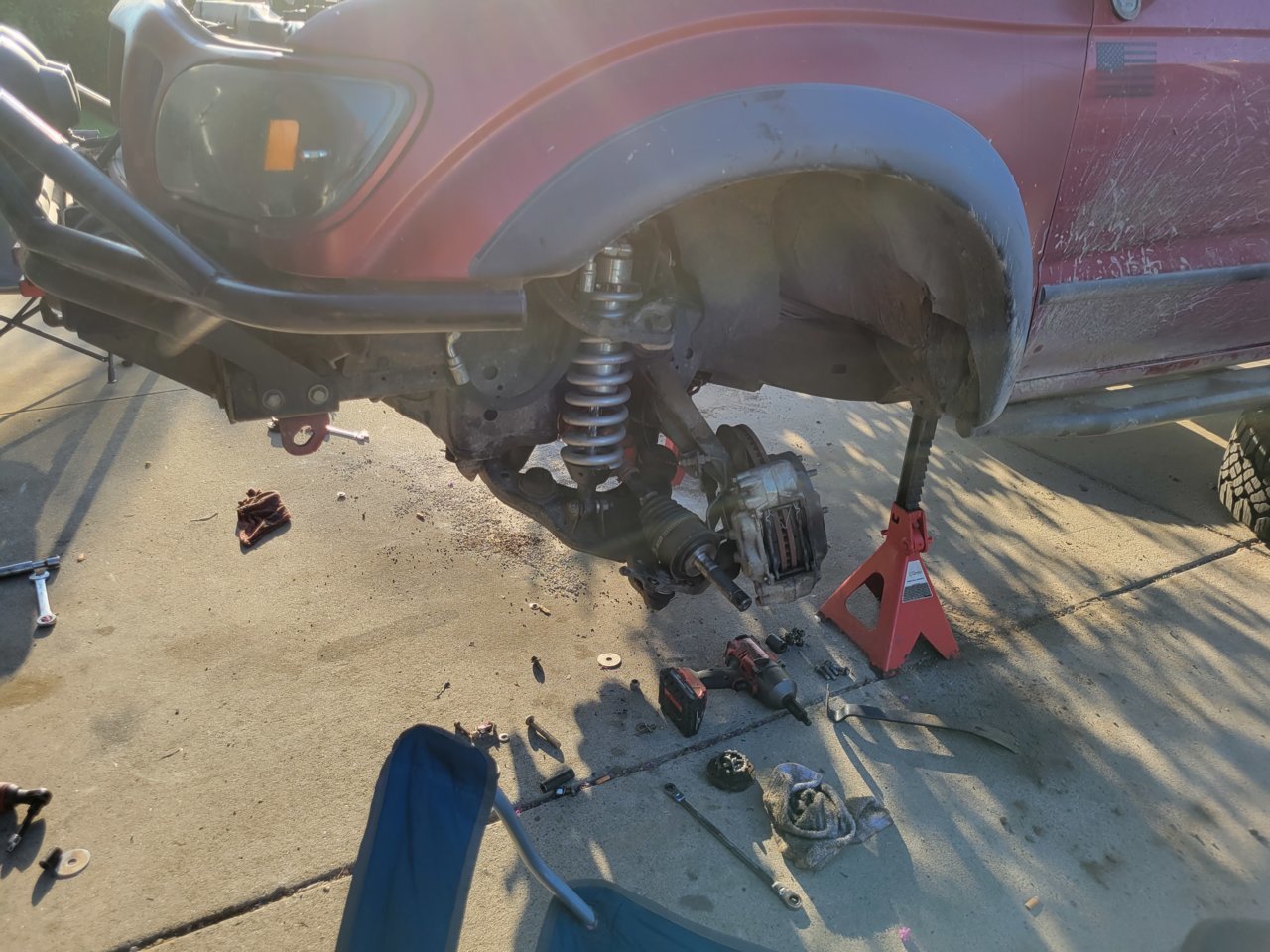

    Tore apart a 3rd set of spindles (my old Prerunner spindles) to get brake backers for the spare set of manual hub spindles I'm building.

    Well... those are ready.
    Such a pain in the ass.

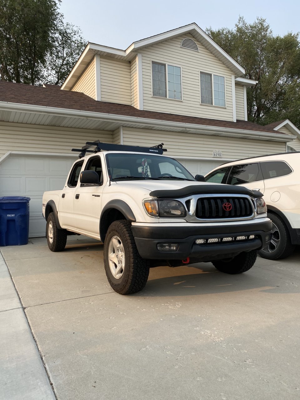

    Put a Light bar in the grill, love how this rig is turning out!

    At least you took the time to put them in the right place and not up at the top next to the bedrail. Looks good!

    Finished the spare set of spindles...
    Which are now on the truck...
    Which means I now get to buy bearings, retaining clips, inner, and outer seals again...
    And repeat this process...
