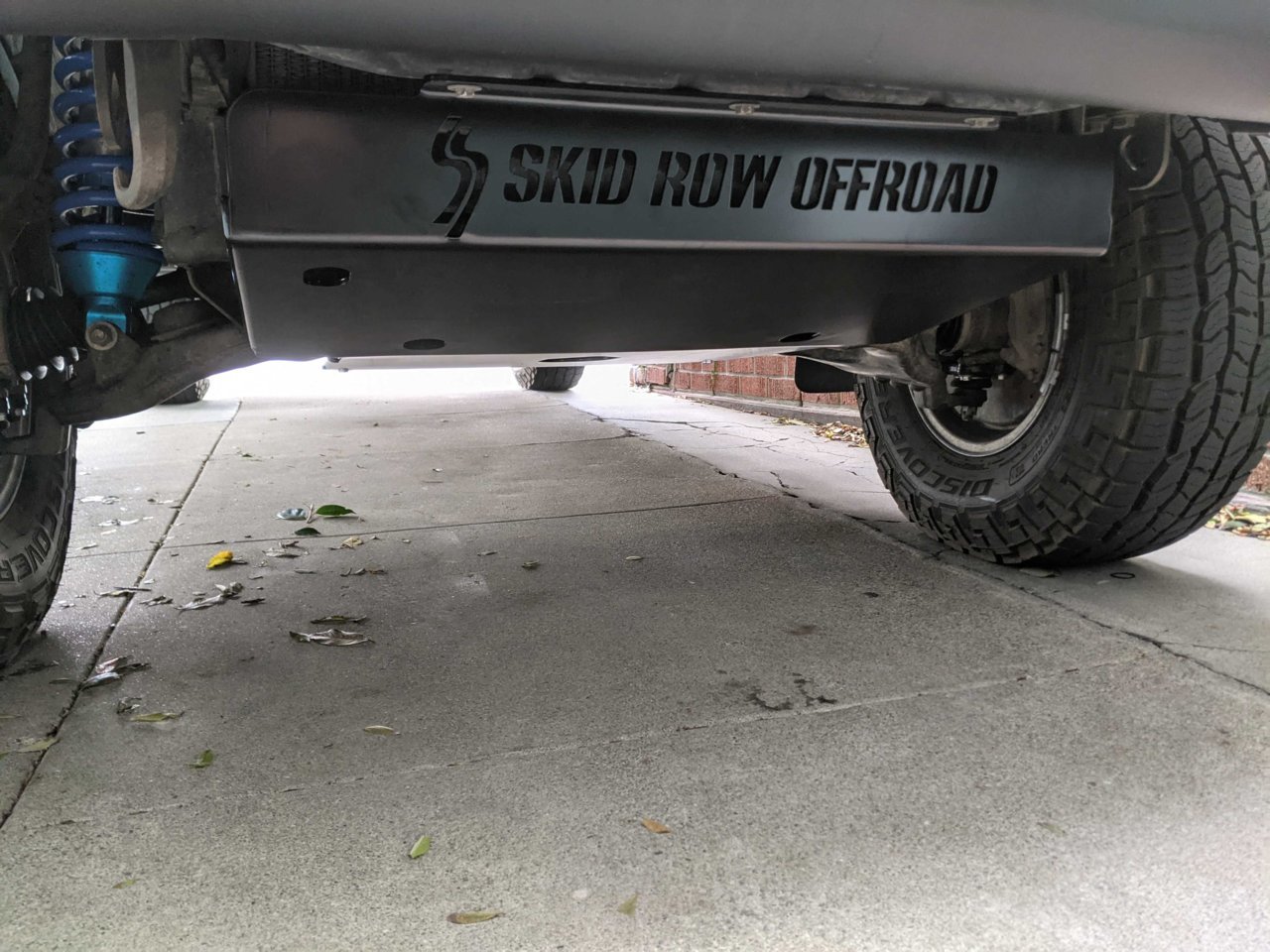

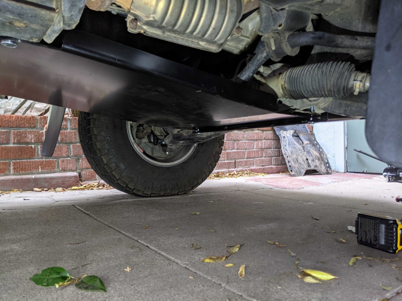

    Greased the driveshaft and installed Skid Row Off Road IFS and transmission skid plates. There's a bit of a lip between the IFS and transmission skid which I can imagine being problematic if backing up over an obstacle. Do I need to crank on those bolts more or is this ok?

    Those bolts look like they’re too long

    Yeah, i agree, I don't know why Skid Row provided such long bolts but they're definitely the right ones.

    I don’t know if you be able to tighten them up enough to get the gap smaller or gone, probably run out of space for the bolt to go

    Remove the bolts behind the transmission, then tighten the bolts where they join together. Cut if too long. Then put the bolts in behind the tranny.

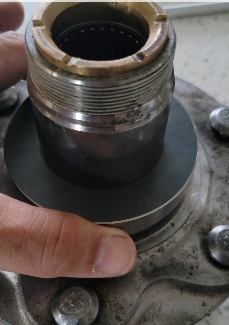

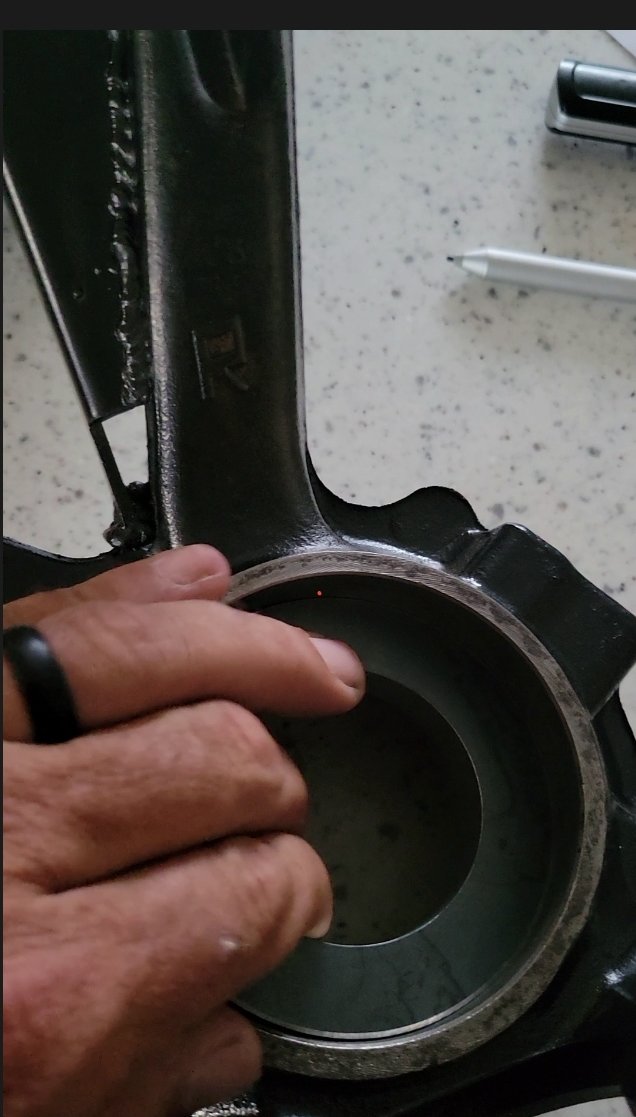

    My neighbor turned a plate for me that supports the entire bearing when the hub is being pressed through. It also presses the entire bearing on the way out.
    Screenshot_20210726-133119_Gallery.jpg Screenshot_20210726-133053_Video Editor.jpg
    I just use one of the large sleaves from the ball joint press, I have, to make up the difference in depth. (This avoids the problem Timmy has with things getting stuck)
    To press the bearing , I have a 1/2 inch thick plate that presses it in flush with outer rim, then I use an old bearing to press it the rest of the way home, past the groove for the c-clip.

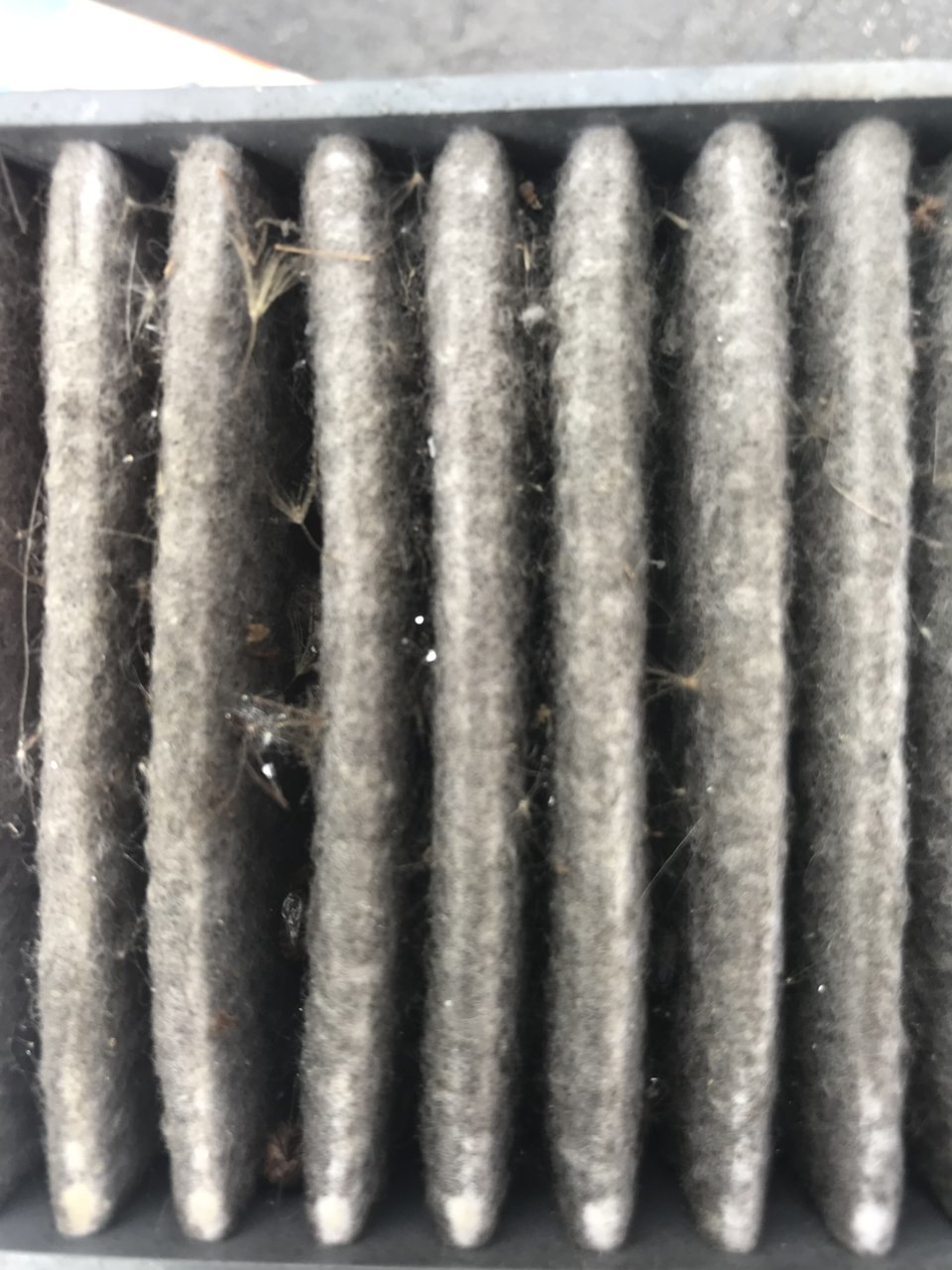

    Changed the engine air filter (hopefully to clear some nagging evaporation check engine light codes P0440, P0441, P0446) and treated myself to some new Bosch Windshield wipers
    Old filter, pretty dirty
