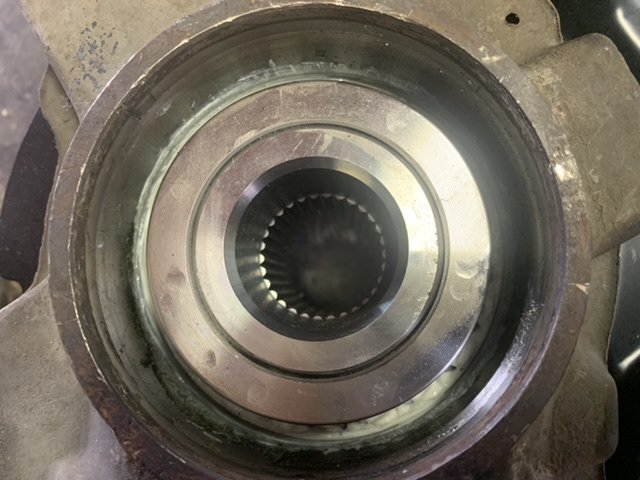

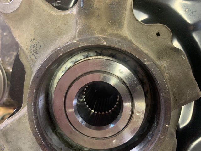

    Hmmm, tough to put my finger on what the exact issue of the loudness on the highway but it might be in this area (pointed in red):

    Not 100% sure from the pictures. But, it looks like they fucked your bearings. The inner part of the bearing (where the hub slides through) is two pieces. If they press the hub through the bearing without supporting the inner part, the hub will push the inner part out like that. That white grease that's visible is the grease that is inside the "sealed" bearing. If you can see that (in this context) the bearing is no longer any good.
    Also, the end of the hub should not be flush with the outer surface of the bearing. You should be able to put the spacer in there and it still be lower than the end of the hub. The ABS tone ring would also go in there (if equipped).
    That "Service Adviser" and the "Tech" should both, really find a different job. The "Service Adviser" should have been able to look up the part number for the bearing and realize the part number cross references for all 6 lug Tacoma. (PreRunner, ADD, as well as Manual Hub)(It's also the same for 3rd Gen 4 Runner and, I believe, 1st Gen Tundra). The tech should have known you can't press a hub through a split bearing. (The inner part of the bearing is "split" in 2 pieces) without supporting the bearing.
    If you're on a time crunch, I'd call this "bad news" but it isn't arson. I'd go back and tell those dip shits to replace the bearings they destroyed and look up the process on YouTube if they aren't properly qualified to do a relatively simple routine maintenance item.

    Thanks. That’s good information. I was going to call a different dealer, but instead I emailed the service director from the dealer that did this and asked him how he plans to correct it.

    I was patiently waiting for someone else to comment and confirm what I saw.
    Yeah, you shouldn't see the inside of the sealed bearing when freshly pressed in and assume it's seated properly.
    That's tech manual 095 - remedial bearing install on 1st gen Tacoma/3rd gen 4rnr.
    Probably better they messed up the bearing than bend the spindle(s)
