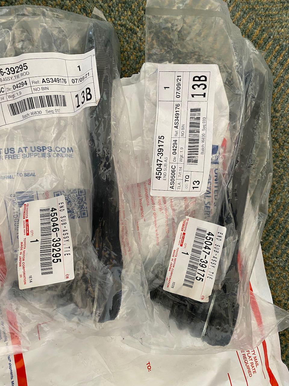

    received some parts today :)
    excited to get it installed next week

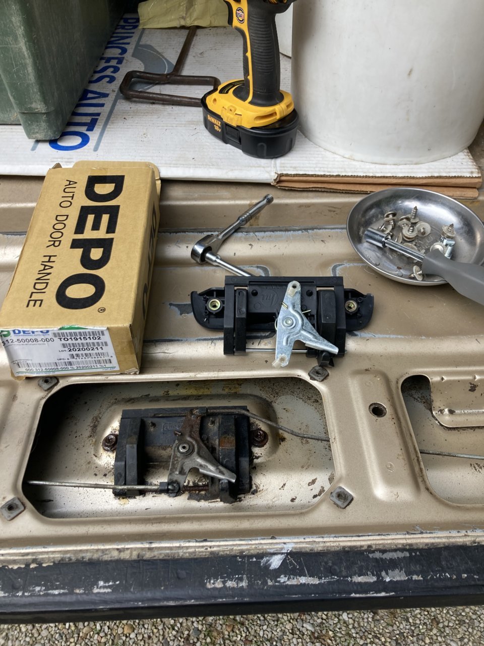

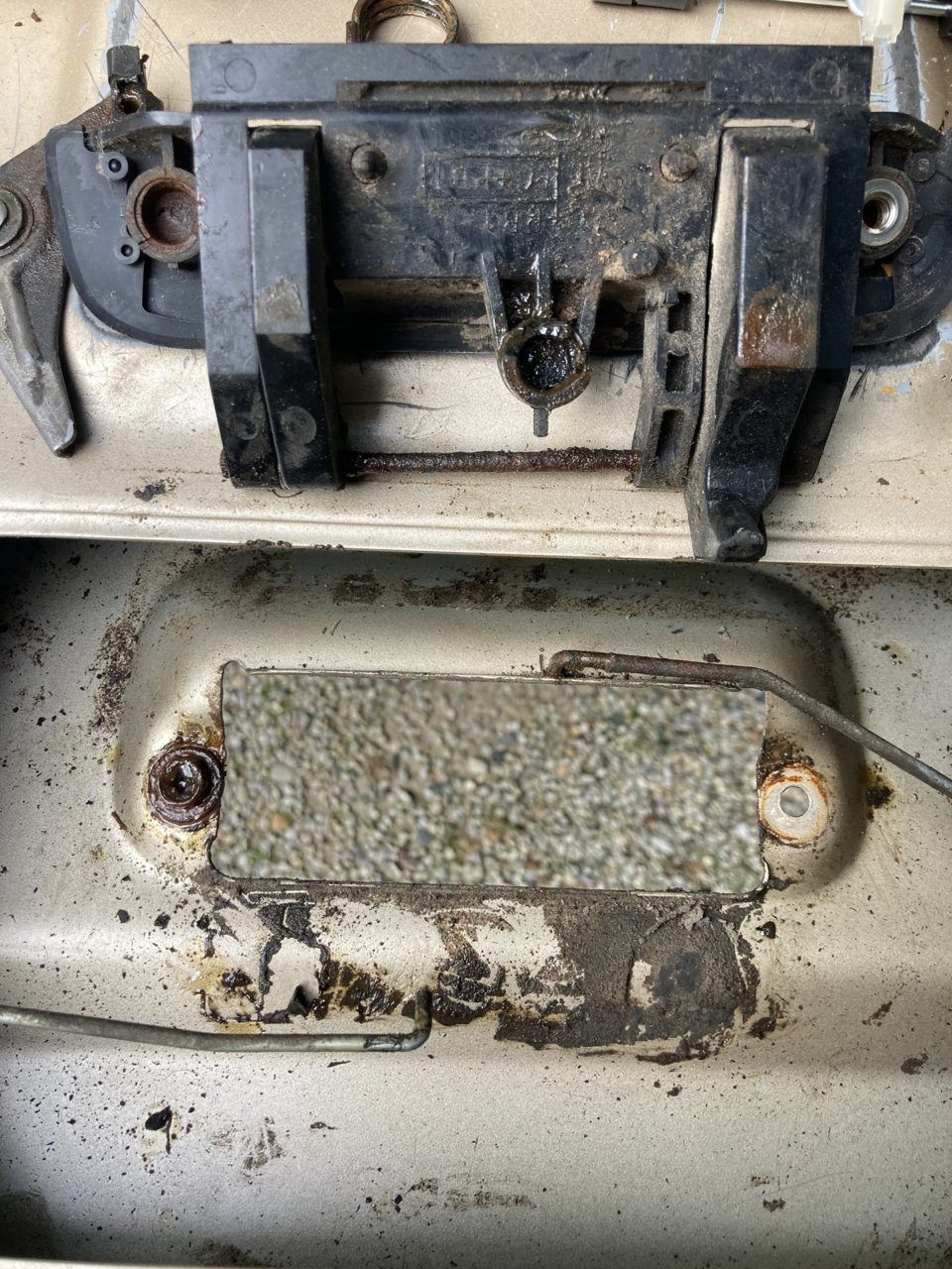

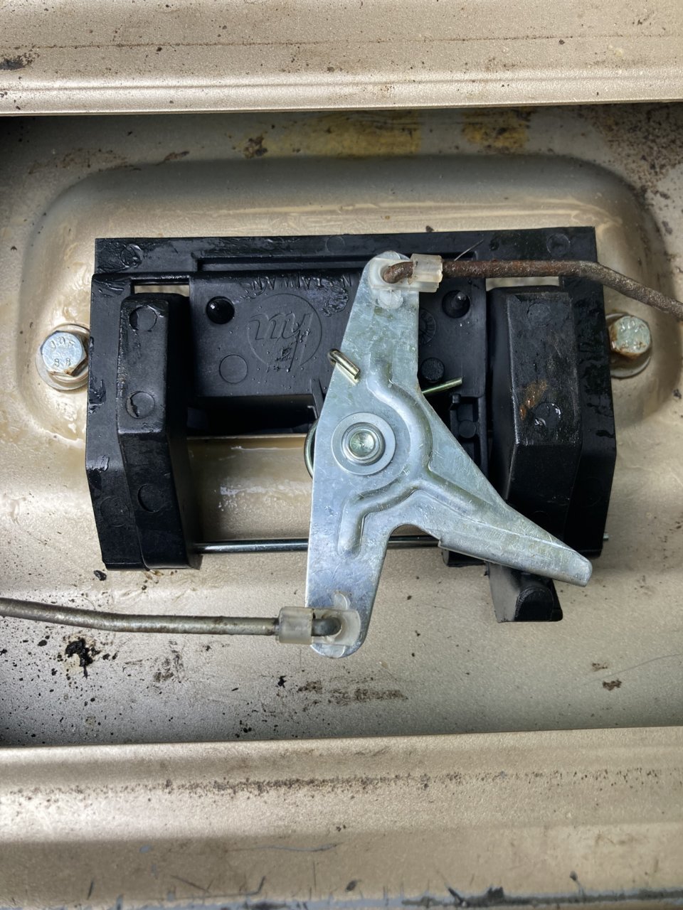

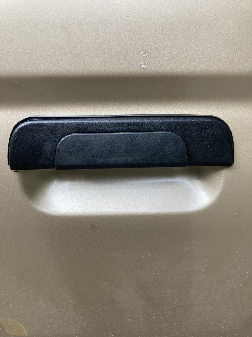

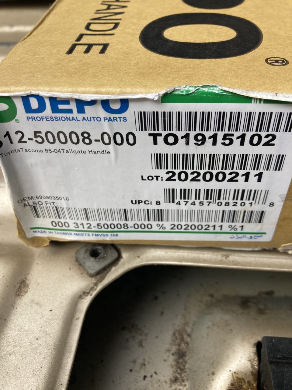

    New tailgate latch install this morning. Decent fitting part that was only $22 Canadian on Amazon.

    I've heard mixed results, on aftermarket......

    Yeah me too so I guess time will tell but I’ve been operating with a broken latch for a few years now so this is much better.
    I did use OEM when I replaced the drivers door handle after a bad Amazon experience
    The doorhandle was $169 Canadian from the dealer here… Ouch

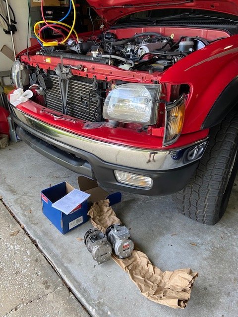

    Out with the old, in with the new. No small wonder the compressor sounded like a cicada, it had maybe 5 CC of oil.
    Put 120cc of PAG 46 in the compressor and 20 in the receiver. Been holding 30” of vacuum for about 20 minutes now, I’ll give it another 40 min and button her up.

    I know. I wasn't trying to criticize. OEM comes at a price. OUCHIE

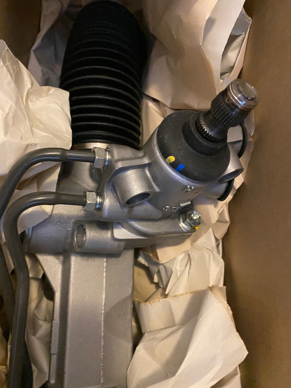

    trying to chase down this shake in the front end. The only thing I think it could be at this point is the steering rack, but I don't really want to load the parts cannon and shell out $500 if its not the rack :annoyed:

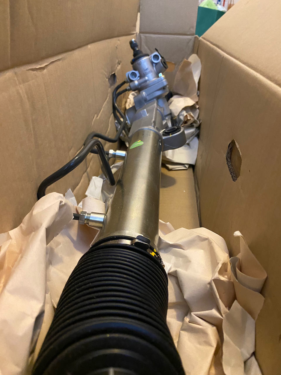

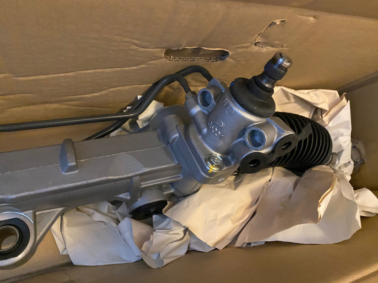

    mine is leaking and I thought why not replace it. Also got the shakes at 65 - 70 mph. Balanced and replaced wheels and tires / rotors and brakes. Ball joints. Got better but still there. So since the rack has a leak, I pulled the trigger. We shall see

    mine is leaking a tiny bit, and has the tiniest bit of play, but the play has been there for months.
    Rotated tires, replaced brake pads, calipers, rotors (had a caliper dragging), ball joints have zero play in the them, tie rods have no play, control arm bushings are new. I am at complete loss lol

    I am installing the rack next week. Will let you know if it helps.

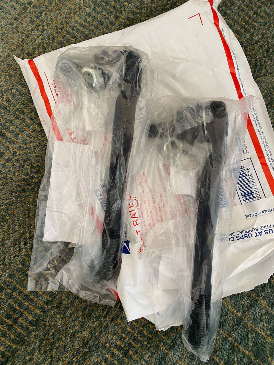

    Ponied up and now its just a waiting game for a new rack and outer tie rods :spending:
