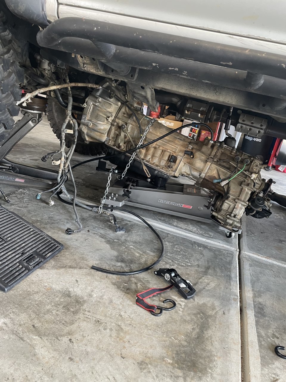

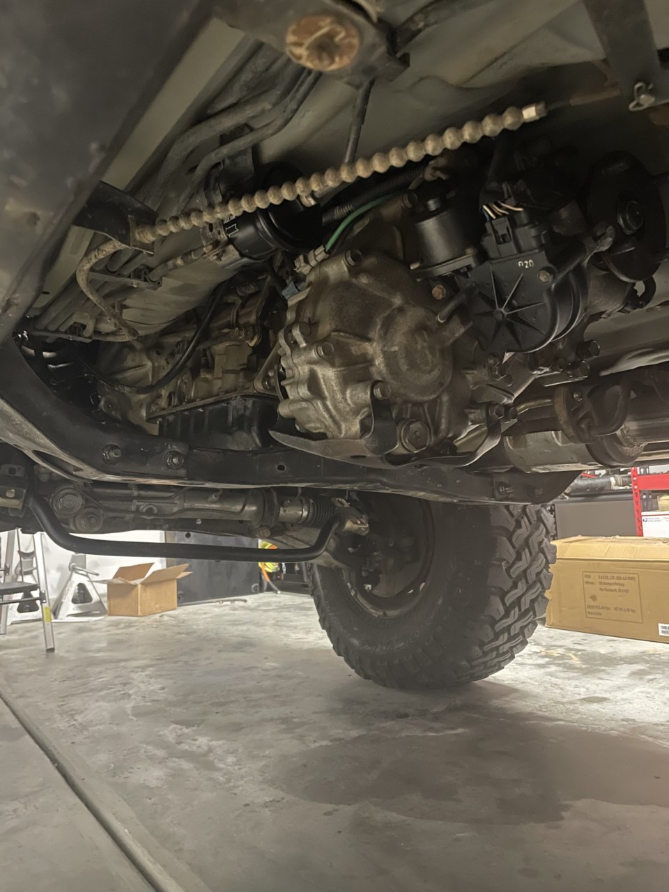

    Why is the front section shortened?

    Dual cases

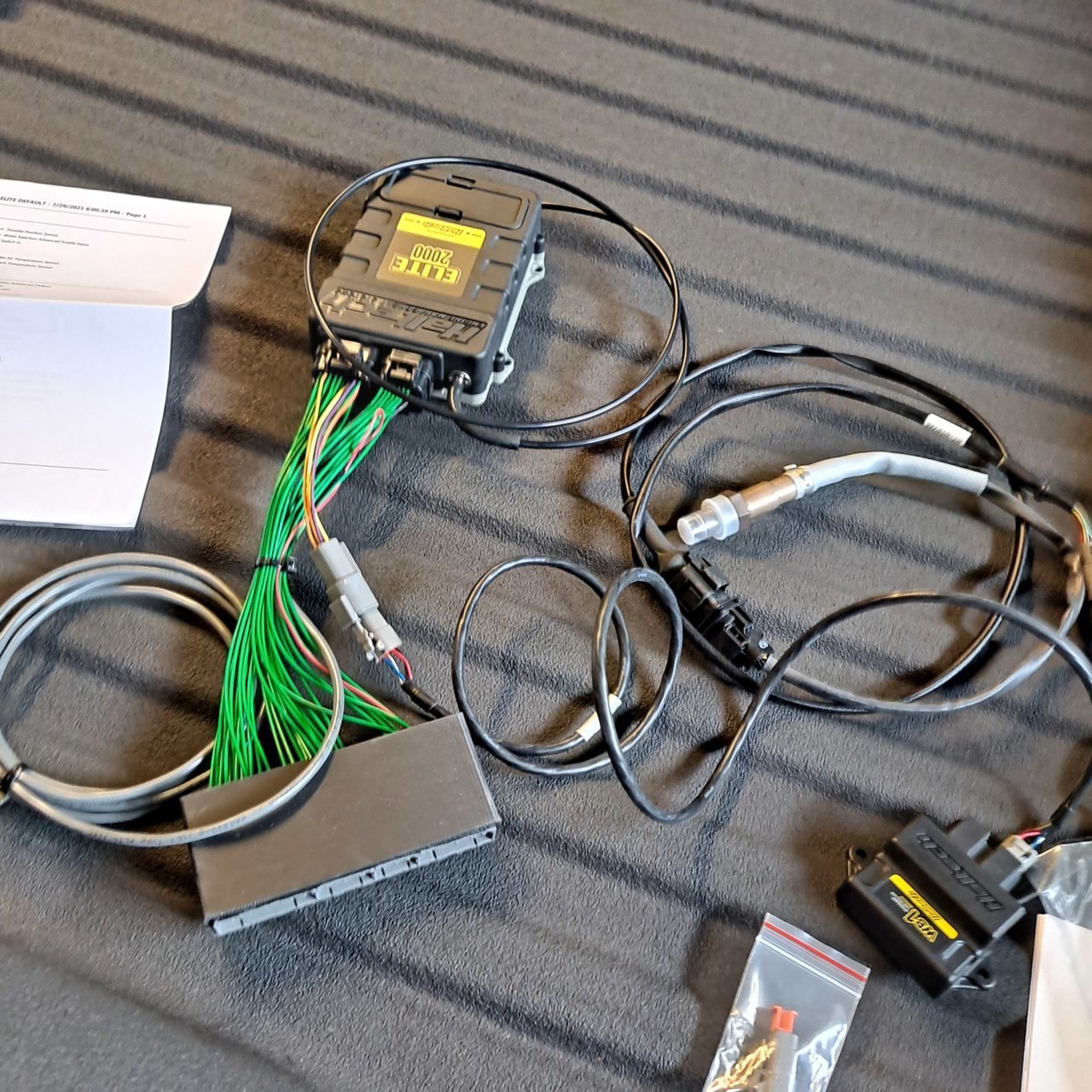

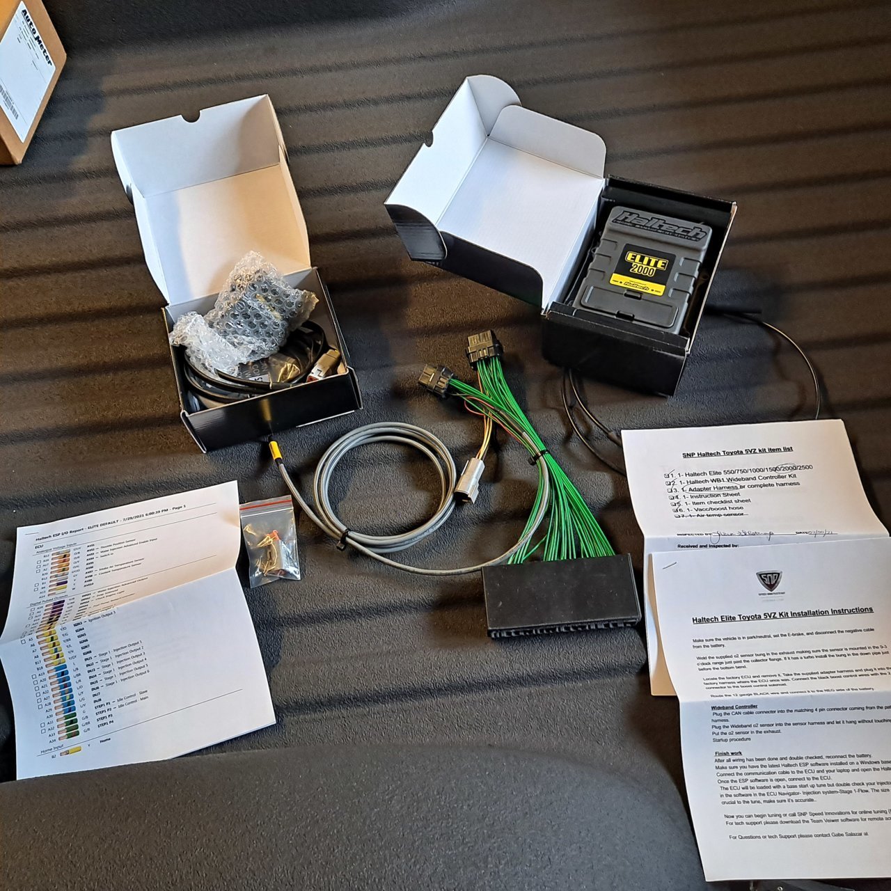

    I’m still on my original starter so I know that day is coming,
    I have the Dough Thorley headers.
    My new project that arrived yesterday is the haltech 2000 Stand alone ECU for the supercharger, plug and play

    Do you have current hp and tq numbers? Just curious how much you will gain from a real tune.

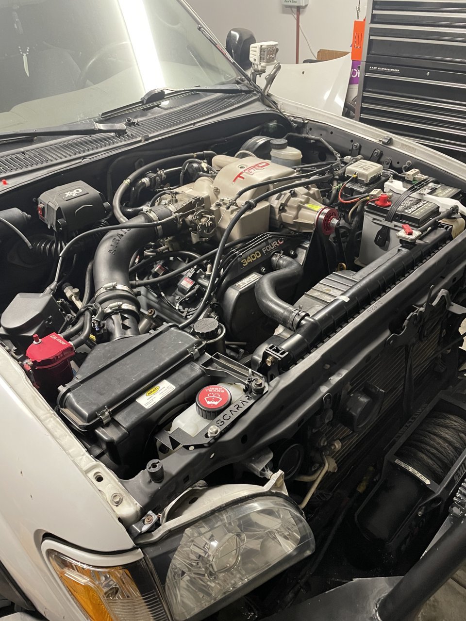

    I'll add that Scarab washer to my list of things I do not NEED but definitely now WANT.

    Just a note on the Scarab washer bottle... if you've done the deckplate mod, the added thickness of the deckplate makes lining up the airbox mounting points difficult (the deckplate pushes on the hardware used to mount the washer bottle to the bracket). I think this could be overcome by using different hardware that doesn't have a tall head height to mount the washer bottle to the Scarab bracket. It is super nice to have just a small little bottle instead of a that 55 gallon drum tucked into the fender.

    I mean my bottle has been long gone, but it's one of these that the lid doesn't always close that well on, and the bottles very thin so if the ziptie that holds the motor on is a little off it will leak.
    For $5 for a two pack at walmart 5 years ago, it's definitely served its purpose, but I like a cleaner version.

    Its about having a consistent correct AFR in boost, better timing number, no open loop or closed loop to deal with,
    no MAF used anymore, the power curve should come on righ away instead of at 3000 rpms. The OEM ECU is very conservative
    Yes I have before numbets but that was done when it was 50-60 degrees outside so I will have to wait till fall (it's 90-100 degrees now)
    to do the comparison after I get it installed and tuned
